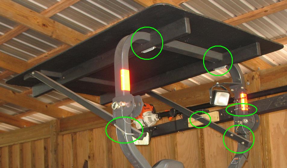

Quit worrying about drilling or not. Just clamp it to the ROP with a square-end u-bolt from the hardware store or a couple of bolts with a steel strap between the ends.
Bruce
Square U-bolts are great! Look how many I'm using to attach my canopy & polesaw-holding 4x4 to my ROPS:

Im no engineer, just repeating what i heard. Also if yours fails or something you will never sue if your hurt wont hold up in court. NO i dont worry about the sky falling.

Didnt really take it like you were jumpin on me. I was just pointing out for those who worry about such things. If i had thought to weld mine first i prolly would have, but the fact that metal is so high and i really dont have any laying around i never thought to weld it. The U-bolts were my first thought and with all the vibrations there one of the few things that hasent vibrated loose on there.

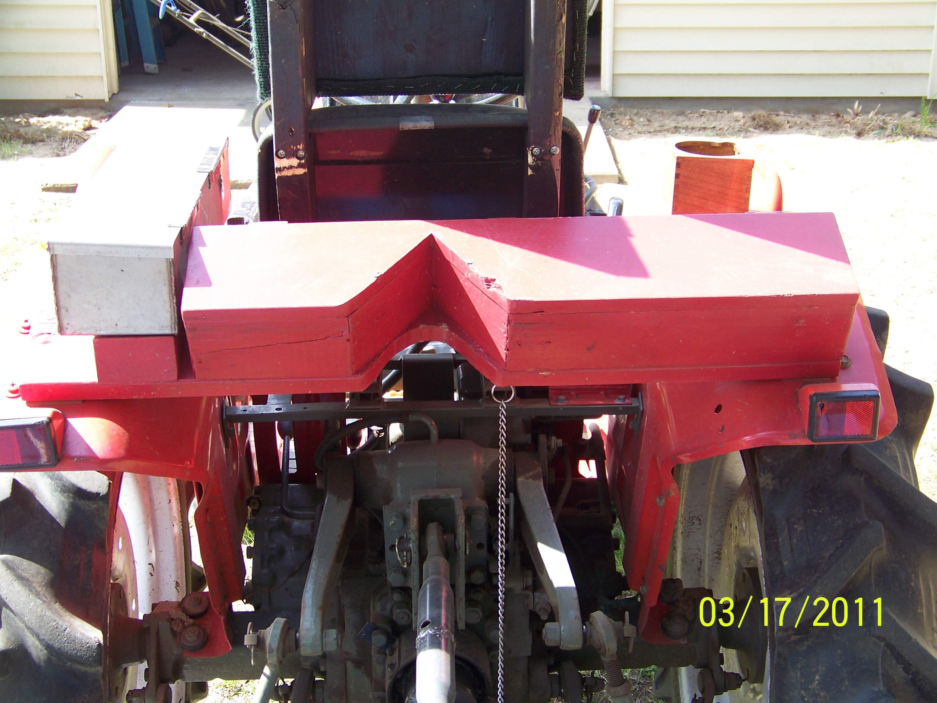

Here is what I had to do to mine to clear the top link. It can definitely be a problem.
