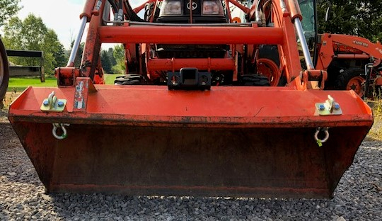

As you can see, I use this bucket for work. Chose to add the backplates with clevis eyes so I could hang shackles on them. Both the hooks and the shackles are VERY useful and much safer than trying to hang chain hooks on the lips of the bucket.
I like this setup. And I realize that as often as I am going to move 1 ton rocks I can take the time to reverse the hooks. It's not like they are welded on. :)

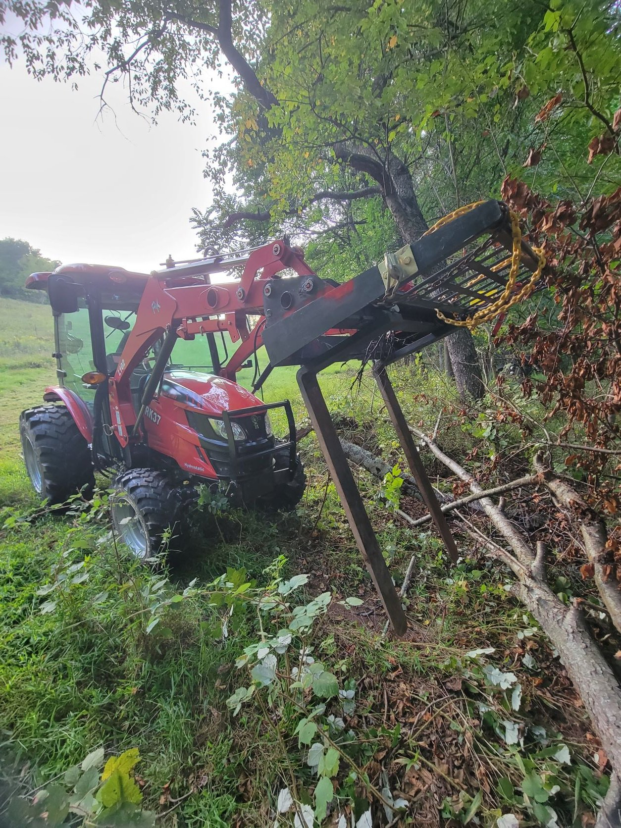

This is my poor man's grapple. I don't do a lot of wood moving so this servs for now. The chain hooks on the side are kind of overkill. The fork plate has a guard I can chain to but they were cheap and fun to bolt on. The 48" forks were about $700 at an auction after all costs. The paint is overspray from marking the edge of the loader plate to make alignment easier.

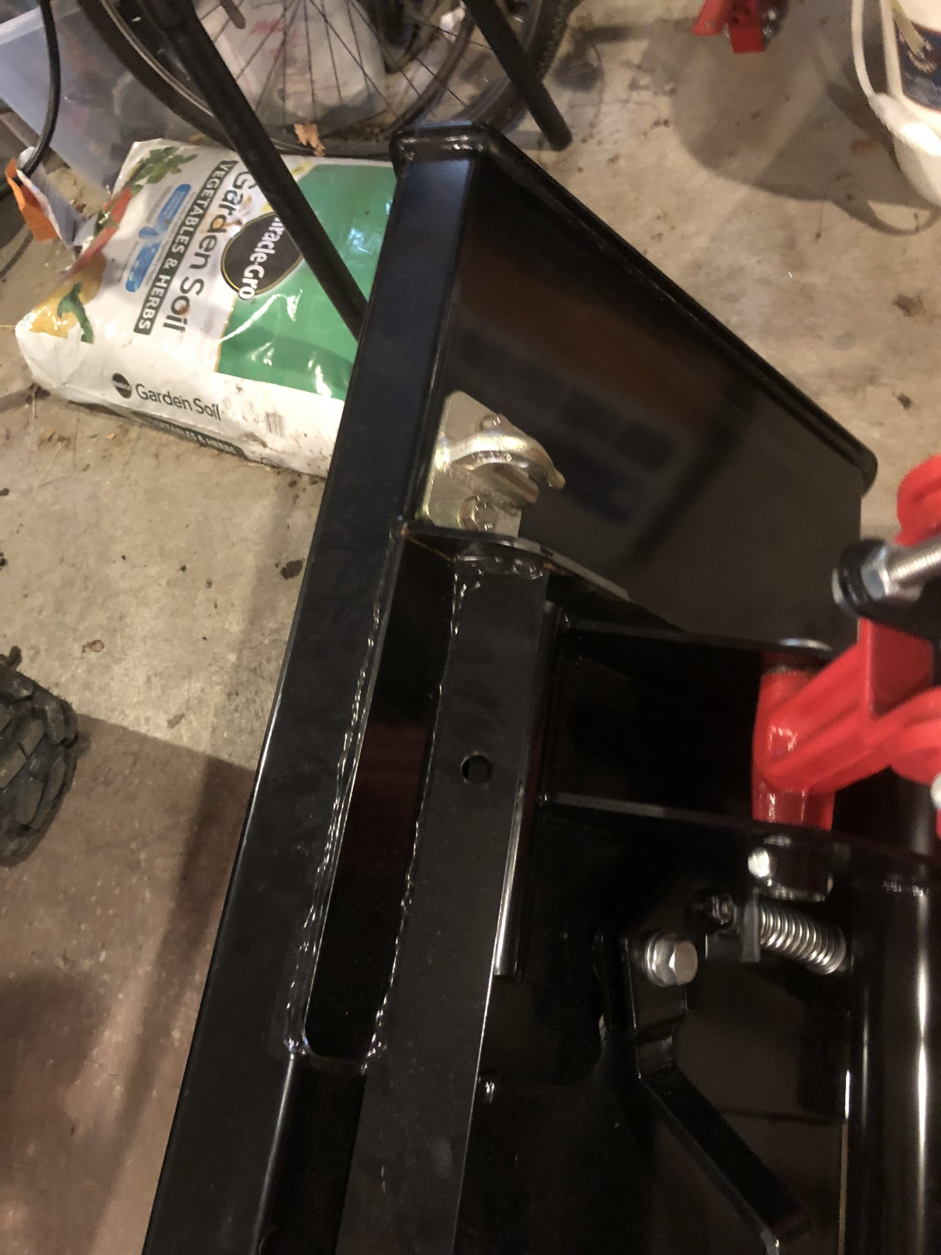

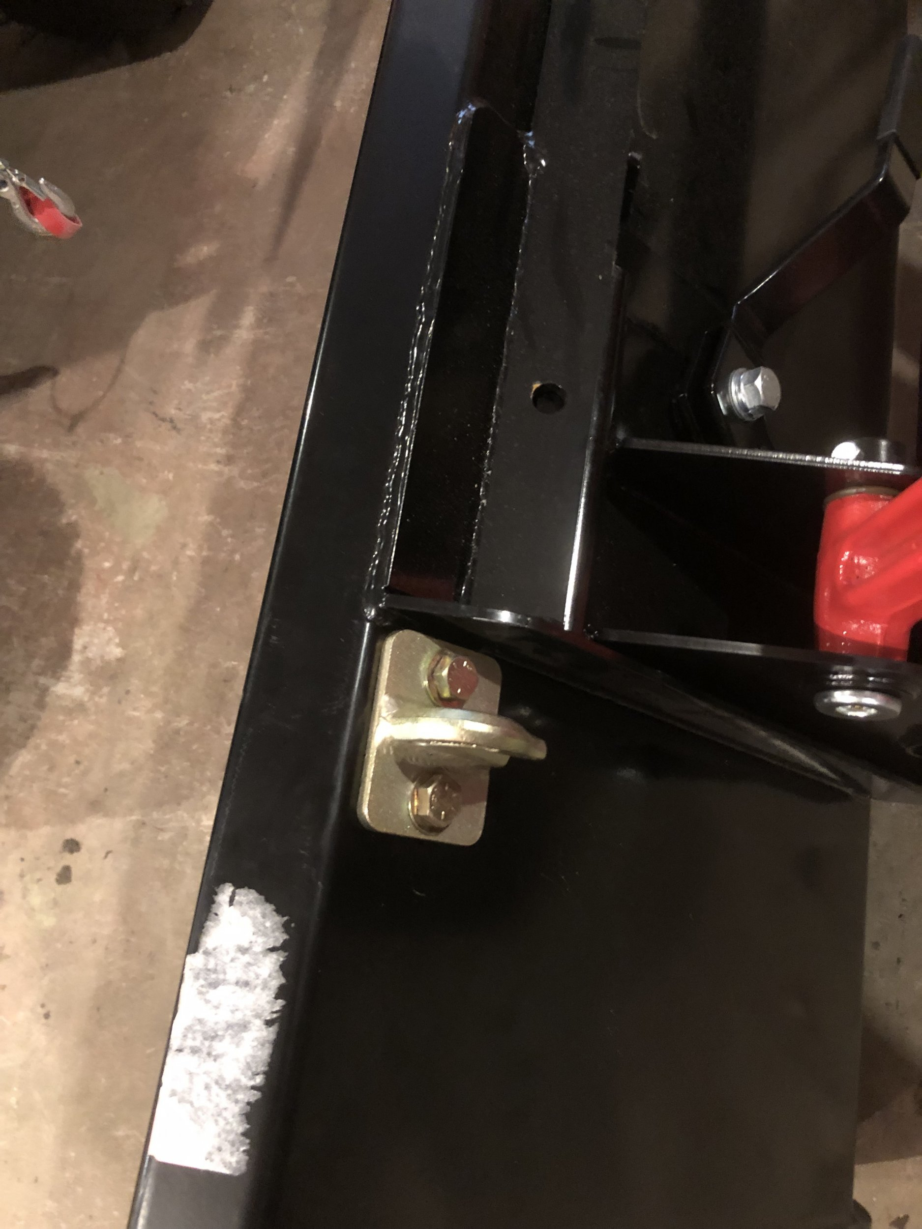

Just got an RK37 and was looking around my shop when I noticed I had 2 of the Ken's bolt on hooks.
I had bought a set of 3 for a previous tractor but could only put one on the bucket.
I placed these just outside the lift arms as there isn't really a place to them right in front due to the skid steer quick attach plates. This placement should still maximize the ability to lift.
I had chosen these hooks as they are very strong and have great reviews. I chose the simple bolt on without the backing plate due to their destruction testing (they have videos on their website) and they had these on a fairly thin piece of metal and the chain broke at 20 thousand some odd pounds of pressure and the washers did not fail. Just saved a few bucks as a result.
Here they are on the new bucket.
