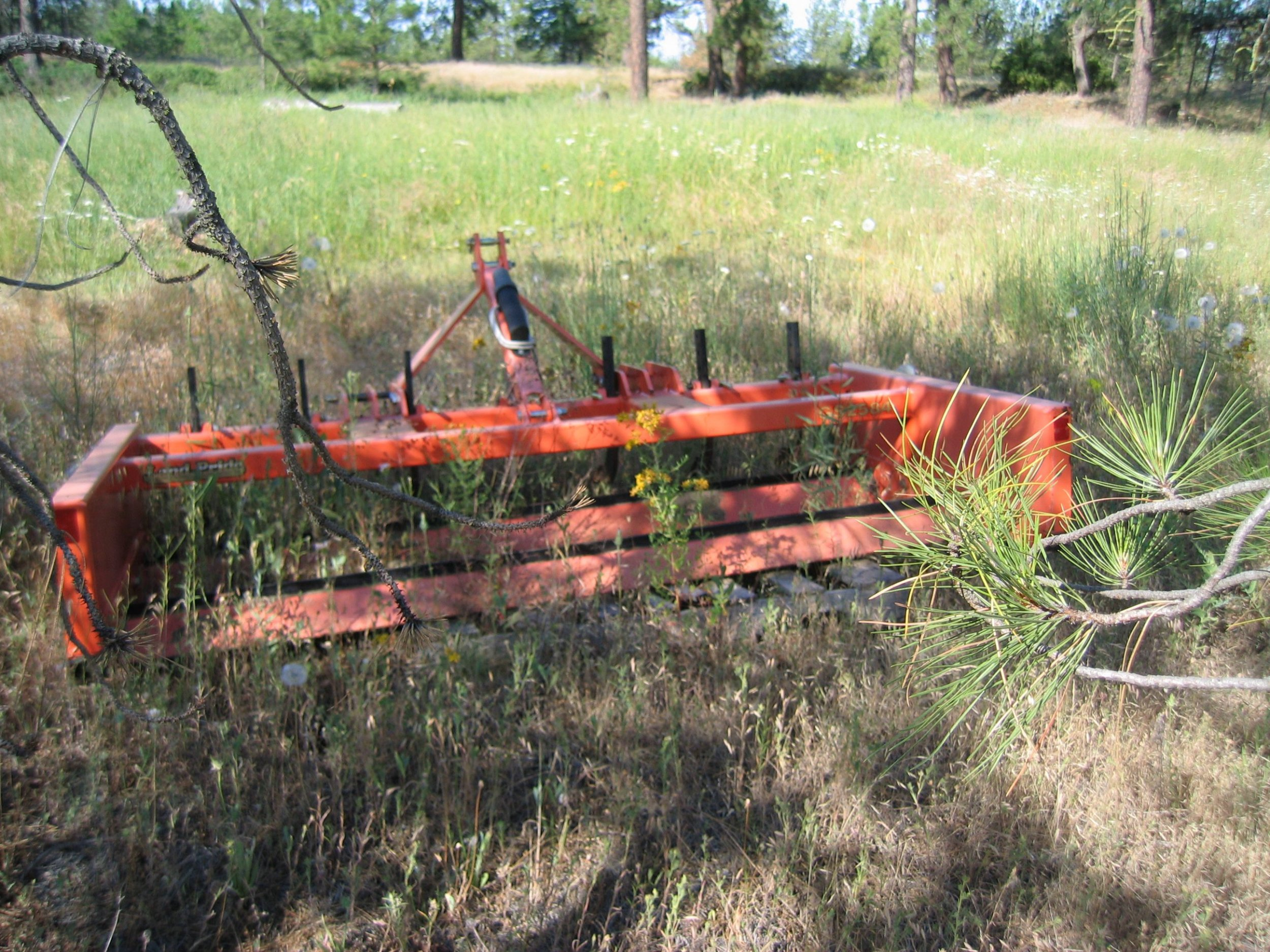

ROBB - roll over box blade. LPGS - land plane grading scraper. The ROBB allows me to mechanically change between standard box blade or scarifiers. LPGS - perhaps the simplest land engagement implement made. Side boards with angled heavy duty angle iron( two chunks) across/between the side boards.
This is the only pic I have of my LPGS. As soon as the batteries charge up in my camera I'll post a better pic.

The ROBB is always, in my case, used in the forward motion. You use either the box blade OR the scarifiers. You don't use them both at the same time. Here is a better picture of my LPGS - GS2584.
