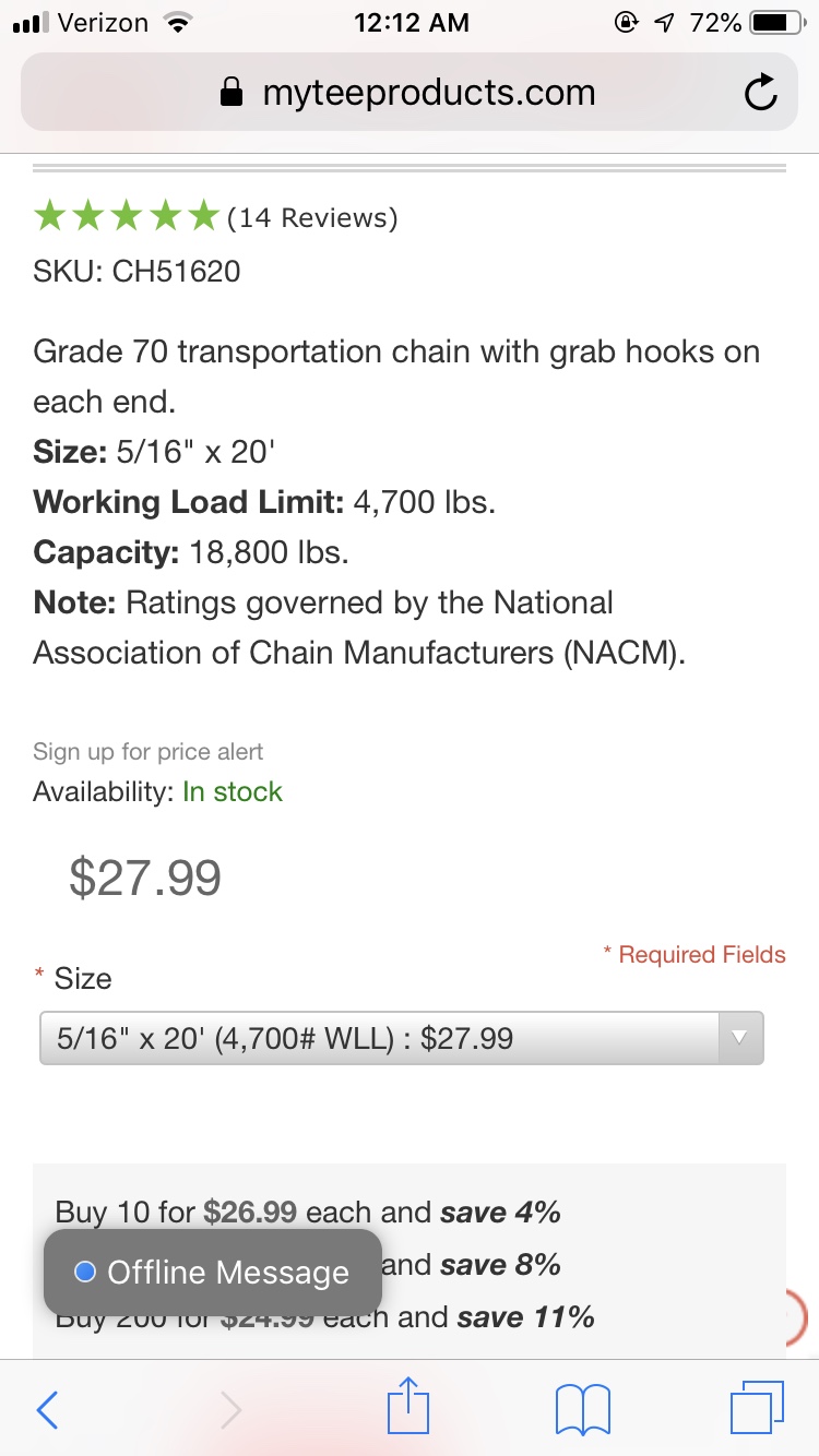

A 5/16” grade 70 chain can be bought for less than $40. How much cheaper can a lesser grade be bought for?
5/16” grade 30 has a WLL of 1,900 lb
5/16” grade 43 has a WLL of 3,900 lb
5/16” grade 70 has a WLL of 4,700 lb
All would be adequate for that light of a tractor but the corrosion resistance of the grade 70 and just the added piece of mind are likely worth it. One chain cut into four (or three) pieces will likely be long enough to do what you want. Even if the lesser grades are half the cost which I doubt they are is it worth saving $20? Securement devices are one area where I think overkill is a good thing.
You can buy a 5/16 20’ grade 70 for $28. Even a 1/4 grade 70 would be plenty strong enough at 3100 WILL but I don’t know where to get it for cheaper than $28

Thanks for the lead, that's the best price I have seen on 5/16 G70.
