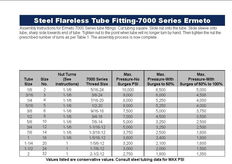

If you're just getting into Swage-lok stuff at work, they have VERY specific tightening instructions that vary somewhat with the size - the reason for that is removability - if you don't tighten the fitting ENOUGH, it will leak. IF you tighten it to spec, if won't leak and you can unscrew it and put it back together easily with no leaks.
If you tighten it TOO much, you will upset the end of the tubing that seats inside the fitting too much, swelling it so it won't come out. If you tighten it THREE much :D it's possible to get a stress crack in the fitting body.
These flareless fittings are NOT Swage-lok, but work similarly - with both, you want them tightened just til you can see a SLIGHT deformation where the sleeve fits around the tubing - less, and they'll come apart under pressure; too much, and they can deform and leak.
When I first started using the flareless fittings, I bought a few spares so I could screw up a couple as a learning experience - I found you can get it figured out in 2-3 tries by just paying attention, knowing approximately how much to tighten, and looking at where the crimped sleeve joins the tubing.
Here's a different brand's chart that worked fine for me... Steve

Brandi, good talking to you tonite - I hope BOTH of us can get life to smile at us a bit more soon :rolleyes:
Just in case you (or others who read this) don't already know, these compression type fittings are NOT like torqueing a bolt - by that, I mean that ALL bolts have a recommended torque spec (except the ones that actually measure STRETCH on the bolt to achieve the required amount of "crush") - but torque specs are DIFFERENT for the same bolt depending on whether it's dry or lubed, and even slightly different depending on what KIND of lube is used -
This is NOT true of compression fittings, which normally use the # of TURNS past a certain point (like when the tube won't move by hand) - dry OR lubed, if they call for 6-1/6 turns (AKA "7 FLATS") then that's what they mean. That # of turns will ALWAYS compress the "guts" of the connector the same amount, whether dry or lubed; so I always use lube (just on the threads, though) so there's less chance of galling on the threads.
Hope this helps... Steve
