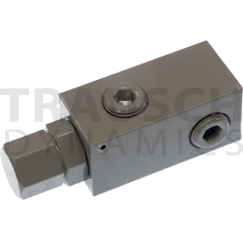

How do you go about mounting a relief valve when it only has one (looks like) 5/32 inch hole through it? Relief Valve.jpg It is item number 7107333 from www.hydraulicstore.com It is a Prince RD-1850H relief valve.

Brandi, your solenoid valve will have 2 mounting holes (not including the 4 "stack" holes for multiple units) - what I would do is figure out where/how that solenoid will mount, then maybe tee off whichever port closes your thumb and mount the RD-1850 on that tee - you'll need to figure out what kind of adapters you need to go from NPTF to BSPP (if that's what you already have on the ex) - those relief valves are usually just hard piped to the rest of the system. I've installed a couple of that model on my 580B for add-ons, and they're fine being held just by piping. I came out of mine with NPTF-JIC's, 'cause that's what 99% of my fittings already were.
It helps A LOT to have a swivel or two on adapters, so you can get the NPTF threads tight and sealed and still point things (like the relief pressure adjust, RD out to tank) the way you need 'em.
HTH... Steve

Thanks Steve. I guess I will have to do that. I just schooled in aviation, that anything unsupported itself will vibrate and vibrations are bad up there. I'll pipe it straight and make a bracket to fit that one hole, just for grins.
