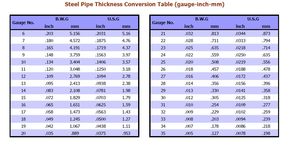

That was 3/8" x .035 wall 304 - normal hydraulic pressures no problem at that diameter, larger (like 1/2") should be at least 18 ga. (.050" or bigger) - those pieces were actually from "dumpster diving" at work - up til the last 4-5 years I worked (rare metals plant) they allowed us to buy scrap from the dumpsters (separate ones for mild, stainless, zirc, Ti, copper, etc) - IIRC, at that time mild scrap was $.05/lb, stainless was $.10...
If you can't find any locally, here's one source
ASTM A269-1 34 Stainless Steel Round Tube | Buy Online | Cut to Size | No Minimum Order
check out the price difference on different wall thickness - 16 ga. 1/2" tube is less than 18 ga. ??? so if you're not desperate for that last little bit of flow, it's cheaper and sturdier to go thicker wall...
Also, note that they will cut a 20' stick in half, should make shipping a little easier. Here's a gauge chart if you don't already have one... Steve
I'm second guessing my steel tubing purchase, after forming one tube and installing it last night, after my Grand daughter and daughter went to bed. I was under the impression it was .068 wall and it is really around .88 wall. Really cuts down on the volume flowing. Not sure if it will make me happy with thumb movement. We'll have to wait and see if I like the thumb speed as is. The lines on the excavator are 1 inch lines.
