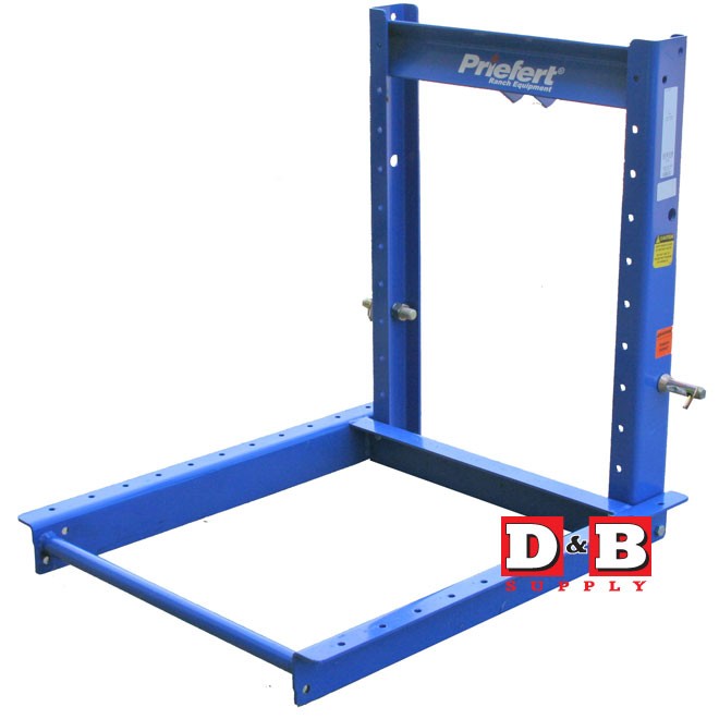

Another selection:
3 Point Carry All For Tractors
A thing to watch for: some have the rear horizontal bars connected near the end. Those work for building a platform on, but you can't use a pallet or use it like forks.
A trailer is better for long items like logs or tall brush. With a carryall you have to carry it crossways or drag one end.

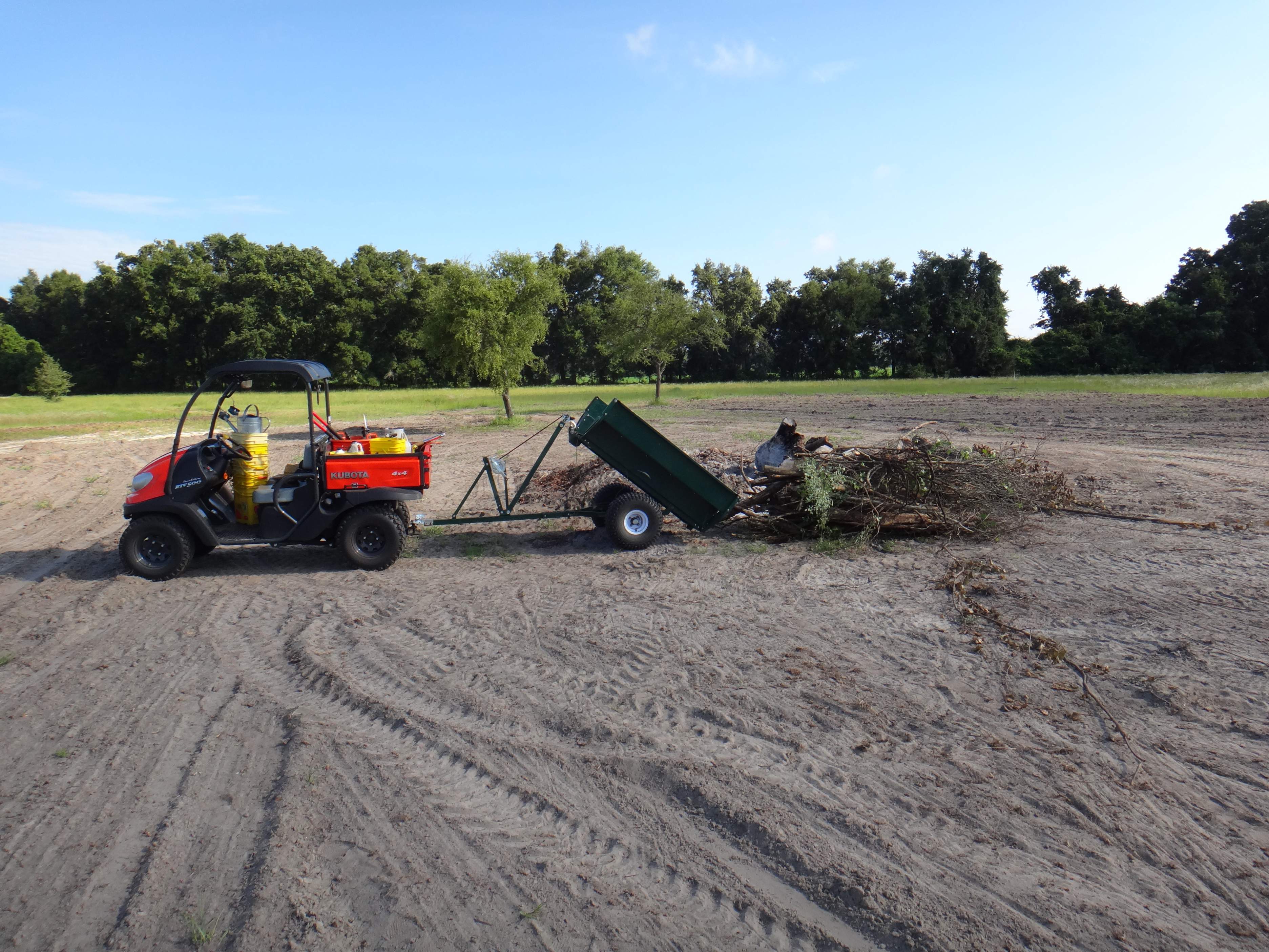

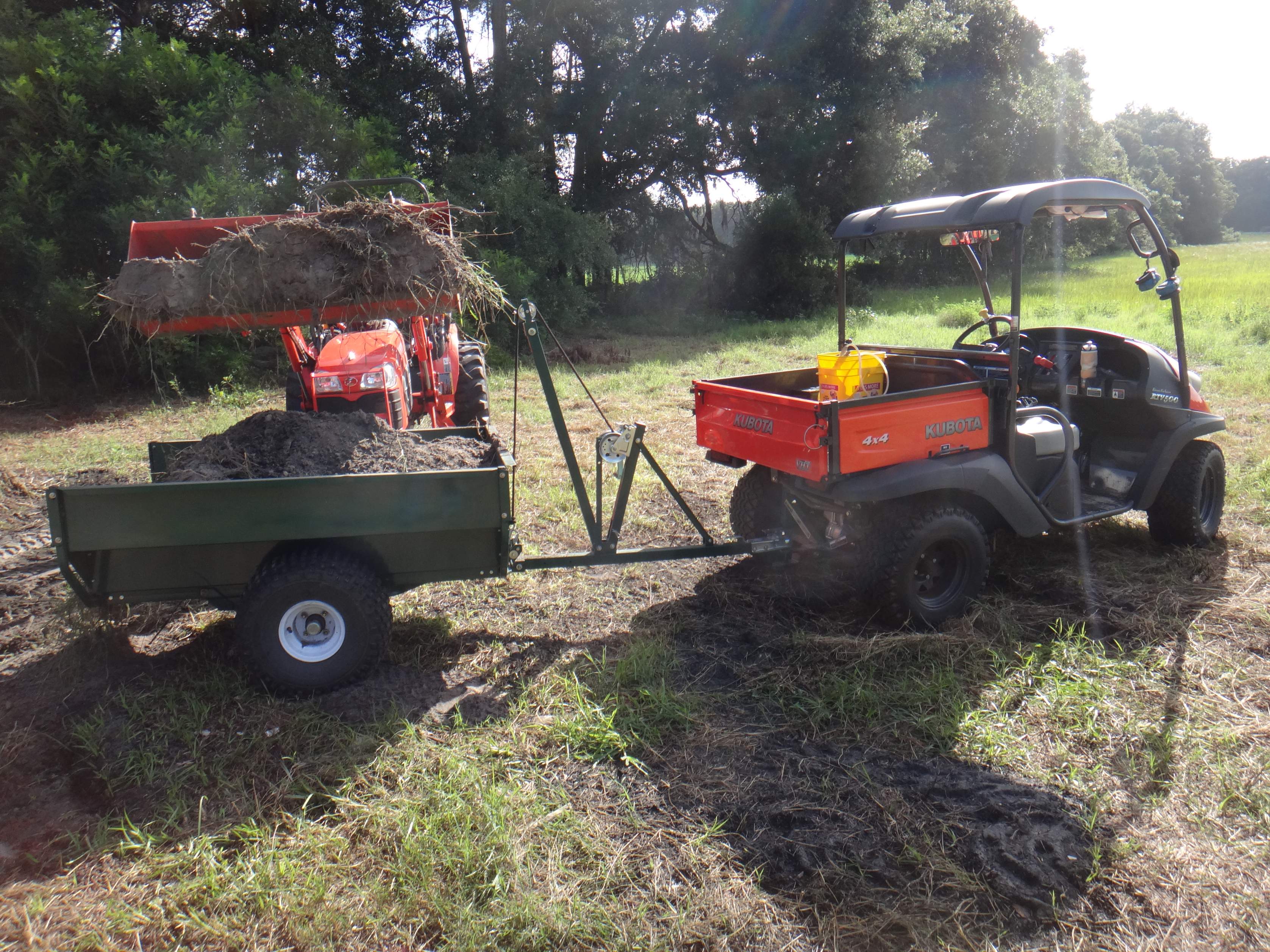

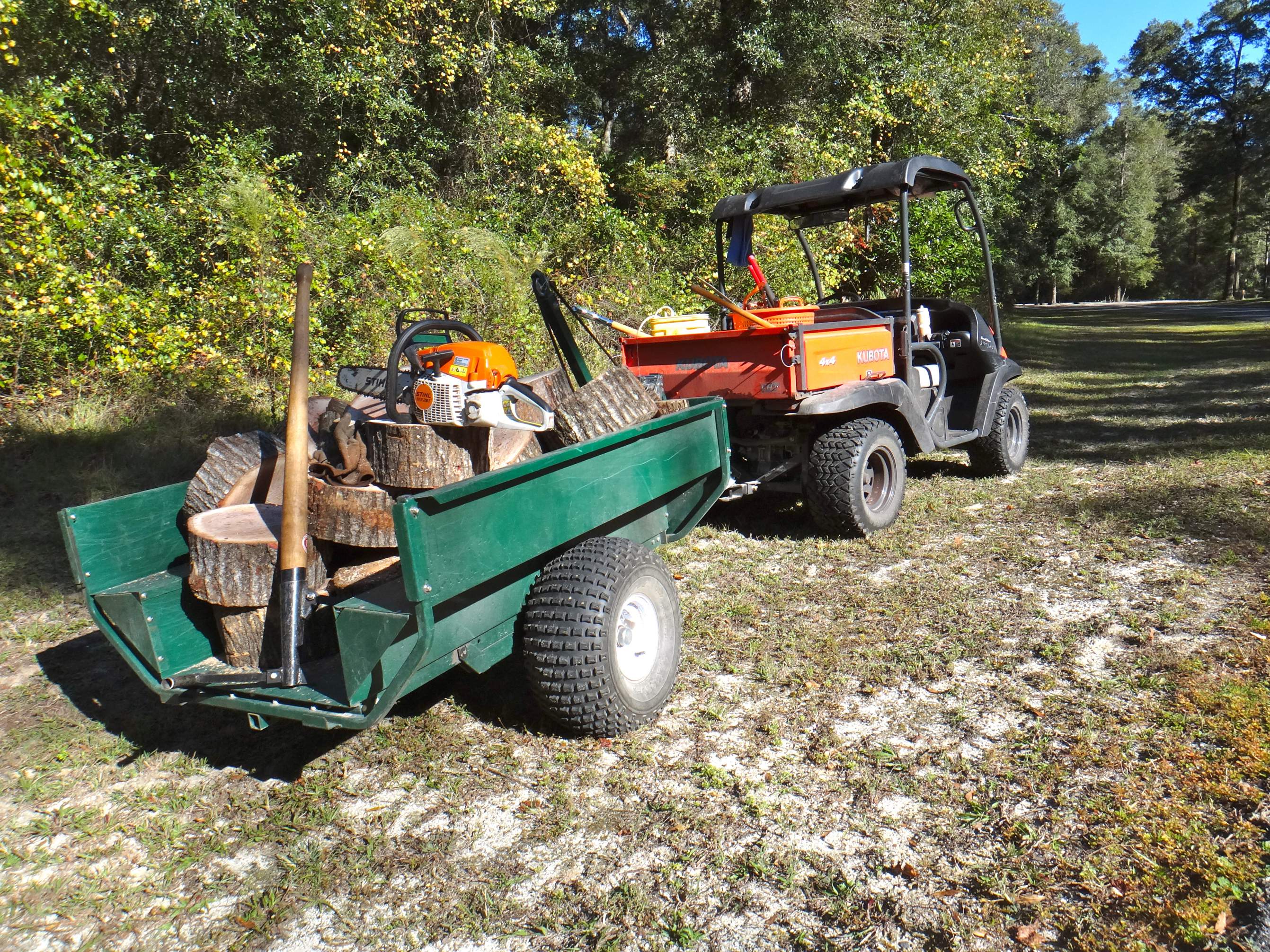

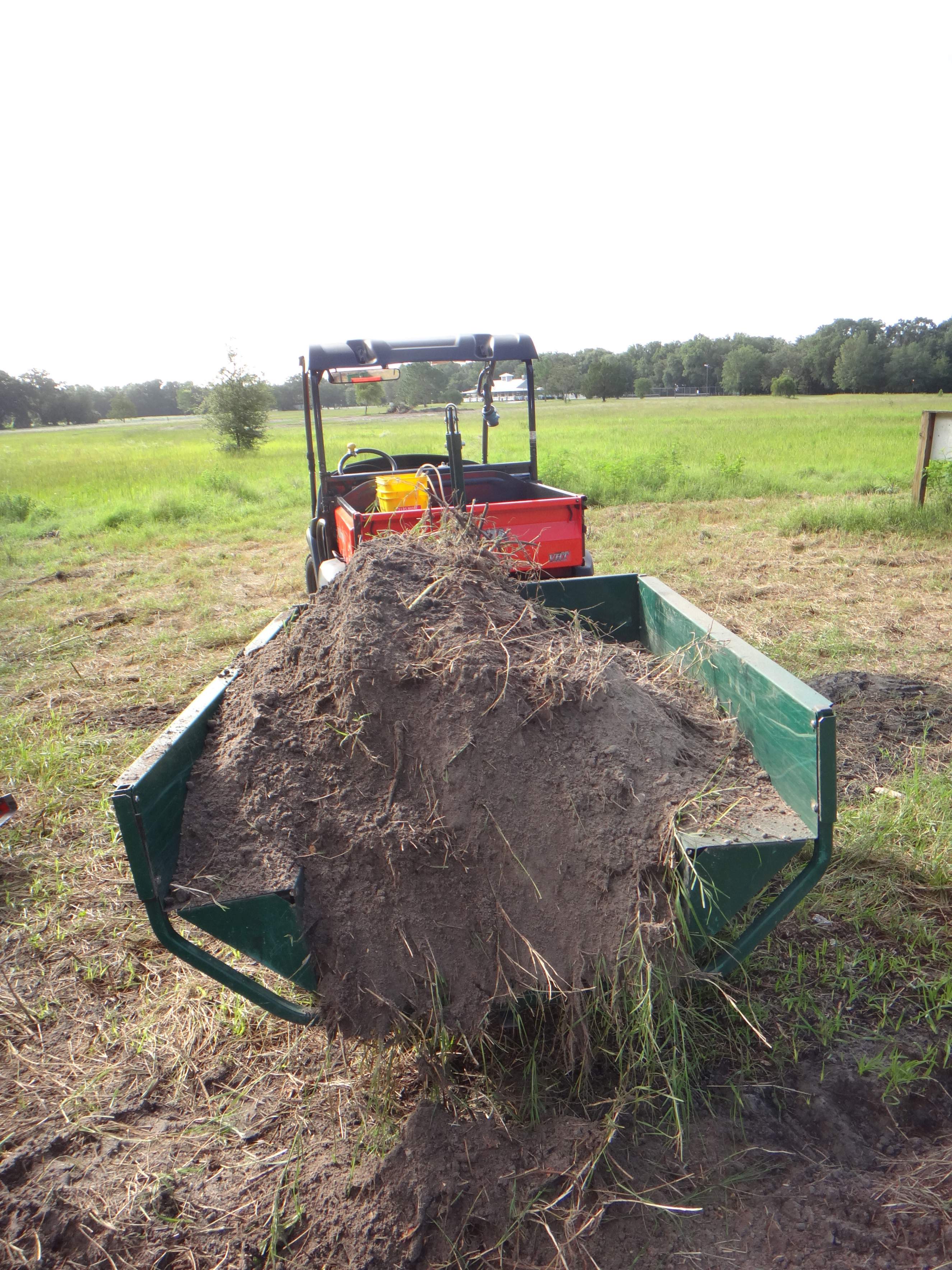

I have an older Canadian MUTS single axle trailer which I mostly pulled behind my Kubota RTV500 utility vehicle. As the load is carried low, between the wheels, the MUTS is very stable loaded. The current, larger MUTS two axle trailers would be good behind tractors. THE TILT/DUMP feature is wonderful and has worked faultlessly for me the last thirty months. Well worth the substantial freight to get the MUTS to Florida from Canada.
If you telephone MUTS you speak to Larry Edgar, the designer, in person.
LINK:
MUTS - Multi-Use Trailer System for your ATV, Quad and 4 Wheeler - Welcome
