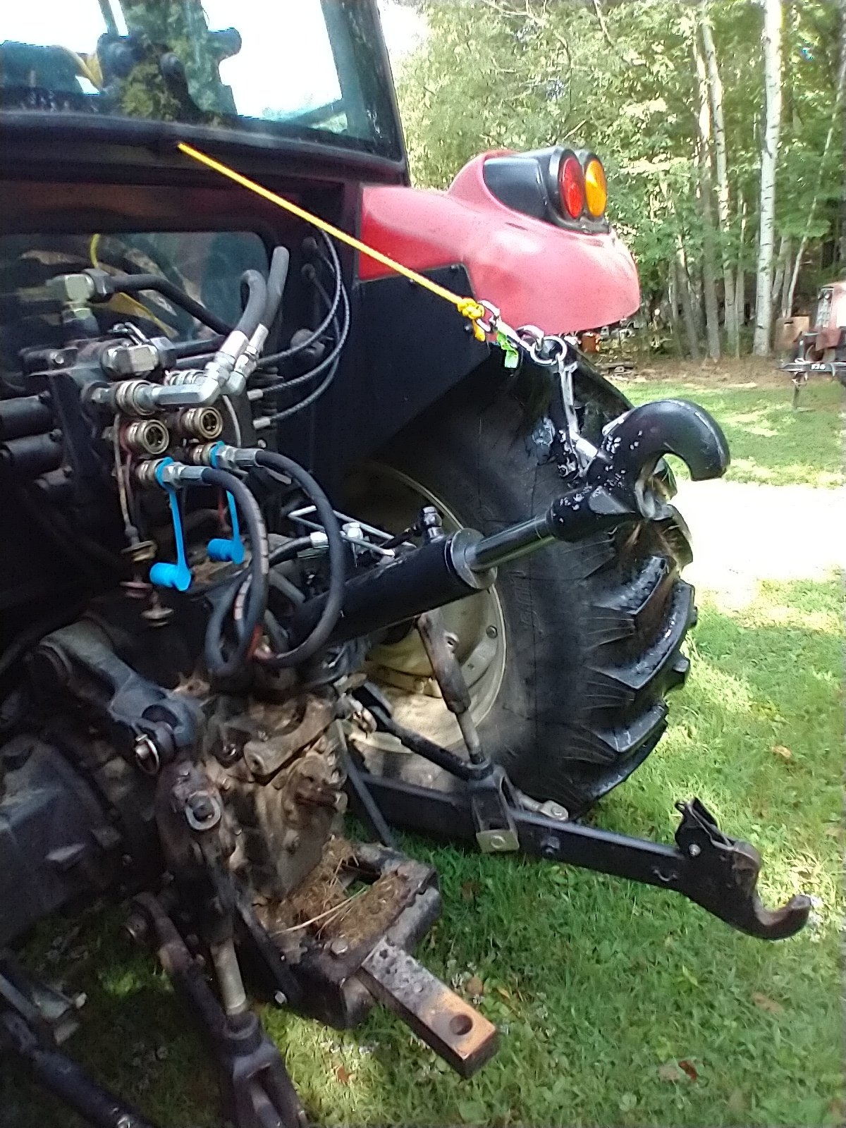

Got the better idea here: :D
quick and easy, back in lift to capture the lower pins, let the top link out drop into place lift and go.

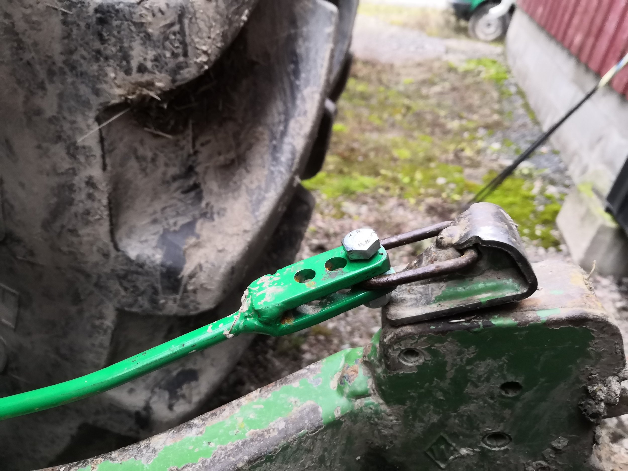

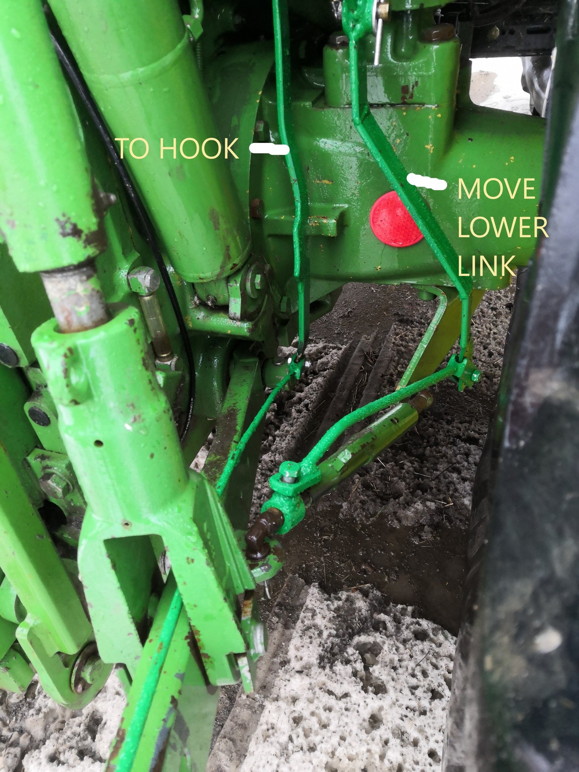

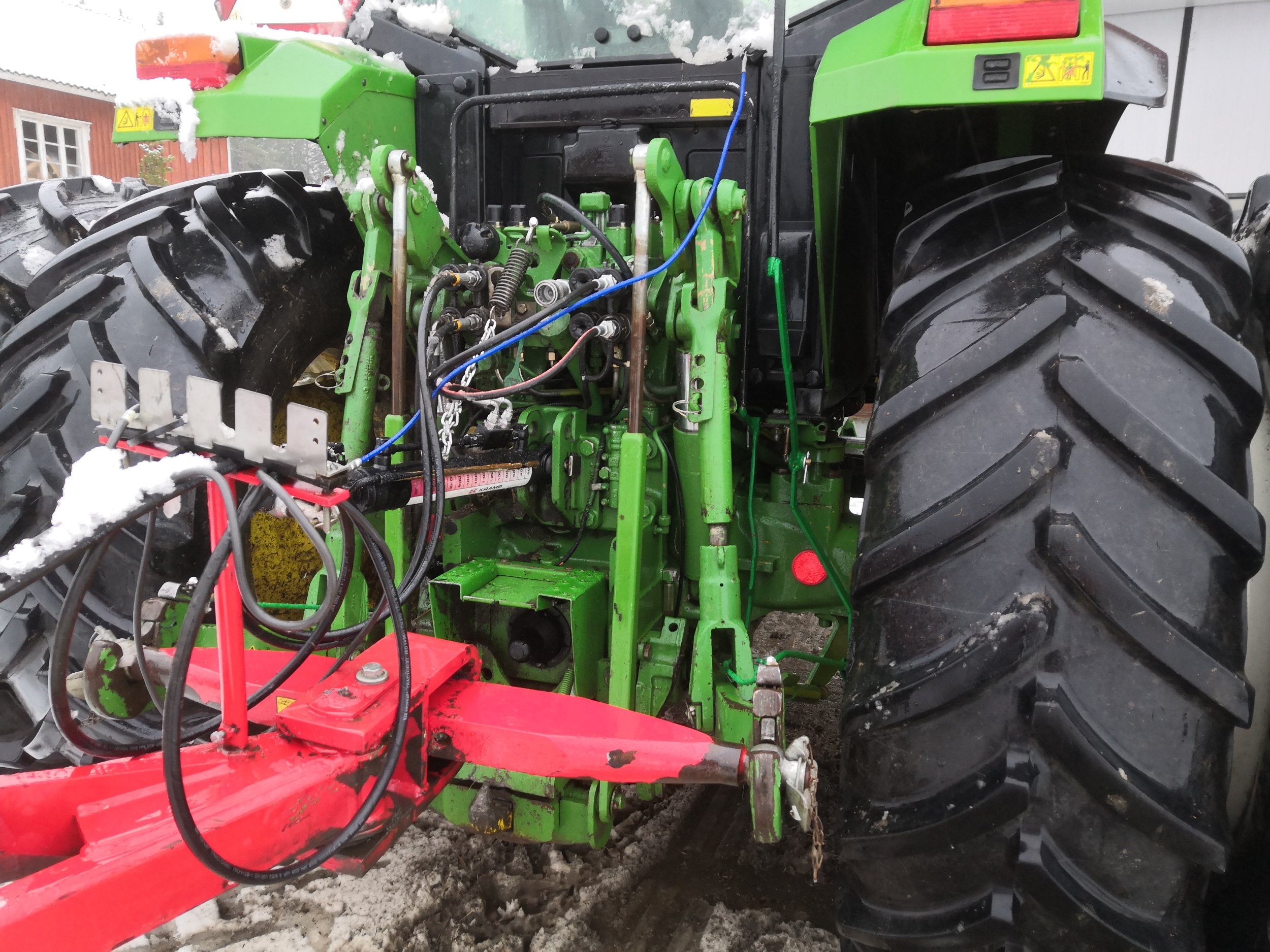

/ Mk Martin pull behind snowblower problems with quick hitch #8
Thank you LouNY. That is good idea
Lets make it better.
I made two rod links to the cabin from the lower hooks and a rope from the top link to the cabin.
The rope here very slippy.
Next rope car tow rope is much better with a spring inside keeping it upright.
Find the chain and other spring keeping the top link lightweight to use.
These ideas are suitable for small and big tractors and all cat 3-points and non standard attachments
Ask your tractor maker to give you EURO HOOKS
Here is one video of my works
