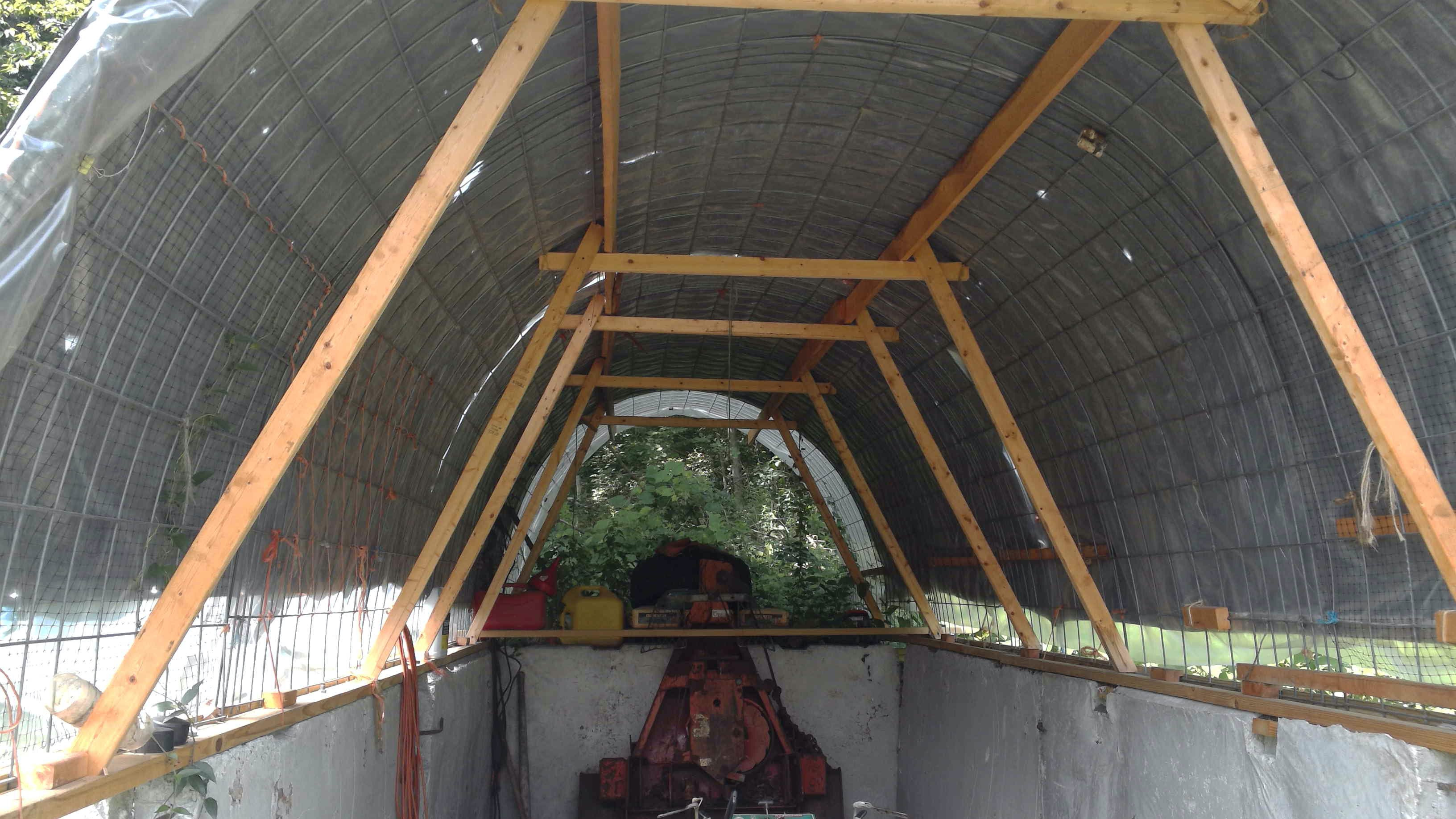

This is my most elaborate CPS, my tractor shed. with a slab and concrete knee walls built into a hillside, it's a little over kill ;)
for the animals I build them on a 4x8 platform and two cattle panels that I can pick up with forks CPS and all and move to new pasture. They make a nice leanto tool shed or dry hay storage also.
The framing prevents the arch from spreading and collapsing and transfers the load down to the knee wall.
If you don't have a knee wall, snow can build up against the CPS and push it in.

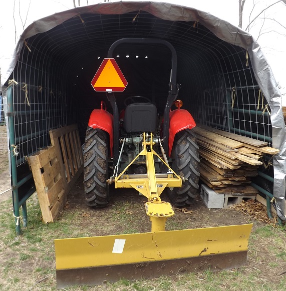

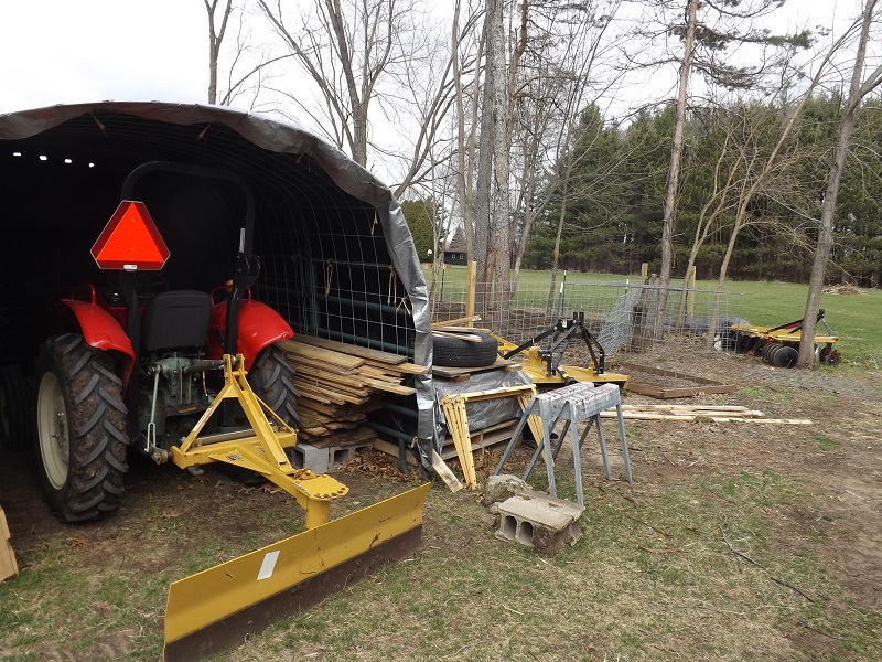

Well, My Yanmar got kicked out of the barn for hay storage. Hay needs to be dry she says, not the tractor. :confused2:
So, I rigged this up. Not as nice as SamSpade's. :p
A few coral panels, 3 cattle panels, 75 zip-ties, and 2 pool noodles to keep the tarp on the edges from ripping. Since the photos, I've upgrade it a little and she had me clean the yard some. :D
Tarps are from Harbor Freight with 20% off coupon or sales at Menards.
