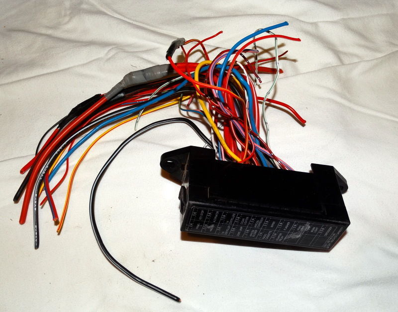

So I see there are 3 unused holes for mini fuses in my fuse box
on my BX25.
I want to add circuits utilizing these future holes.
Can someone clue me in as to exactly what kind of connector
I need to buy (and where*) and once I have it w/ a wire attached, how do
I install it, will I simply push it in from the back till it clicks in?
Also how to remove them?
Here are links to large format pics of the front and back of the fuse box.
Maybe it is a common box ?
FRONT PIC
REAR PIC
* I went to the parts area at Kubota's website and I will be
dipped in it if I can find a part number for the fuse box and
those connector ends. I dare ya to try to find a P/N for the
fuse box! The box "might" come w/ connectors. (?)

NOTE:
OK I figured out the P/N for the fuse box. K2581-63224
It is attached to the whole darn wire harness.
NOT Good for me.
BUT! I just bought THIS on Ebay. It looks like the same company
made this box. I am gambling the terminals are the same. If so
I can play w/ it and figure things out and have some ends to
splice into my box.

/ BX25 FUSE BOX Wire Connectors ???
Here is a picture of the fuse block I bought that is SIMILAR
to what I have on my BX25 davesi708. What is the AZ tool
needed to remove the pins from this fuse block and what
is the part number for the pins. ?

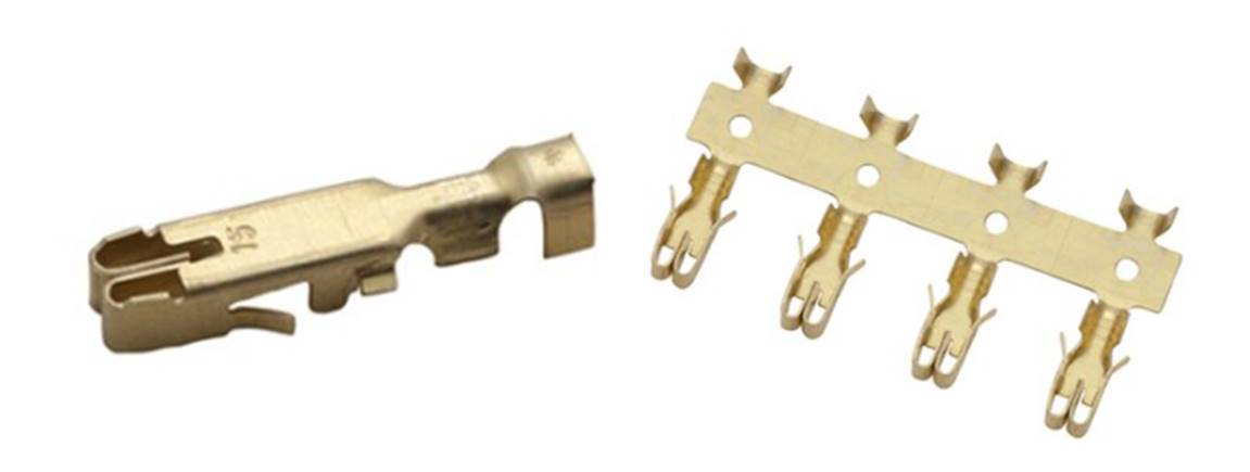

PS, I have NO DOUBT that some of the terminals are MULTI TERMINALS.
I can see one feed wire going in to both the 10A fuses but each
of the two outlet wires from each fuse has it's own wire.
Here is an example of a MULTI TERMINAL as I call them.
a 4-way Fuse Block Terminal they call this.
You only need one feed wire for this...well,
I believe you can use these multi terminals two ways.
You can feed it with one big wire or you can use it
on the outlet side and feed 4 small wires.
These come in 2- way, 3- way, 4- way etc.

OK, I received the donor fuse box I bought on EBAY.
The process to remove these lil buggers is simple, a tiny
flathead screwdriver will work nicely. More on that later.
Right now here is 3 views of the same terminal I pulled
out of the donor fuse box.
Granted, I could attach wires to these terminals I am removing
from the donor box and I just might do that but for those in
the future who can not get there hands on a donor fuse box
like I was lucky enough to find, here is a picture of what
I believe is needed. I am 99% sure on this, of course I
will need to plug a terminal into my fuse box to be 100% sure.
If anyone finds these terminals for sale before me please post up
where and a P/N please. There are 4 different terminals.
Small Medium Large and Triple

Here is how to release / remove the terminals.
They pull OUT from the back.
With lust a LITTLE bit of pull, pulling on the wire from behind
use a tiny flathead jewelers type screwdriver and simply push the
spring loaded tabs in the appropriate direction and they come out
with ease.
I the triple terminal, well I was able to apply a little bit of pull
from behind and I kept going from one to the next to the next and
all of a sudden it popped out.
Patience, if you break a tab you are toast.

I think I found them! At least they look very similar.
Fuse Block Terminals
Let me know if you think they will work.
#16
No Bueno moship,
What you found has little spikes that stick out that
hold the terminal in the fuse block. Here is another
picture and explaination as to how the Kubota
terminal works.

I found something VERY VERY CLOSE, if not it.
Looks like a Honda Fury motorcycle might have the
same terminals. This picture is in some guys forum
album at furyforums.com This looks like what I see so far.
Moship I am quit sure I will be able to use one of the pigtails
from the fuse box I scored on Ebay, now I want to ID the
terminal so others in the future will know what to get.
#19
THIS is VERY close
That sideways "D" shaped hole if where the tab in the fuse
block holds the terminal end.
