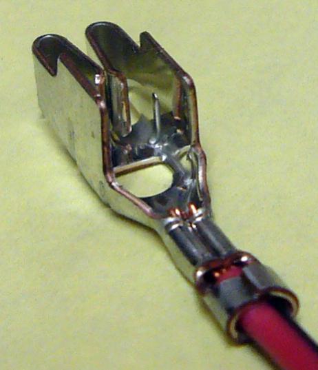

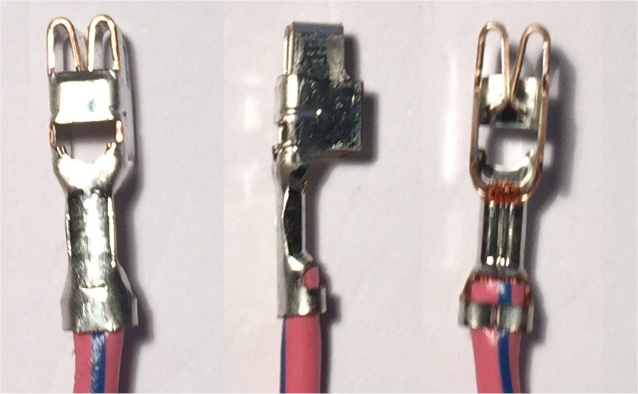

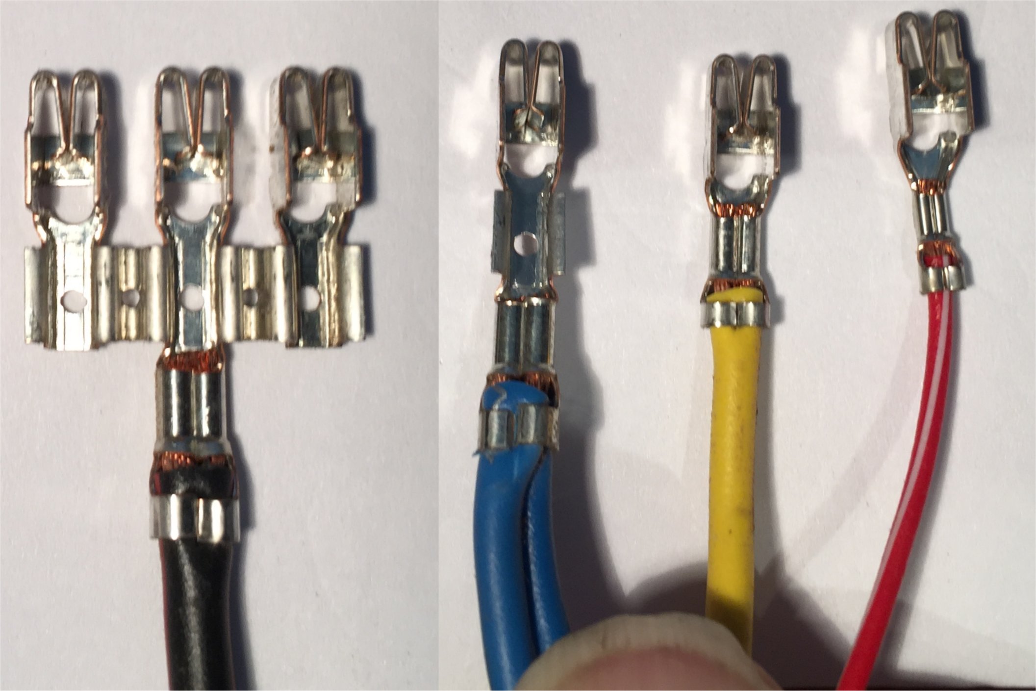

OK, I received the donor fuse box I bought on EBAY.
The process to remove these lil buggers is simple, a tiny
flathead screwdriver will work nicely. More on that later.
Right now here is 3 views of the same terminal I pulled
out of the donor fuse box.
Granted, I could attach wires to these terminals I am removing
from the donor box and I just might do that but for those in
the future who can not get there hands on a donor fuse box
like I was lucky enough to find, here is a picture of what
I believe is needed. I am 99% sure on this, of course I
will need to plug a terminal into my fuse box to be 100% sure.
If anyone finds these terminals for sale before me please post up
where and a P/N please. There are 4 different terminals.
Small Medium Large and Triple

#13

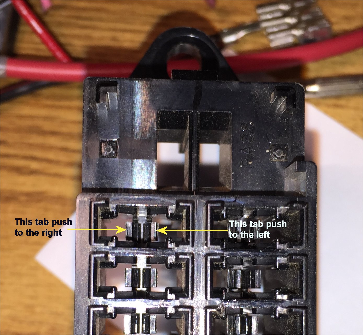

Here is how to release / remove the terminals.
They pull OUT from the back.
With lust a LITTLE bit of pull, pulling on the wire from behind
use a tiny flathead jewelers type screwdriver and simply push the
spring loaded tabs in the appropriate direction and they come out
with ease.
I the triple terminal, well I was able to apply a little bit of pull
from behind and I kept going from one to the next to the next and
all of a sudden it popped out.
Patience, if you break a tab you are toast.

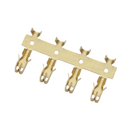

   / BX25 FUSE BOX Wire Connectors ??? #15
I think I found them! At least they look very similar.
Fuse Block Terminals
Let me know if you think they will work.
#16
No Bueno moship,
What you found has little spikes that stick out that
hold the terminal in the fuse block. Here is another
picture and explaination as to how the Kubota
terminal works.

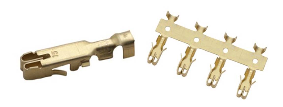

I found something VERY VERY CLOSE, if not it.
Looks like a Honda Fury motorcycle might have the
same terminals. This picture is in some guys forum
album at furyforums.com This looks like what I see so far.
Moship I am quit sure I will be able to use one of the pigtails
from the fuse box I scored on Ebay, now I want to ID the
terminal so others in the future will know what to get.

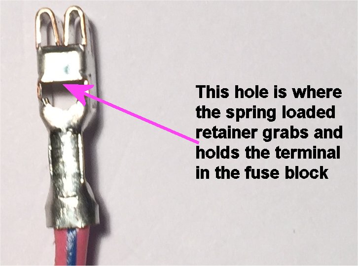

#19
THIS is VERY close
That sideways "D" shaped hole if where the tab in the fuse
block holds the terminal end.

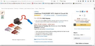

   / BX25 FUSE BOX Wire Connectors ??? #20

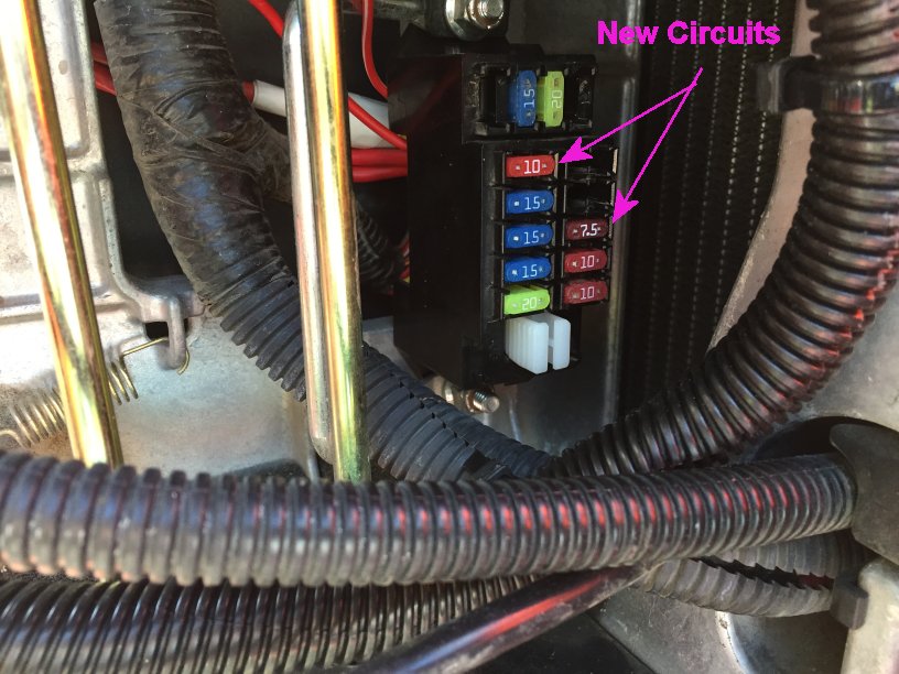

So I get what you are trying to do. You will have a neat installation, but couldn't you have done a quick and easy thing like this?
