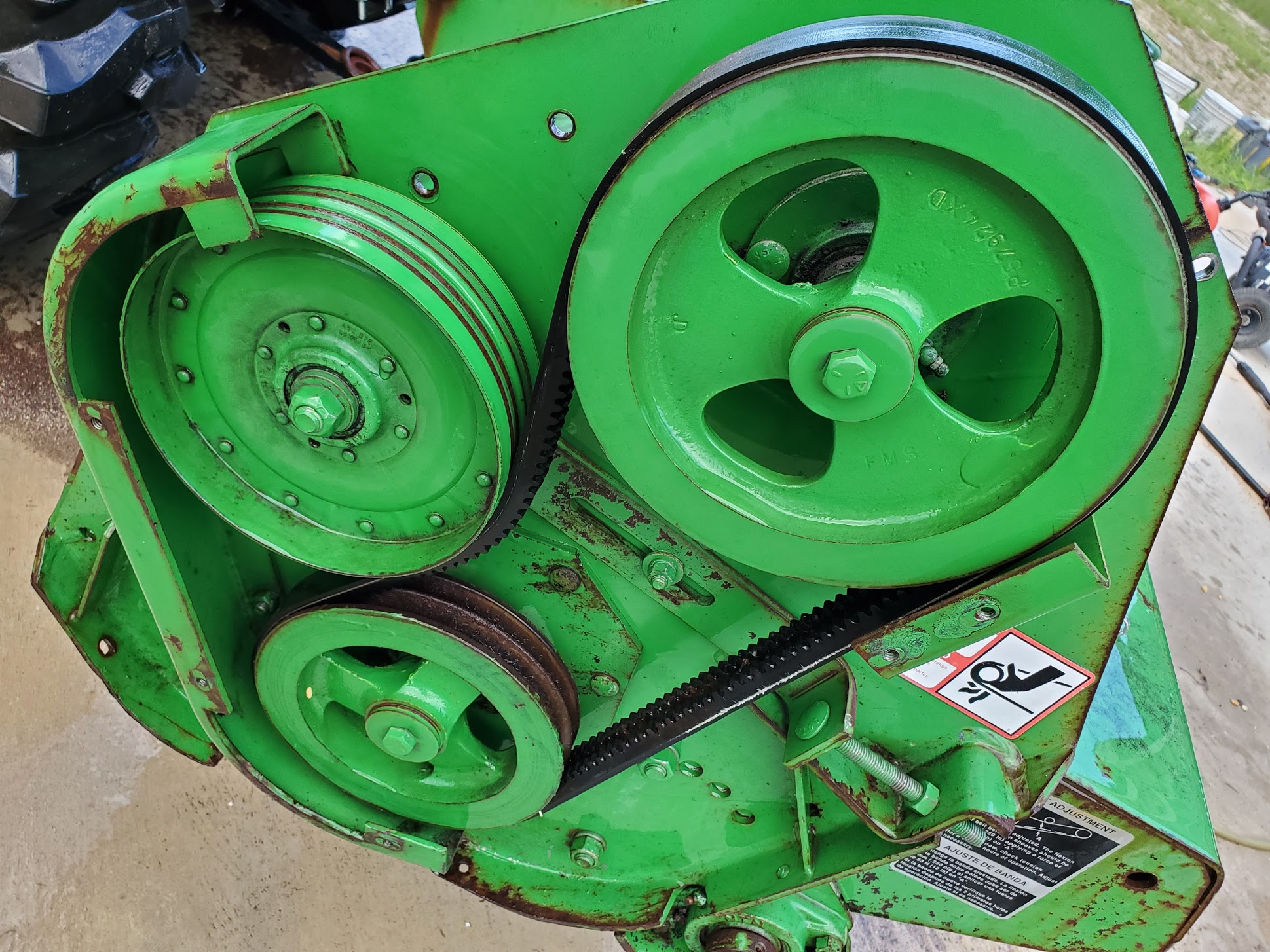

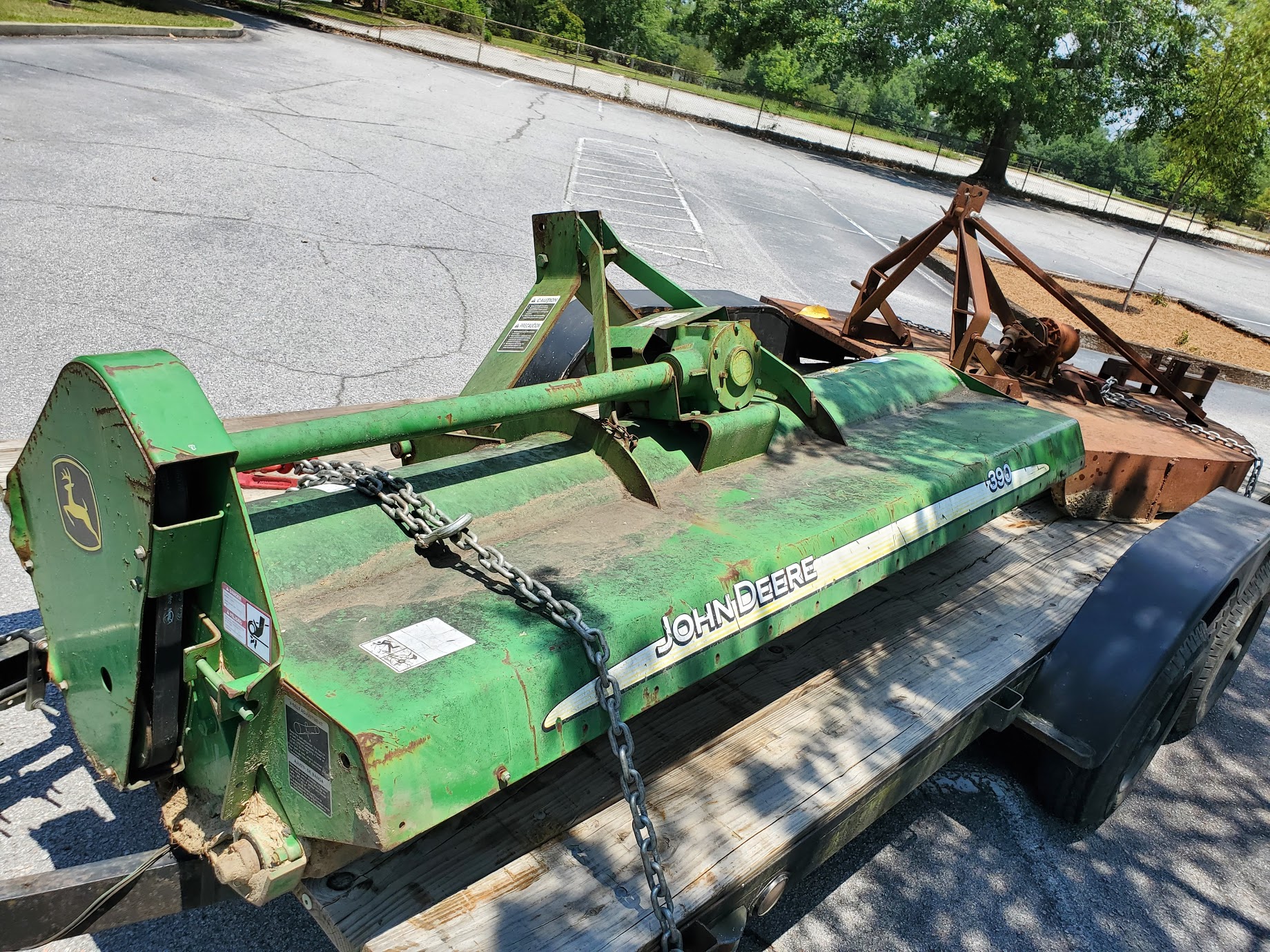

Here is a pic of my JD 390 behind a JD 4105,,,
The tractor will pick it up, but that is about it,,
any grass over about a foot tall will take 110% of the HP that the JD has,,,
in other words,, the JD does not have enough power to mow with the 390,,,
I pull the 390 with a 60HP tractor,, grass over 3 feet tall can give that tractor fits,,
The 390 is a LOT of mower,,,

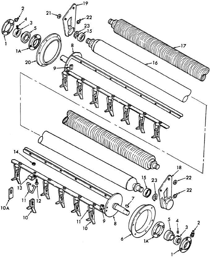

I'm going to go look at the equipment tomorrow. As of right now I'm thinking that I'll pick up the 390 and see how it goes. If the tractor can't handle it or I'm not happy with the speed I can pull it, I'll just go back and get the smaller Ford unit. I'll try to get better pictures while I'm there. What specifically do I need to be checking and what would you need pictures of to verify if the arms for the roller on the Ford are present?
   / Buying used flail mower (JD or Ford) #16
Pripyat, they are numbers 18 and 19 in this picture.

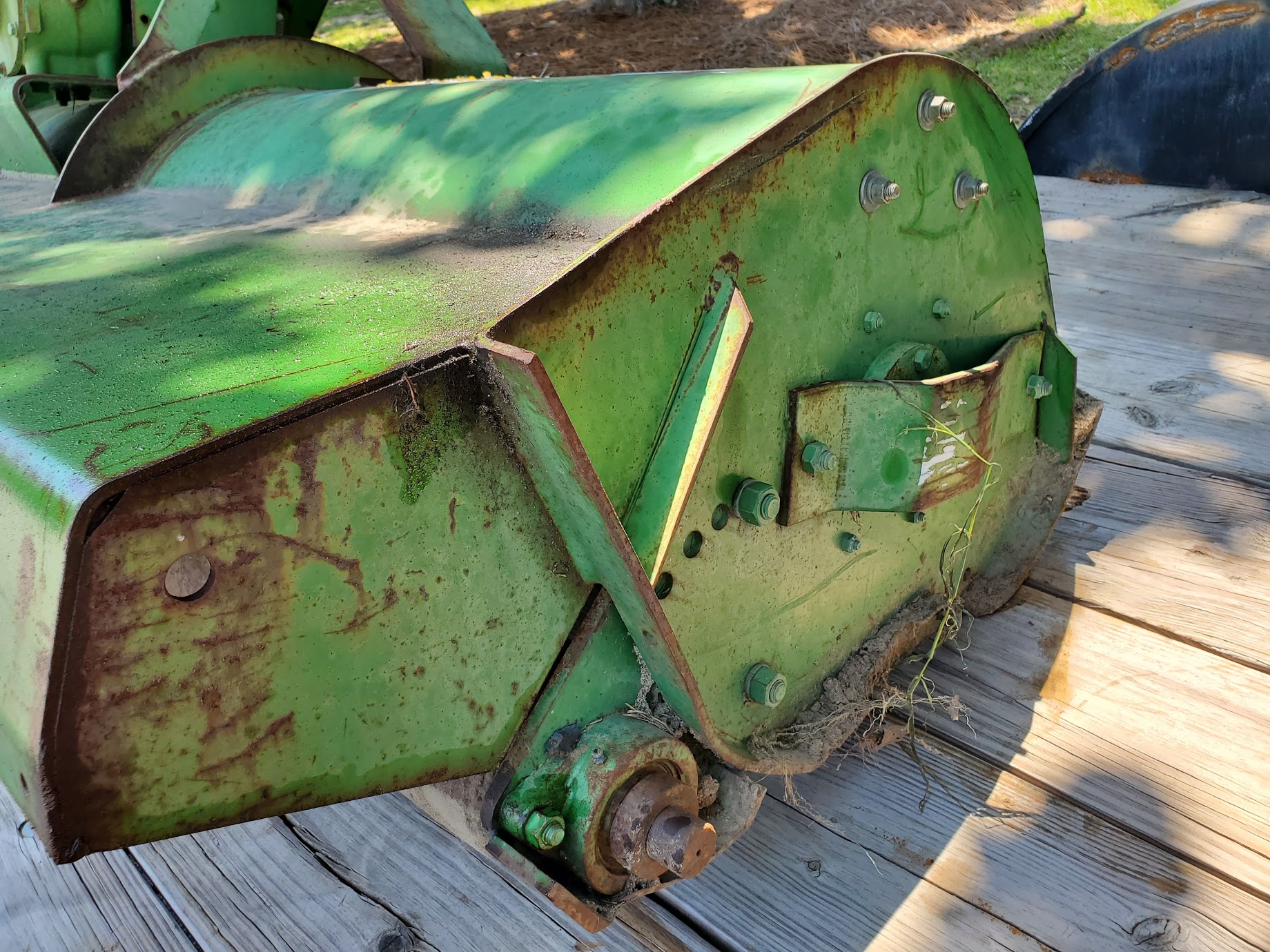

So I went and looked at the mowers today. The guy had all sorts of stuff. I did verify that the Ford does indeed have the bearing mount arms and the roller is not bent. I ended up getting the JD and a 6ft bush hog with 70hp gearbox for $1K even. The bush hog needs a wheel but I've got a 6ft frame with a bad gearbox that will solve that. I haven't messed with the bush hog yet but I did mess with the flail..
One of the bearings on the height roller wouldn't take grease, it had apparently hardened. I pulled the zerk fitting and cleaned it out, dug out what hardened crap I could get and put it back together. It took grease the second time, I guess I'll keep adding grease until I feel like I have flushed all the crud out.

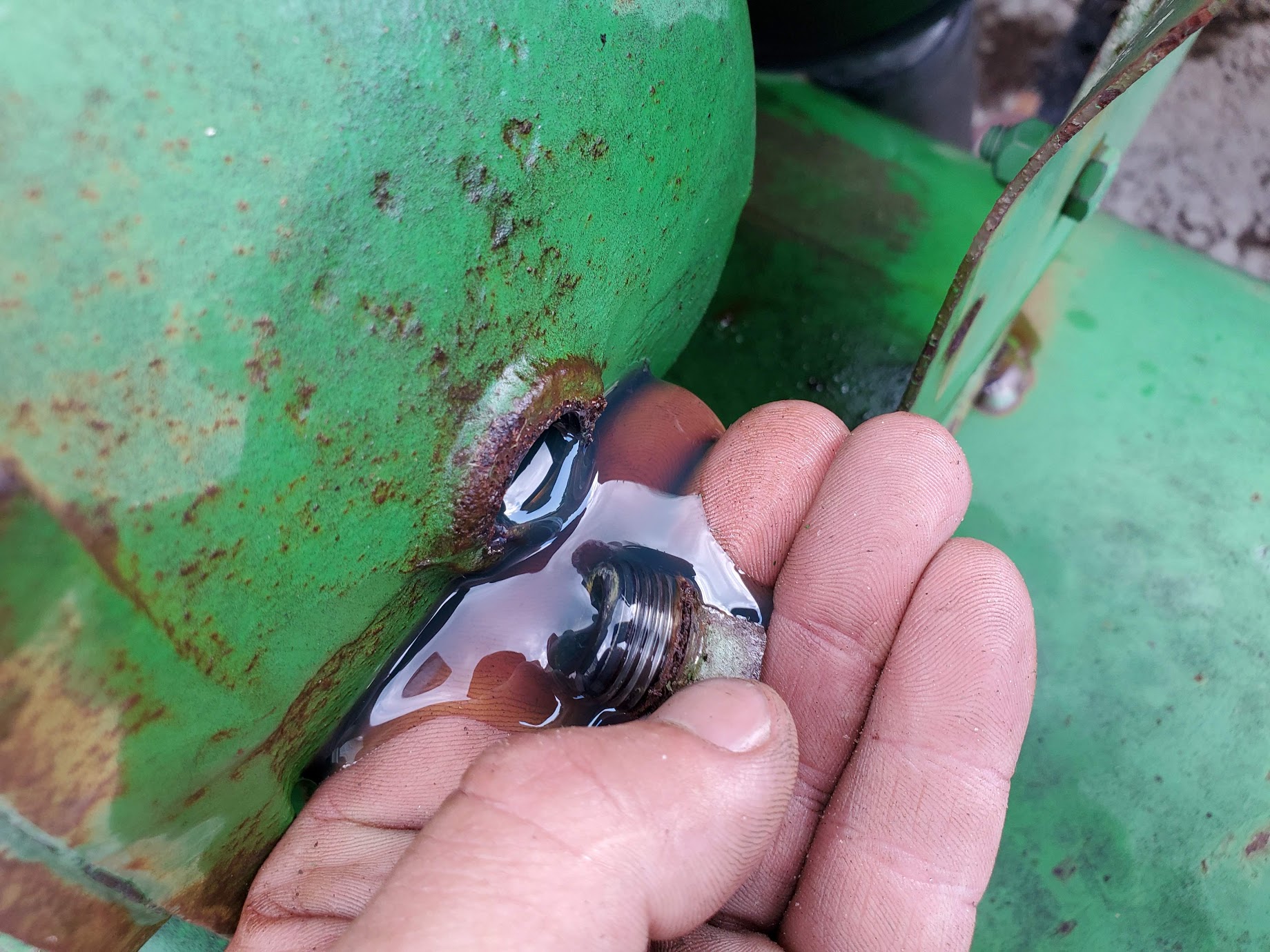

Planning to change the gear oil once I figure out how to drain it? Granted, the oil looked pretty good.
There are 4 bolt holes for the roller height. If 1 were the closest cut and 4 was the tallest cut, I put it in hole 3 to test with. It left a lot of bent-over brush.
I dropped it to the lowest cut and.. wow. It is impressive. This thing is going to save me SO much time.. I was having to go over the thick stuff twice with the 5' bush hog to get a cut that isn't even comparable to what I'm getting with the flail in a single pass. I'm running in M-4 which according to my speed diagram comes to 6.5kmph or 4.0mph. I was manically laughing at one point.. :laughing:

Check the gear oil for clarity now that you run it ,,
if the 390 had been sitting for a year or more,, the dirt will settle out, making the oil look clean.
Actually, back, maybe around the 1920's or 1930's, a farm technique was to use engine oil, drain it, and let it settle,, then use the clean oil off the top again.
there is even some kind of tank that helps with the settling,, I saw one in an antique store in PA,, a few years back.
"detergent" engine oil keeps dirt in suspension longer, so it can be filtered, and / or drained,,
but, even that oil will let the dirt settle out after a couple years,,

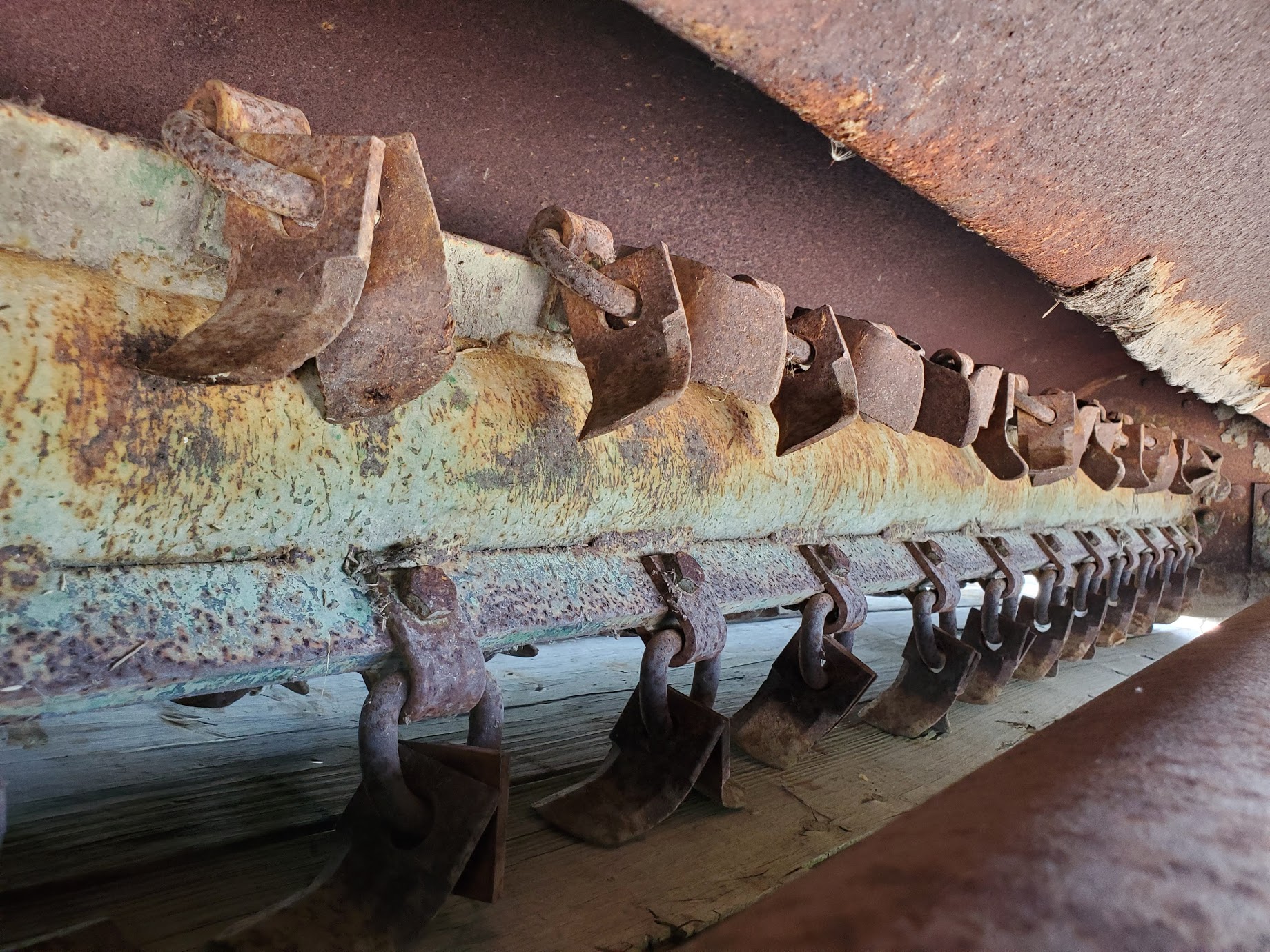

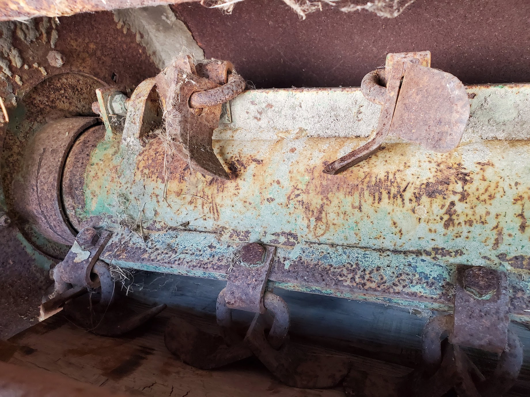

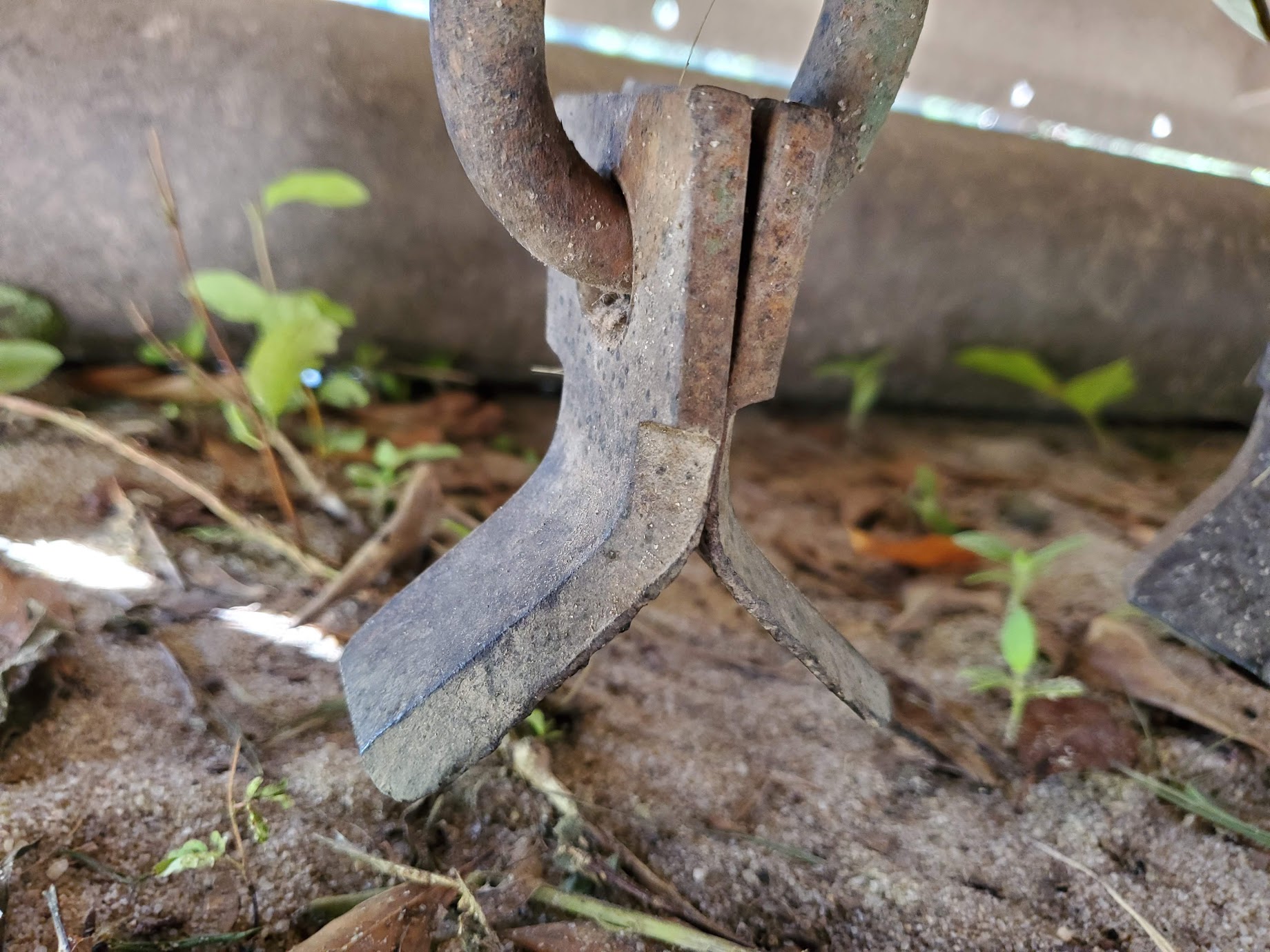

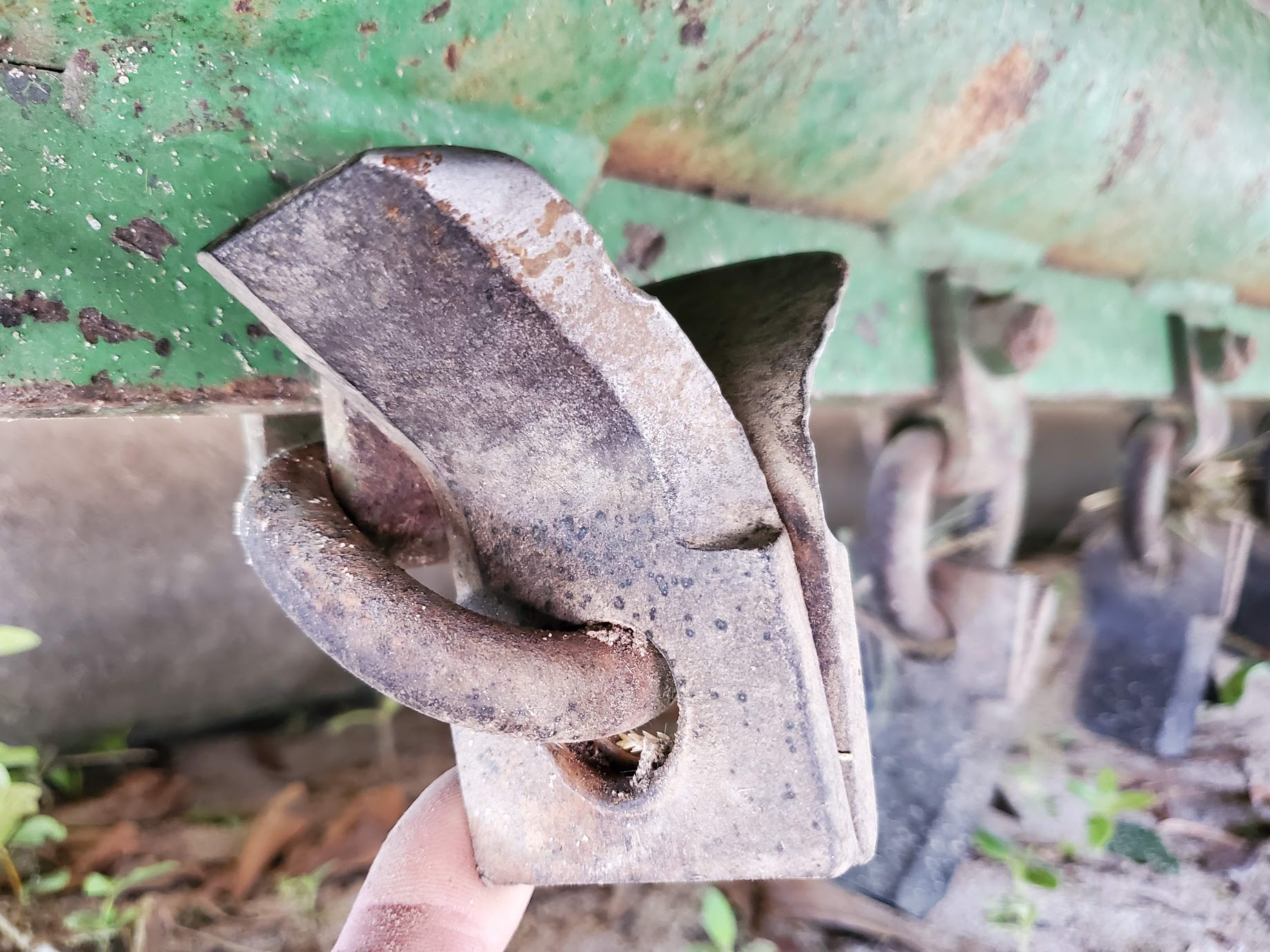

You need to invest in some new side slicer knives unless all your going to is what you showed us in the video.
   / Buying used flail mower (JD or Ford) #20
Welcome to the world of flail mowers! Looks like you got yourself a nice mower, enjoy! Nice to buy a used implement that you can hook up and go right work with without totally rebuilding. My old employer used to buy old equipment all the time thinking we could bring it home and put it in the field the next day...
Why...? Looked like maybe a couple bent ones in the first picture but those are hardly worn at all. Need to put it to work and wear them out first.
