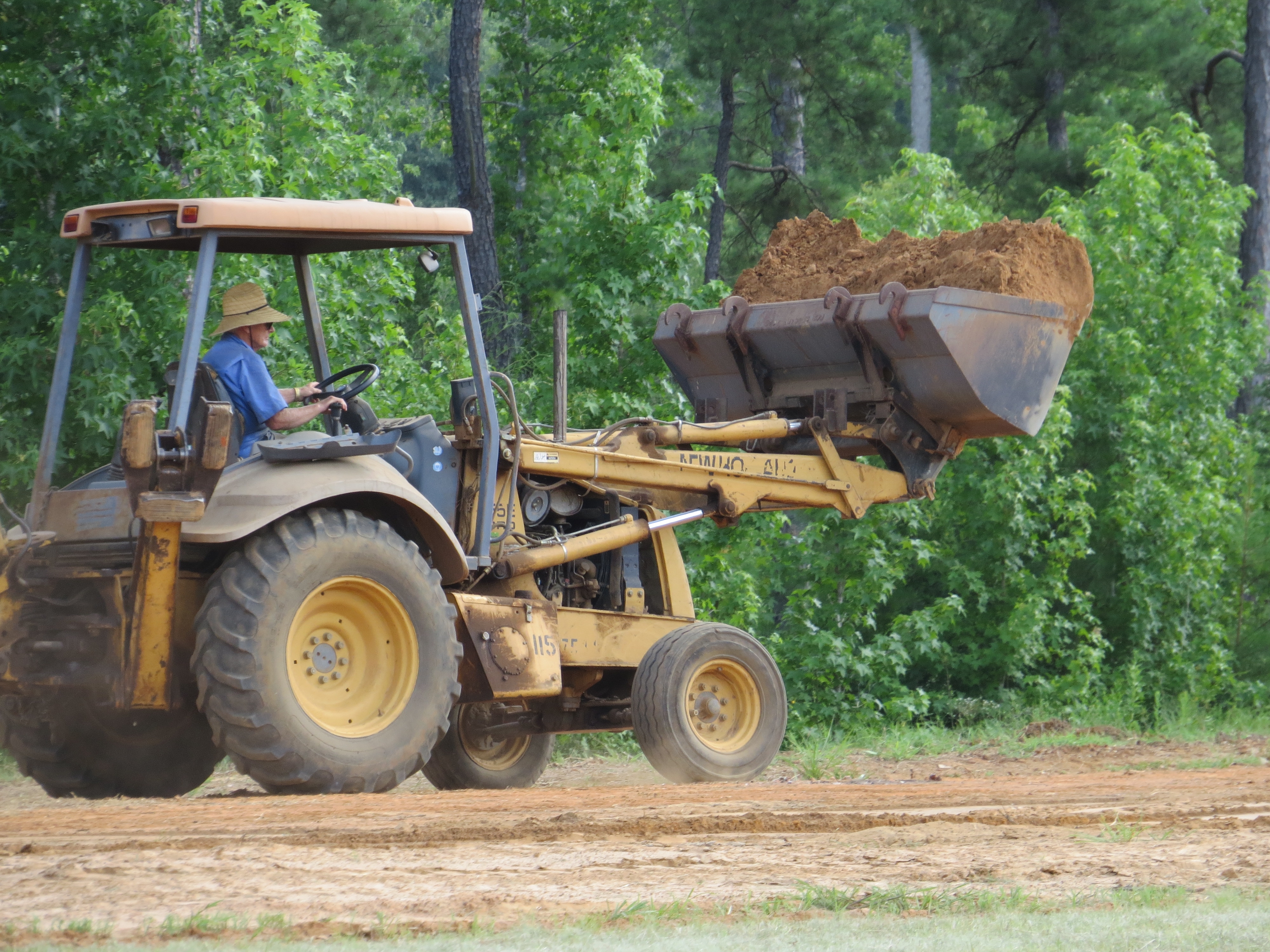

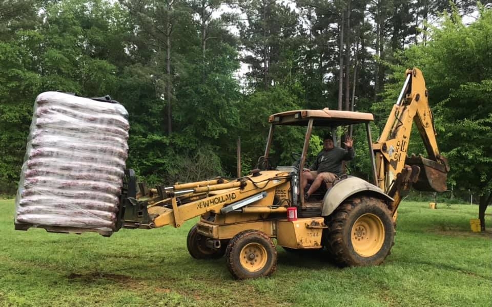

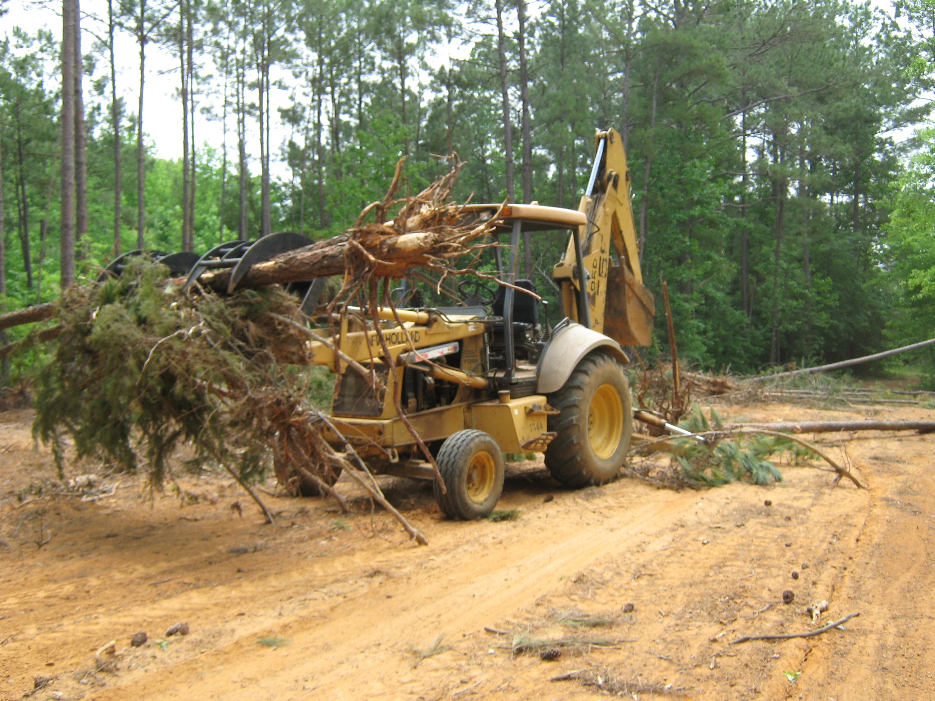

I welded on a Quick Attach plate to my bucket and had created the attachment for it on my loader. I can switch my backhoe front bucket to pallet forks, hay spear or grapple in just a few minutes. It really was life changing to be able to dig up a tree with the hoe, cut it into 20 foot lengths, and then pick up each log and carry it to the burn pile!!!
Something else to mention is how much stronger the loader is on a backhoe than a farm tractor. I can lift 6,000 pounds with it and carry a full yard of dirt.

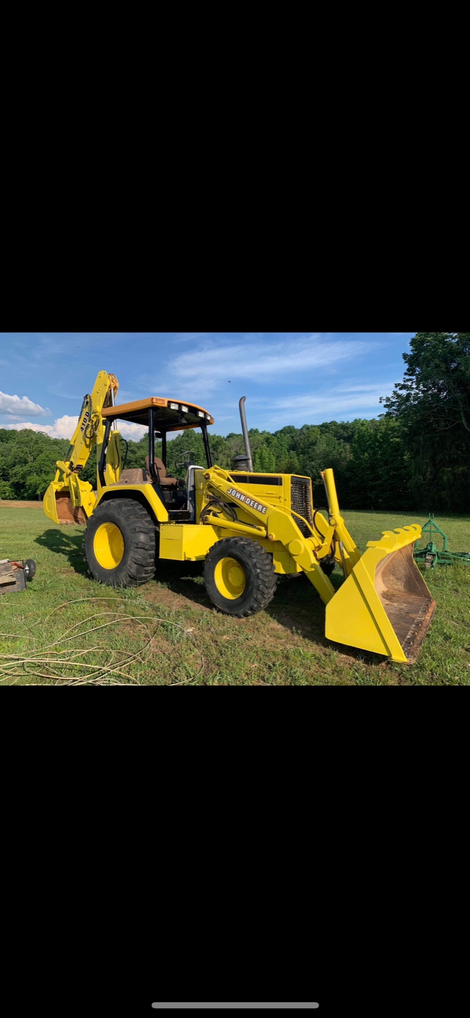

Gotta agree with all those who buy old commercial backhoes. They last forever and parts are cheap. Old style pre-emission machnes, almost unbreakable & easily maintained. There are a lot of them out there and just no buyer market for them at all - particularly the older open station ones. So they just sit.
My buddy bought his old JD310 for $9000 ten years ago, put tires on it, built two ponds, and still uses it today. BTW, new sharp tires are the secret to using a 2wd backhoe in the mud & snow.
I know of two more locally that cost under $15K each... and one is 4wd. They will all lift and carry close to 3 tons in the bucket.
Our own old JD310 has a mere 6500 hours. Probably good for thousands more. It mostly just sits now that the big digging chores are done, but it's a keeper.
For anyone who is a wanna be homesteader, consider an old commercial backhoe. Either a JD or Case.
Start looking by asking around at small town municipal or school district maintenance shops.
