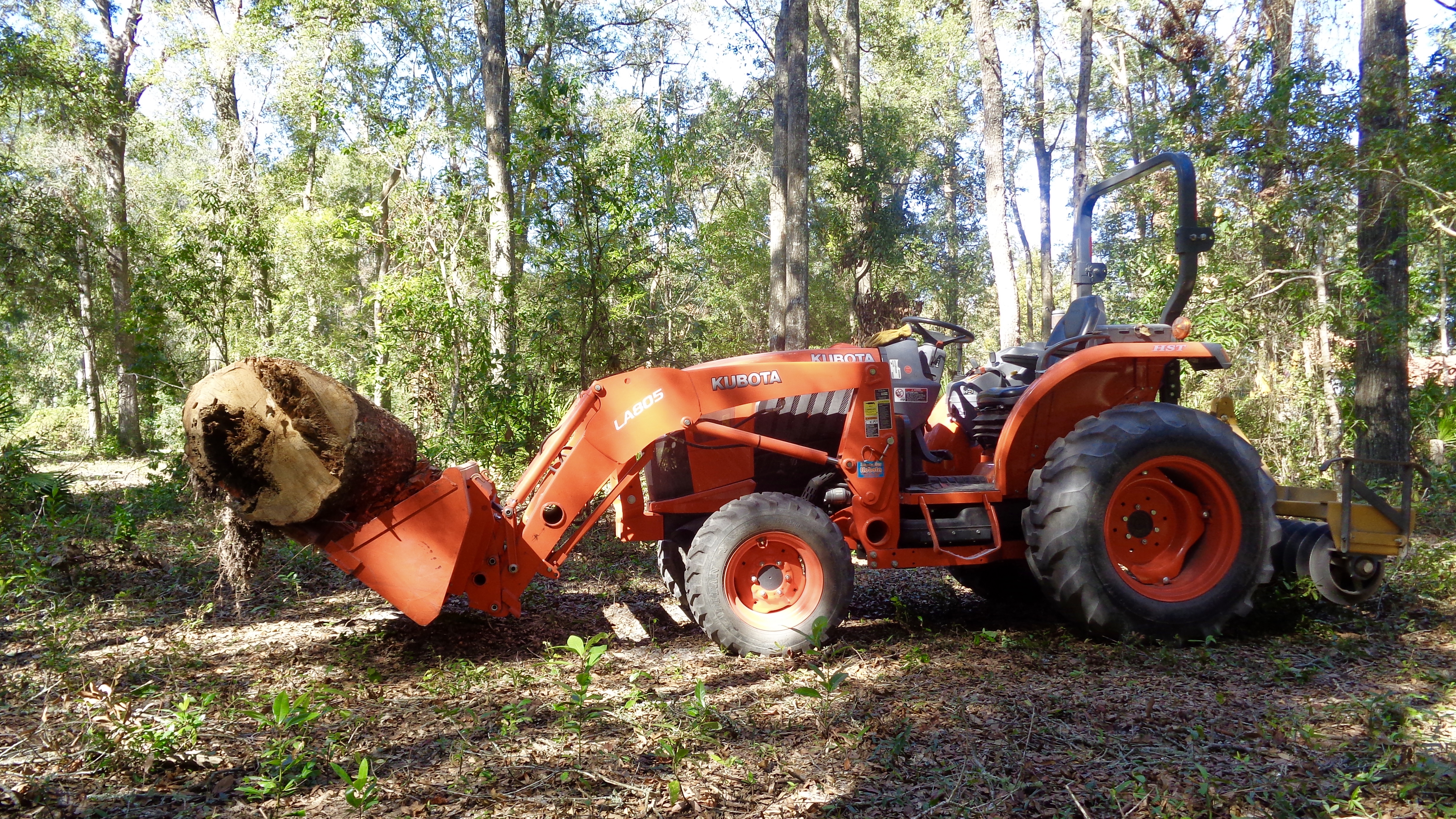

Good advice from experienced contributors. All tractor alternatives suggested have REAR ENGINES and four equal size wheels.
You can use a FRONT ENGINE tractor for loading pallets but not only do you need a 4,500 - 5,500 pound bare weight tractor, you need considerable Loader counterbalance on the Three Point Hitch to make FEL lifts safely. Loader + tractor + implement counterbalance makes a long combination which may limit warehouse access.
Lifting and transporting heavy loads with a tractor-loader is a primary cause of tractor rollovers. Jarred maple syrup likely fragile if the tractor shifts abruptly.
Small front wheels and large rear wheels provide tractor pulling power but make tractors inherently unstable.
I'm looking for a loader with direct attach pallet forks, not forks which attach to a bucket.
The nomenclature for direct attach FEL forks is SKID STEER QUICK ATTACH (SSQA) pallet forks, an industry standard for tractors and skid steers.
KUBOTA 'MX' LINK: https://www.kubotausa.com/docs/default-source/brochure-sheets/mx5800.pdf?sfvrsn=1c71be0c_4
