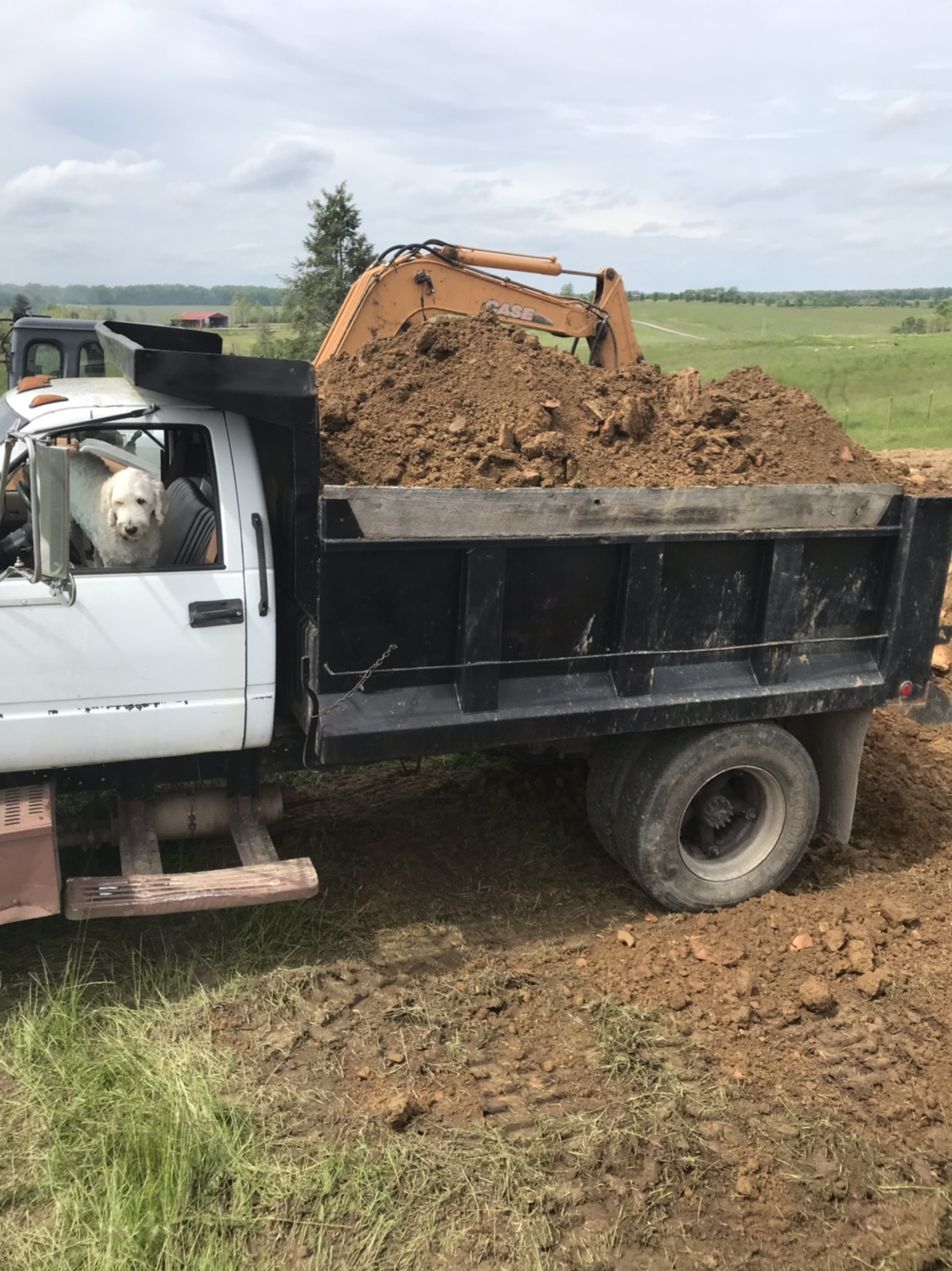

About 10 yards. My mini excavator and CTL will make my M59 look silly with one operator. If you’ve got 2 people it’s even better yet. The BIG downside to the CTL and mini is you have to have both of them.

I love the picture of your truck "driver"

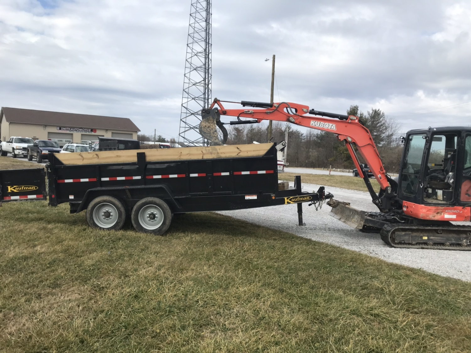

I wasn’t a fan of a mini x for a long time and if I could only have one machine it wouldn’t be a mini x. But a mini x is amazingly more productive than even a good backhoe. That mini will out perform my M59 by double. And the truck driver loves going to work. If everyone went to work with the same enthusiasm he did the country would be in a lot better place than it is now.

View attachment 707864 I wasn’t a fan of a mini x for a long time and if I could only have one machine it wouldn’t be a mini x. But a mini x is amazingly more productive than even a good backhoe. That mini will out perform my M59 by double. And the truck driver loves going to work. If everyone went to work with the same enthusiasm he did the country would be in a lot better place than it is now.
