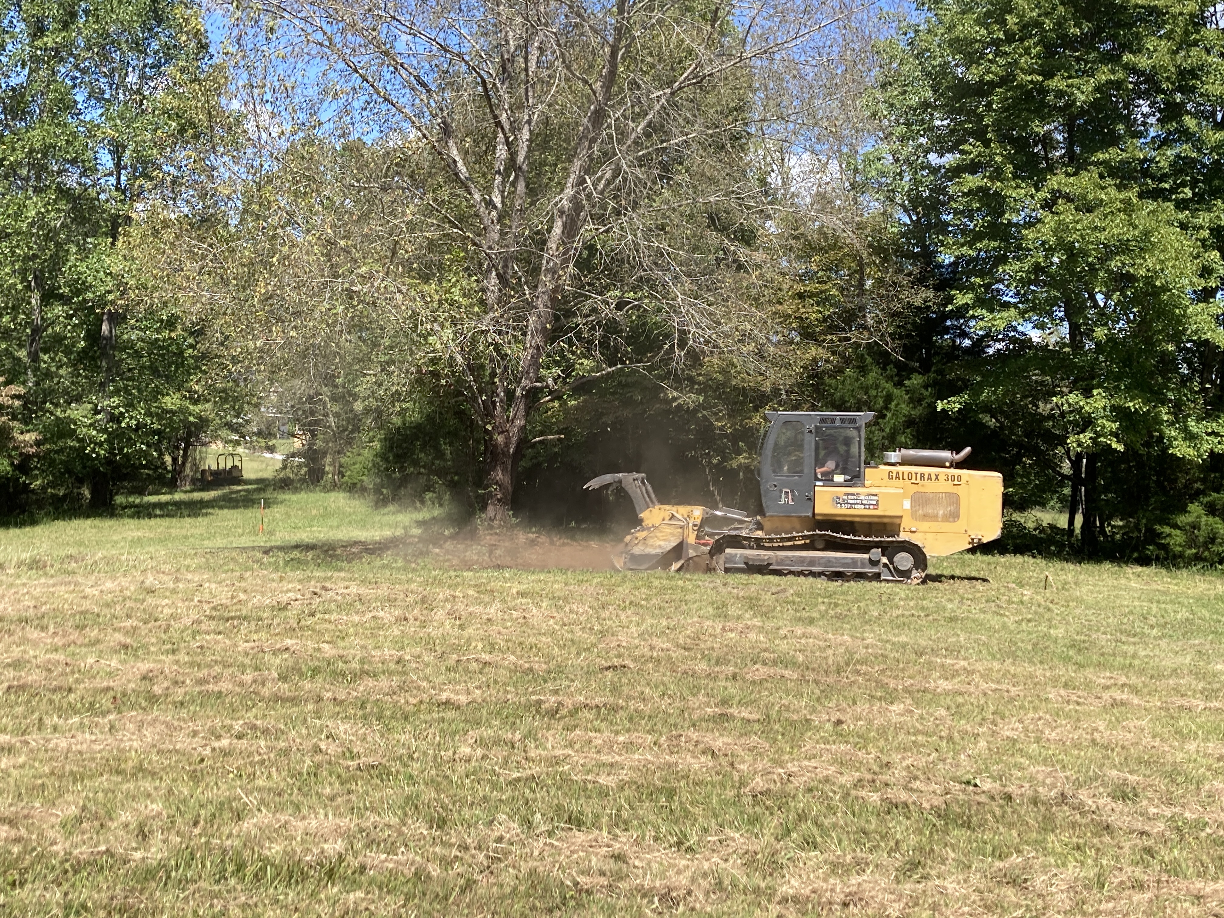

For moving the big logs, a grapple is best, but pallet forks will work OK. To use the bucket, you will need to buck it down to logs.
The advice above is good, too. A land clearing business with a forestry mulcher can do wonders. They can 'eat' pretty big trees and the mulch lays down a nice barrier.
/ Buying advice #25

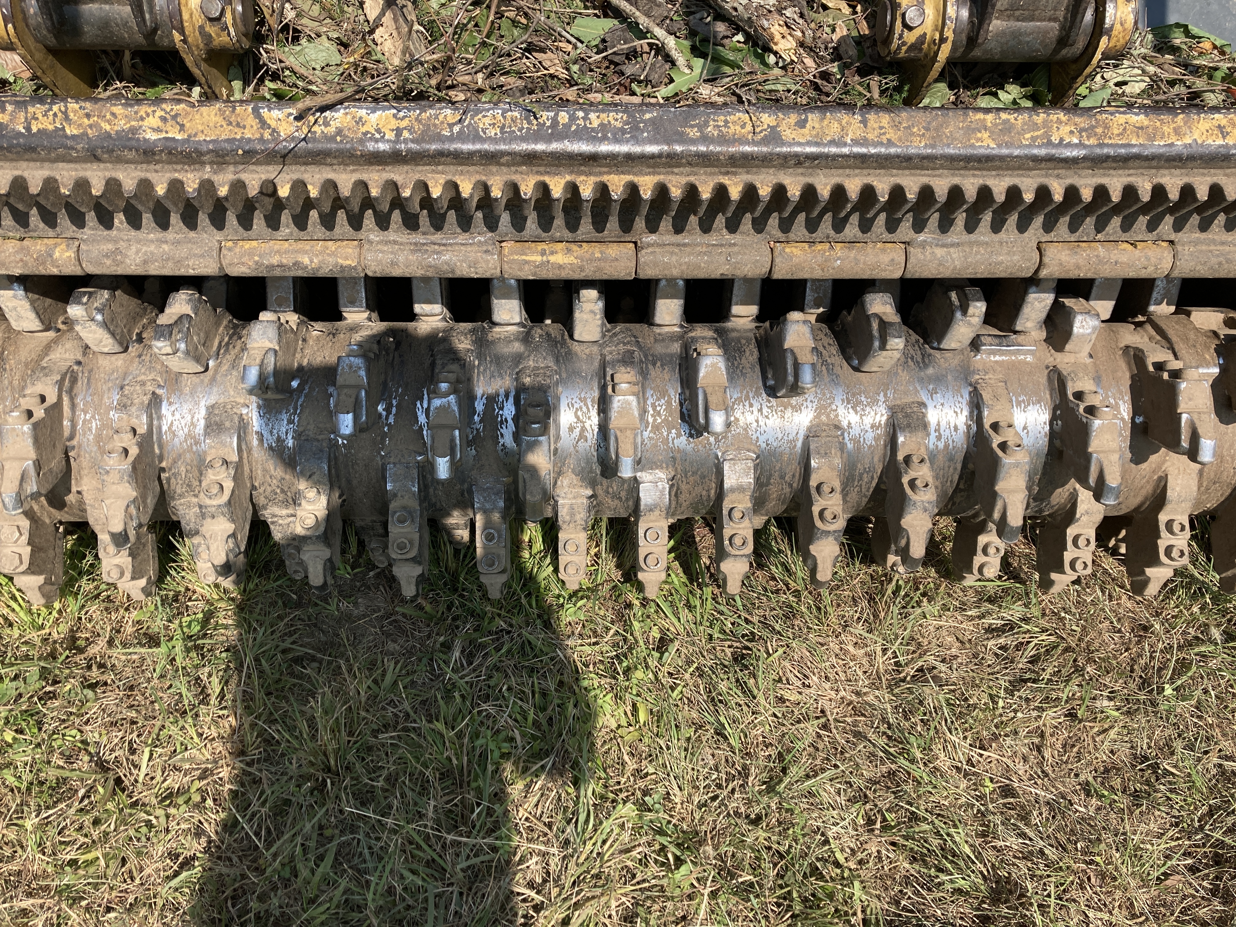

Depending on the size of the mulcher, the practical limit for grinding a tree seems to be about 8" or so. If you have a lot of large trees, might just need a dozer. Chipping branches is still a lot of work feeding the chipper even if you rent a large chipper. A forestry mulcher can save you a lot of time and work with better overall results so you can get on with your project.
Our mulchers ground bigger trees than that, but left larger debris. Mulcher on a skid steer I think does a better job grinding things small and does less damage to the trees being kept/worked around. We had two of these big guys work about three acres for us.
