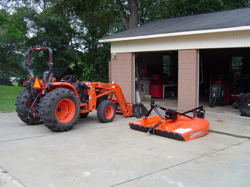

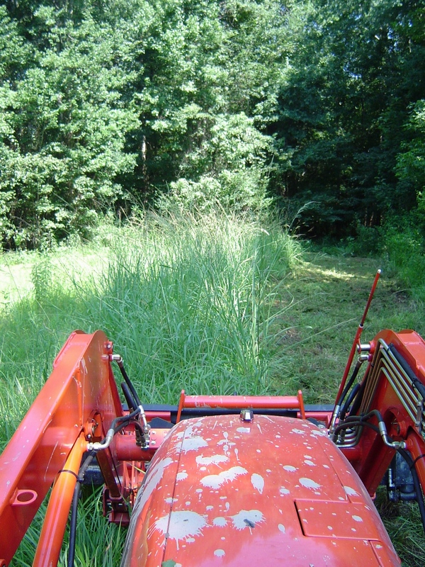

I researched around on cutters, also. I have a Kubota L3830. I am not sure what the weight limitations are on your tractor's 3 pt. lift, but that is something you need to consider also.
I bought a Squealer 172 recently and like it. I weighs near 800 lbs. I have cut 2" stuff with it without problem. Have to go slow and keep the RPMs up. But, mostly 1" roadside type of stuff. Now, I am not an expert, nor a professional, but I am very satisified with it. I got the slip clutch and paid $1450. I had to wait a month for it to come in, since none were in stock. Too bad we all don't live closer to try each other's stuff out before buying...
The larger heavier duty models weigh a lot more, and require more horsepower to operate. And are more expensive. For most use, I think the medium duty is just fine. Woods or Rhino are good, too. But I haven't used them to compare. Best as I can remember, they were a little more pricier but weighed about the same.
