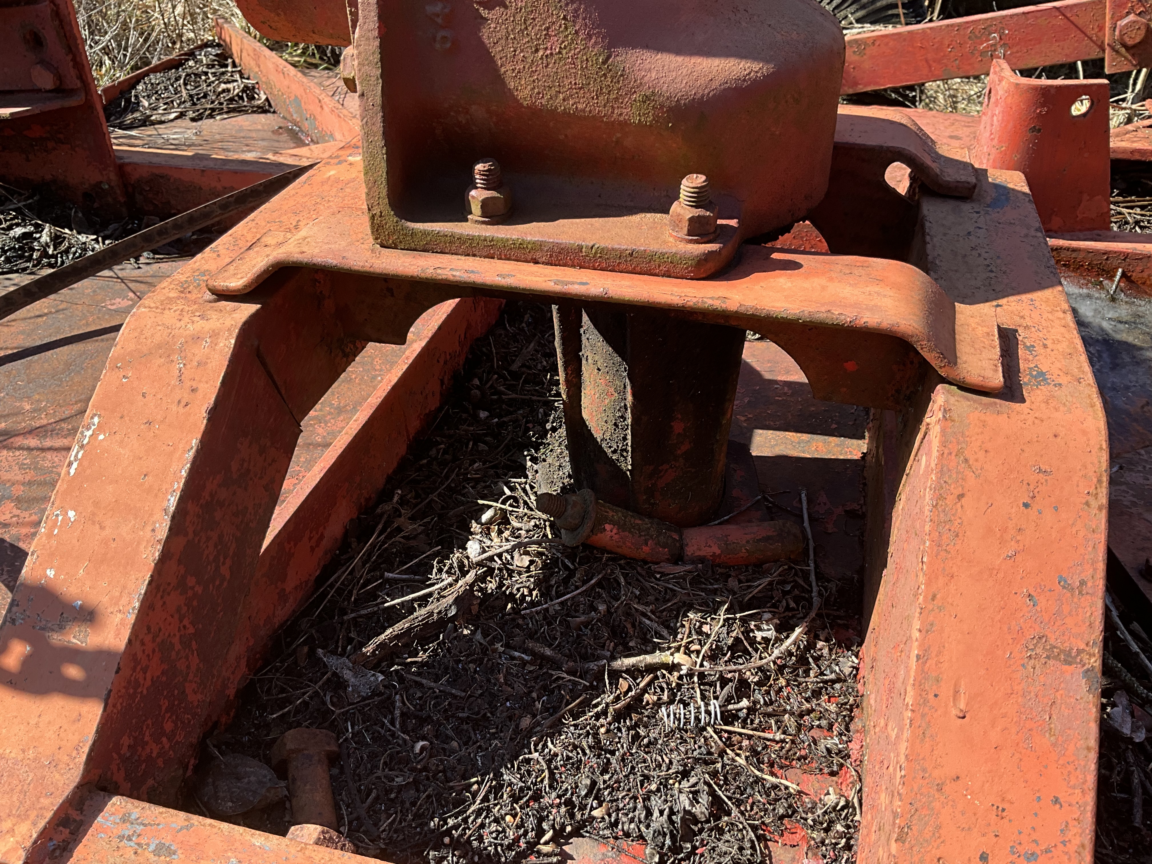

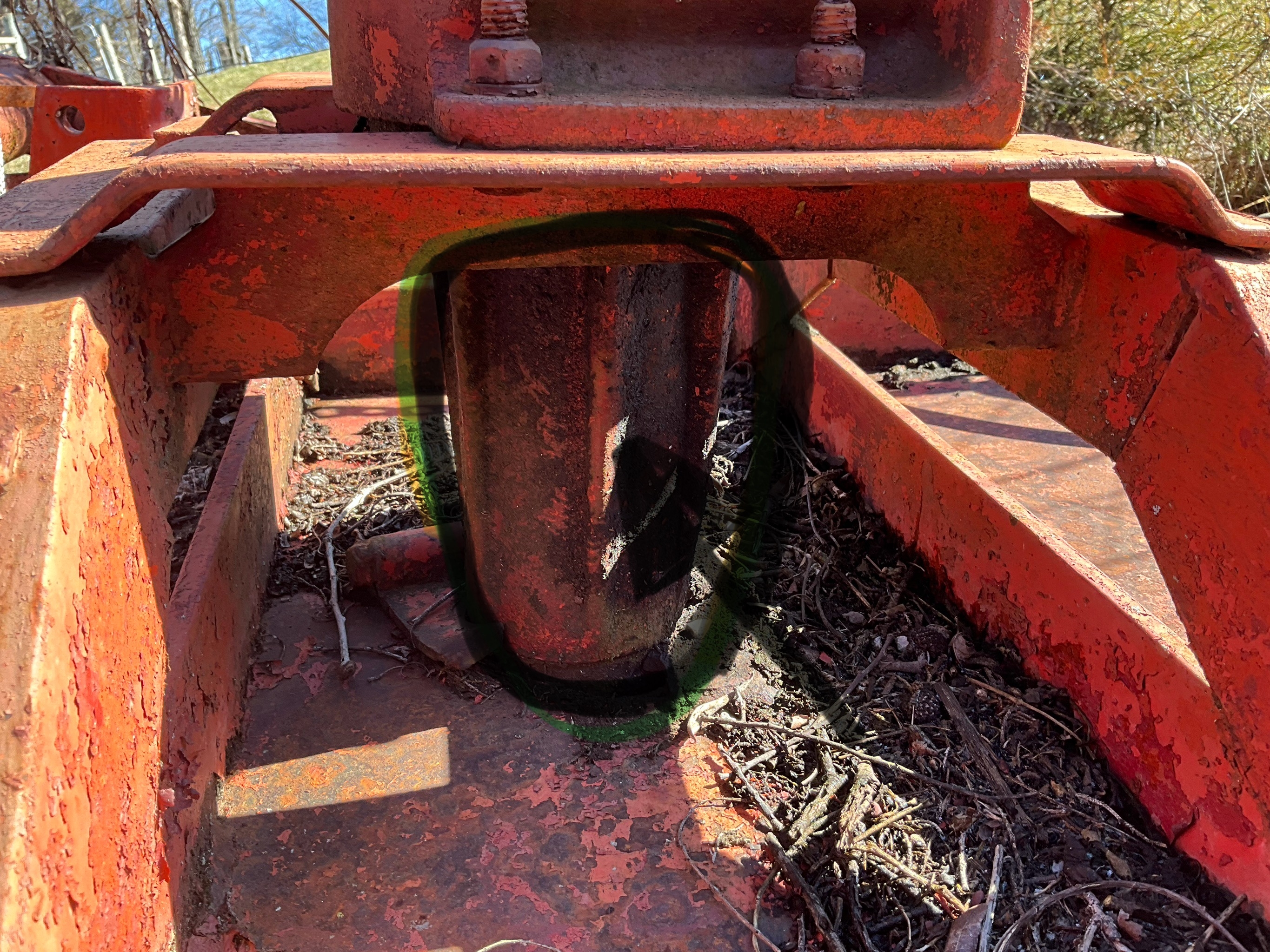

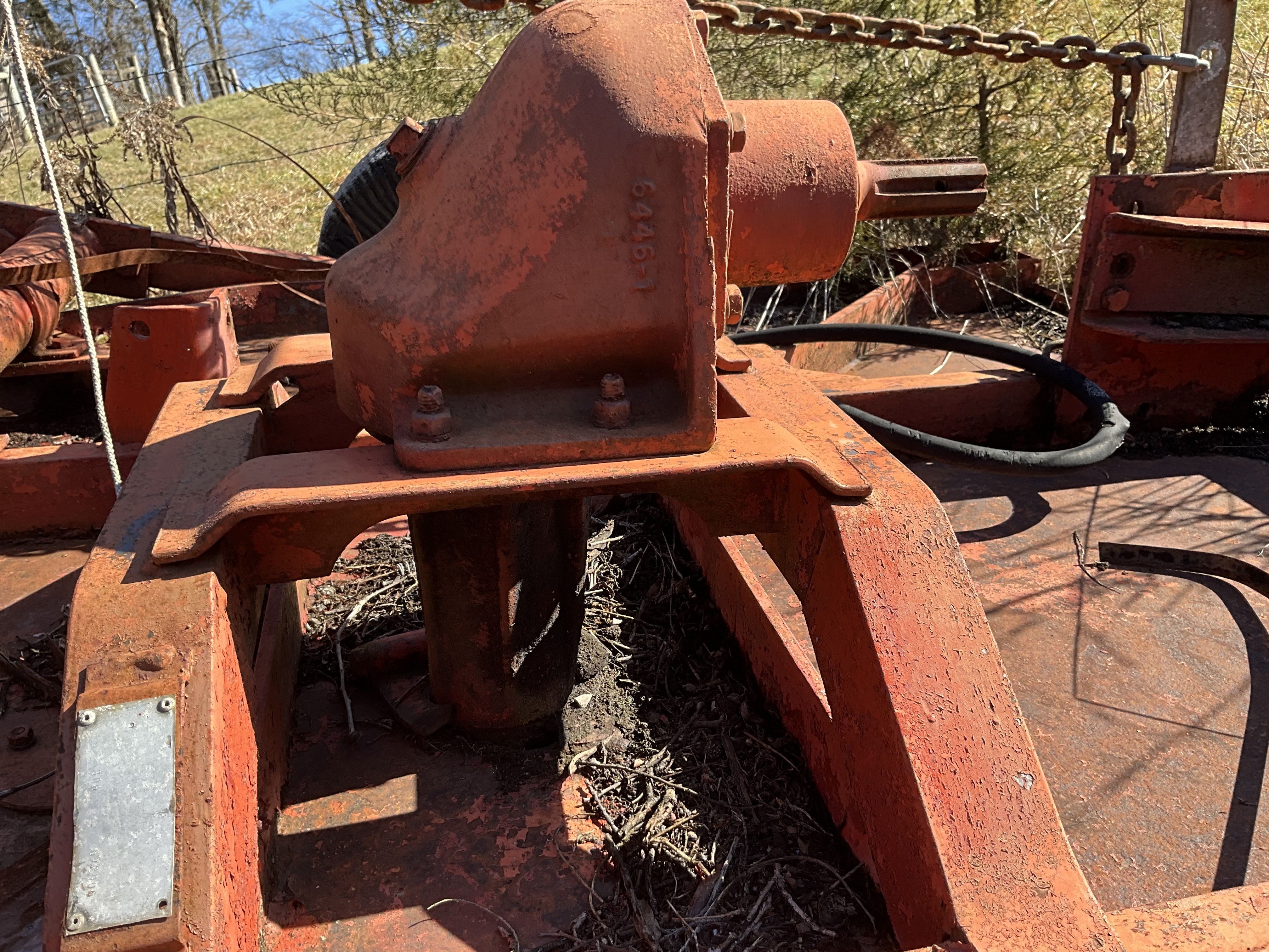

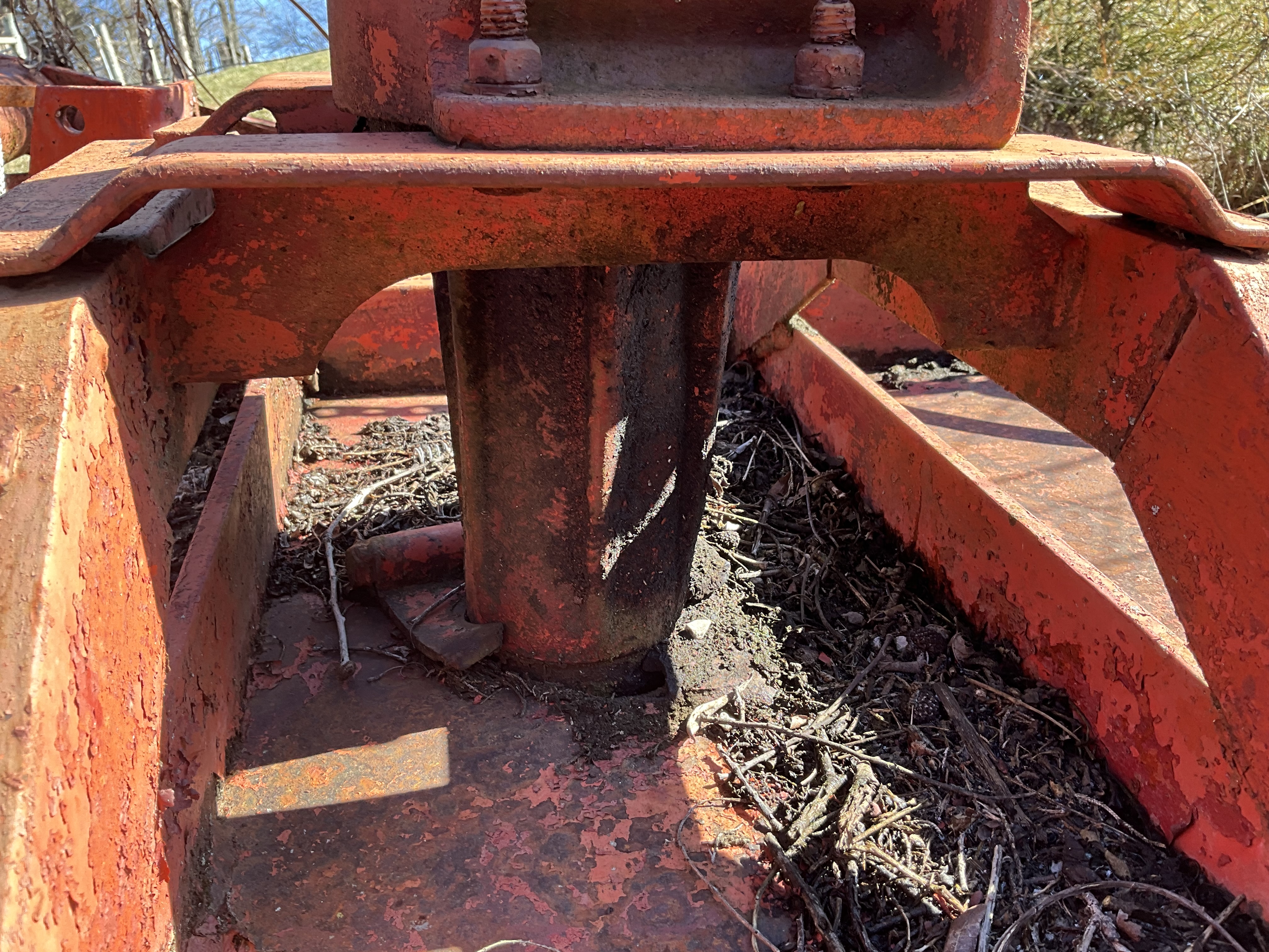

Have an old Bush Hog Model 12 rotary cutter that I’m looking for a part I’m unable to find. The gear box is ok but attached to the gear box is a part that supports the shaft and bearing that extends from the gear box and is the mounting bracket that holds the 2 cutter blades. I’ve been searching for a replacement or part number for this part without any luck. This bracket looks to be 10-12” long. I’ve included pictures showing the location and the part as it is still mounted to the bush hog. Any help to better identify and where I might get replacement parts would be greatly appreciated. Thanks Larry H.

I don't see that part on the parts diagram, nor that style gearbox. Nevertheless, I think it could be fabbed by a competent machine shop/welder as it looks like a flat clamp that holds the gearbox steady on the deck.

If it is an actual Bush Hog brand of rotary cutter you could give Bush Hog a call but I doubt they will support a rotary cutter that is 5 decades old. Still, it might be a starting point.
You might look around for a salvage unit to put together one functional unit but that might be like looking for a unicorn.
Maybe a machine shop/welding shop could fabricate a replacement or repair the existing part. I can't see the problem with the part in the photos but it may be repairable.

The part I need is the one shown in this photo. The part is bolted to the bottom of the gear box and has the long shaft that has the connection to the pan that the cutting blades are attached to.

2 of the bolts that clamps through the flange and secures to the gear box came lose and bolts on opposite side broke the flange and when that happened the part was no longer clamped. I guess if unable to find this part I might be able to get it repaired by some good welder.

The blade carrier has probably been on that shaft for 50 years as well. Good luck getting that off. And even more luck finding that gear box extension. It's most likely not sold by itself--You'd have to buy the whole gear box. If you're set on keeping the cutter for sentimental reasons, I'd look into replacing the gear box with a more modern and conventional style. Or a new cutter. :whistle:
Edit: Oh yeah, even if you have it welded, it's got to come off. Again, good luck.
