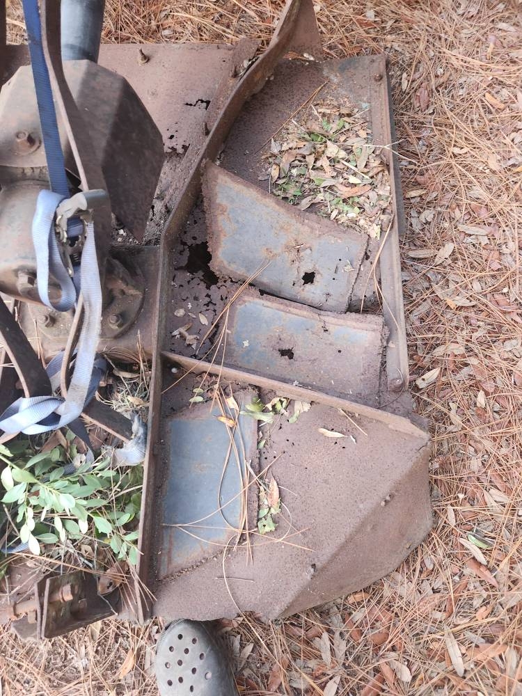

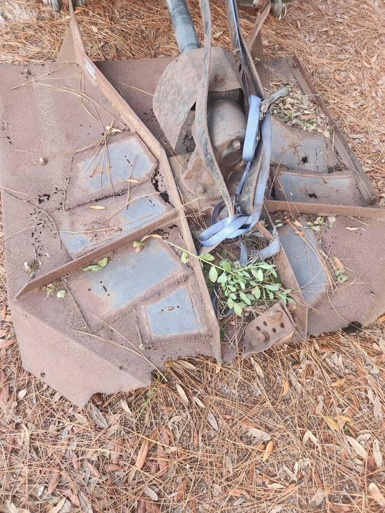

So, for years and years, ive made due with a Ford 917L 54" flail mower, that I have always kind of hated, or maybe just never liked? Last year, I got a 7 ft APP/chisel, and the guy threw in a rusted pile that is allegedly a 48" New Holland bush hog. So, its been in his swamp for a decade and in my woods for a year, but I "rigged" it up last weekend, and despite having 40% of a deck, only 1 side, a broke 3 point frame, and a structural ratchet straps, oh, and no tail wheel, or frankly back end of the "hog" it runs very smooth, cuts good, and is quite. Which is odd, any ive used in the past vibrated a ton, were very noisy, ect.
So, I dont need/want a "heavy duty", but an actual medium duty, 60 inch, that is also well balanced, smooth, and quite. I think this one might be beyond rebuilding. So, which models would you call medium duty, that are also smooth and well balanced? And if coarse affordable, if not "cheap". New or not, im more asking models, and then I'll figure out the shopping.

FWIW, I once bought a very similar rotary mower. I totally replaced the deck with 1/8" sheet steel. The entire frame, including tail wheel was in good shape.
If I counted my time, transportation costs of driving around looking for stuff, welding rods, Buying and having the sheet steel cut to size and bent on their press brake, wear on hand electric tools, etc., I probably had more money in that rebuild than a new one cost. Oh, I left out the skinned knuckles and banged up knees.

When I hooked this up, I really expected to immediately turn it off, and throw it away. Only reason I was/am considering doing any repairs is, it actually cuts well, and is smooth for a bush hog (maybe others ive used through the years where worse than most on vibration?).

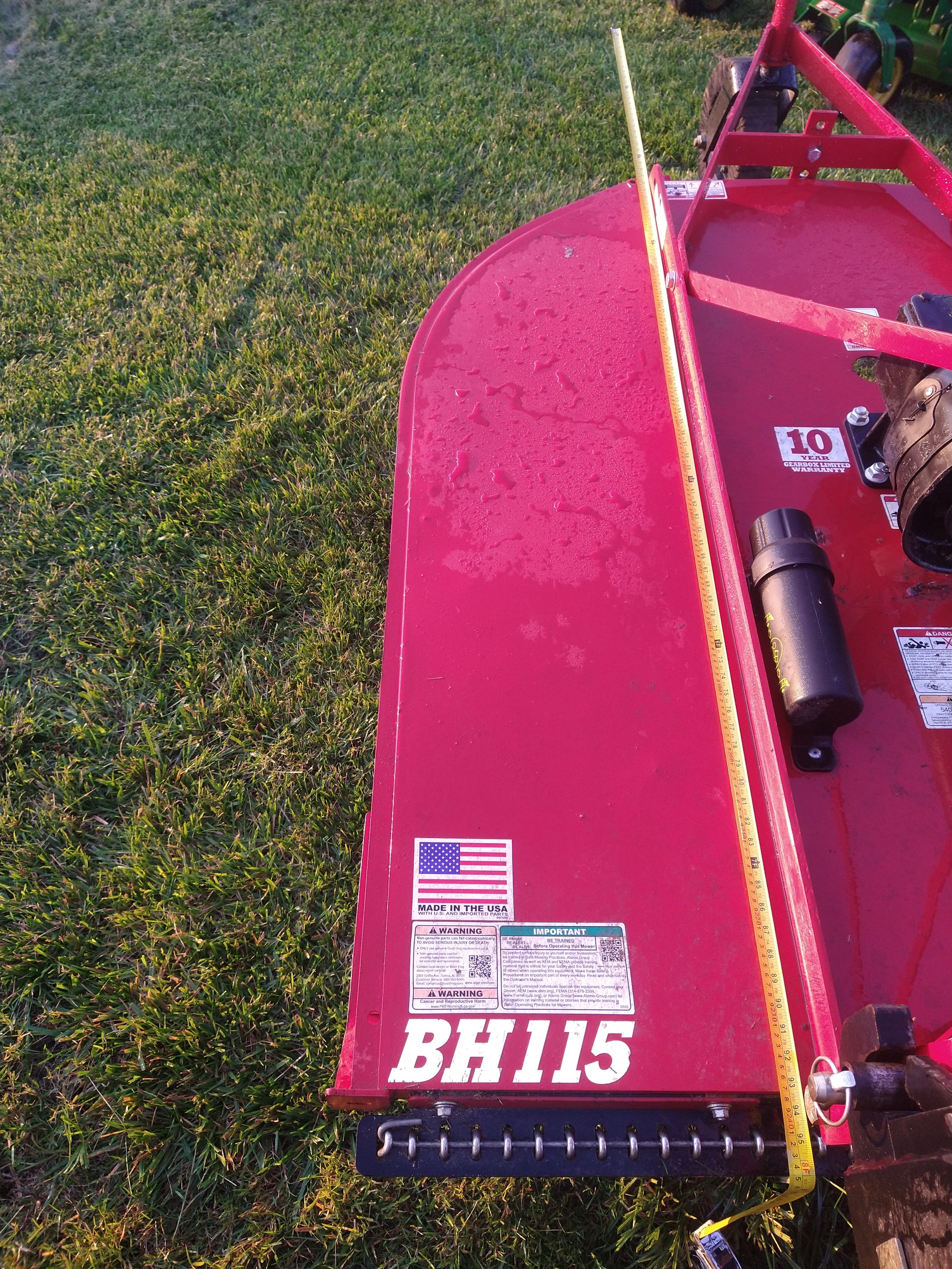

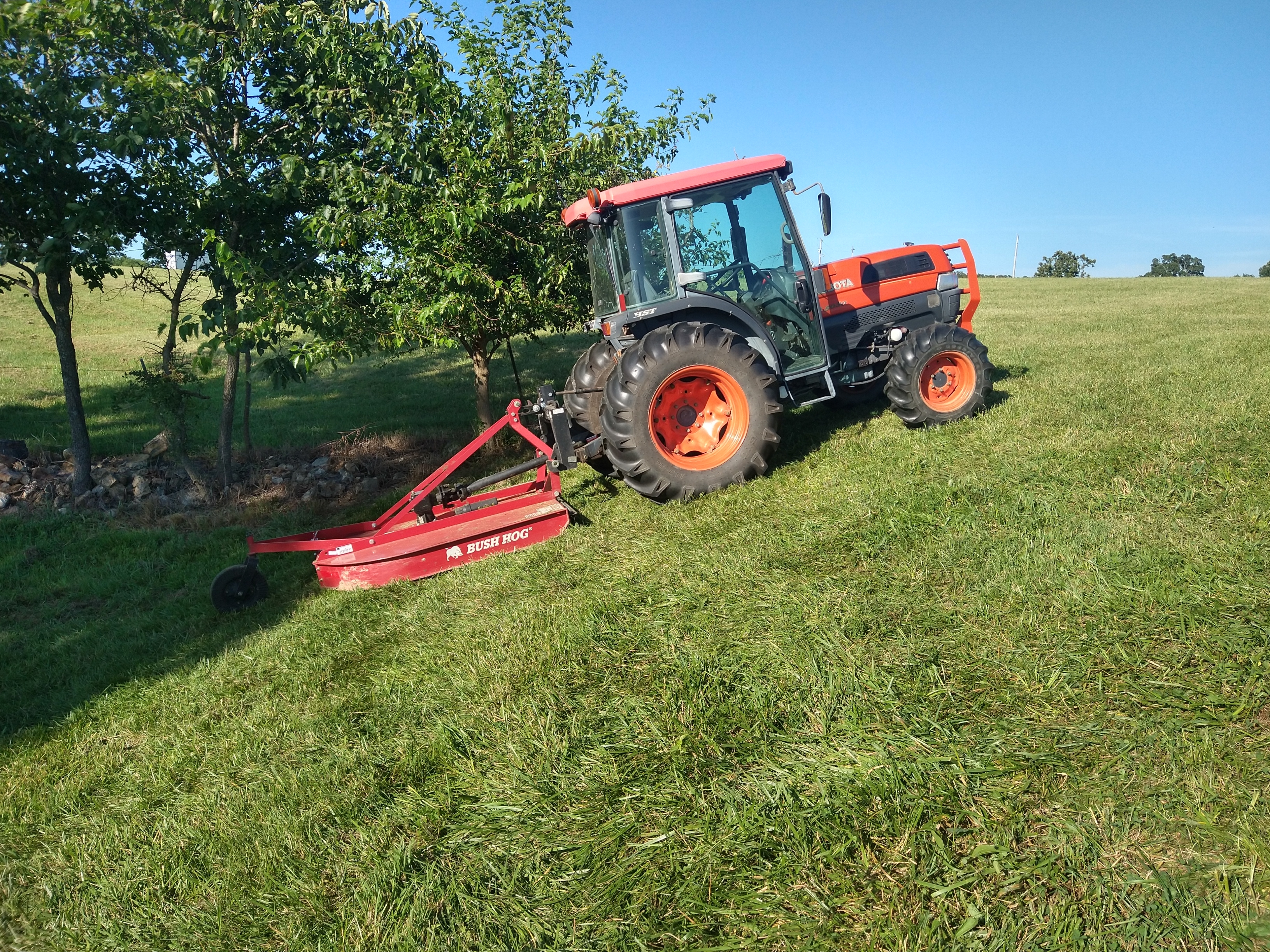

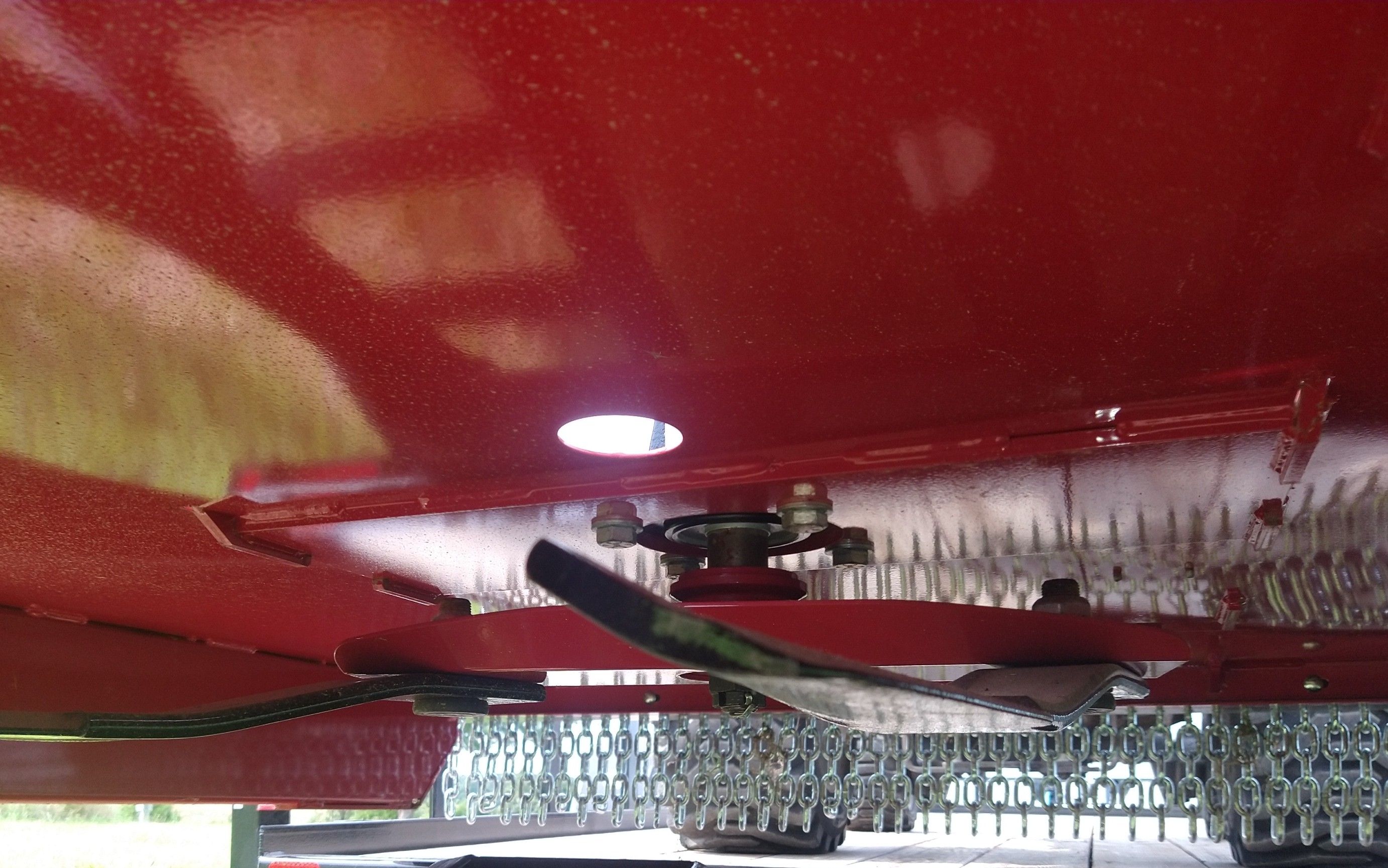

I have a Bush Hog BH115, I like it!
It is long though ... And weighs 518.4 Lbs on my scale.
It does have some "lift" on the blades ...
It's rated at 1" but I've cut more ...

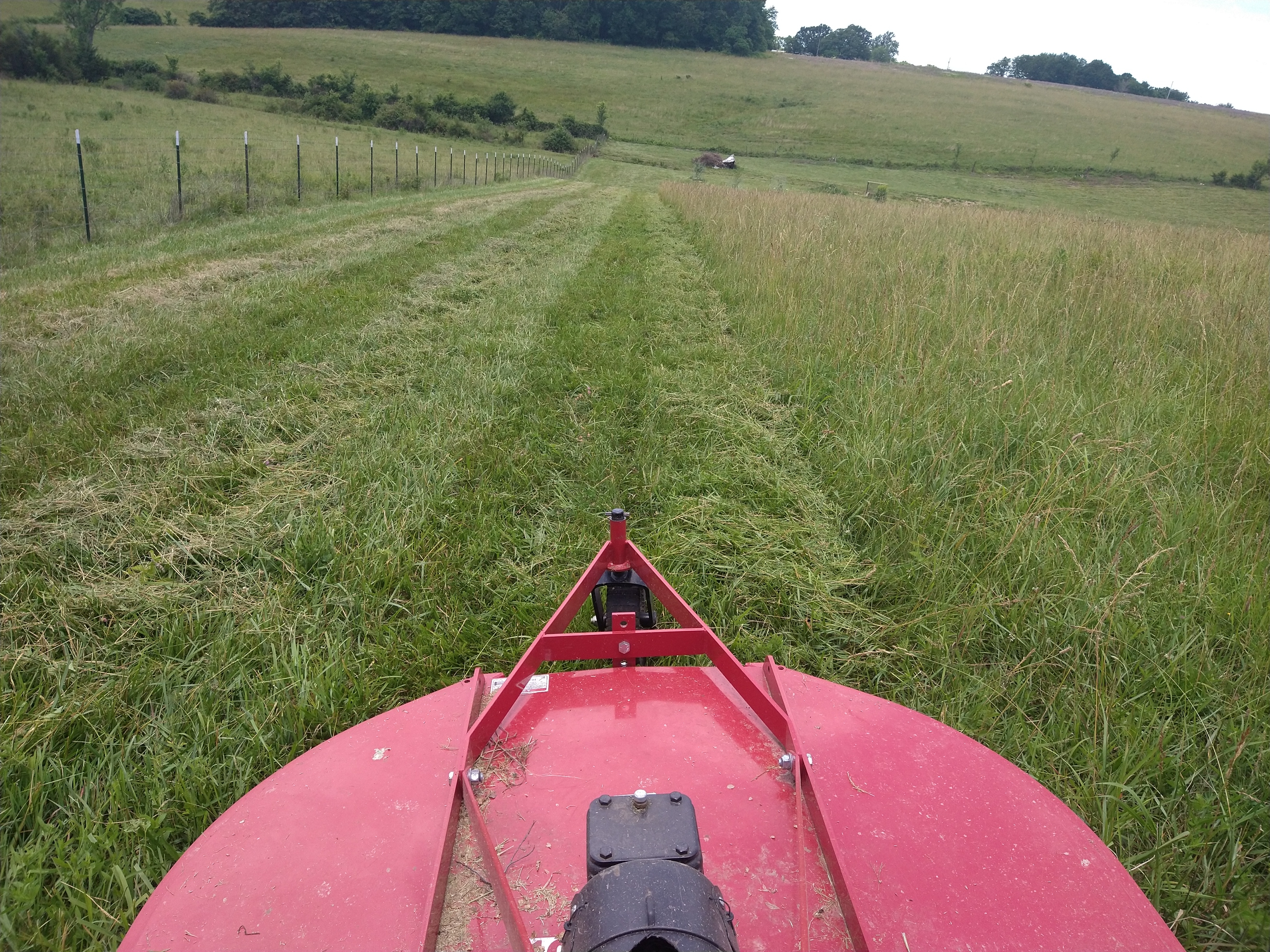

Now that I've "tamed" the back pasture ... It cuts grass good, but leaves the typical windrow ...
Shorter looks better!

Maybe instead of light/medium/heavy duty ... Go by the rated diameter of what the manufacturer says it's cutting capacity is ... 1", 2" , 5"! ...
The heavier duty it's rated for will generally mean that it will last longer ... If you have enough tractor to get it spinning ...
The BH 115 (1" cap) that I have says minimum PTO HP of 20
The BH 215 (2" cap) says minimum PTO HP of 25
The BH 315 (3" cap) say minimum PTO HP of 35
The BH 516 (5" cap) says minimum PTO HP of 70 ... But it is a six footer too, they don't make it in the 5' size ...
