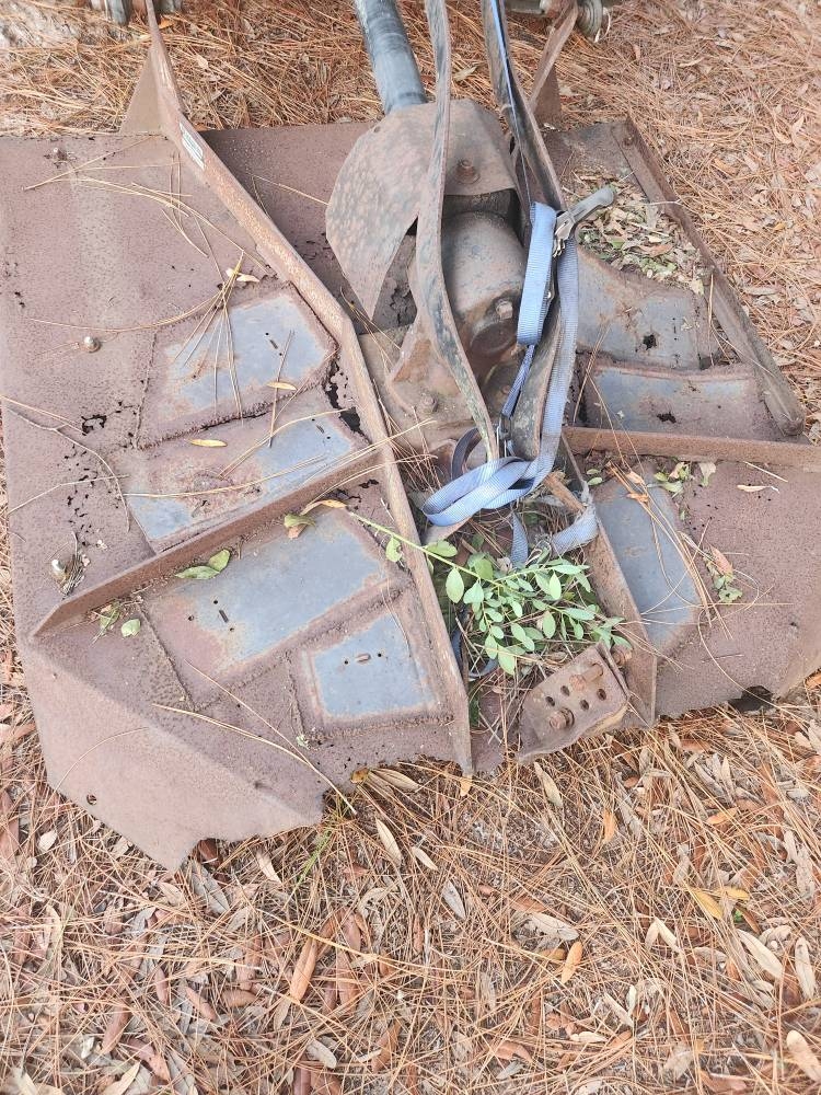

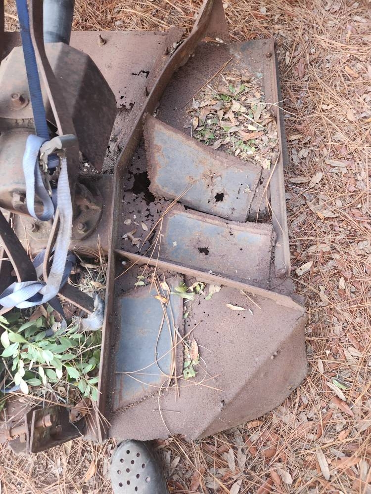

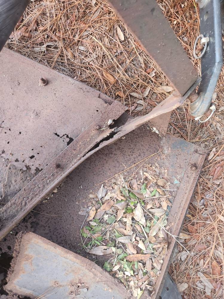

So, for years and years, ive made due with a Ford 917L 54" flail mower, that I have always kind of hated, or maybe just never liked? Last year, I got a 7 ft APP/chisel, and the guy threw in a rusted pile that is allegedly a 48" New Holland bush hog. So, its been in his swamp for a decade and in my woods for a year, but I "rigged" it up last weekend, and despite having 40% of a deck, only 1 side, a broke 3 point frame, and a structural ratchet straps, oh, and no tail wheel, or frankly back end of the "hog" it runs very smooth, cuts good, and is quite. Which is odd, any ive used in the past vibrated a ton, were very noisy, ect.
So, I dont need/want a "heavy duty", but an actual medium duty, 60 inch, that is also well balanced, smooth, and quite. I think this one might be beyond rebuilding. So, which models would you call medium duty, that are also smooth and well balanced? And if coarse affordable, if not "cheap". New or not, im more asking models, and then I'll figure out the shopping.
If some manufacturer would produce a tow behind, which would eliminate most of the vibration on the tractor itself, medium duty rotary mower in something smaller than 8', I think there would be a good market for them. King Kutter makes a heavier duty mower much like their finish mowers but with a stump jumper, but the local Rural Kind expects full non-refundable payment before they will even order one--in other words, pay sight unseen, kind of like a "pig in a poke". May be a great machine (probably not a match for a Bush Hog brand, but it is on a compact tractor) but not my preferred way of purchasing something so expensive.
   / Medium duty 5 ft bush hog? #24
When I hooked this up, I really expected to immediately turn it off, and throw it away. Only reason I was/am considering doing any repairs is, it actually cuts well, and is smooth for a bush hog (maybe others ive used through the years where worse than most on vibration?).View attachment 4117185View attachment 4117186View attachment 4117187
Scab here scab there
Presto good as new
Working that good I’d put the metal on
May not look the best but you’ll enjoy using it
