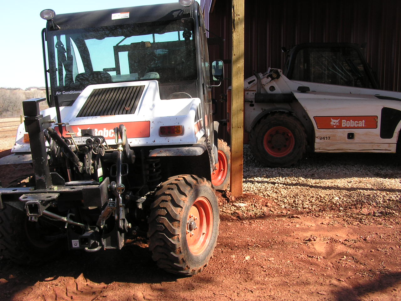

If I get up against a fence or a building, I set up crab steer and drive away! :thumbsup: :D

For me i can just turn my wheels and back out. But the secret is is that i have all narrow front (middle wheeled, tricycle,....) front end

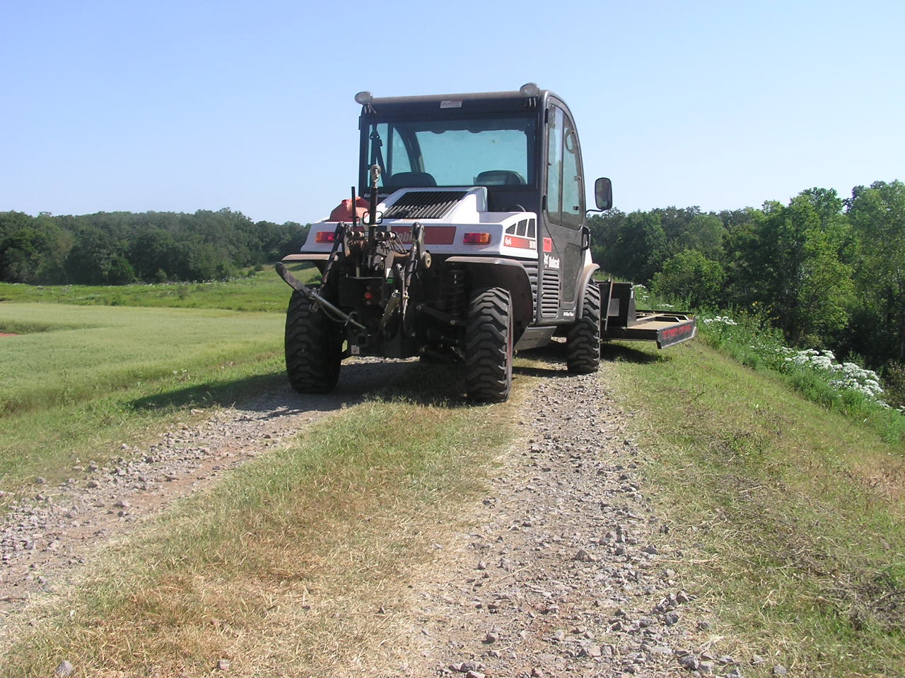

Thanks.
My wife bought the Toolcat so the cab would keep the poison ivy off of her while she helped with the mowing. She does let me use it some times. Sure is nice having the brush hog out front.
She won't mow the dam. :D
