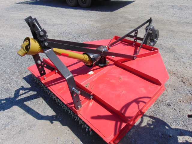

Is a rough cut mower and a bush hog the same thing? I want something to cut long grass, small trees, bushes 1-2" in diameter. Would a flail mower do this or is a bush hog more appropriate. Are there any brands, styles to avoid, there is a local auction coming up and they have some new 5' and 6' rough cut mowers such as the one pictured, what would it be worth brand new. My tractor a a TN75 75 hp.

Yes except Bush Hog is a name brand. Most people say brush hog for that reason. At auction $400 for a 6 foot sounds reasonable.
/ bush hog etc... #4
YES.
A Flail Mower has several times the number of parts relative to a Rotary Cutter.
Rotary Cutter is a more robust implement.
If you do a lot of brush cutting, the two blades in a Rotary Cutter will gradually blunt. You can still cut brush fine but you need fairly sharp blades to cut long grass. You sharpen Rotary Cutter blades with an angle grinder.

I would want a rotary cutter at least as wide as the tractor. My TN 55, a weaker sibling of your TN 75, is about 68" wide and my 6' rotary cutter covers my tire tracks. You have enough tractor HP and weight to handle a wider cutter, but prices begin to really climb when you get to 8' and wider cutters.
Do you know the brand of the cutter? I don't recognize its brand from your photo, but it appears to be relatively light duty.
Most manufacturers offer light-, medium-, and heavy-duty cutters. Woods, Land Pride, Bush Hog, Rhino, Brown, and others make quality machines. I would obtain quotes from local dealers in order to make an informed decision.

Don't bother with a light duty cutter like the one in your photo. Your tractor will overpower it, and I suspect the cutter would not last long unless it was really babied.
And, yes, get one that covers your tire tracks.
