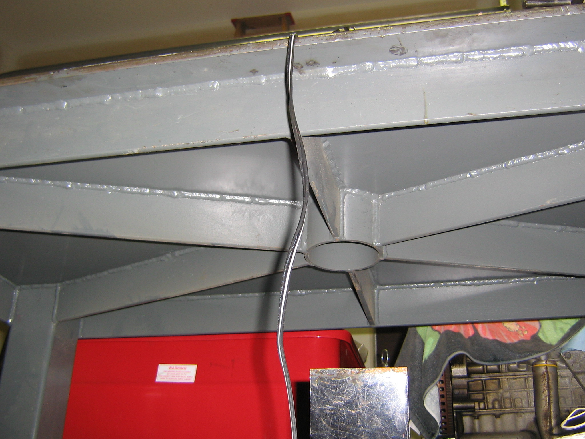

/ Building welding/work table? #4
i would say 3/4 better than half, 1" better than 3/4.
also, one thing a lot of guys miss is they just weld the legs to the bottom of the table, and they weld the snot out of them. this results in a table with a crown radiating from the center out to the corners... really not very good.
if you light stitch some channel iron, angle, hss (channel probably best) or whatever you have as long as it is straight, around the perimeter... anywhere from 4"-8" back from the edge, it will form a strongback to weld the legs to. you will end up with a flat table, and when it comes to fabbing steel... that's something you really want.:thumbsup:
also, if you have the room, 4'x6' is probably better than 3'x6' too.
using a vice on a receiver is something i never tried... sounds like it may be a good idea. again, you would weld to the strongback, not the table... or very little to the table.

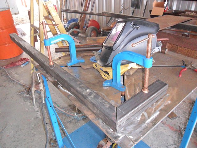

I have a bunch of different work benches. My favorite right now is my Arc Station from Miller. It's only thirty by thirty and three eighths plate. But it's handier than a pocket on a shirt.....

1/2" plate is a good choice for the top. I also used 4"x4" for the legs and have adjustable feet made with 1" bolts and some homemade washers with thin rubber glued on. The supporting structure is all 3/8 x 3". This was my first project with my big welder and I went a bit overboard, warping the top a bit. It hasn't caused any problems using it over the last 15 years, but pride of workmanship would have preferred I hadn't warped it. Be very careful. I wish I had asked for some advice before starting the welding. The bottom rails are 2x2 and easily support the bench for moving with a dolly and floor jack or pallet mover. Please excuse the junk in the pictures as I just recently moved here and everything is still piled wherever it would fit. I have a truck motor I usually store under this and the combination weighs 1300 lbs. I can do anything I want with hammers, pry bars, etc. and it's as solid as a rock. One of the most useful projects I've made. Size is 30x60
