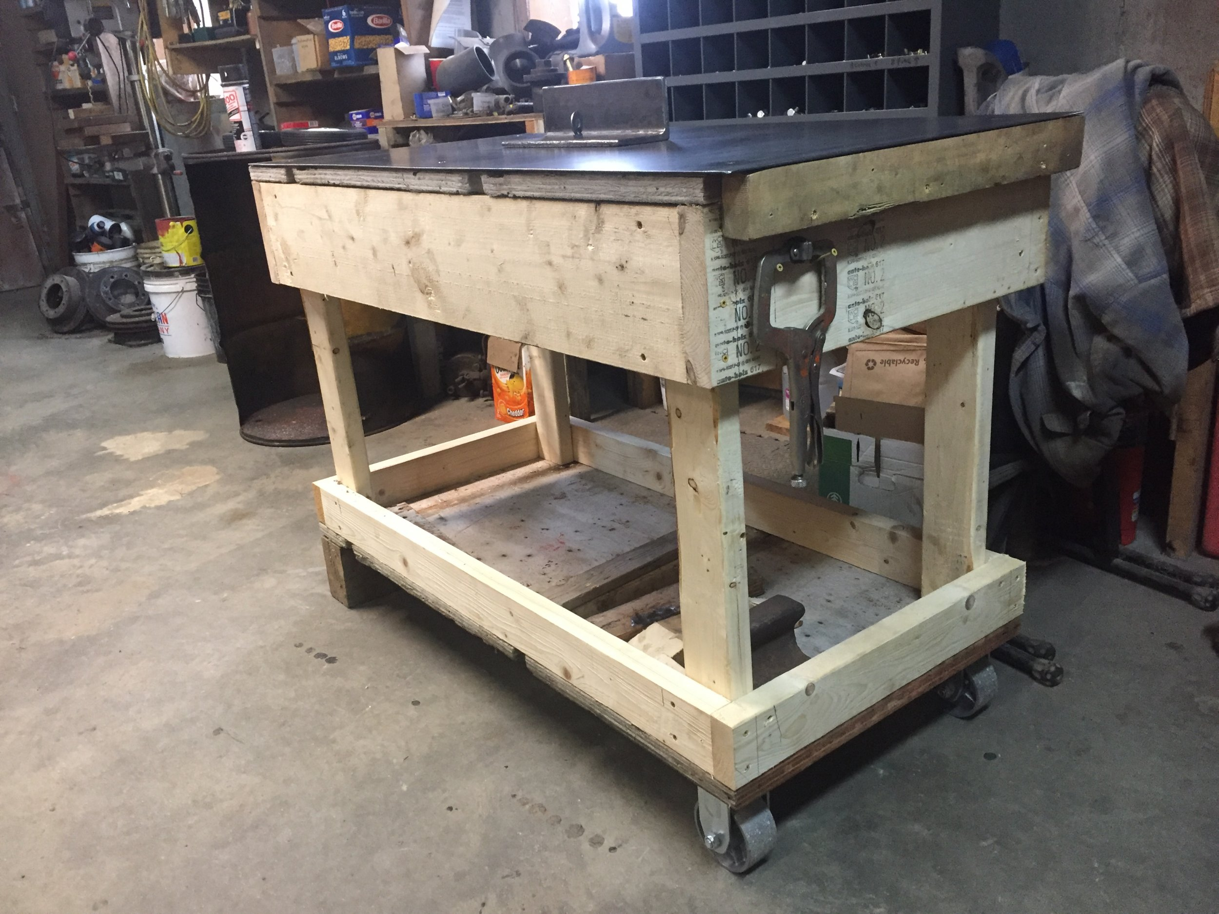

Our family farm and my concrete business generate a somewhat regular need for welding stuff, so after years of welding on makeshift tables made out of sawhorses and plywood, my dad and I finally made a dedicated welding table. You can see on the front corner where there is no wood under the steel top. That's where we clip the ground.
The 4" angle iron has multiple holes for a 3/8" bolt to cinch down. The bolt goes down through the steel top and through the 1 1/8" plywood to a nut that's welded to a small plate which is screwed into the bottom of the plywood. I welded a washer on the head of the bolt for easy, tool-less turning.
I used steel casters and the red handle to move the table is from a roll away tool chest. The 4" angle iron isn't quite done yet, as I have to modify it to allow clamping things horizontally.
I'll post pics of the welder and plasma cutter here soon. Our local welding shop has commented that "for a concrete outfit, you guys sure do a lot of fabrication."

There is a significant chance of fire with this table. Be careful. Personally, I'd have found inexpensive scrap iron rather than the expense of that large dimensional lumber to make the table out of. Not trying to rain on a parade, but I have seen wood welding tables catch fire.

Maybe raise top plate up a tiny bit and put a sheet of cement board between plate and plywood as insulator....

How about a second layer of thicker steel?

Or maybe just use all steel? Mark has a valid point, welding and wood don't work together well in a garage with wood studs and a table constructed of wood has the same issues, except being even closer to the fire.
Assuming this wood table is moved outdoors (I see paint and flammables in the picture) to use it, and then stored inside at night. What happens when you get an glowing ember stuck in a crevice of the wood, and put it away for the night and then the wind picks up or the HVAC fan comes on? The glowing ember finally decides to start burning better and hotter, and the table ends up burning down your shop? Is it worth it to take the risk?
Now, as far as a work table, that is a nice one, but not as a welding table. Put a vice on it keep it away from a welder!

The risk is real. The problem is more often with sparks from grinding and cutting more than heat from welding. Sparks can build up in corners and start to create enough heat there to get the wood smoldering over time. If you are welding and scorch the wood, it will be immediately obvious but a smoldering fire can start long after you leave.
I welded over sawhorses for quite a while too, but those don't really have much place to catch and hold sparks. You have a plywood shelf below that is perfectly suited to cause that exact problem. If you store anything on that shelf it will create even more places for sparks to build up that you can't see.

What a fire extinguisher is for. I built one as well but I used all steel. Top is 1/4" thick HR plate 4x8. legs are angle iron and it's on industrial neoprene casters with brakes and it's HEAVY too.

Yeah I know what you mean. It looks like a very solid worktable. It is just one that is unfortunately risky to use for serious metal work. Plenty of other good uses for it.

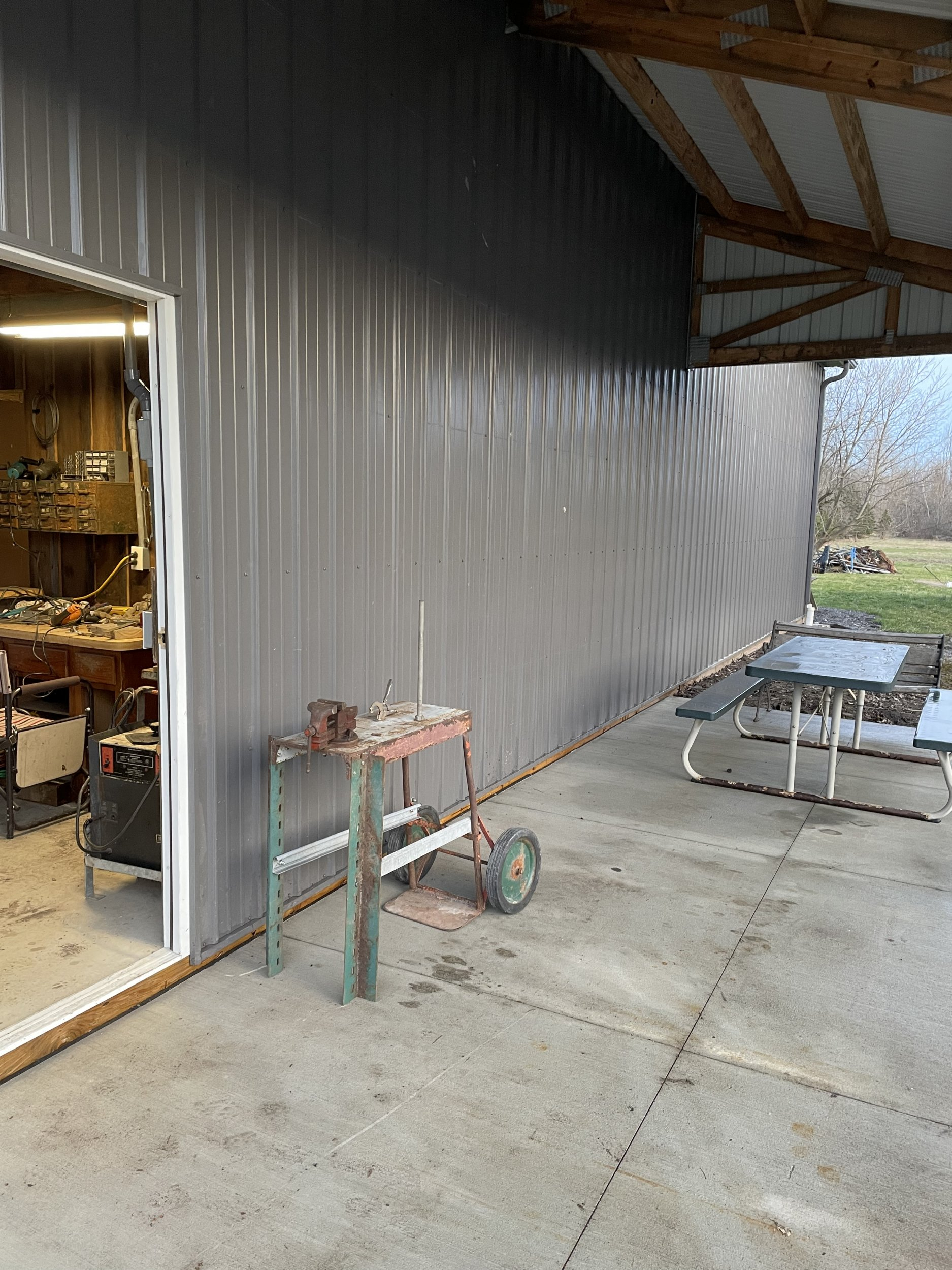

Reading this thread got me worried about burning my new pole barn down, so I made up a steel welding table. I used some junk from my scrap pile, and it took me about an hour.
The top is a piece of heavy steel c-channel about 12” wide x 30” long. The front legs are angle iron. The back legs are made from an old dolly that one of my old barn frame and roof fell down on and crushed a few years ago, after I had stripped off all the siding. It was a twin to this one I am dismantling right now.

I plan on the same, weather permitting. I made my table small and portable enough to move inside if necessary, but most of the time it will be under the this covered porch:

That's a nice clean building and concrete. If you use a grinder, be careful which way the sparks are flying. If directed toward the building, little rust blooms will appear.
You'll probably also notice rust stains on the concrete from welding and grinding. Those darn little particles of steel have a way of doing that.

Thanks, thats good to know. I’ll wheel the table over to the other side of the porch, and let the chips fly out onto the grass, or at least as far as my welder cables reach. It will also be harder to ignite that little strip of pressure treated lumber under the steel siding and above the concrete that way.
That piece of threaded rod makes a good handle to tip the table back and roll it around.
