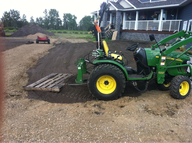

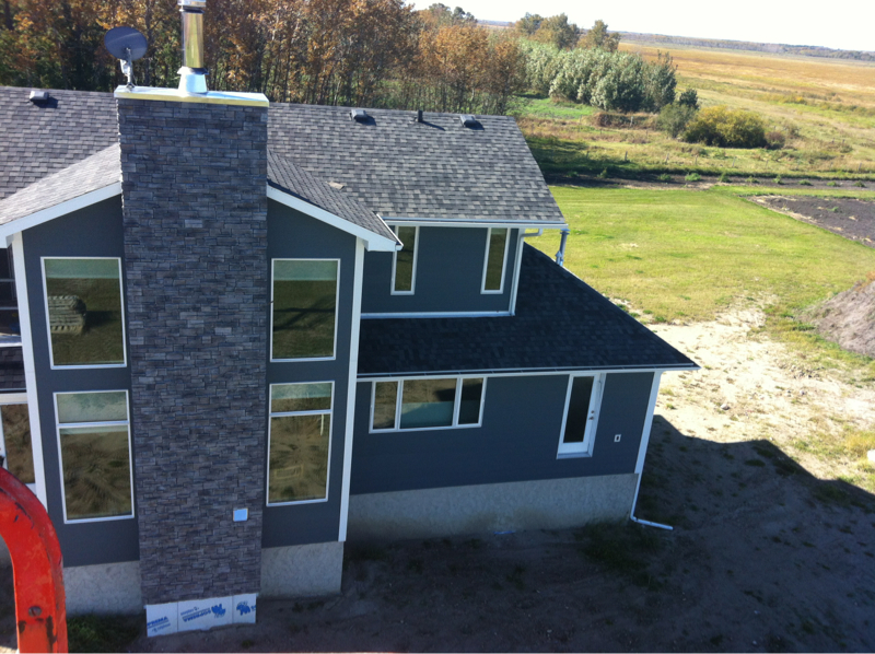

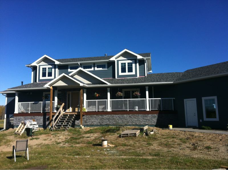

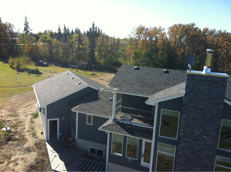

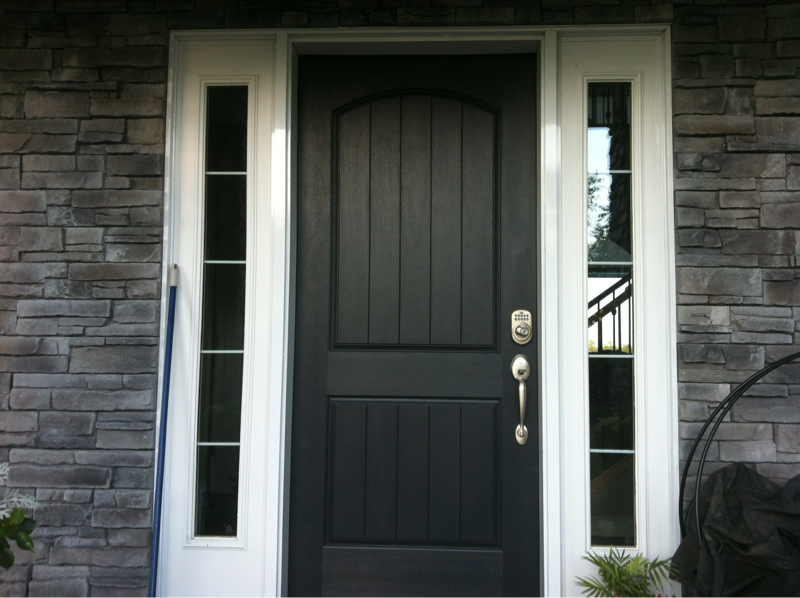

I have a Cousin that built the garage before the house. They never did build the house after. Lived in the garage for 5 years and now are trying to sell it as a house. In building my own home I learned few things. First any time estimate I have on how long it will take to do something needs to be tripled. If I think it will take a day to do something it usually ended up taking three. Second, it was easy to work on the house and I got a ton accomplished when we lived 30 miles away. Once we moved in the progress ground down to a crawl. When I lived away from sight I would pack a lunch and a thermos of coffee. I would get there by 7 am and work through until 9 or 10 at night, with only quick lunch breaks. The third thing I learned, but it is probably very specific to my job is that I lost money doing things myself. When we were done and I looked back and compared the hours I spent on the house to the amount of money I would have made working equivalent hours at work I would have been way further ahead going to work and hiring a builder to build the whole house. That only is because my job had tons of overtime available that year at double time, but not everybody has that opportunity. Now when I look at things on the house I take the price of getting somebody to do it and then calculate how many hours of OT I would have to work to pay for it. Then I decide if I can do the said house job myself in that many hours. If it is anywhere equal I will choose working on the house over OT, but there are some tasks that just aren't worth it.
Oh, and I would never again use asphalt shingles. One corner of the house catches lots of wind and they are always blowing off. I wish we had done metal roofing, and I am looking at changing in the next few years.
