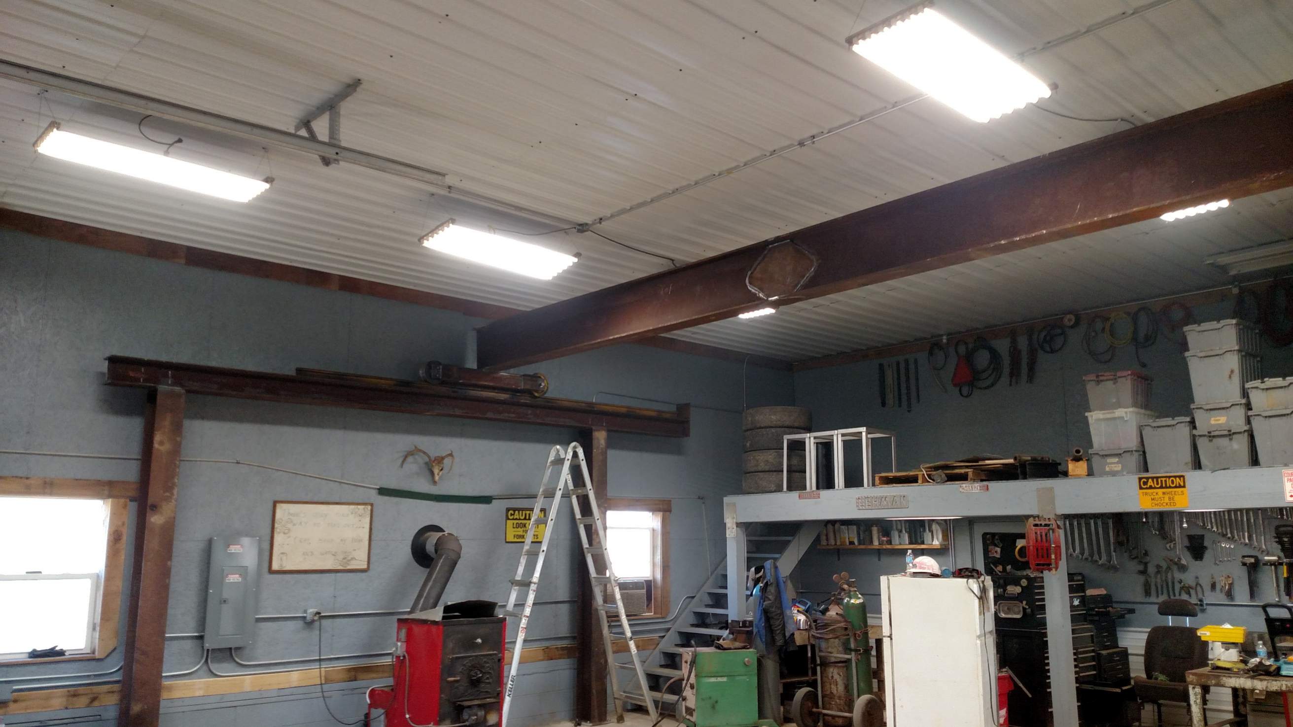

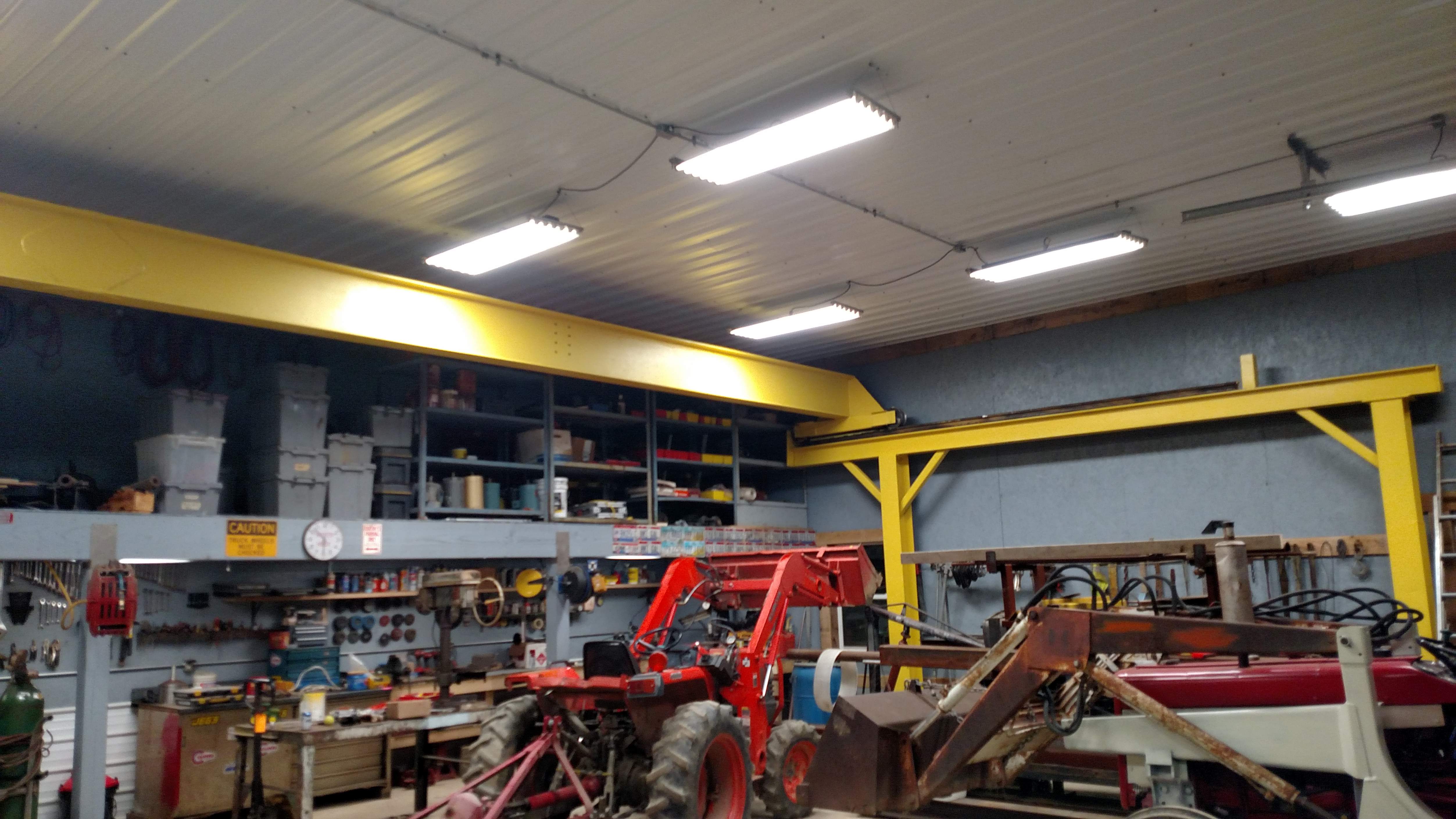

Got the knee braces on.
3' long each, 3x3x1/4" tube on 45 degrees
All done except paint now

Looks good, I plan on one in mine in the next year or so, still setting up the basic shop itself.

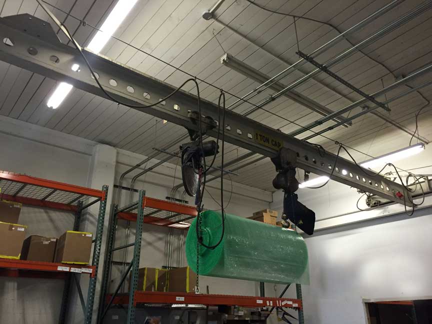

Here's what happened to mine. Tenants are using it to hold a roll of bubble wrap. It's 22 feet, on rails 100 feet long. Kind of a waste but it pays the rent.

Yea, could probably hang that bubble wrap from the conduit and be fine:D
Which I had electric hoists but man are they pricy. If I used it all the time maybe I could justify it. But once or twice a month....

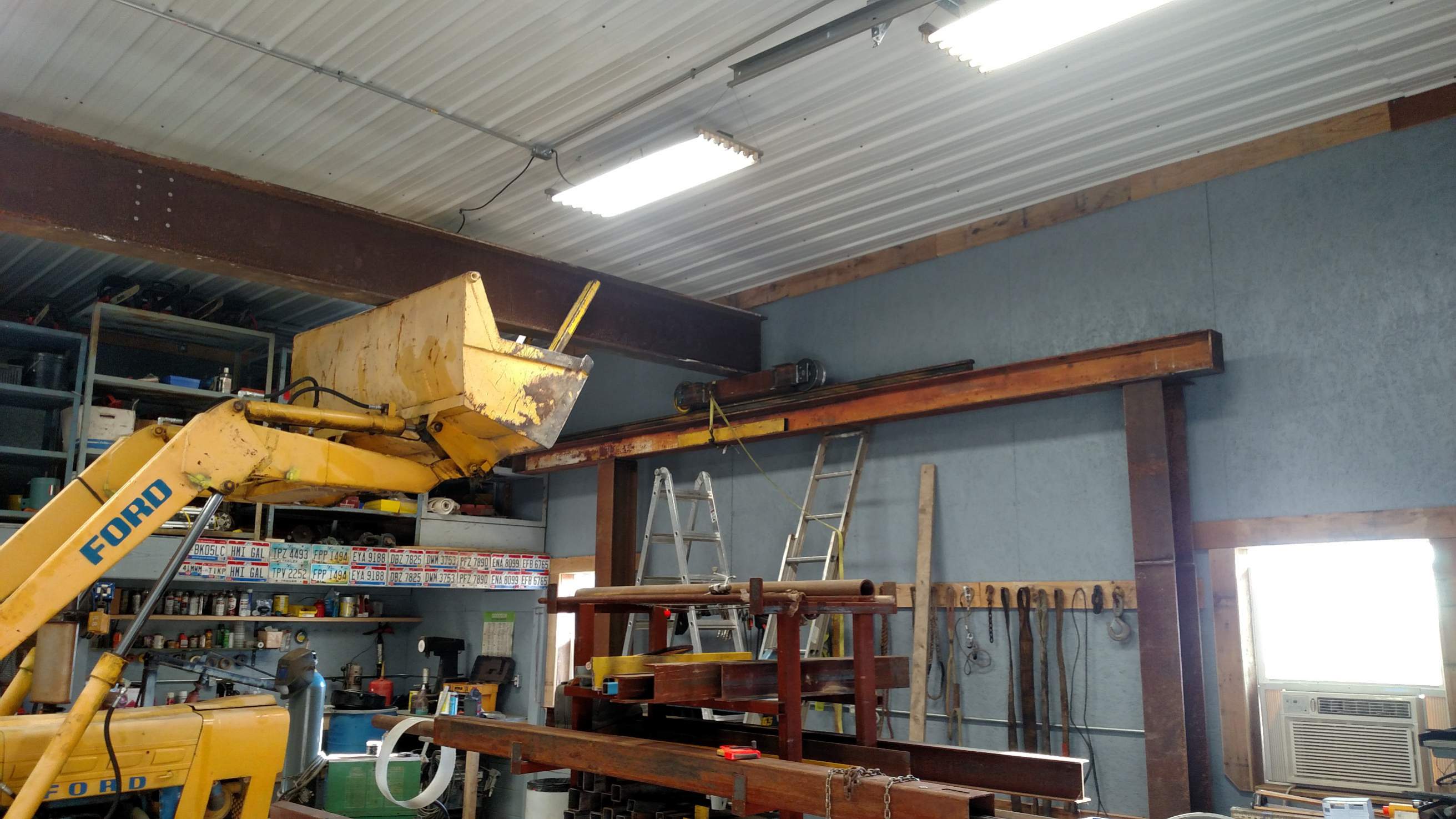

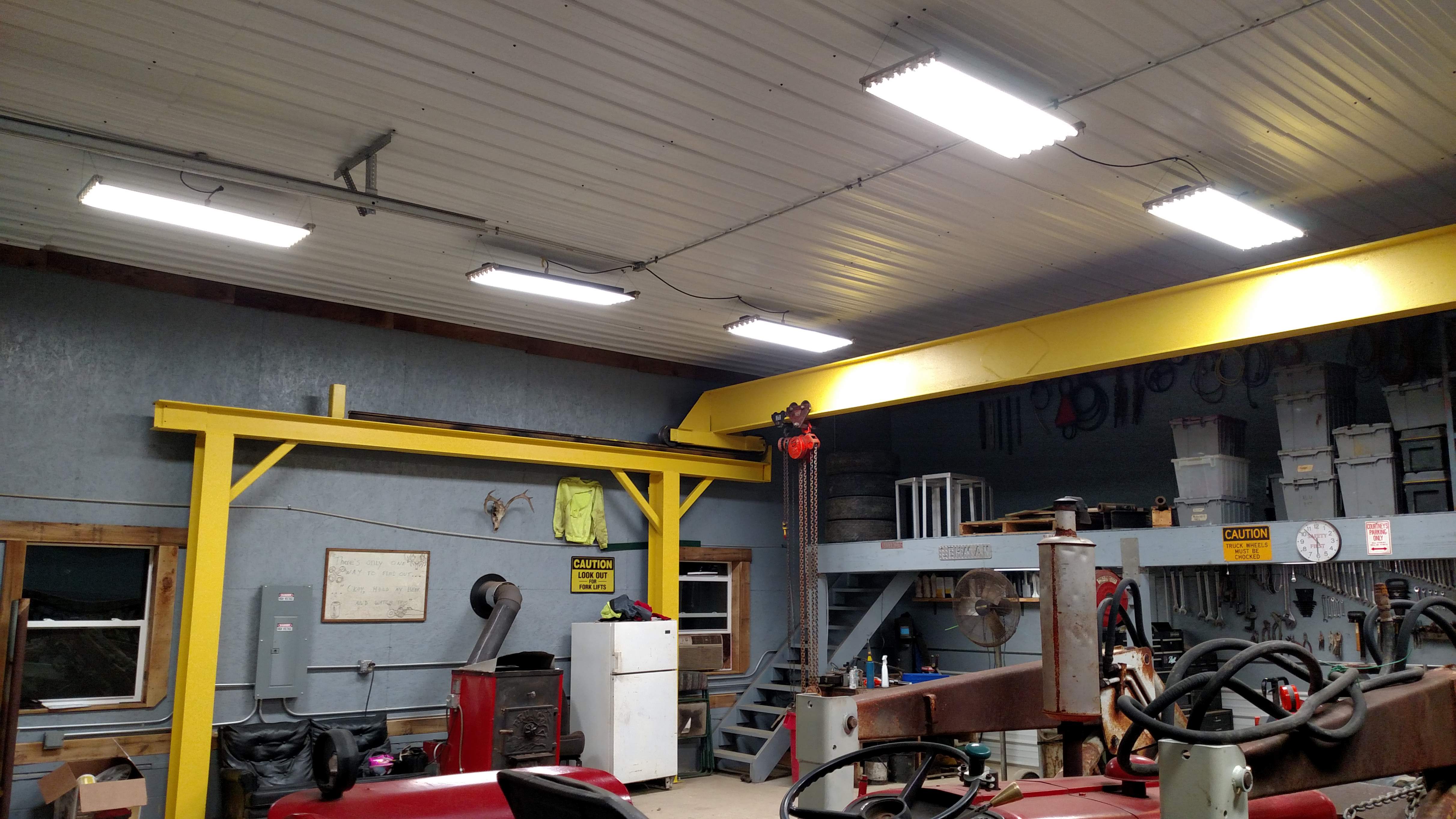

Here are some shots after paint. I didn't paint the rails since they were reused, they were kinda greasy and didn't feel like cleaning it all off. Just need to stensil the capacity on it and call it done
/ Building my bridge crane #89
Looks professional. Nice job !
/ Building my bridge crane #90
Looks even better. Stencil the capacity on the fish plate with a black diamond border. With an electric hoist you're inclined to add a whole system to spool the wire as it travels which could be the most difficult part of the whole job.

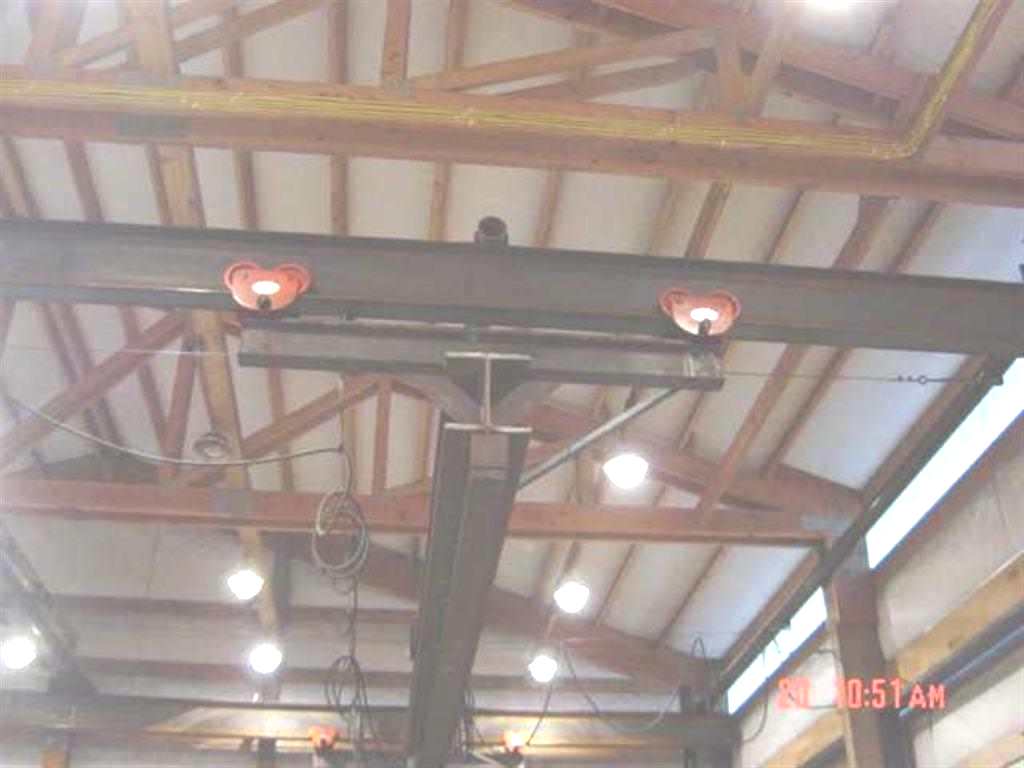

Not really. Run a piece of 3/16s aircraft cable parallel to the tracks (but as tight to the ceiling as possible) and get a bunch of cheap little pulleys, fasten your power cable to the pulleys every 2' or so. Do the same thing for the trolley but run it along the top if the Ibeam and fasten it every foot.
Aaron Z
That's pretty much how I have the power running to my crane. The power for the 1-ton hoist comes from one end of the shop. The power for the travel winch comes from the other end of the shop. I started out with small snatch blocks, but they didn't last long, I've been replacing them with snap clips.
Makes sense, not much weight on them and its not like they are holding much weight or moving down the cable all day.
Aaron Z
/ Building my bridge crane #94
My span beam can set in one place for months at a time. I've checked the snap clips, they show no wear at all.

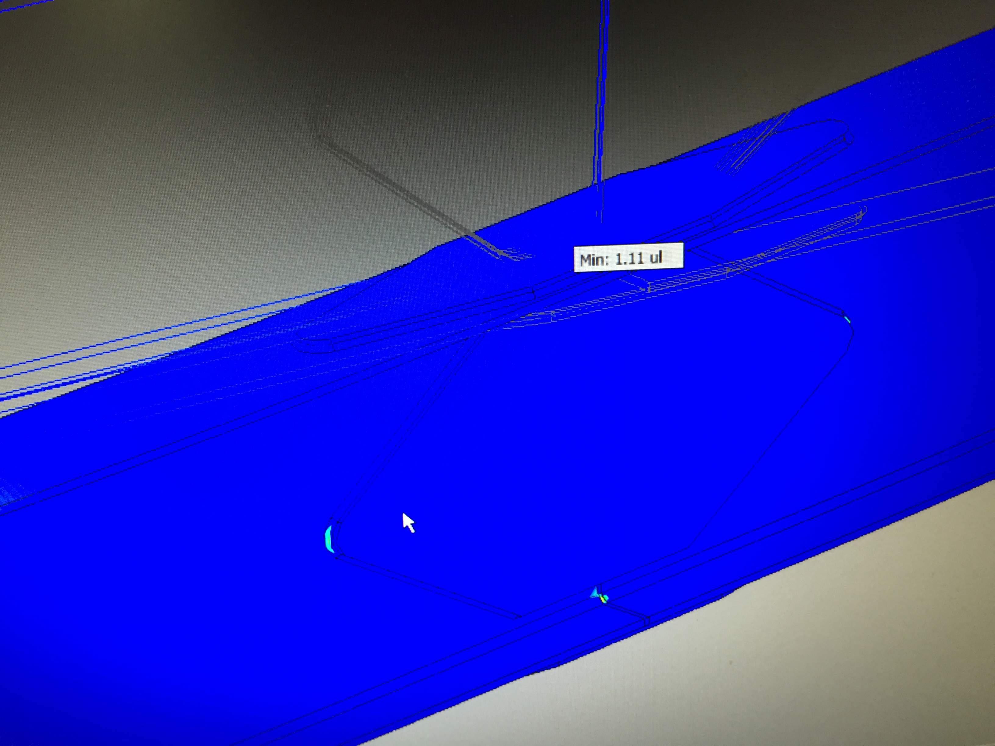

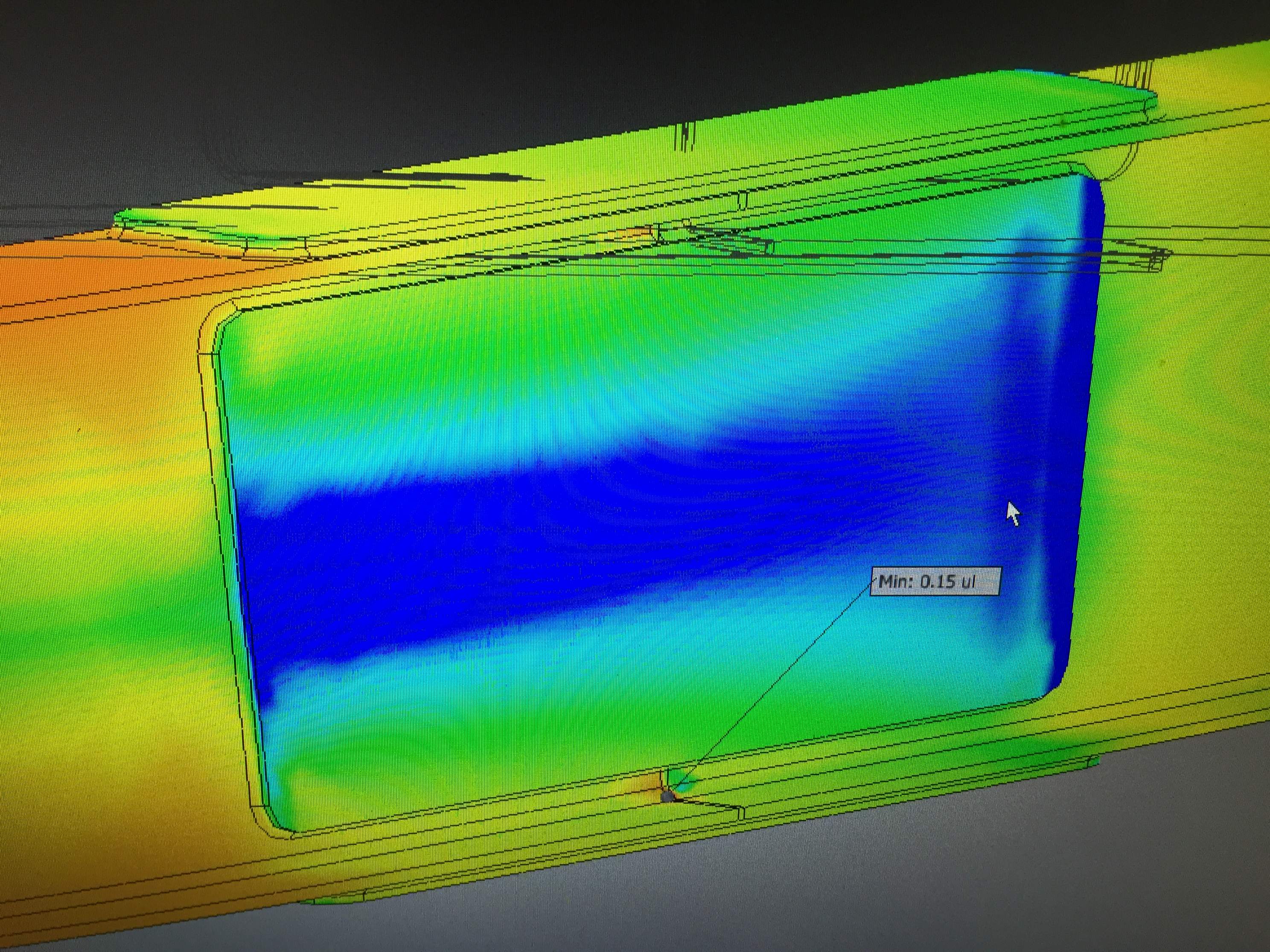

First of all take this info for what you paid for it. Which was nothing. In other words its for discussion only. :rolleyes:
Attached you will find FEA of OPs spliced beam... using tapered and square scab plates. Note hot spots at points of scab plate. With that being said, highest stress is at butt welds between two beams and not at scab plates.
Also I've included approx safety factor at 10,000 lbs with indicated loading... around 1.1. OP should inspect rail at butt weld joint for possible fractures. Proceed at your own risk. Not sure what you are gonna rate this crane at but be careful. Cranes are serious business.
Good day. :cool:
Did you model actual welds and the scab plates spaced apart from the main beam so your FEA program calculates the stresses individually, or did you just "glue" them to the beam, over the full contact surface, so the stress in the scab plate is the same as in the I beam flange ? Watching the stress concentrations in the square scab plate case, i assume the latter...
