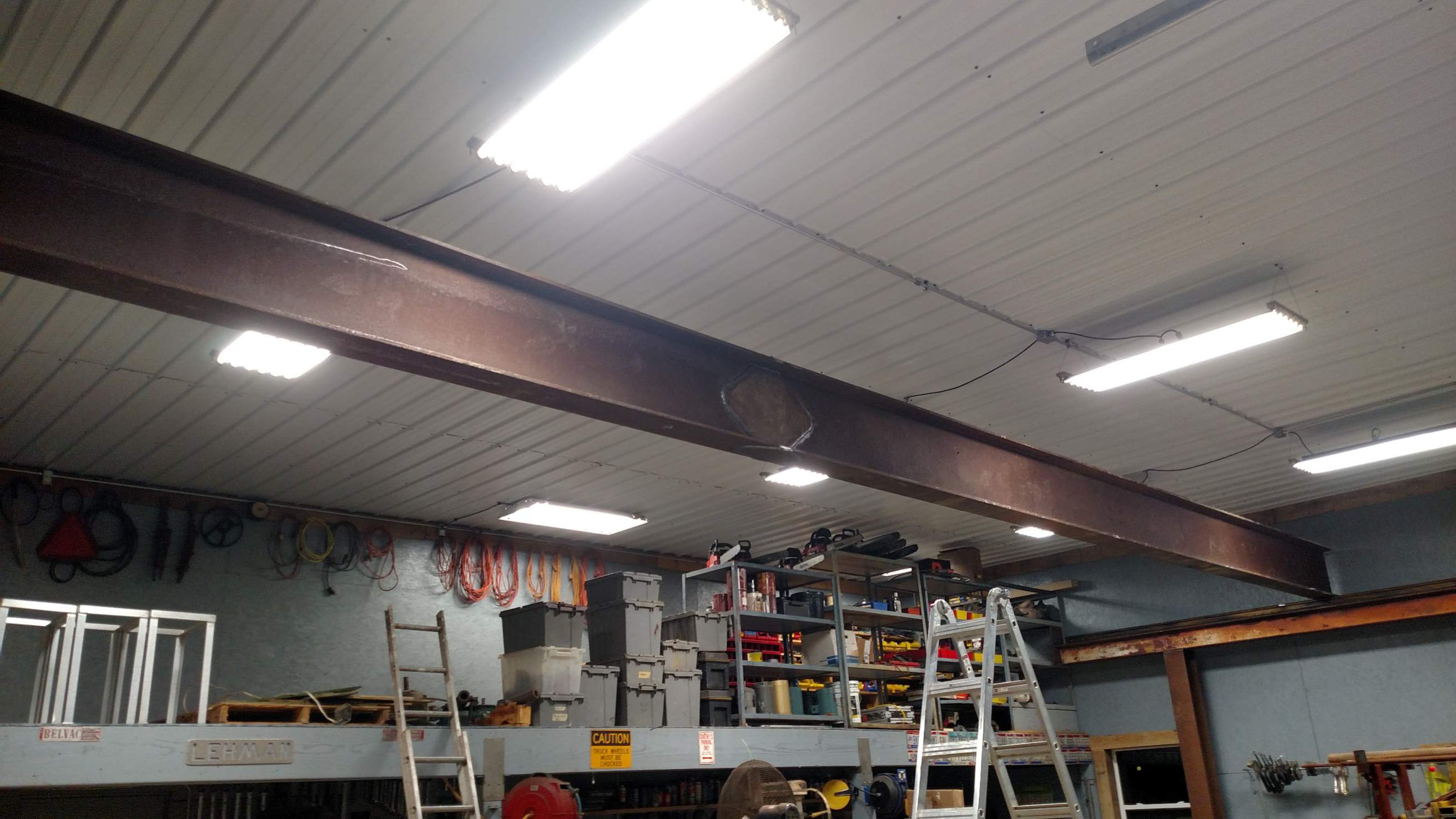

Talk about points on a fish plate. Note, there are no vertical welds on the points? Note, how the welds are curled out? All to cut down on stress risers.
/ Building my bridge crane #23
Cool! I like those "bolting" welds too.

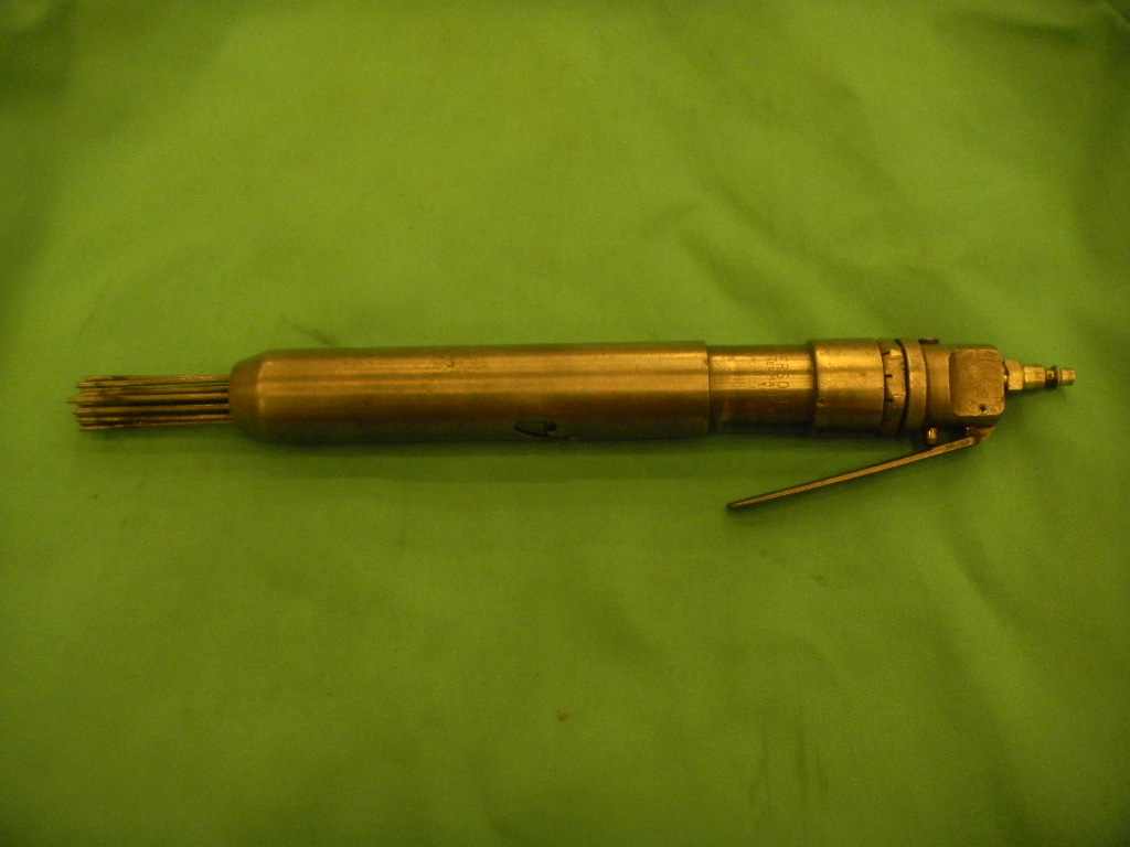

,,, Do you also peen with a needle scaler?

WRONG! ... The tapered ends act to blend the stiffness from the beam into the stiffer area of the patch. Also the taper away from the edges of the flange inhibit a tear/crack beginning at the edge of the flange.
Exactly... abrupt stiffness changes are stress risers. That said, we aren't building an airplane where the margins of safety are near zero so it is probably a moot point. I doubt LD is going to load this thing anywhere near ultimate or cycle it such that fatigue becomes an issue. But good design is always appreciated by those who understand why.

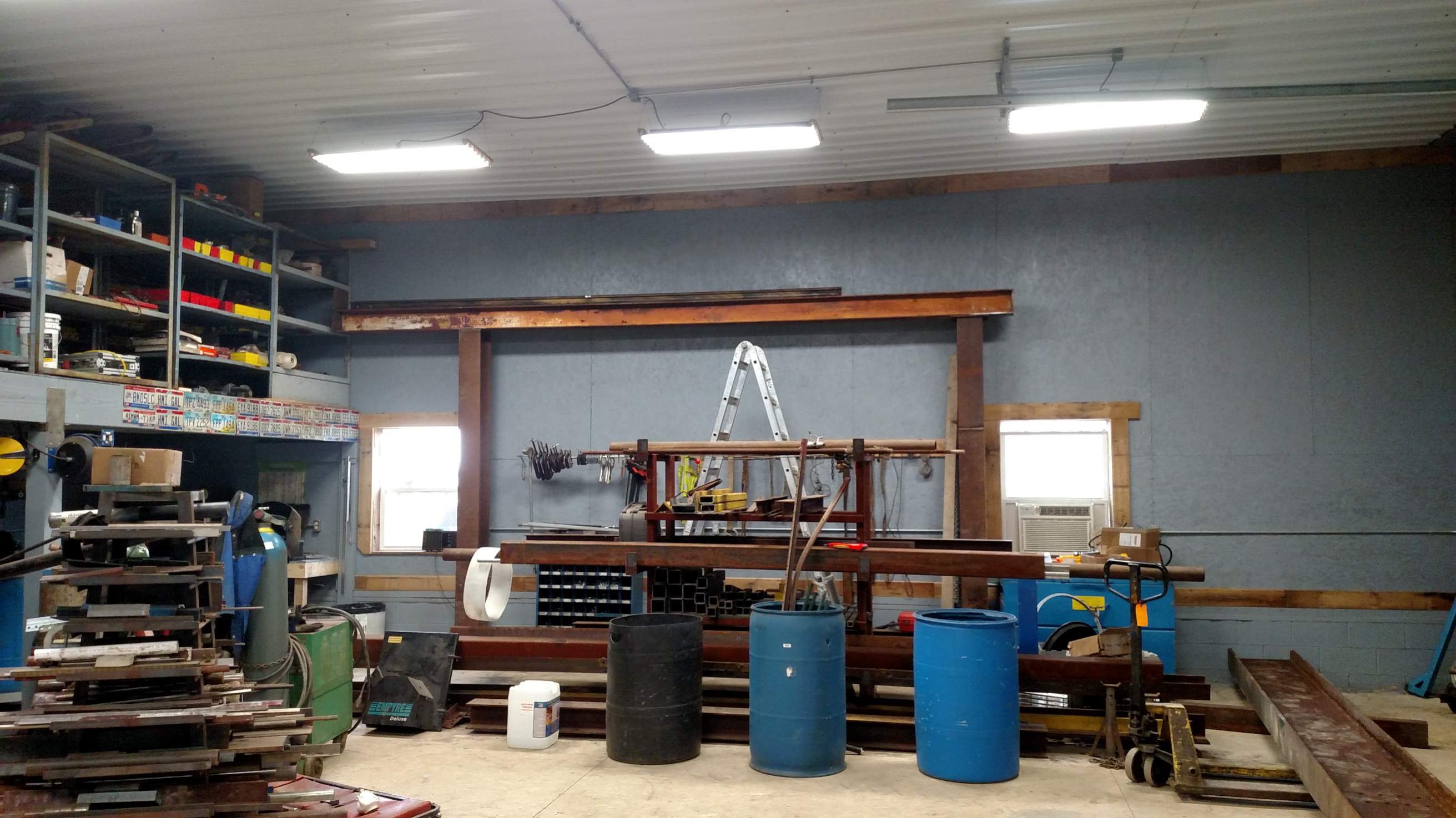

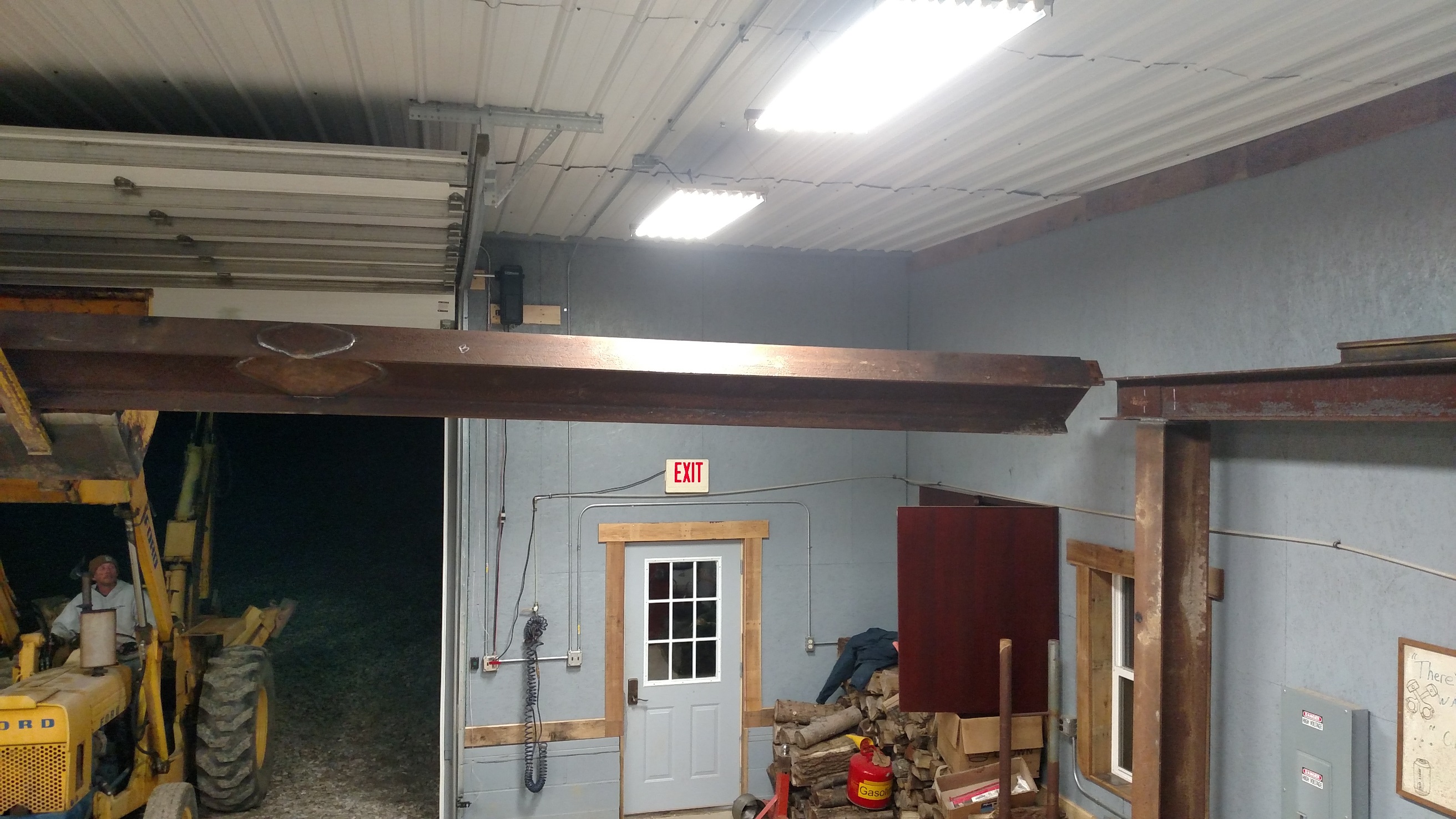

Got the rail beams welded on. Still need to do the knee braces yet. Got the main beam set and uprighted. Todays project is going to be lifting one side at a time and rolling the end trucks under the beam. I think I gotta raise the lights a tad too. Looks like they are about 1" too low once the beam is on the truck. Slight mis-calculation:mur: But It was hard to measure things precisely, And I knew wanted the beam as high as I could get it, knowing I can shorten the cables on the lights in just a few minutes.
And the darn backhoe bucket.....its about 1" out of level over its 6' width, which translates into alot more over a 38' beam
/ Building my bridge crane #29

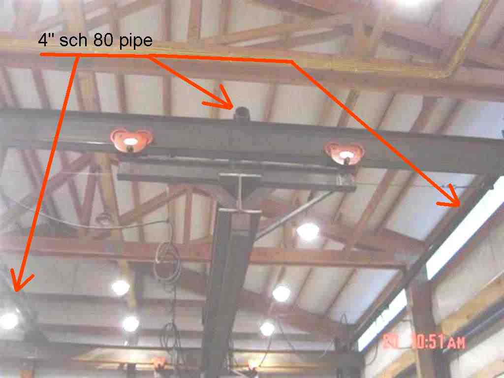

Oh I see now how your truck beams are going to work:cool2:. Your not going with under the rails truck beams. I wish I had done that, but I was to cheap to rent a fork lift:eek:.
Are you going to power your span beam? So you don't have to pull it by hand?
#30
Yea, Top runners. I thought you got that. I said it a few times, and one of the reasons why I cannot tie the rail beams together like yours are with pipe.
The trucks each have one wheel with the gear so I can add power later. For the time being, the just gonna be pulled by hand. But eventually I will at least tie the geared wheels together and have a chain pulley and chain. So I can move the beam the say way a manual chain hoist works.

Well a least your lights are on chains. Just tuck them up,no?
#32
They are on fixed length cables at each end, looped over a 1-hole conduit strap serving as the hook.
I'll either add a second strap or give the cable a few wraps around the existing strap. Havent decided yet

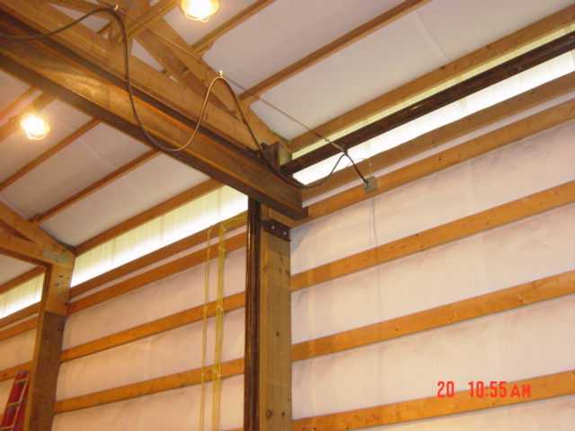

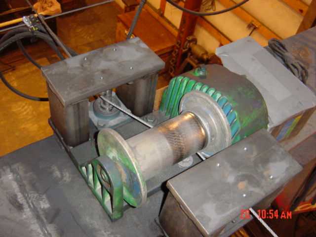

My span beam pulled by hand really easy, but when I needed to get close to the back of the shop I could not get enough angle to pull on the span beam. So I used a 120-volt winch to power the span beam.
#34

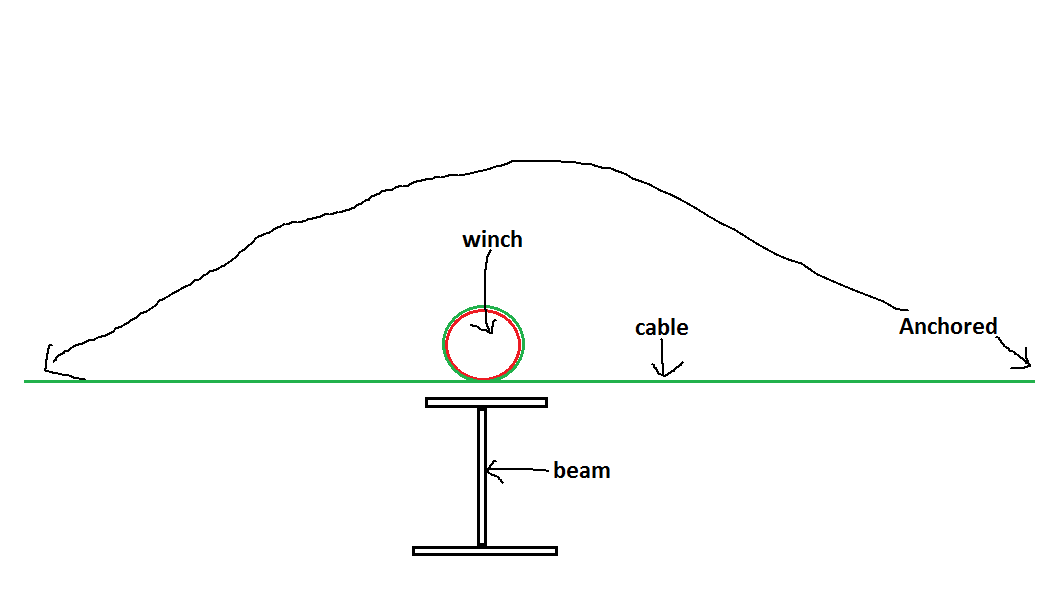

hard to see how the winch is set up.
IS it on the span beam? And one loop over the spool and cable anchored and either end? reversible? If thats what it is, I kinda like that Idea.
Something like this:
/ Building my bridge crane #35
You got it!:thumbsup: I had to build the fair leads, to make sure the wire rope did not ride over it's self.
Yes the winch is reversible. It works great!
