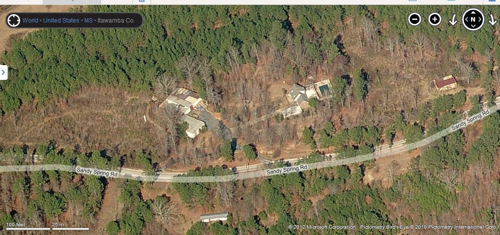

Unless you can get some assets reallocated perhaps your best bet is Bing.
An example of my house and shops in Mississippi.
HEY NOW! I have no control over such alleged assets!
Bing does have the newer sat maps from approx fall of 2011, it shows where I had most of the timber slash mulched... Before the fence project started... Zillow also uses that same sat image. I was hoping for something newer...
Thanks!
