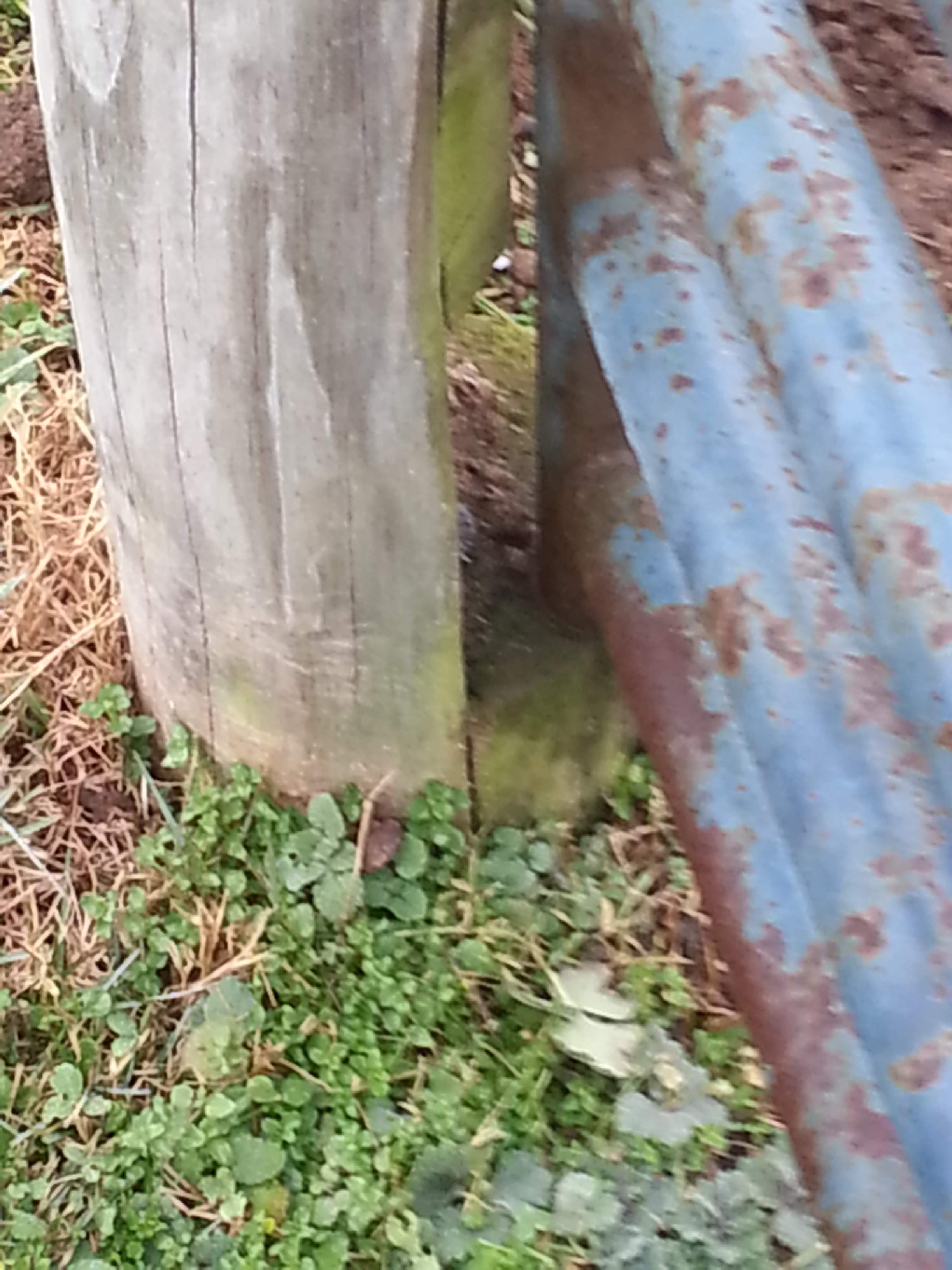

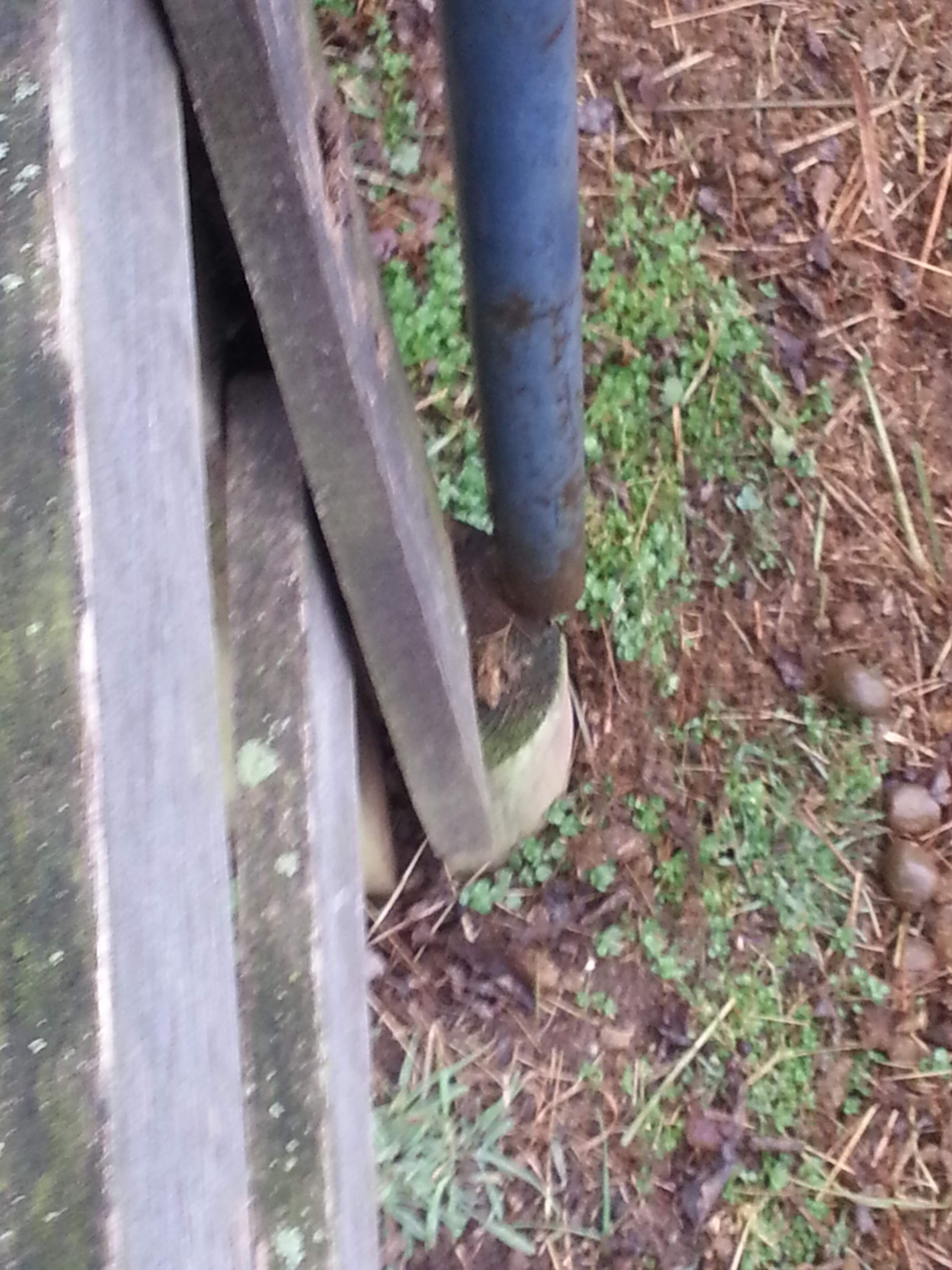

Here's some pictures of my gates. The black gate is 12' (11'6" opening) and the other one is 8'. I don't have a problem with it sagging when closed because as you can see the top board rests on a 1x sandwiched by another 1x that is a little higher to keep it closed. There is enough flex in the gate to lift it up over the outer board. If I was making a three board gate I'd probably put the supporting blocks (1x) under all three rails. The 12' one sags a little when open but I also keep it closed. You can see where I braced the hinge end. I didn't use diagonal braces because I wanted it to blend in. You can see the horses can't push out on the gate because it straddles the boards. Although on the 12' the gate doesn't straddle the face of the post enough. The horses could probably push the center of the gate to get it to flex open. I should've shifted the ends of the neighboring fence boards over a little more as they are not on center. A double post or wider post or even a chain would also fix that. For the hinges, I used carriage bolts through the boards and lag screws in the posts. Although horses are usually attended when in the arena, I would feel comfortable using this method in the pasture too.
Not sure how that got in there but since it is there, the bottom picture is of another use I found for the ratchet rake - poor man's forks. Yeah I know - a lot of weight way out front. I go low and slow. Another reason for a twelve foot gate.

I am SOOOOOO stealing this idea!
I may need to come over and put my hands on them to get a feel for how they work... I'm going to use gates like these out in the woods where I will have trails that the tractor or riders might want to use, occasional gates, closed 99.9% of the time... Those are VERY NICE...
I assume the posts are 1/2 rounds?

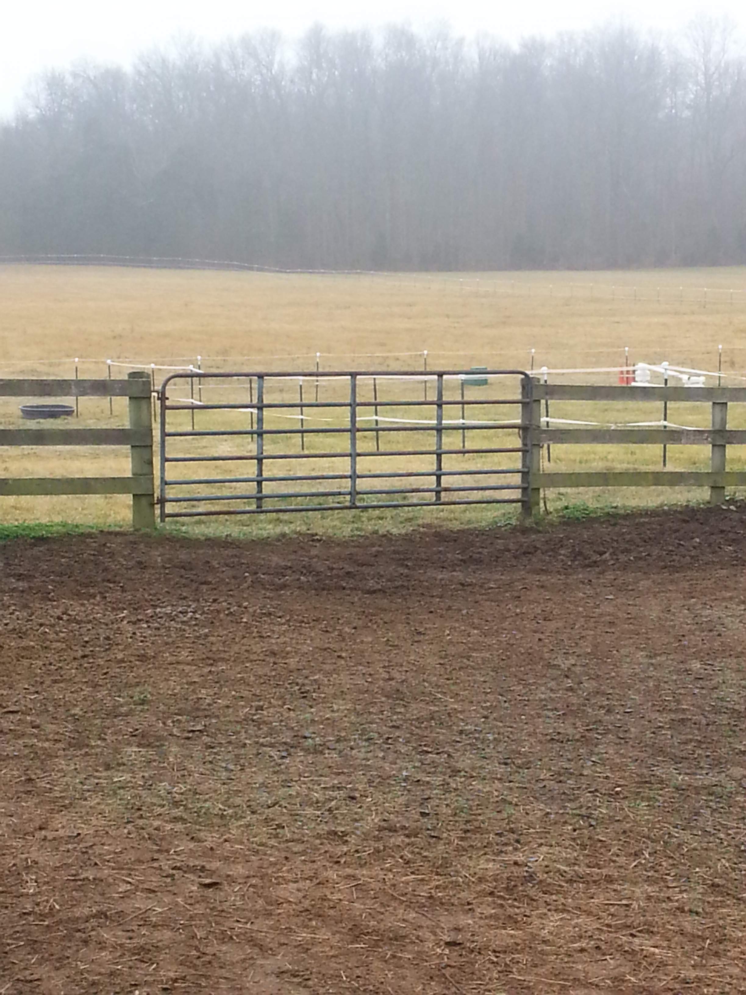

12 foot gate, cedar post fence, and wire mesh combo. Post area for throw-away spot. Mesh for pasture.
These are half-posts, the gate sits on a half buried next to the other half holding the fence up. Buried next to each other, they make the gate opening sturdy. IMHO.
