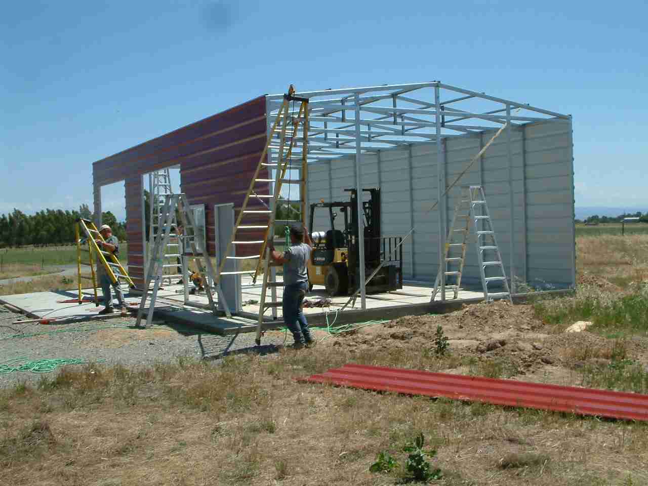

Here's a photo of the 24'x42' metal pole garage/shop I had built last June. Has 12' walls, two 10'x10' roll up doors, one window, one 36" mandoor. Cost: $16,300 installed. You can buy the material in kit form for about $11K.
The concrete slab is 6" thick with #4 rebar on 24" centers both ways. Cost: $7500.
You and a few helpers could assemble a building like this without much problem. I had it built because I'm too old for that type of stuff. My installer had a chop saw with metal cutting blade, a couple of air-powered screw guns, a power metal shear and a forklift to get the trusses in place. The siding came in 3" high sections, 24' or 42' in length.

Typo detected: the siding came in 3-ft high sections, not 3". You can see a piece of it in the foreground lying in the weeds.

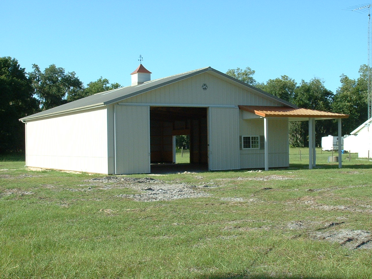

Quick update. My building is complete with the exception of the floor. The cement is being poured Friday.
/ Building advice needed #34
Jim,
That is a nice looking building. I like seeing steel buildings that are dressed up with overhangs on the roof, coopalas, a porch roof, etc... I think it really adds to the visual appeal.
