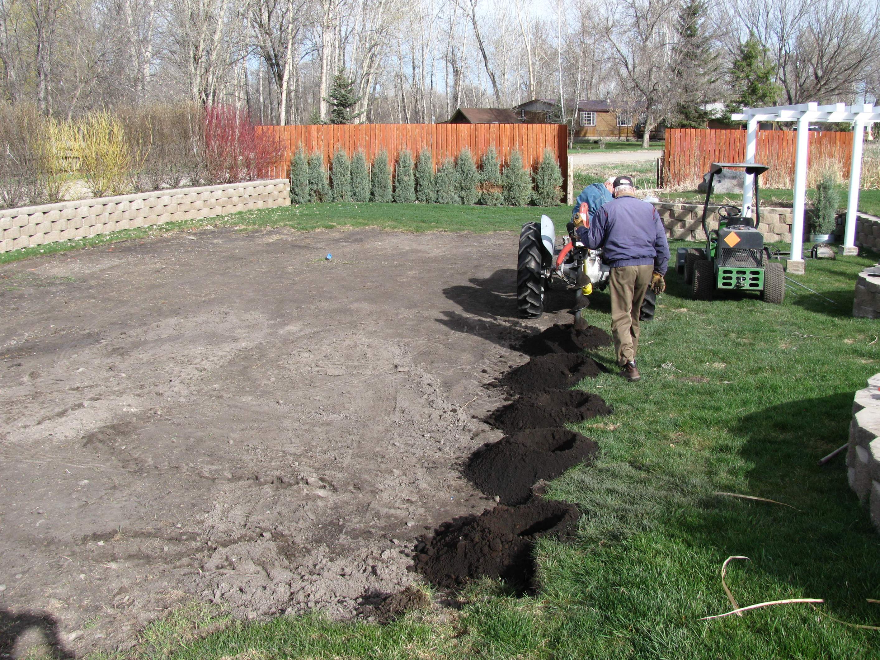

/ Building a Greenhouse
Drilled holes 30 inches deep, 4 feet apart for the 2 inch pipe.
PJ

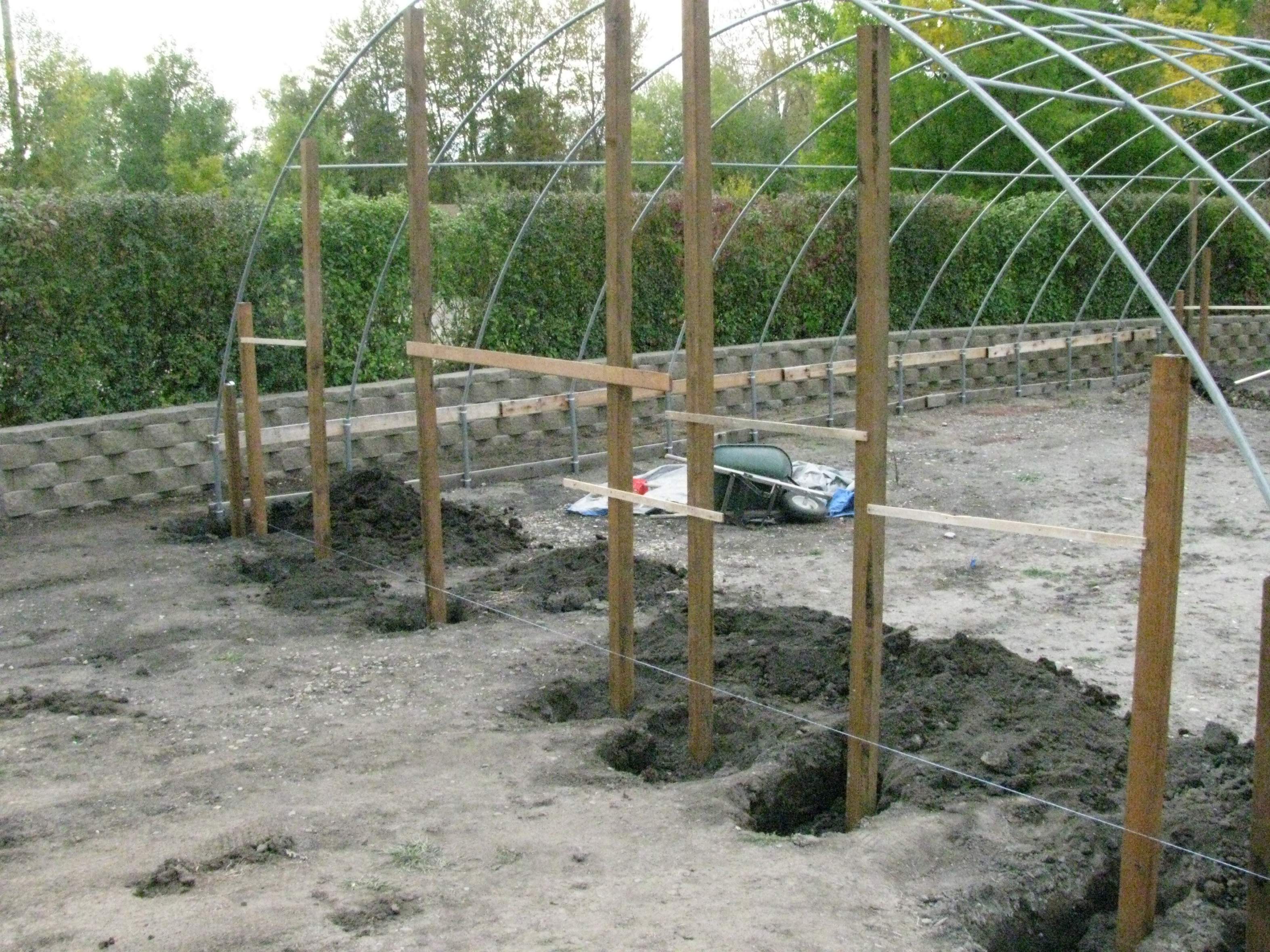

Used plum line to get 2 in pipe about level. Did not cement in each pipe.
PJ

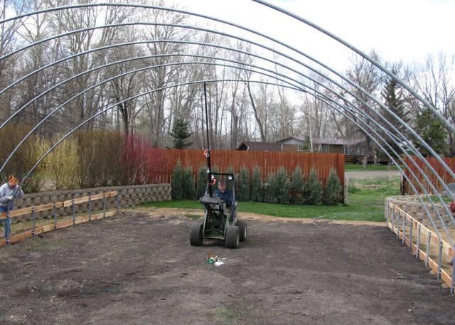

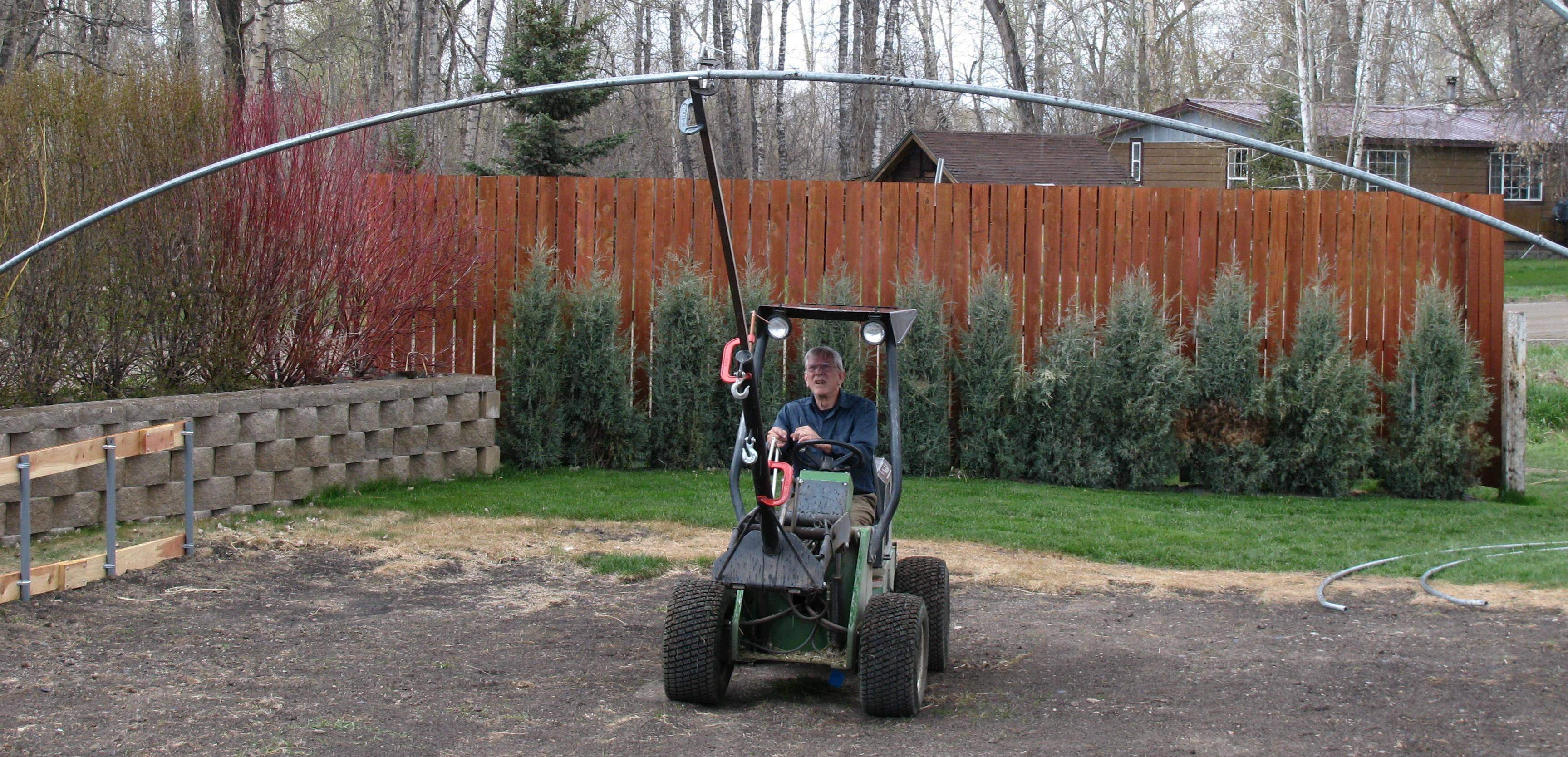

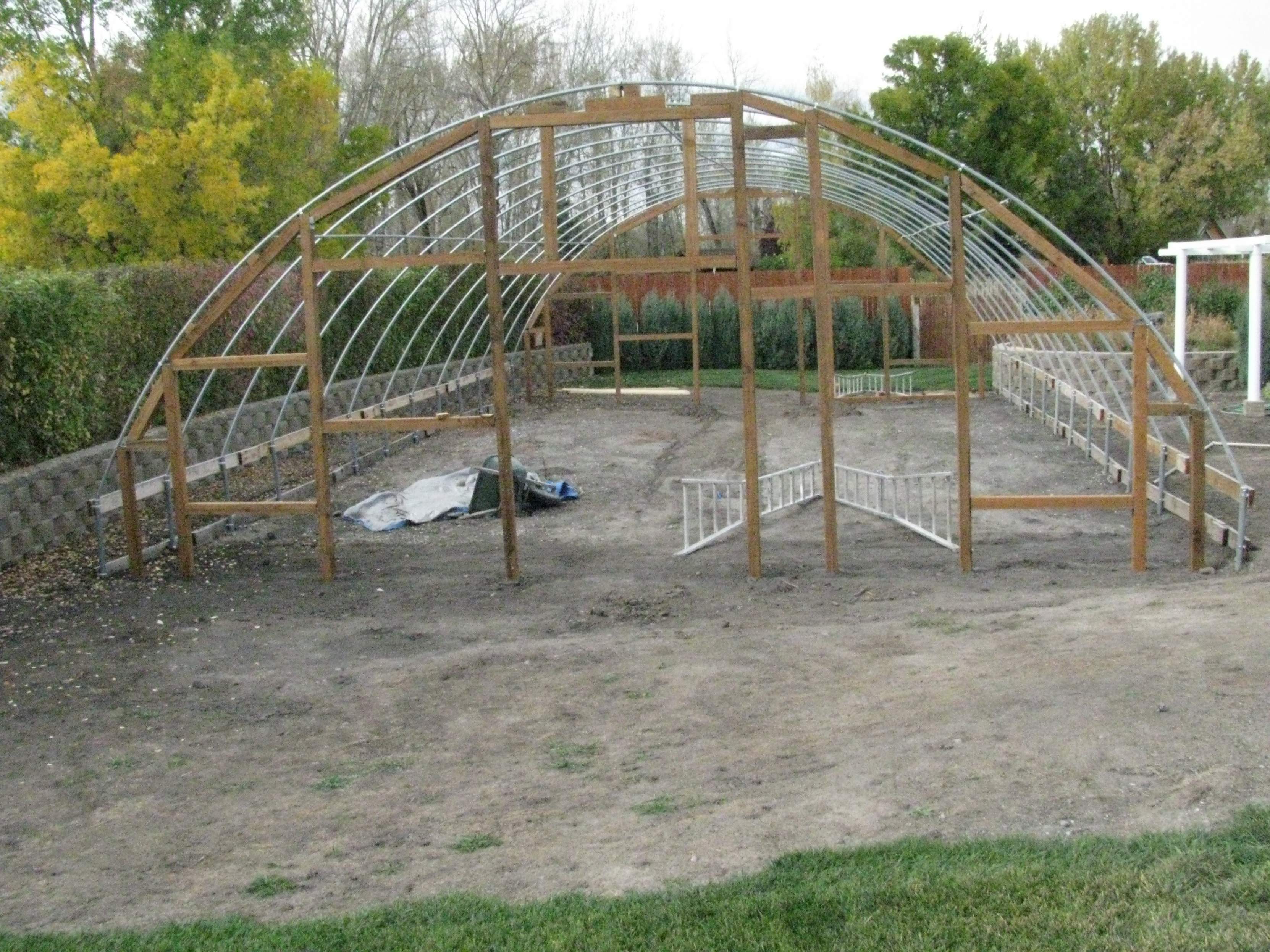

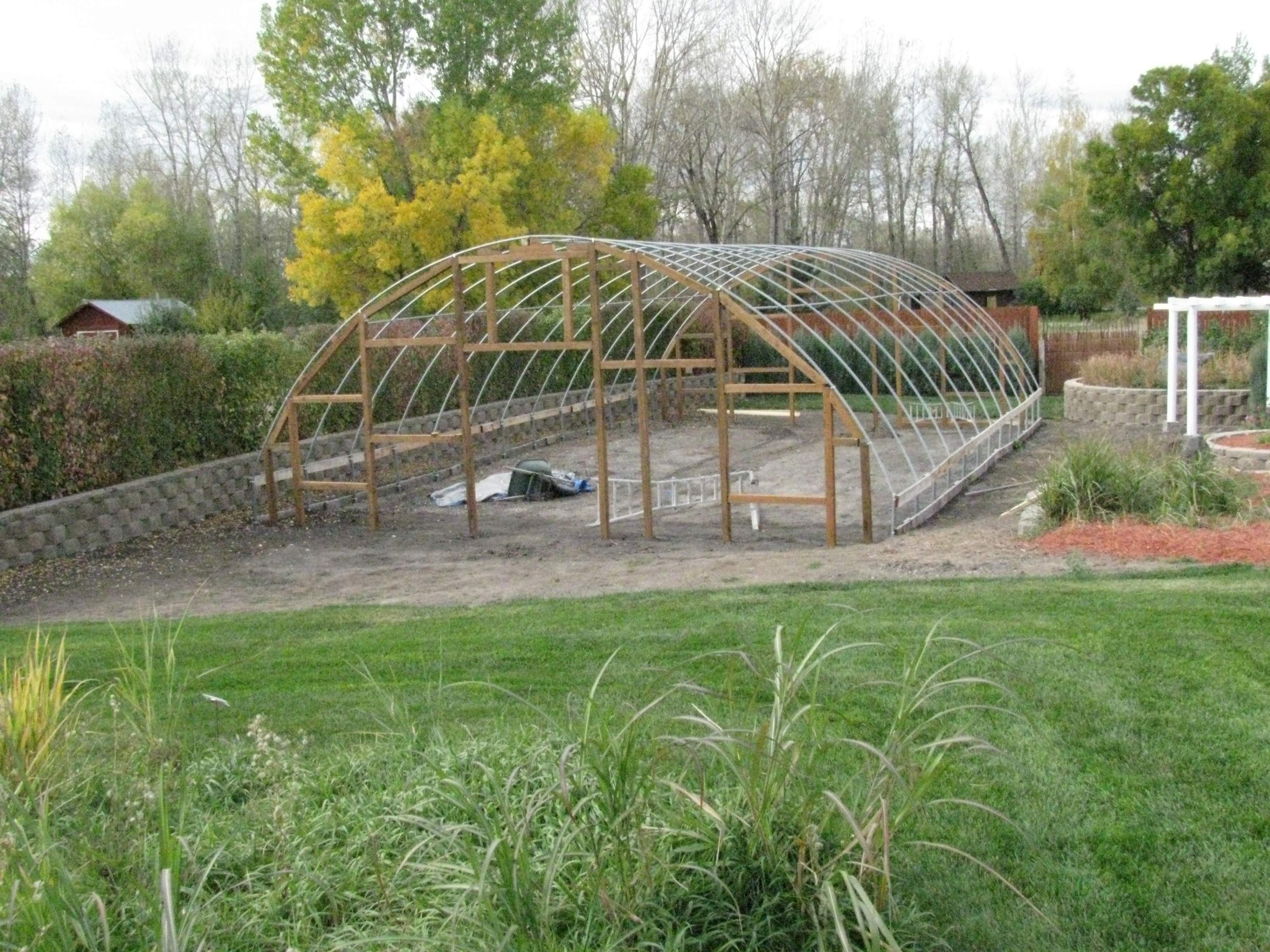

Put a square pipe on my boom pole to extend its reach. Worked very well as I had a bent piece of metal on end to secure ribs while lifting.
PJ
The width is 30 feet. The ribs are just a little longer so must be pushed toward center to place in the 2 pipe. The rib material is 1 3/4 inch. Has tapperd ends.
PJ
#9
Putting the side rails on. Each 4-foot span is bolted to side rail then attached to the end 4 x 4's.
PJ

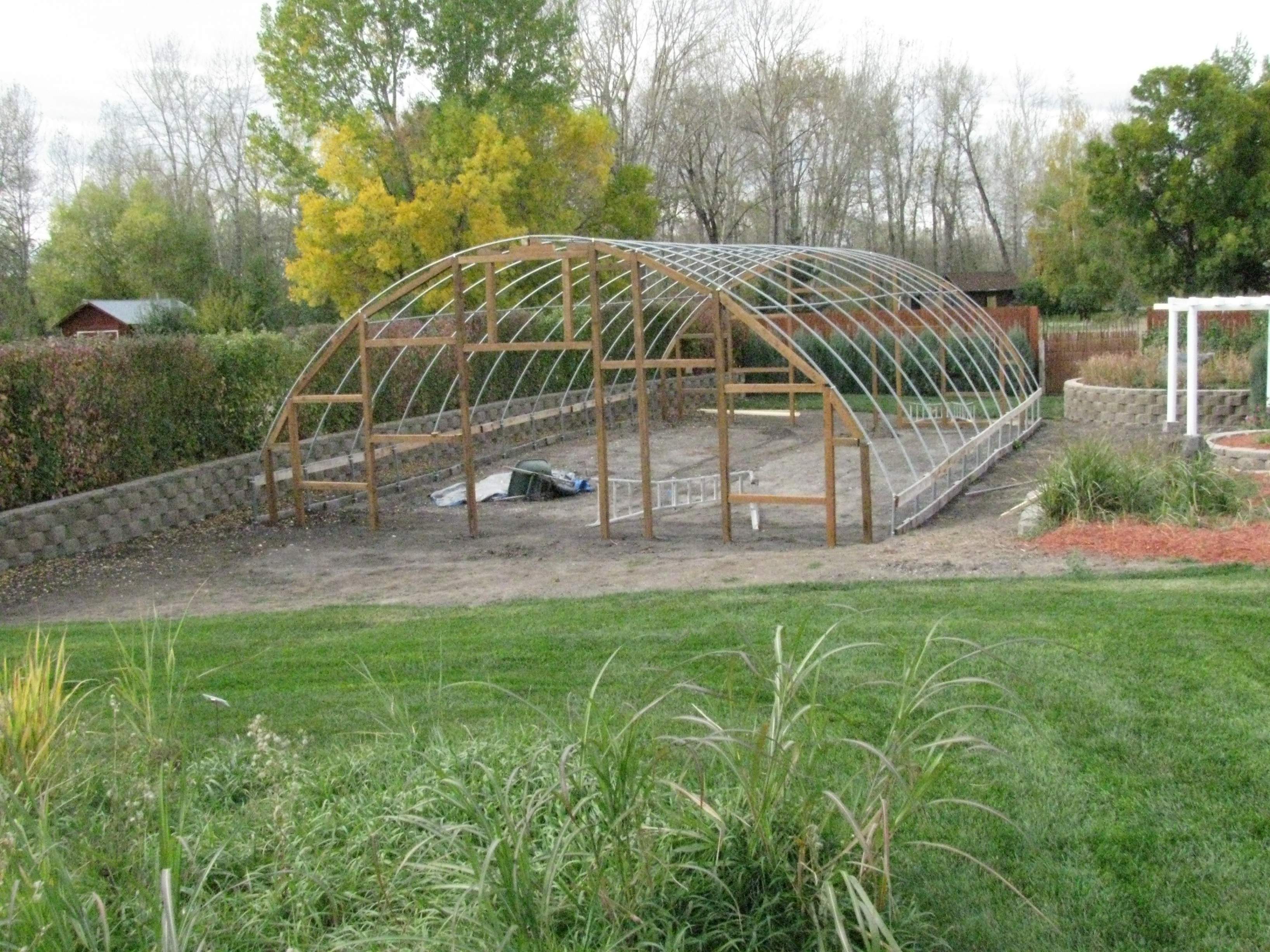

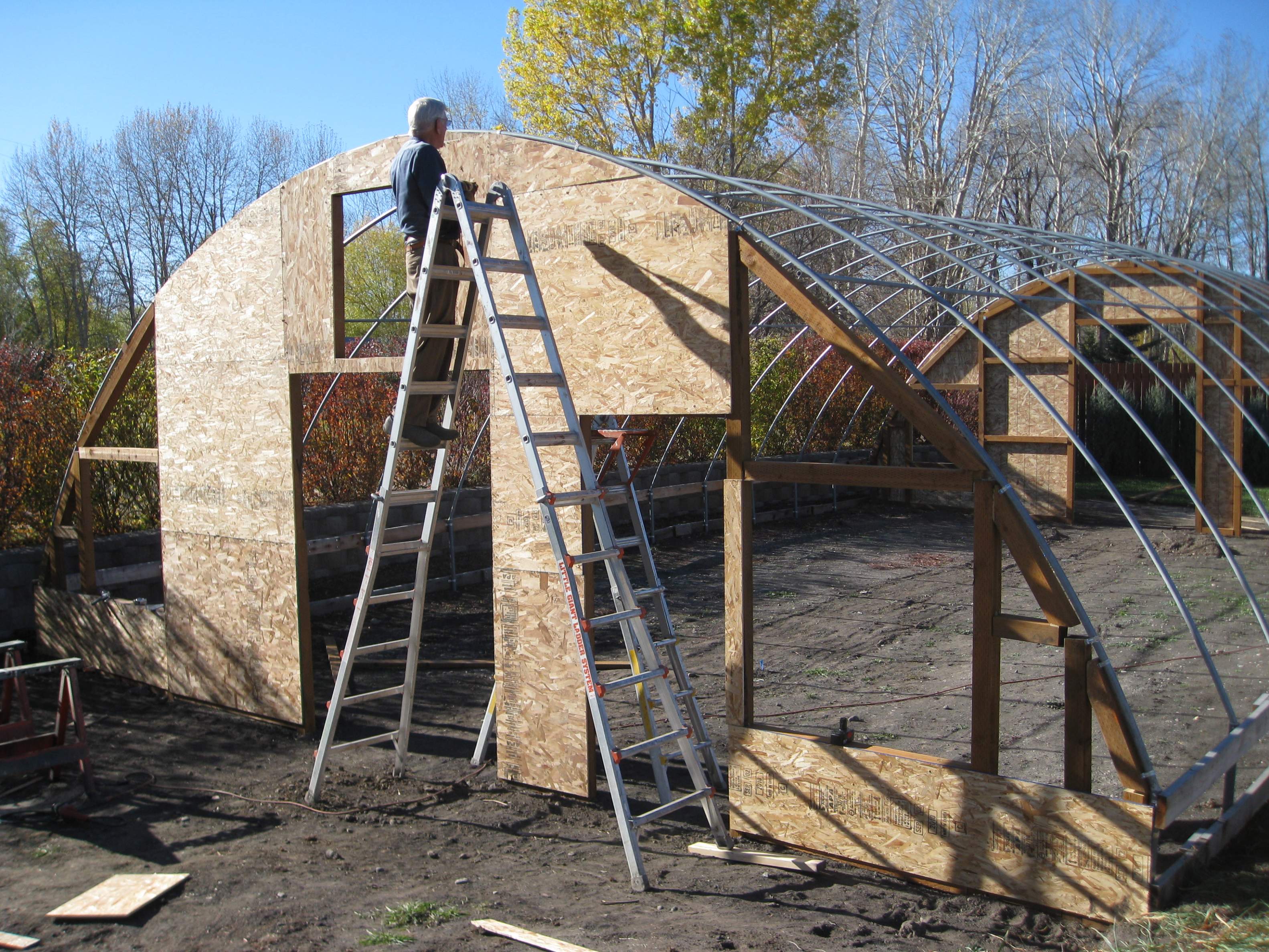

All ribs and ends are completed.
PJ

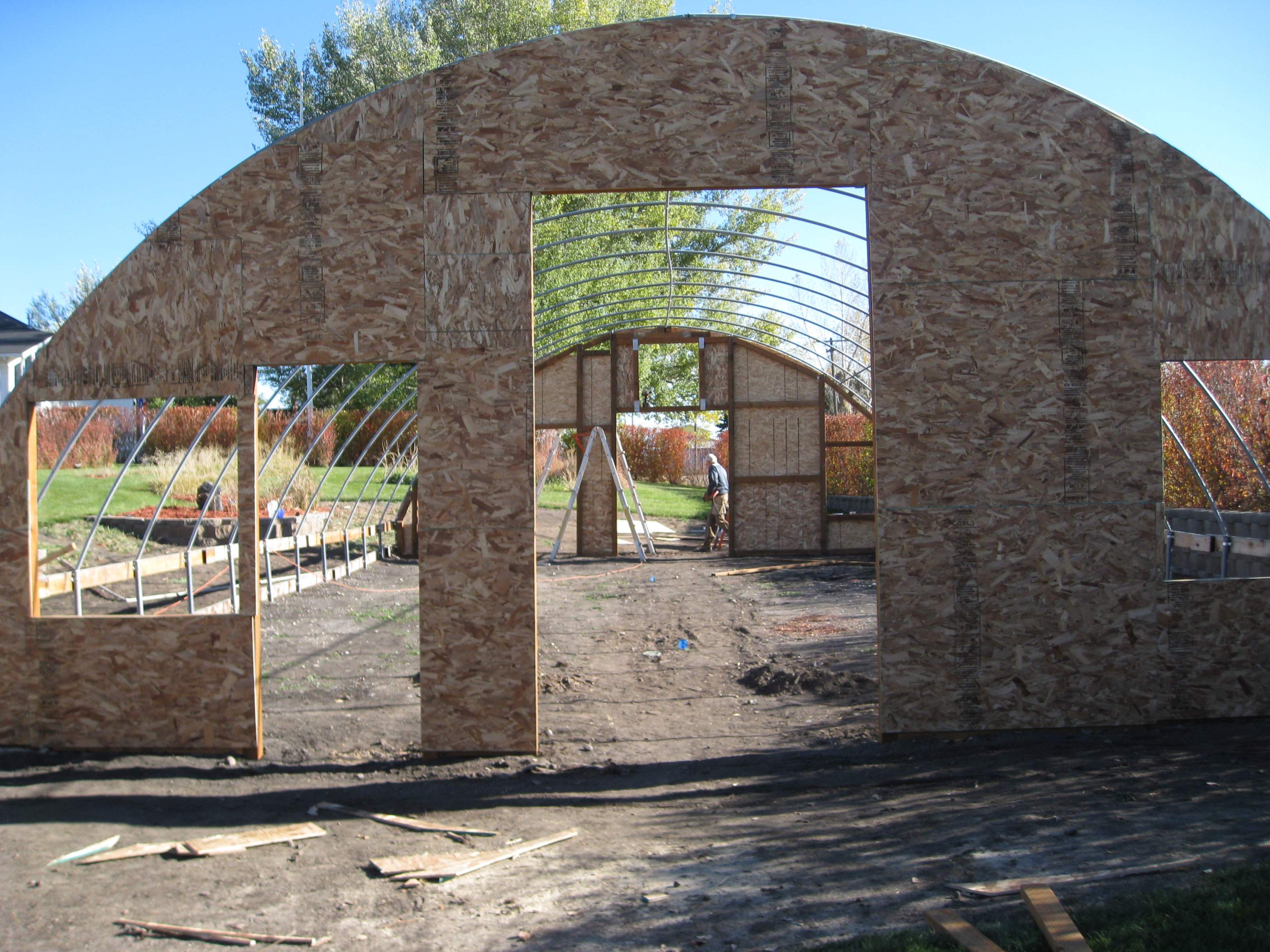

#11
Plywood puzzle.
PJ

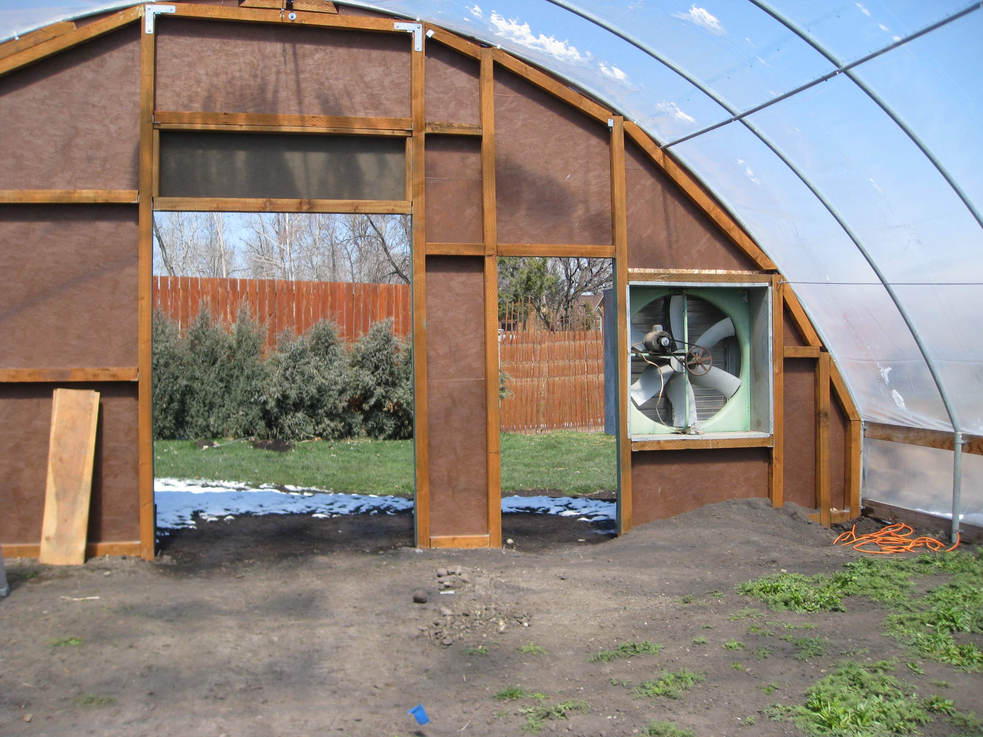

#12
Ready for fans and doors.
PJ

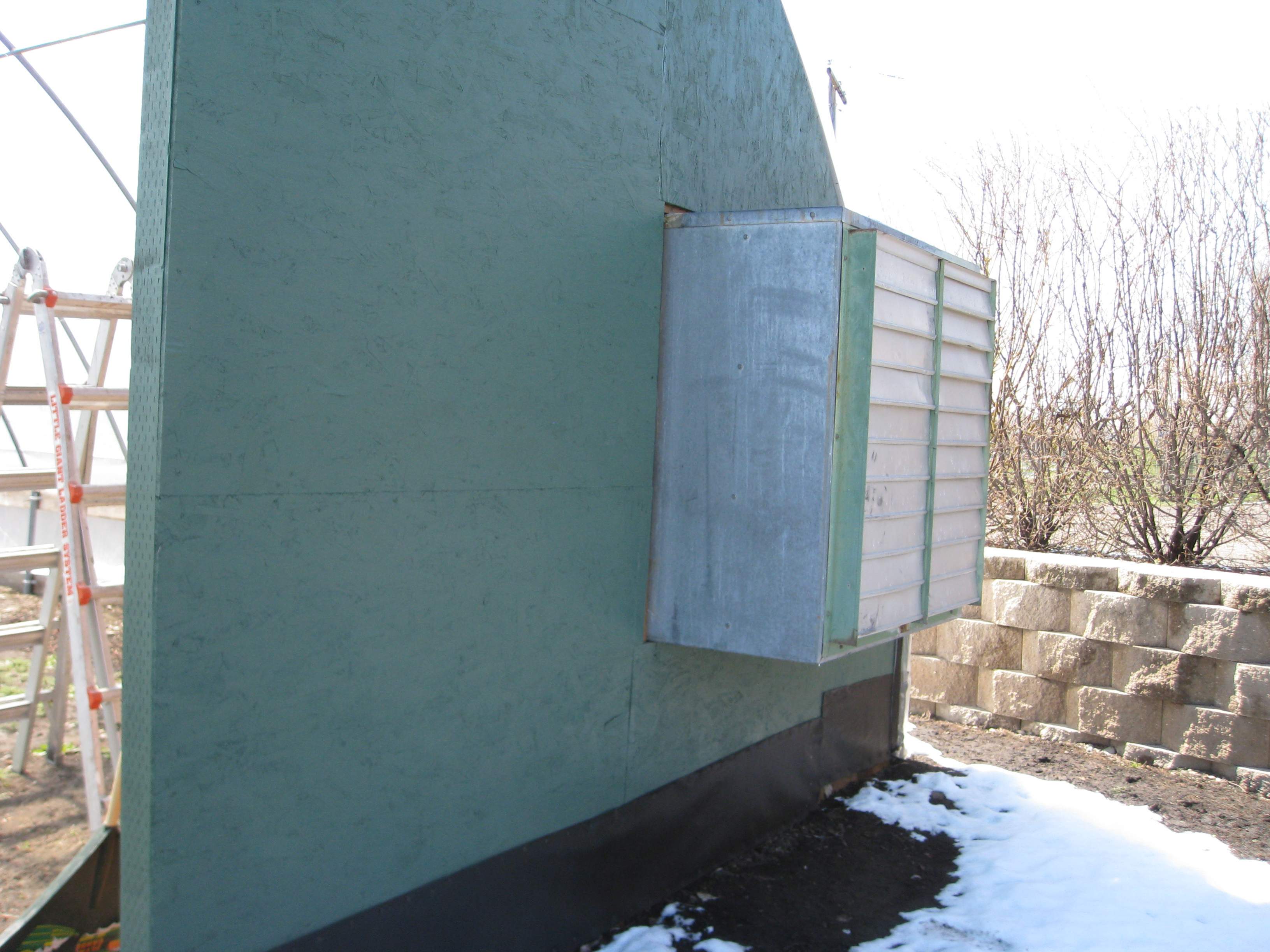

#13
First 48 inch fan in place.
PJ
#14
What it looks like from the outside.
PJ

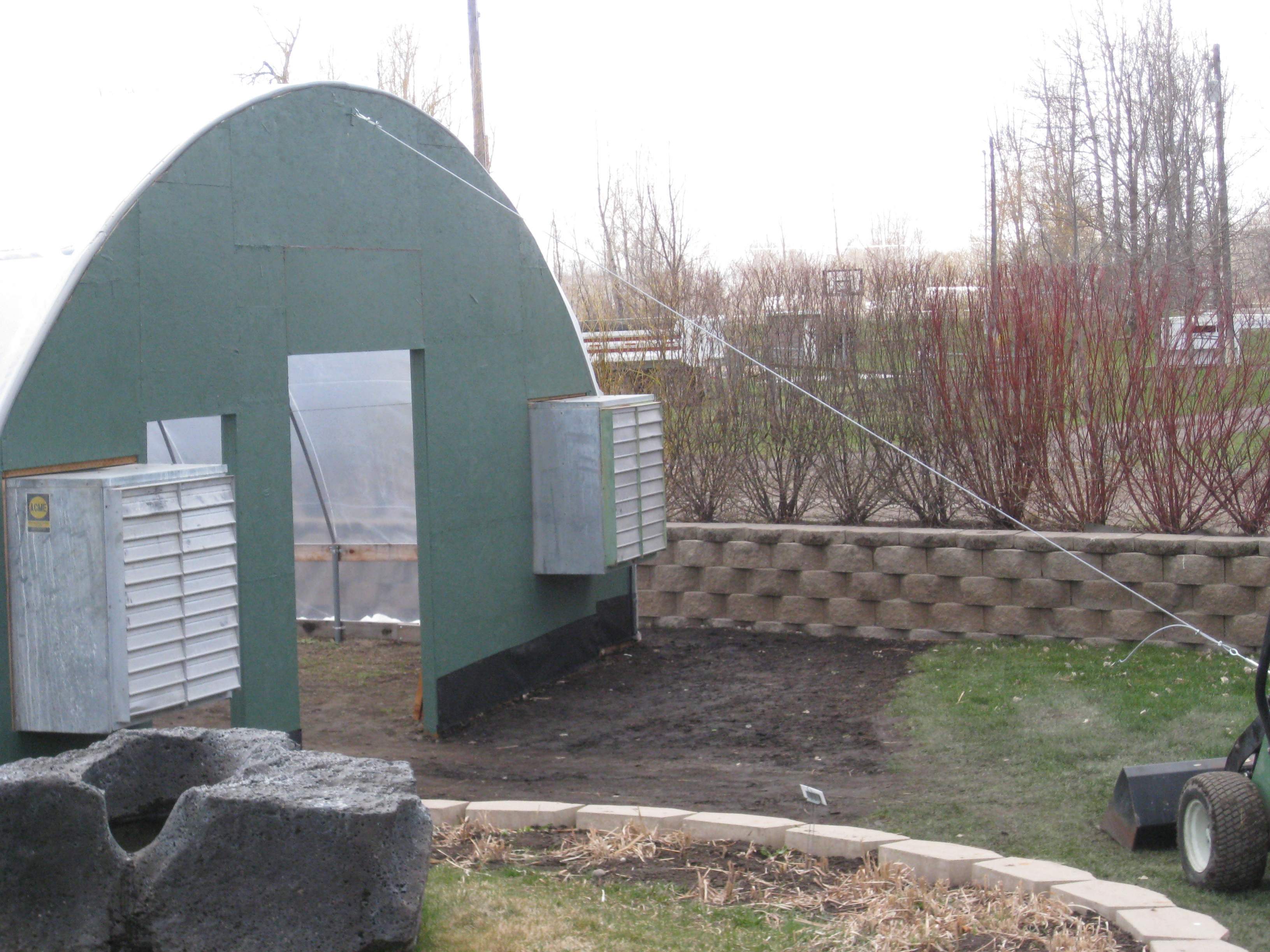

#15
All in place.
PJ

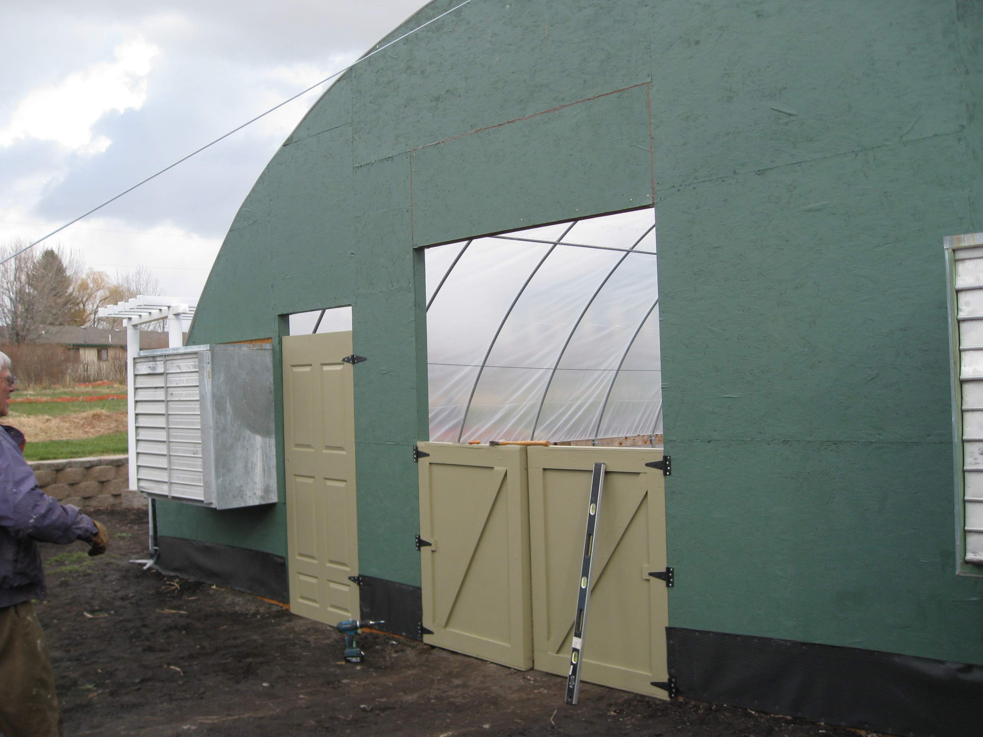

#17
Barn door type going in.
PJ
#18
Ready for the other end. Top will be wire mesh on frames for summer and covered in winter.
PJ

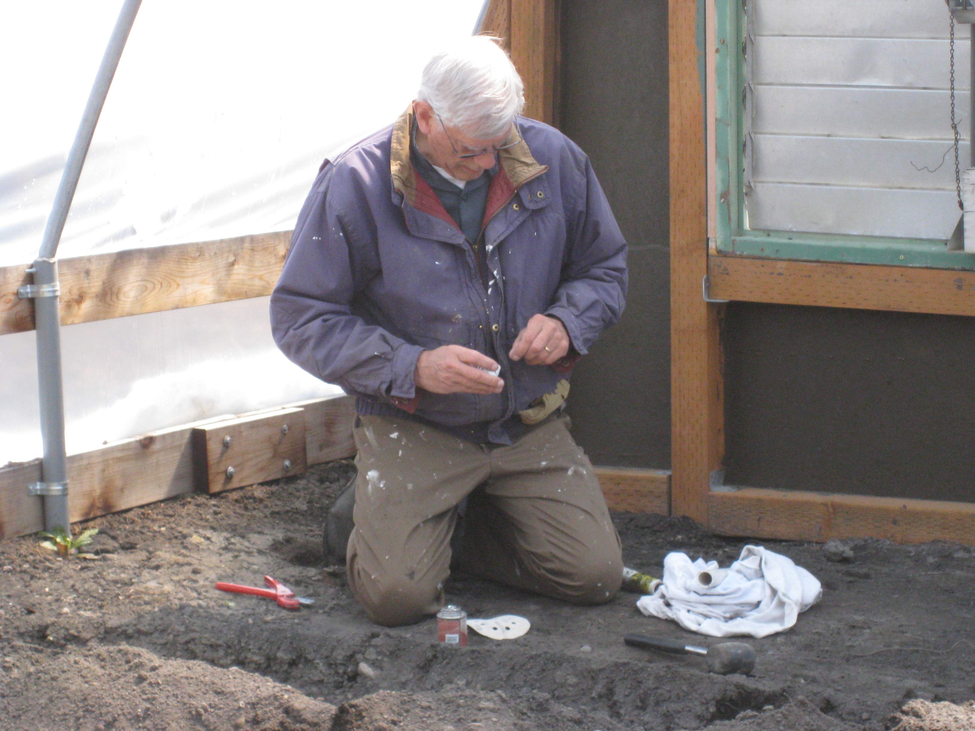

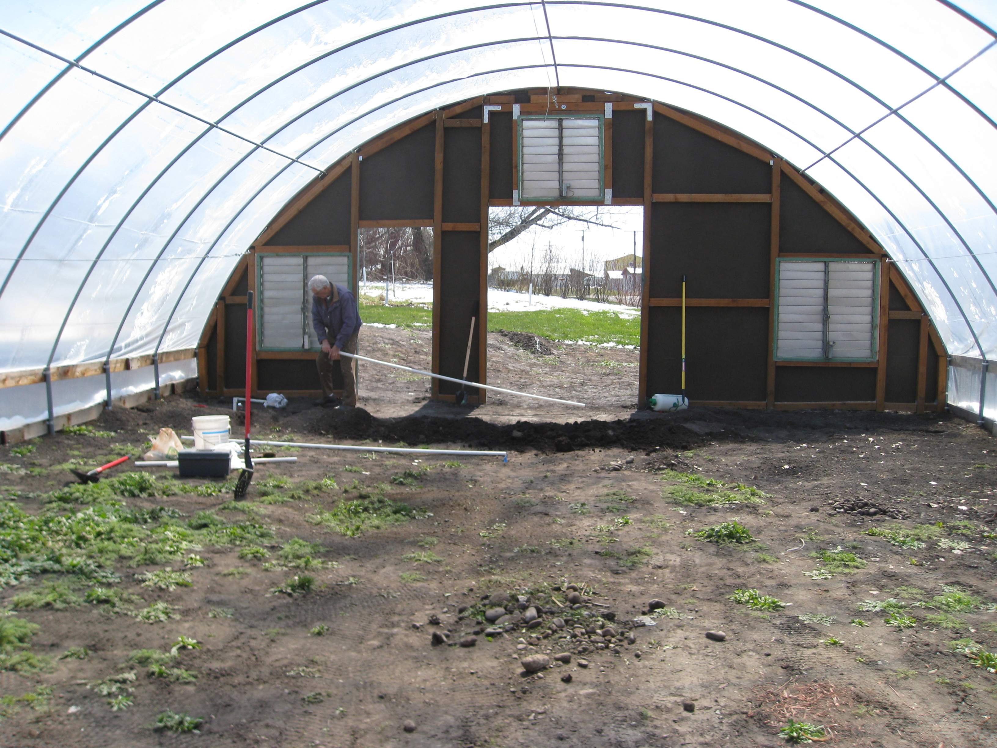

#19
Trenched underground water into greenhouse.
PJ
#20
52 x 52 6 mil greenhouse film carried out of garage to driveway.
PJ
