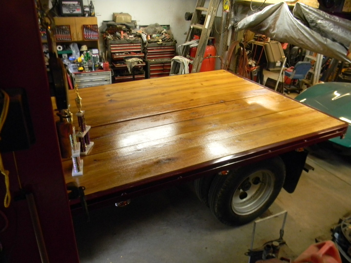

Here's one I built for a classic truck I had for a few years. 10'6" long x 84" wide. Rough cut 2x10 hemlock for that old look. Color matched paint to body. Mainly built as a show truck. Won a few trophy's for best in class original truck.
Your's is progressing very well.

Wow that looks great, how did you do the rounded corners?

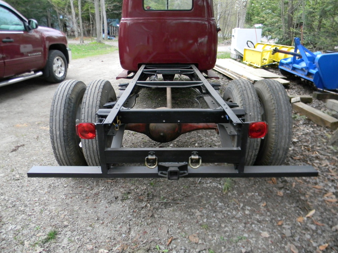

George,
Very nice build looks great. Been awhile since I had a truck with the fuel tank behind the seat too.

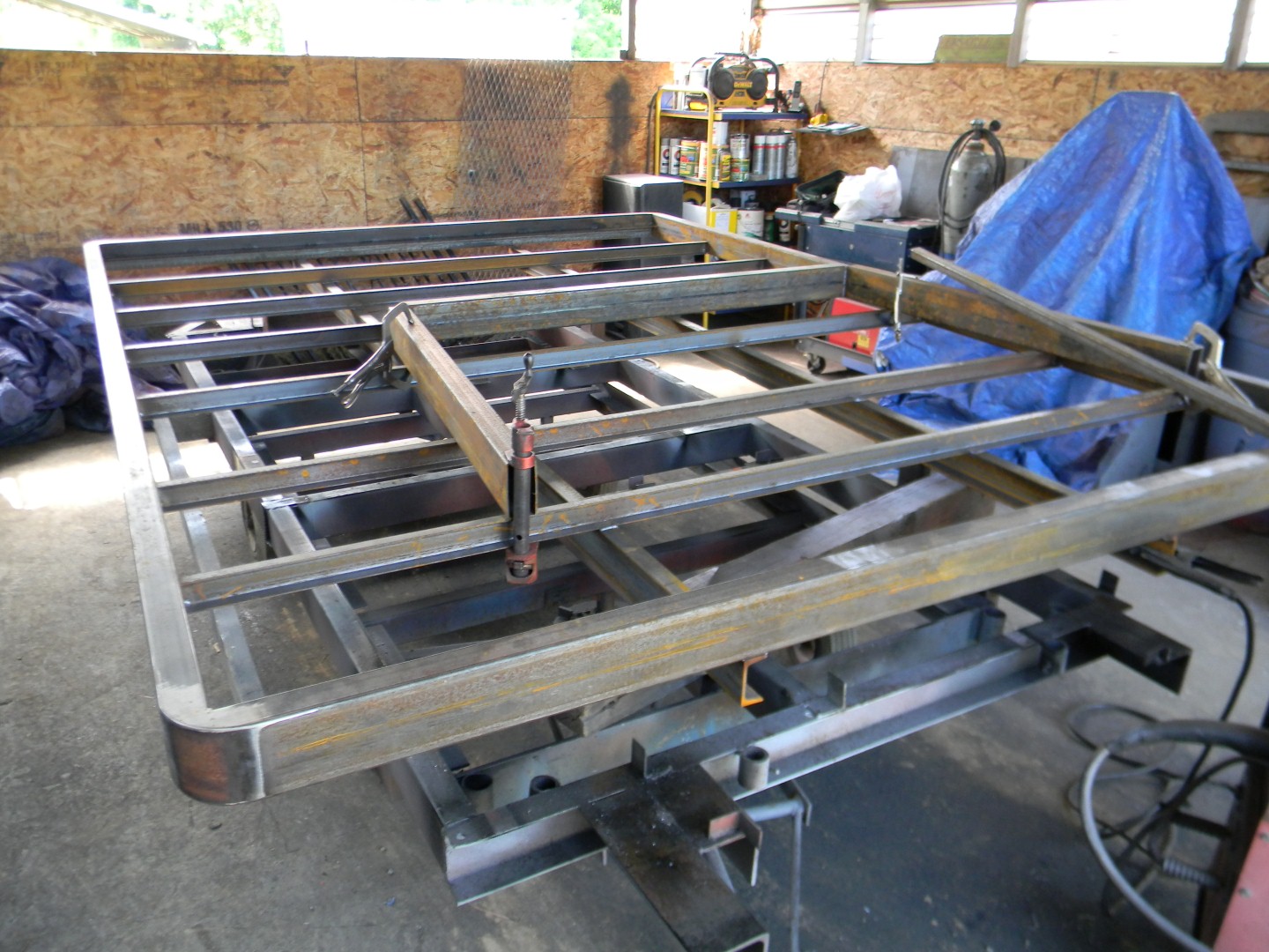

Corners are flat steel carefully heated and bent around a 3" pipe clamped in vise, curved to fit and pieces to fill the gaps welded in a ground down. Took a long time to cut and bend by hand but wanted the round corners to kinda fit in with a round body truck. A plasma torch would have made cutting things easier but couldn't justify buying one. Mostly used torch, 4" cutoff wheel, 4" grinder, and welder to build. Rectangle tubing steel and 1 x 3 channel for cross braces, diamond plate for rear apron.

George,
I enjoyed going to car shows with it but driving it was time consuming (especially going to distant shows) with the numerically high rear end and top speed of about 50 MPH. Sold it last fall and got something more comfortable and faster.
