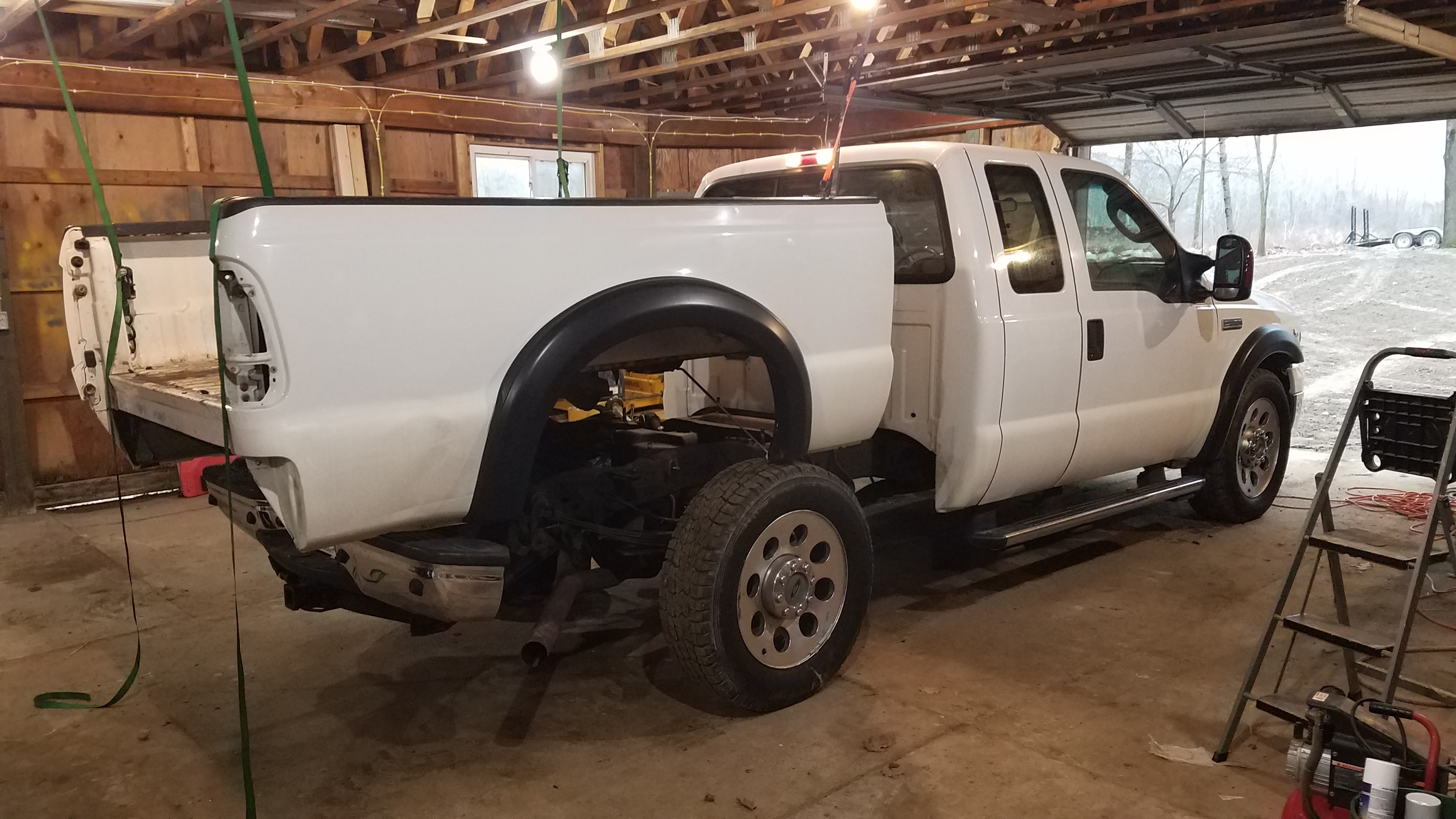

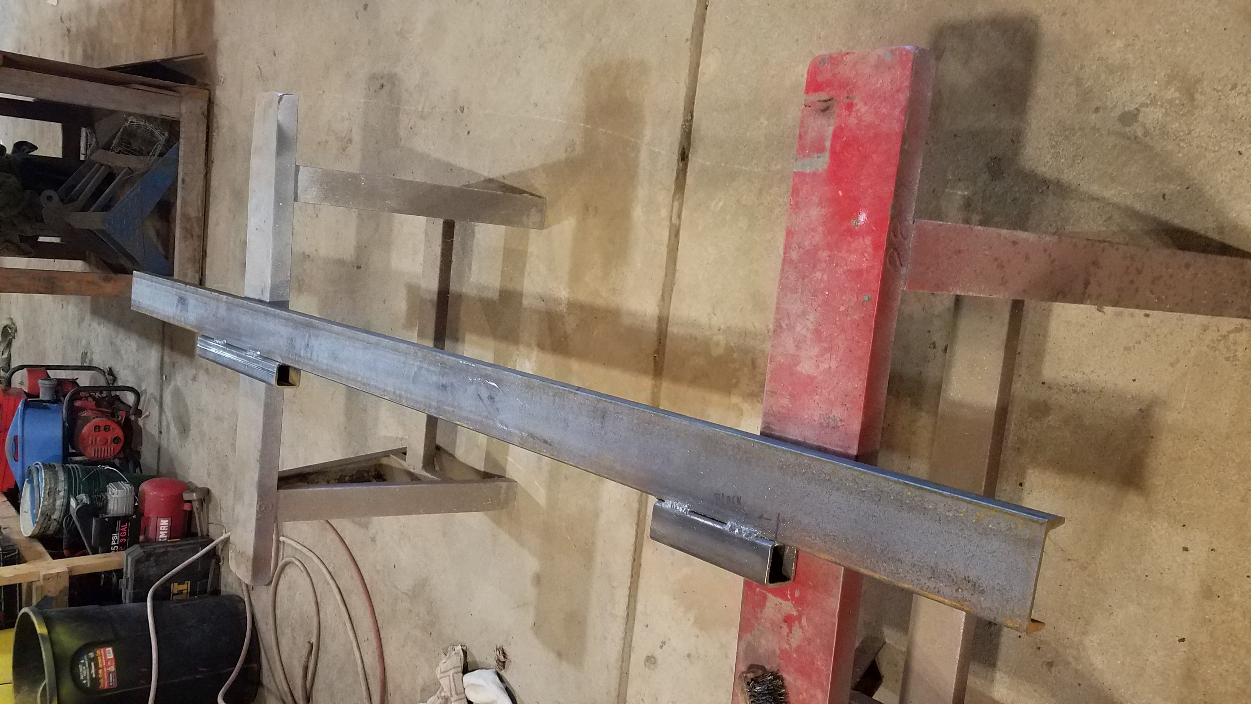

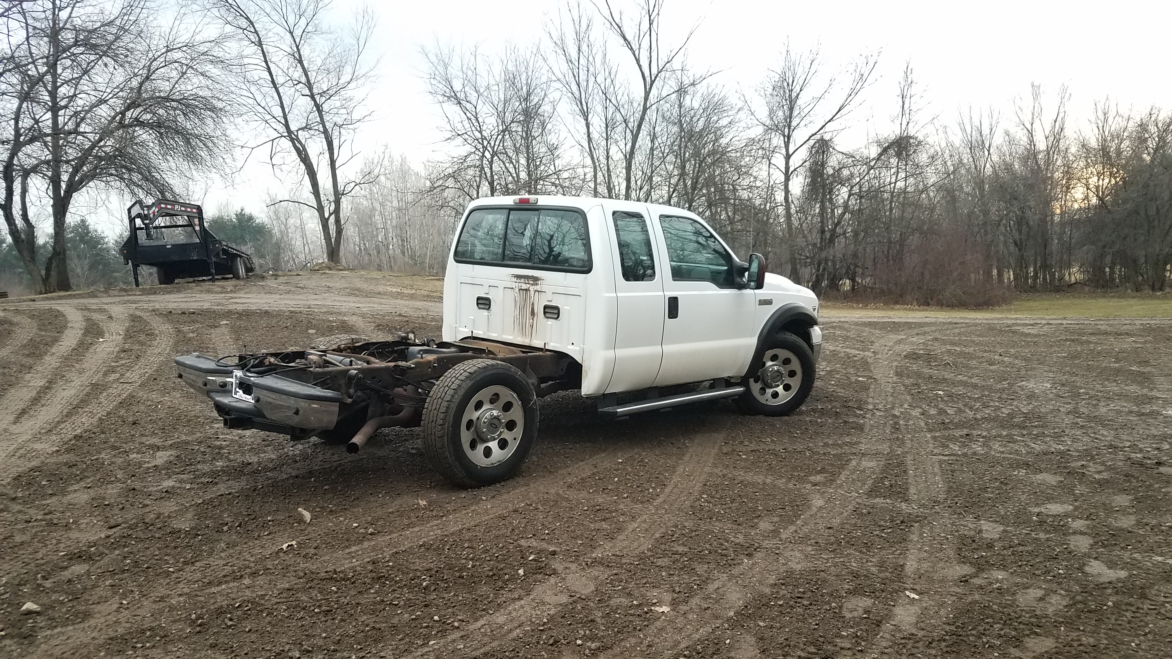

Ongoing project... I'll post updates as it goes. I'm hoping to complete the project within the next couple weeks. This is going on my 05 F350 ShortBed. The flatbed will measure 94"x80". The deck material will be wood.
Took the bed, bumper, tailgate, lights... off the truck and sold them on Craigslist.

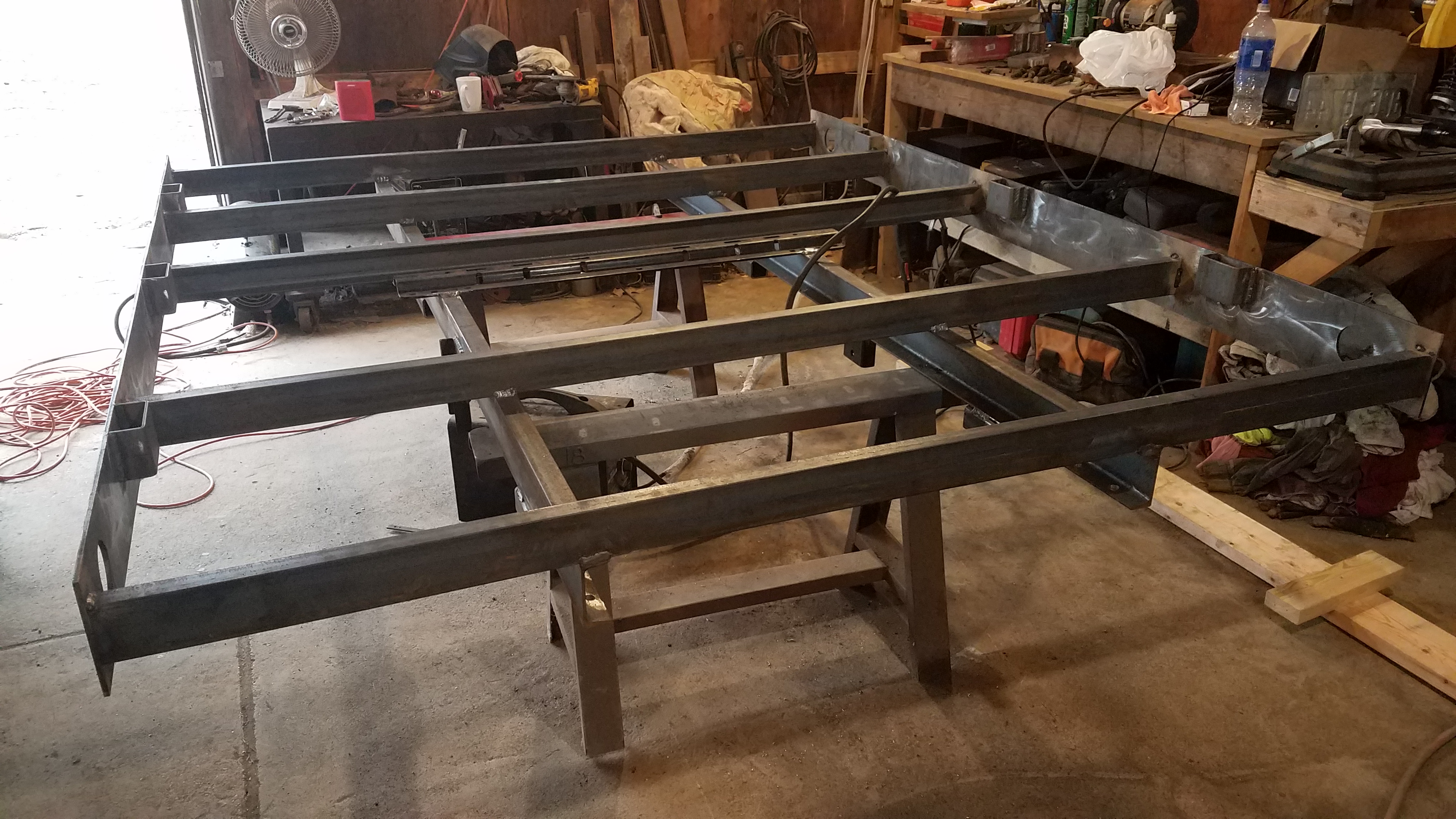

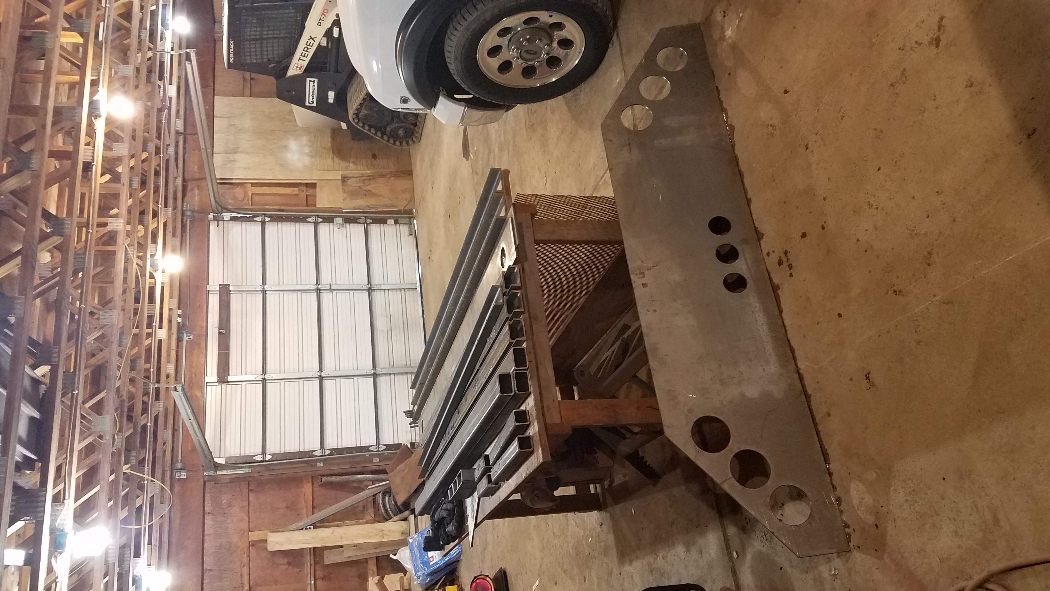

Picked up my steel order from my local steel shop. I have about $750 in steel (which includes the custom cuts). I'm using heavy gauge structural C-channel for the framing. 1/4 " plate for the side rails. 3/16 " plate for the rear "apron". I'll be building the bulkhead/headache rack out of 3/16" walled 2"x3" box tubing.

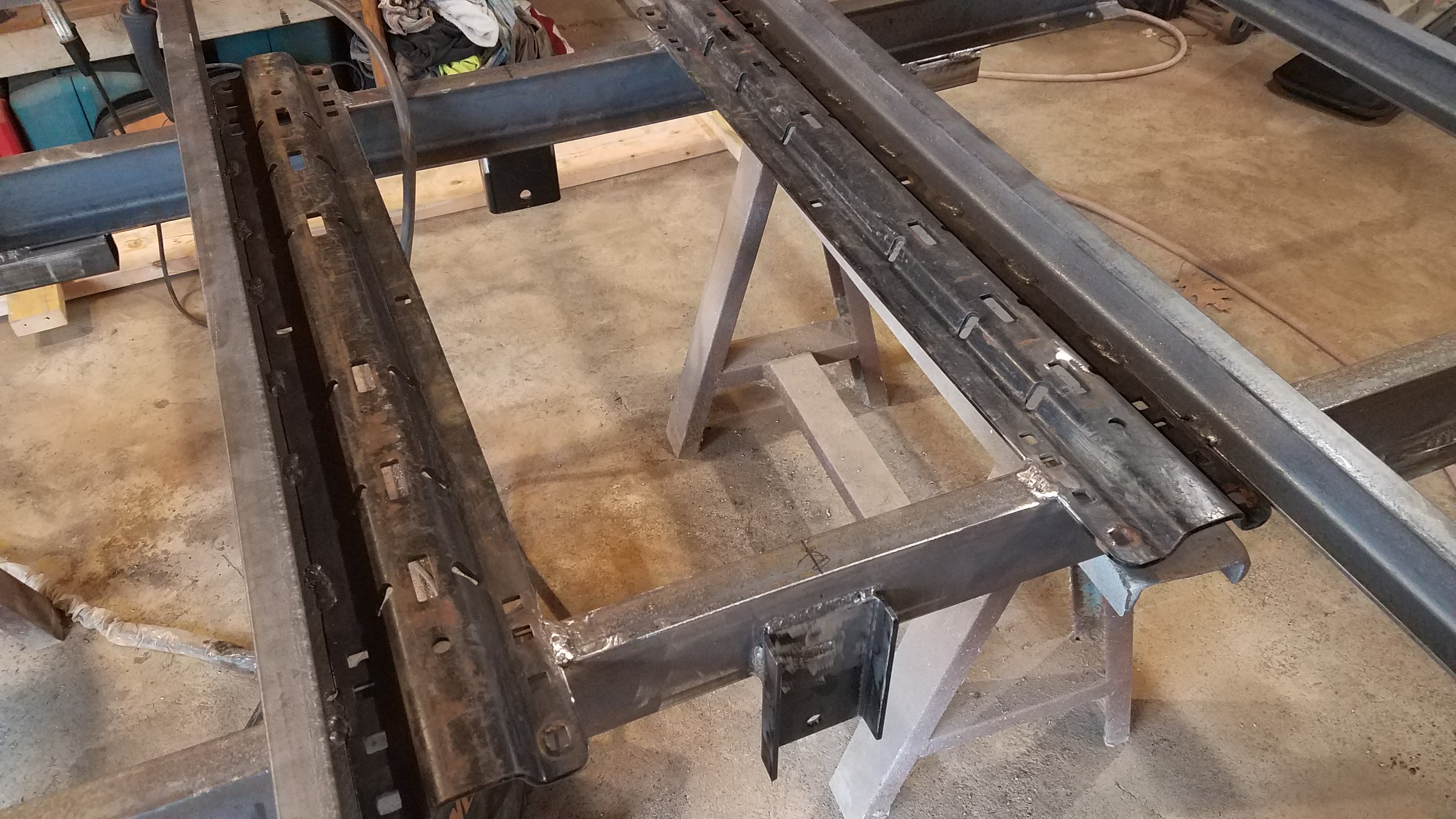

I'll be retaining the factory rear trailer hitch, but building in recessed 5th wheel rails with a gooseneck adapter plate (for towing flexibility).

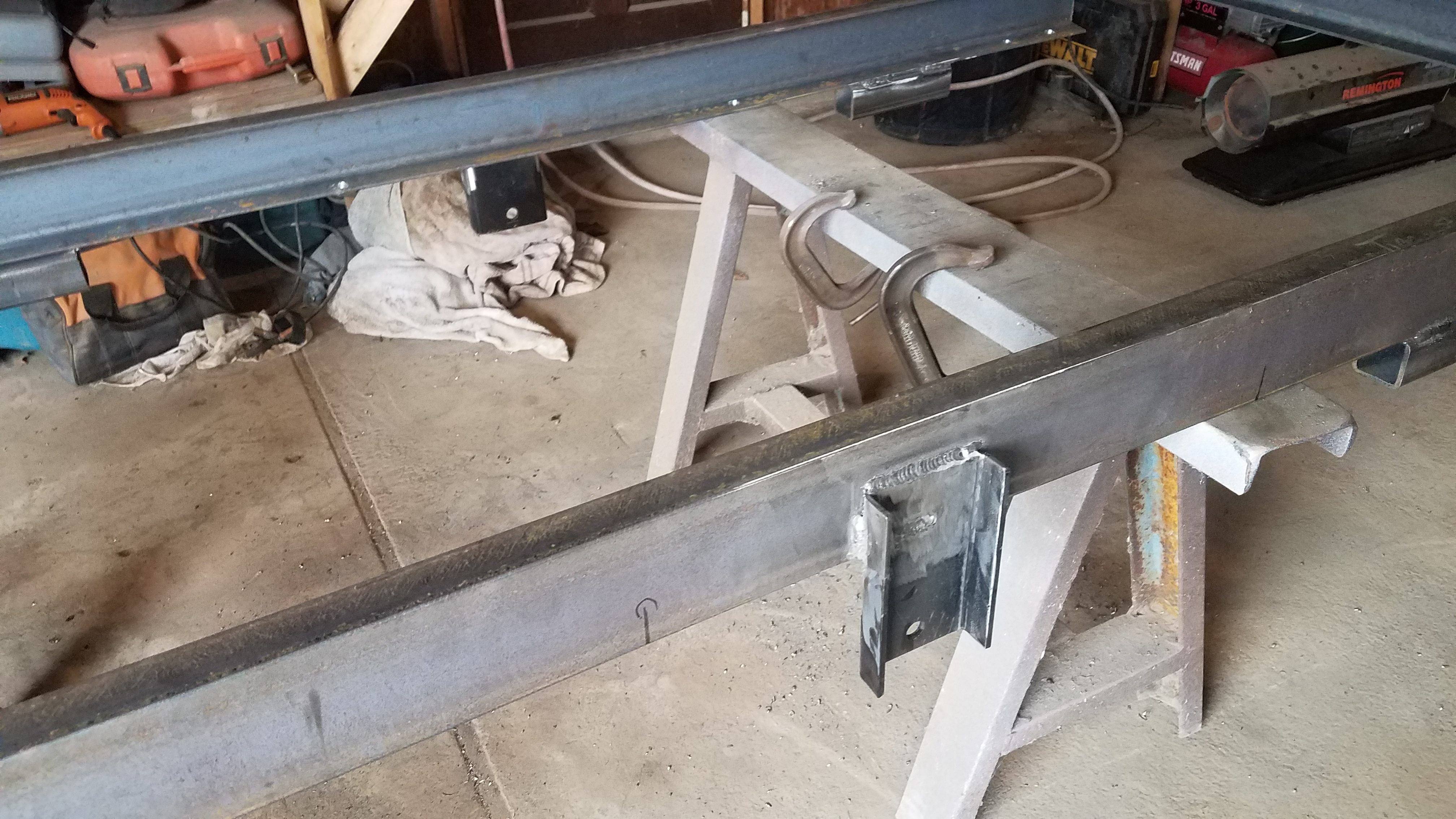

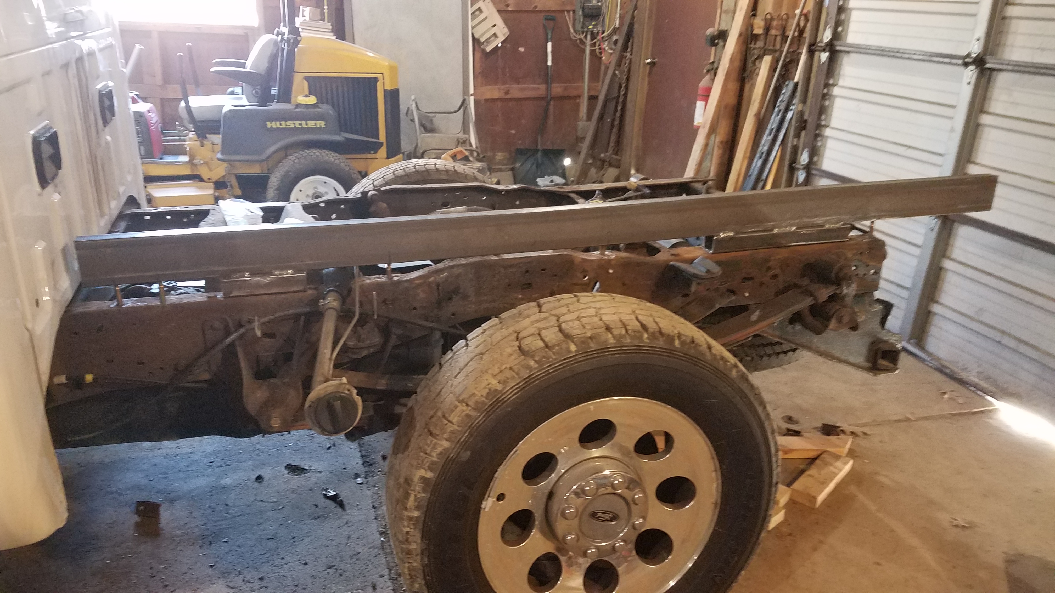

Spacer blocks for the frame rails:
Each frame rail will be mounted to the truck frame with (5) 5/8" grade 8 bolts, bolted thru the original mounting holes on the top side of the truck frame. There will be an additional (not pictured) 5/8" bolt on the outer side of each frame rail, bolted thru a C-channel bracket.
So in total, this flat bed frame will be mounted to the truck with (12) 5/8" grade 8 bolts.
Now that the mounting points are drilled and completed, today i can start welding the cross-channel pieces.
More to come...

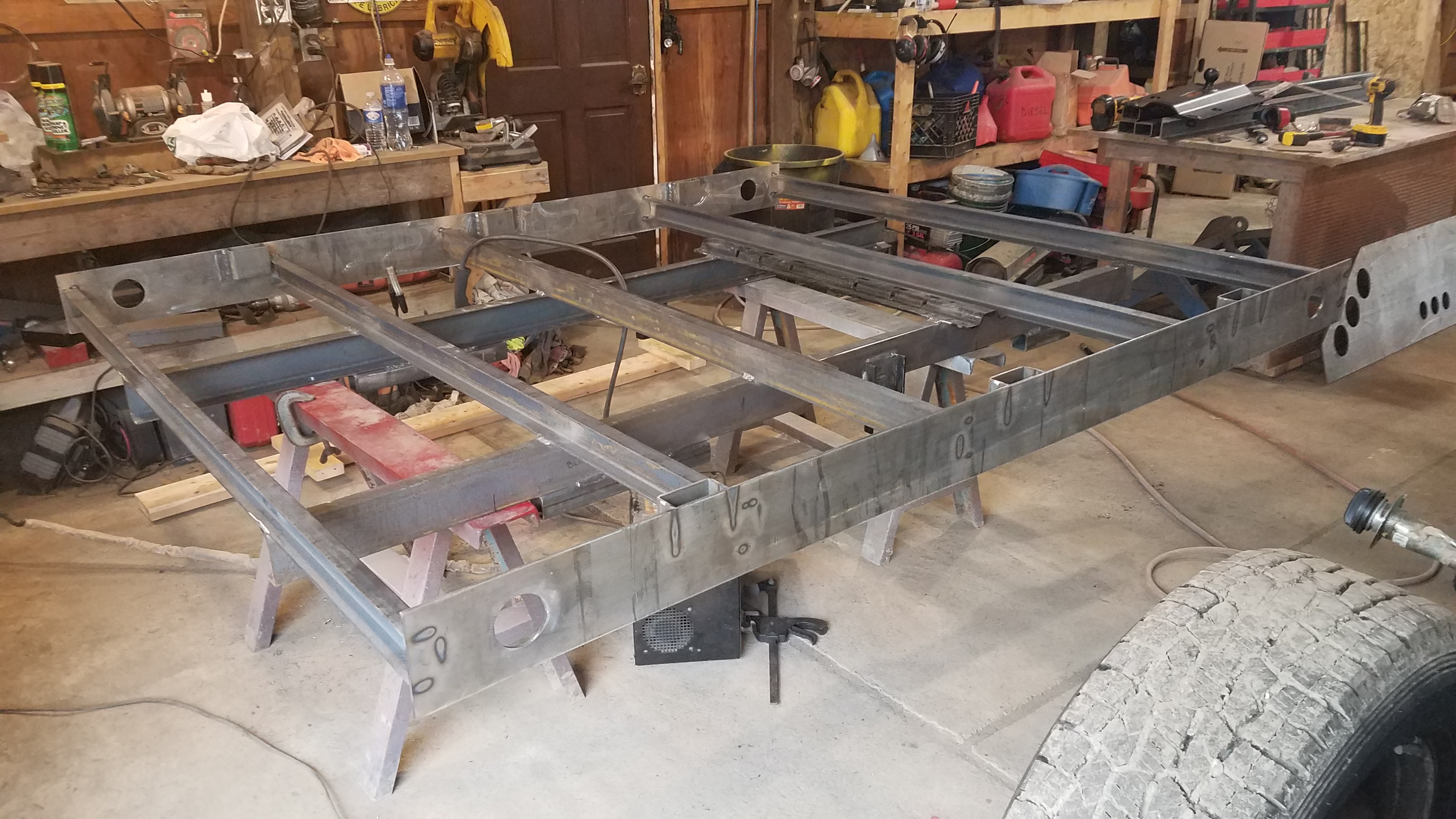

Finally got everything squared up... Should make decent progress today (hopefully)
And pay no mind to the mess in the barn ... Always have too many projects going to keep it pretty
Will this be attached to the frame or body only? You have some nice "iron" in your sig. pic and guess you move it with a g/n. (that should be frame mounted).
/ Building a flatbed for my F350
#20
The fifth wheel rails are welded to the main flatbed framing beams, which will be bolted to the truck frame with twelve 5/8" grade-8 bolts.
