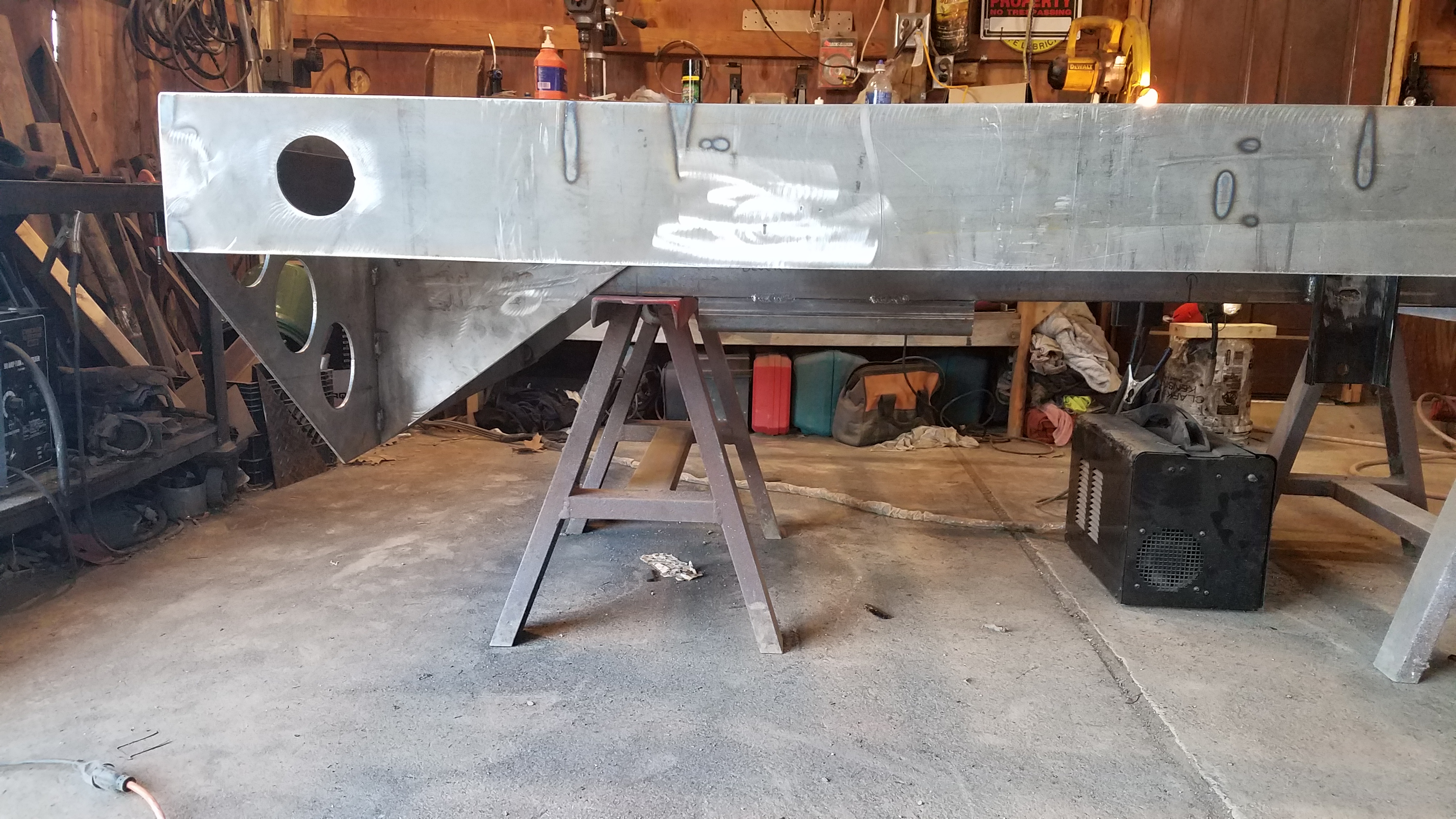

Meeting your specific requirements is golden and is the reason to build your own. Looks great so far, I would recommend you take the time to work out the fuel fill into the side rail as high as you can get it before going much farther though. You need the fuel fill cap centered above the ground at about 34 inches. Less than that and you can have issues filling up on sloped filling station pads.
Ok thanks, I'll look into that. The temps dropped to around 10 deg so it slowed me down a bit anyhow.
Nice looking job on your utility bed builds too, those look great and very useful.

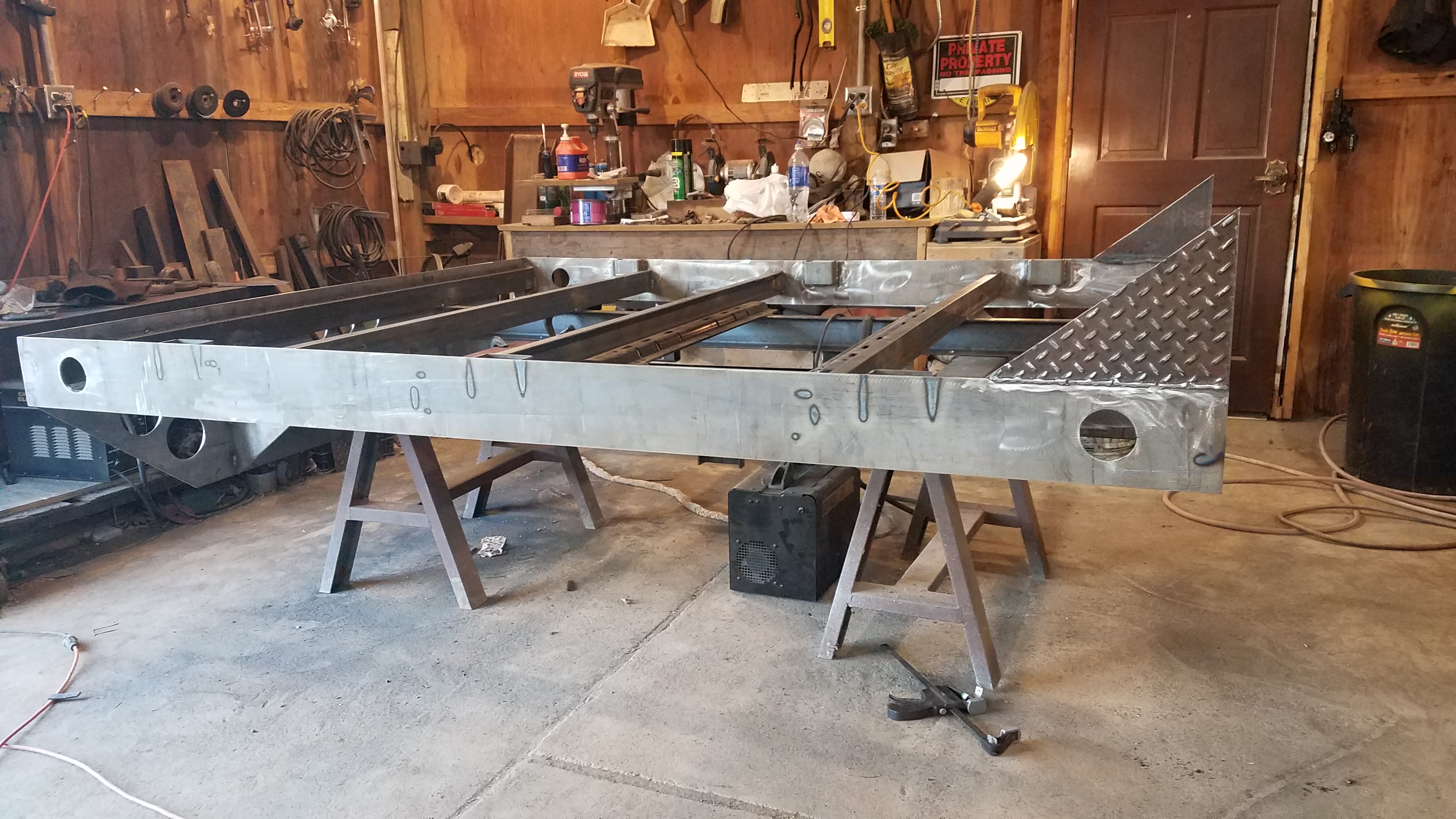

Wow that looks great, how did you do the rounded corners?
Corners are flat steel carefully heated and bent around a 3" pipe clamped in vise, curved to fit and pieces to fill the gaps welded in a ground down. Took a long time to cut and bend by hand but wanted the round corners to kinda fit in with a round body truck. A plasma torch would have made cutting things easier but couldn't justify buying one. Mostly used torch, 4" cutoff wheel, 4" grinder, and welder to build. Rectangle tubing steel and 1 x 3 channel for cross braces, diamond plate for rear apron.

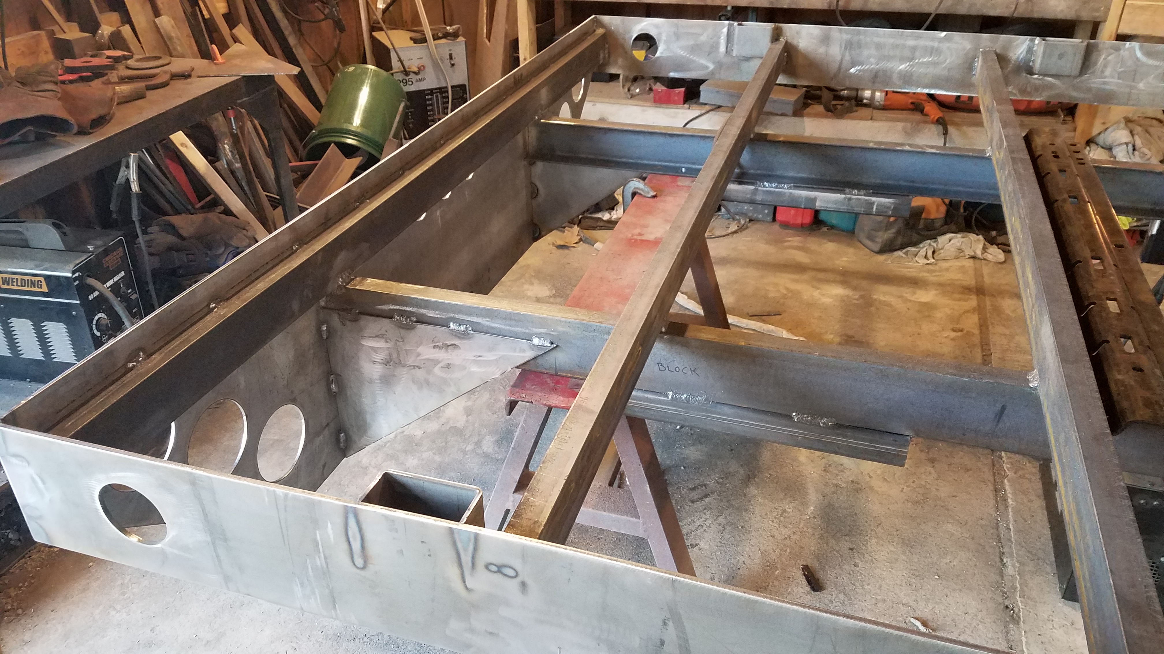

Finished the bulkhead outer framing (still need to attach the front plate material and inner cross member)
Figured it was time for a test fit.
Now need to make provisions for the fuel filler ... Thanks for pointing that out, it does need some adjustment.

That looks great so far!! What kind of wood are you going to use for the bed?? Oak, PT 2X?, or maybe marine grade plywood sheathing? I am guessing you will be painting it black?? I notice it looks like you added some stake pockets that are welded on the inside of the outside frame rail, is that right?? If so, NICE touch! Also, I would consider adding some rear facing LED lights on top of the headache rack to light up the bed when you're working at night, and maybe weld some guards over them for protection, so they won't get knocked off by limbs, etc. And while you're at it, I would custom install a rear view back up camera, just for the finishing touch. I like spending other peoples money lol. Keep up the good work, I'm anxious to see the finished product!

Thanks. I'll be using treated pine, 2x8 or 2x10. It's a work truck so that'll be the best route, allows for cheap and easy replacement boards when needed.
I'll take the lighting suggestions under consideration.
