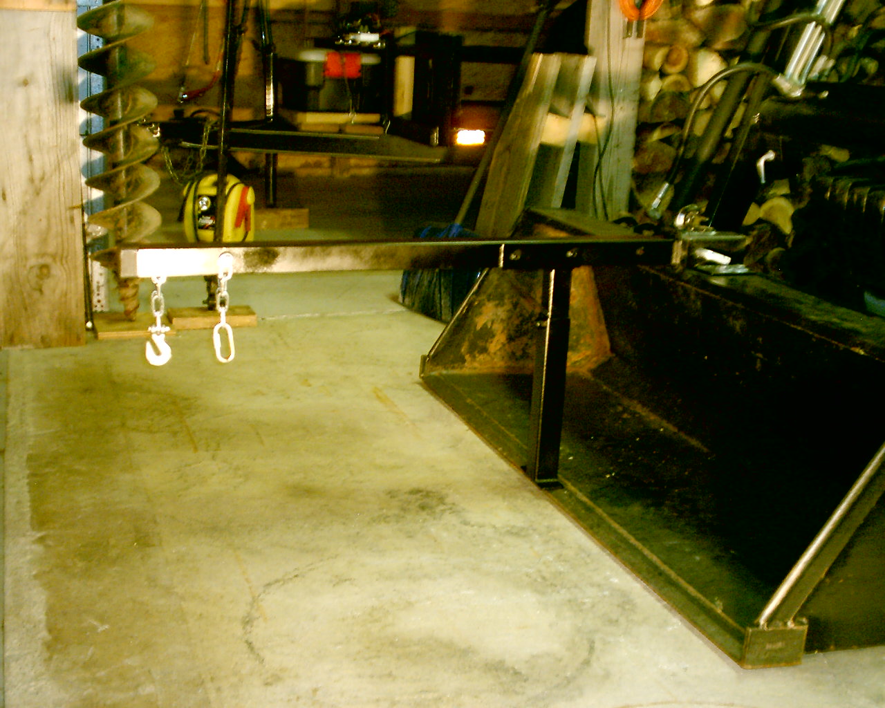

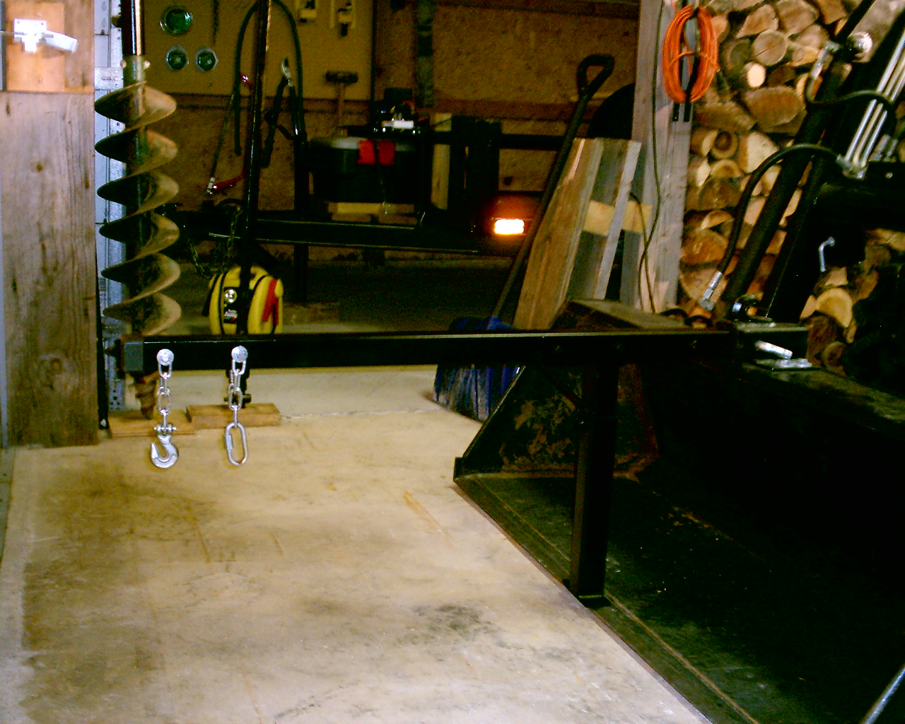

On a much smaller scale I built one after I tried to get a Bush Hog off my trailer and learned how limited the reach of my tractor was. I utilized the hitch I mounted to the top of my bucket.
Chris
