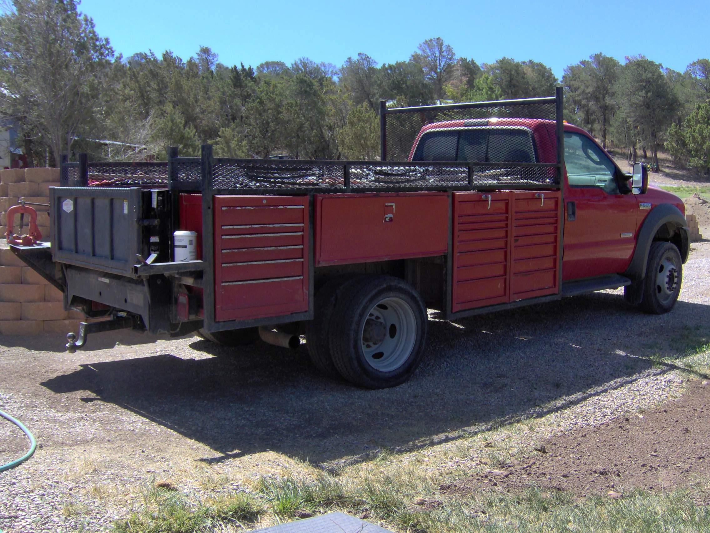

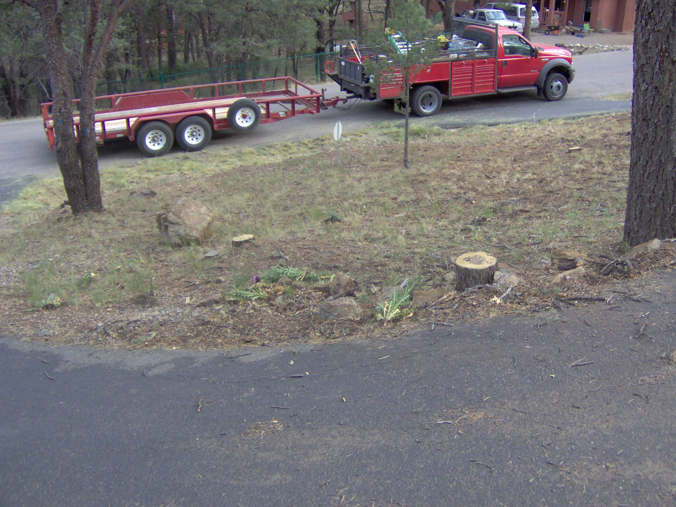

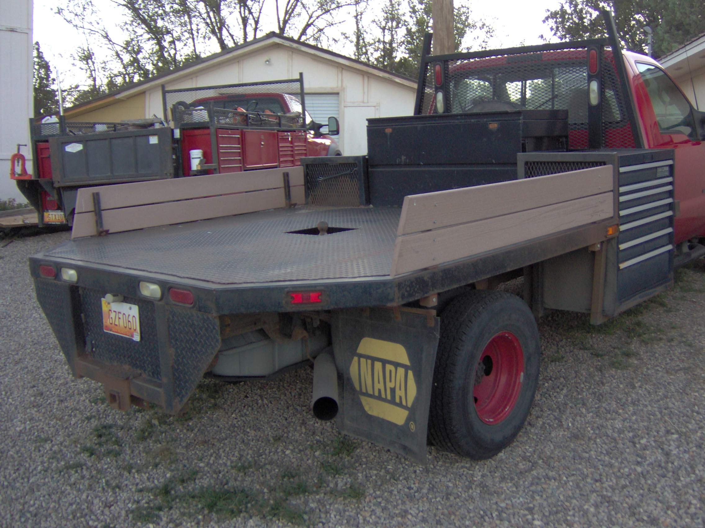

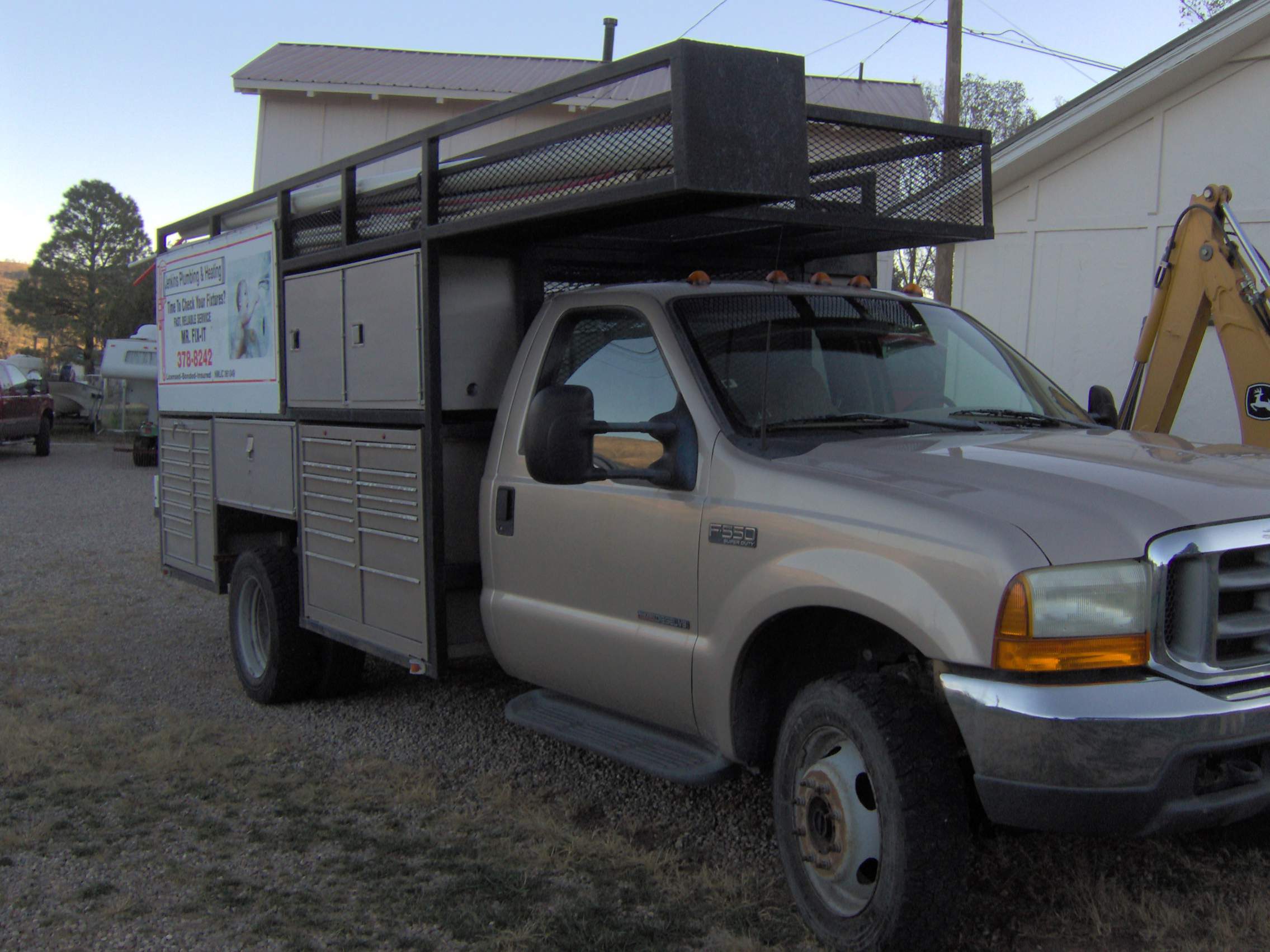

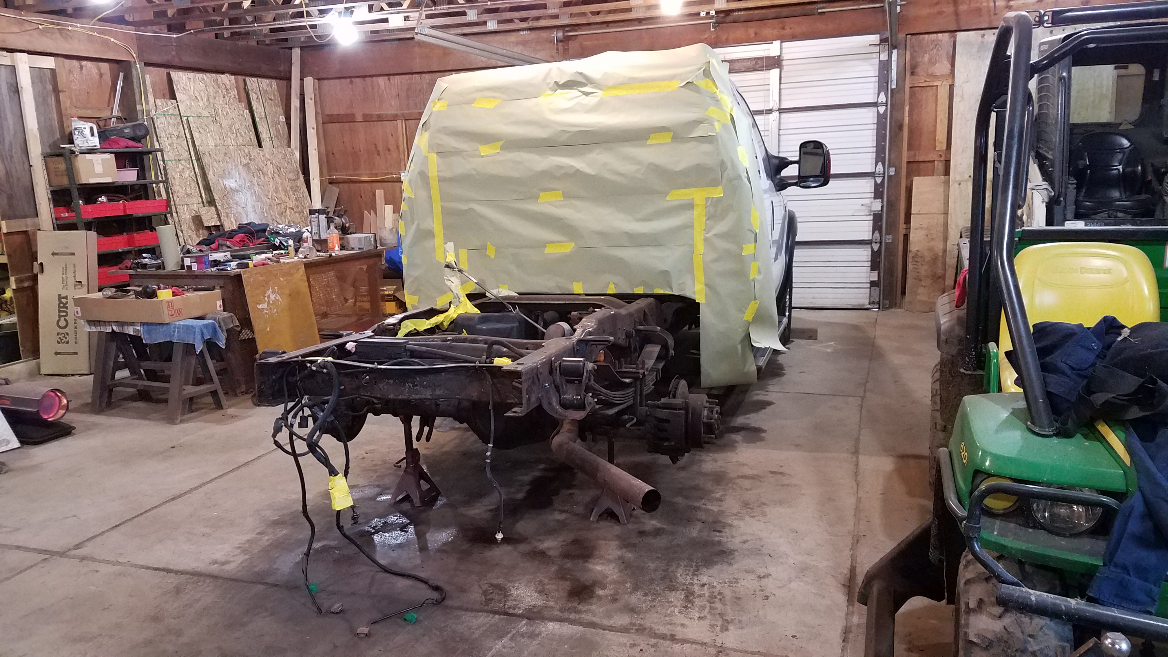

I prefer to build my own truck beds as I am much more satisfied with the custom results it allows. It seems like most truck bed builders have zero imagination imo. These trucks worked very well for my uses in construction and plumbing/hvac business. Since I am changing my business to more tractor work and less construction I am considering building a new bed for this work.
Here are three trucks I built from scratch on F350 and F550 CC.

All the ones i looked at, for SRW ShortBed trucks, were near $2500+ and used inferior steel (thickness, construction) compared to my build. Plus, they were only 84" long whereas mine will be 94" long.
If i could have picked one up for $1500 or less, i would have saved the hassle and time and just bought one.
But i might as well save myself $1500+ dollars, and build a better flatbed that meets my requirements.

Meeting your specific requirements is golden and is the reason to build your own. Looks great so far,:thumbsup: I would recommend you take the time to work out the fuel fill into the side rail as high as you can get it before going much farther though. You need the fuel fill cap centered above the ground at about 34 inches. Less than that and you can have issues filling up on sloped filling station pads.
