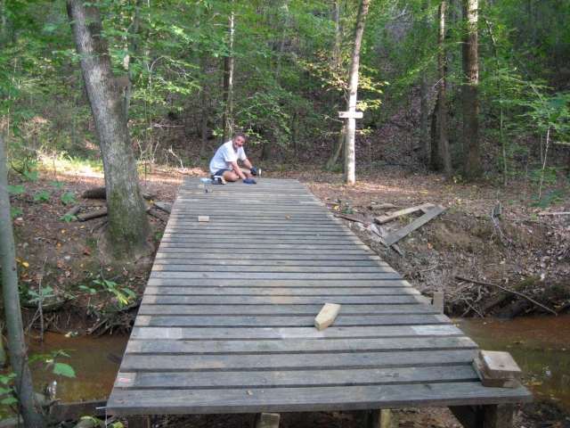

Check post 27 in that thread. He used 16 footers offset, meaning 8 foot of overlap in the middle of the 2 boards. He bolted every foot and glued it together also.

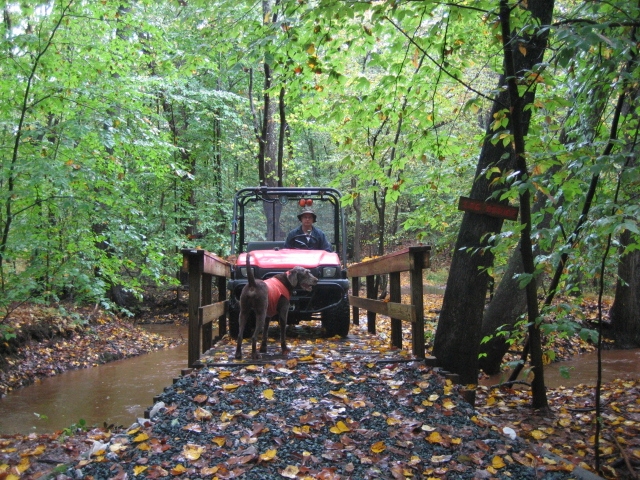

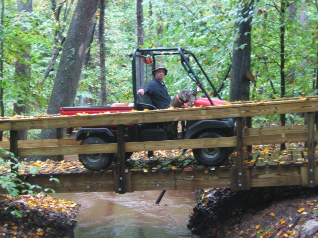

katyhorn - good evening and welcome to TBN. Be very careful with your design. Notice the pics you posted show NO TRACTOR on that bridge. Also this is a clear span bridge - meaning, no center pier to carry the load. I would strongly suggest a review of your design by a knowledgable civil engineer acquainted with bridge design.
/ Build bridge over creek #10
Amen, your requirement is far more complex than the 12-16' spans discussed here a lot. Always build more than you plan now; as time goes on it will suddenly not hold up when you decide it would be nice to take a load of gravel across with a 1 ton truck and trailer. Many have done your type using flat bed trailer decks. A 30'er can be had pretty cheap. I knew a guy who spanned a 30' cut with a RR flat car bed. The salvage value of the waste steel from wheels,trucks, and etc paid the haul cost and renting a trackhoe to move it. You can make beams from laminated 2Xs or plywood but a little engineering will probably pay off. You can take all the risj you want but others may not see it your way. Around here fire depts are refusing to cross bridges not certified by an engineer.

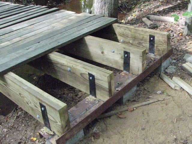

Granthol, Thank you. If you look at the pictures, I think he first took two 2X12's 16-ft boards and glued/bolted them together. He did this again and ended up with 4X12's 16-ft long boards. Then he spliced them together. Are you saying he may have used another 2X12 by 16-ft and glued/bolted at the joint with an 8-ft offset?

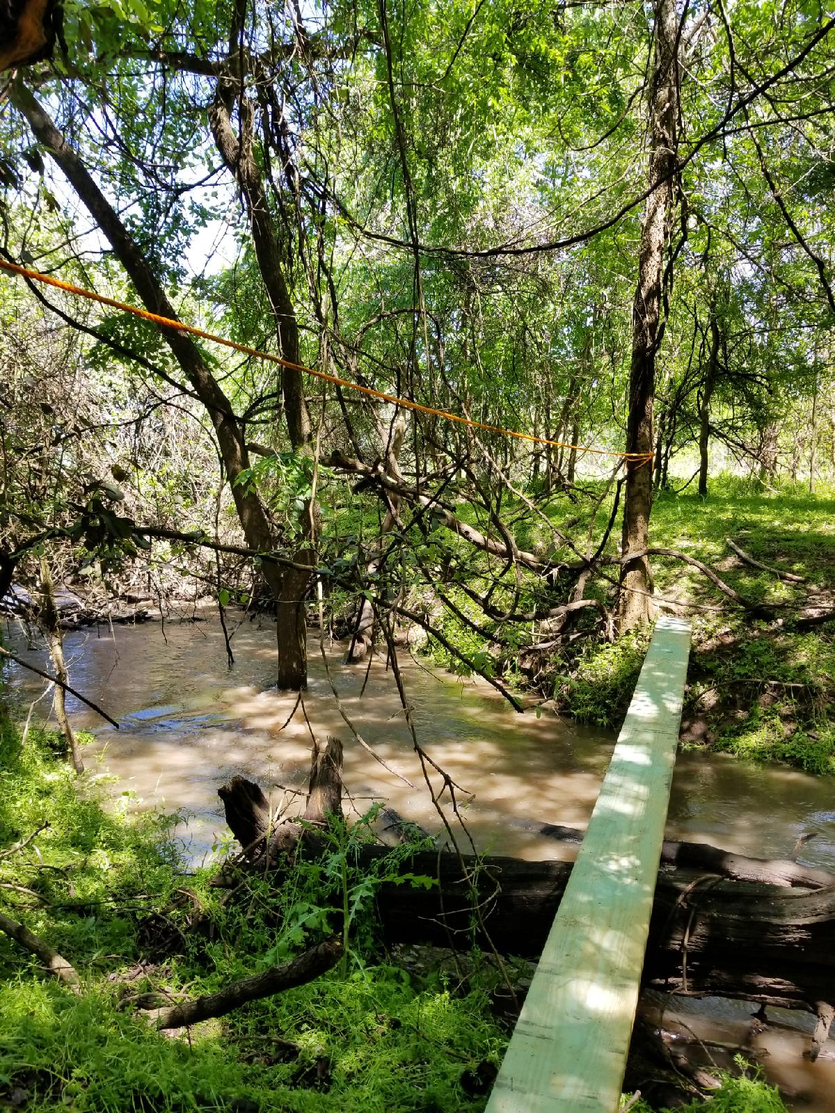

Hello Everyone, Thanks for all the insight!
I like in Katy, Texas near Houston and our new property is in Smithville, Texas about 70 miles out. It will be our retirement place but for now, it is our weekend ranch with just an RV. I will be there tomorrow and will take lots of pictures of the creek, but for now this is the only one I have. It is a rope and a 2X12X20 board that I bought at the local lumber store for a temporary cross. The board now has an anchor in the middle of the creek. Like I mentioned earlier, I think to clear the creek to solid ground on both ends will like be 24 ft. Here is the pic.
