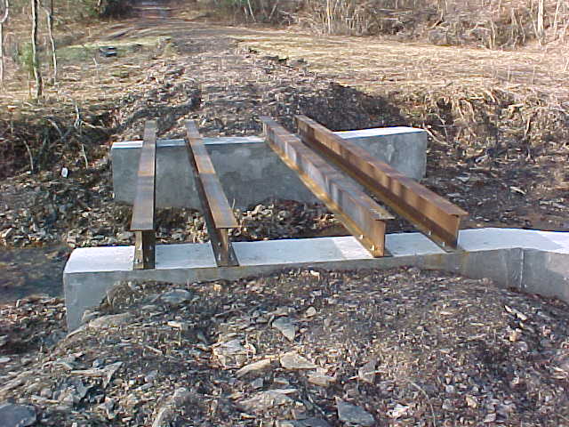

Now that is a professionally built bridge.
Keep the pictures coming.

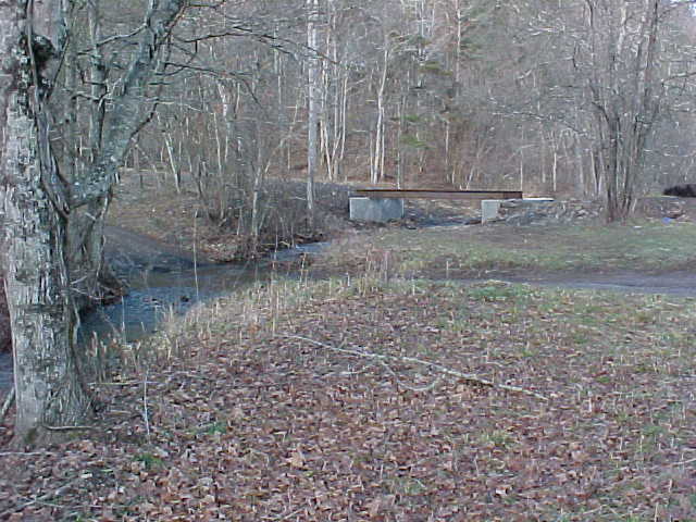

and yes the first vehicle on the bridge would be my little orange buddy. /forums/images/graemlins/cool.gif

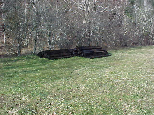

I had trouble getting dirt to pile up to the proper level i wanted, so i desided to build a retaining wall for the dirt. i rented a post hole digger and sunk rail road ties as far as the post hole digger would go. shear pin would break at about 4 to 5 ft, solid slate does that. /forums/images/graemlins/grin.gif

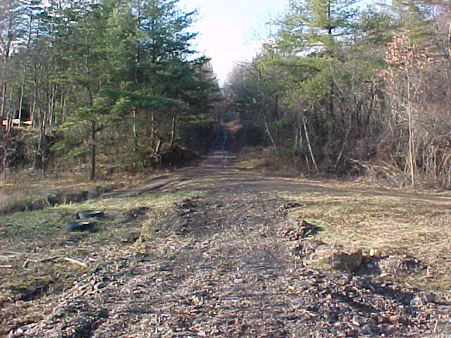

#66
Re: another update on the bridge project
picture from the side

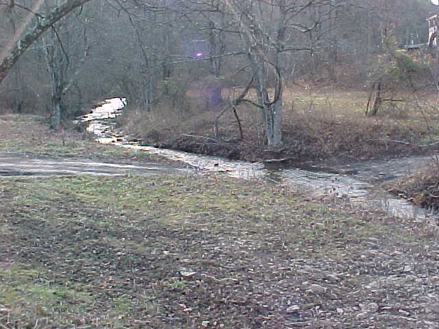

I have been looking for someone or something to pin all this rain on. Shame on ya. Attached pic will show you what I have been putting up with. The creek should be 6 to 8 feet below the bank. Luckily the 2 times the water got this high the rain stopped. The creek goes down almost immediately after the rain stops, must not be any tributaries to this creek. I love this property except for the flooding possibilties. I don't care how dry it gets, I don't think I will ever pray for rain.
