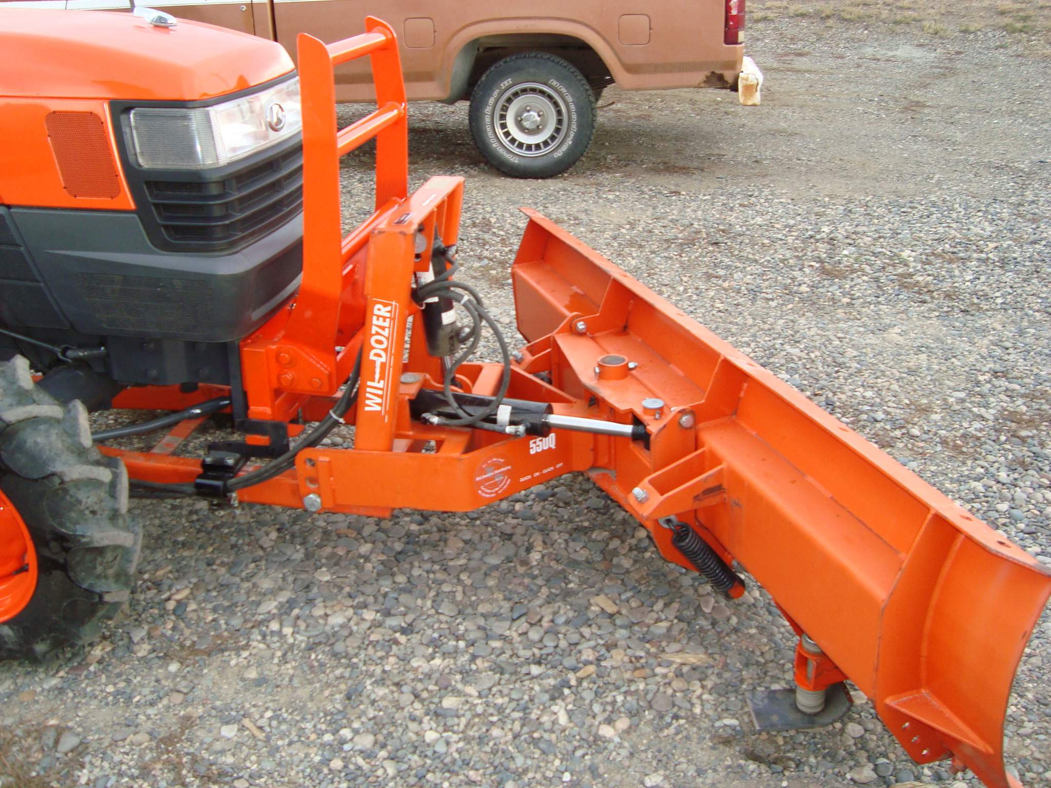

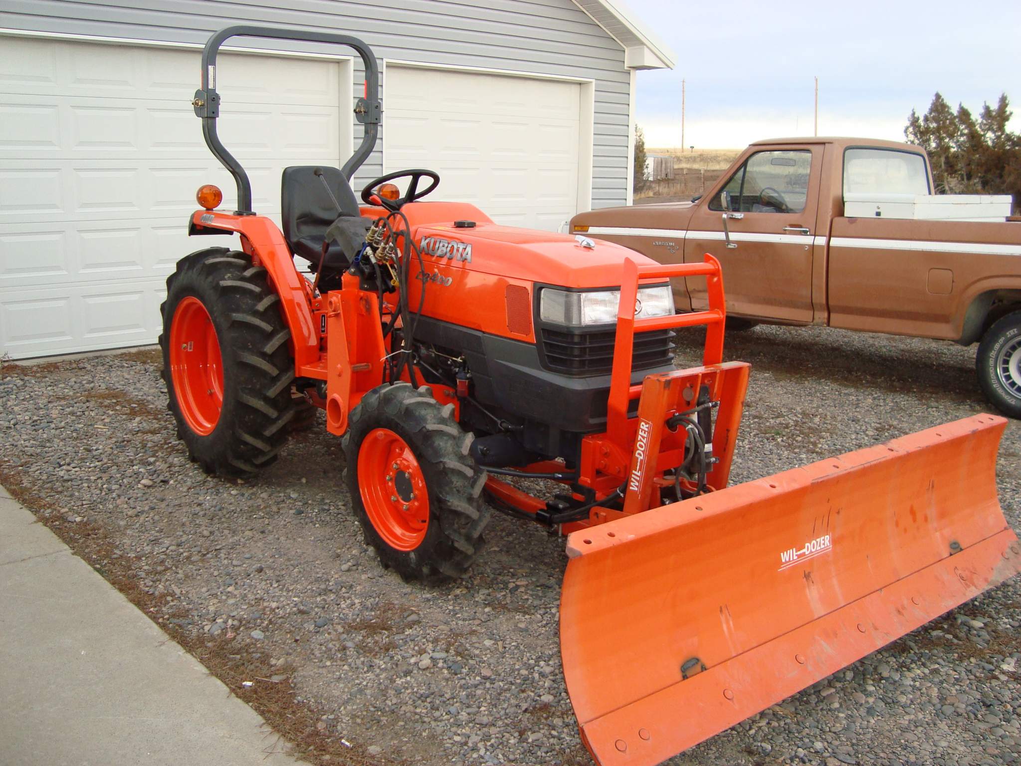

I had both, since I got the plow I sold the pusher. I have a plow that mounts in place of the bucket and angles with aux hyd. I have a long drive and with the pusher I would get part way down and run out of steam, with the plow I can angle and go all the way. I can stack just as high with the plow as the pusher and clean up just as fast. Real advantage is being able to angle for the long straight sections. When I did parking lots pusher was much better for carrying snow a long ways through the lanes. Plow can't carry without pushing sideways. I hardly ever use the bucket unless I need to scrape a small section for whatever reason.
/ Bucket vs Snow Pusher #18
Plows and pushers aren't meant for the same purpose. Pushers are usually part of a pusher/blower tandem mounted on the same tractor or loader. Pushers -especially reversible ones- are mostly used in commercial snow clearing when one has to quickly clear a large number of relatively short drives or pile up snow for hauling away, this mainly applies to parking lots. The advantage pushers have over plows is that when used properly they leave no snow in their wake and you can put it exactly where you want it. The dawbacks: requires more horsepower and heavier equipment, it's not meant for garden tractors or pickup trucks; cannot be used to sweep snow aside so distance range is very short and limited by horsepower and terrain conditions. If you're not into commercial snow removal and have a long drive with enough room to sweep snow aside then you're much better off with a plow.
Some plows can be transformed into pushers via hinged hydraulic or electric "wings" that can be lowered on each side of the plow, it's very expensive though and not as sturdy as a standard pusher.
