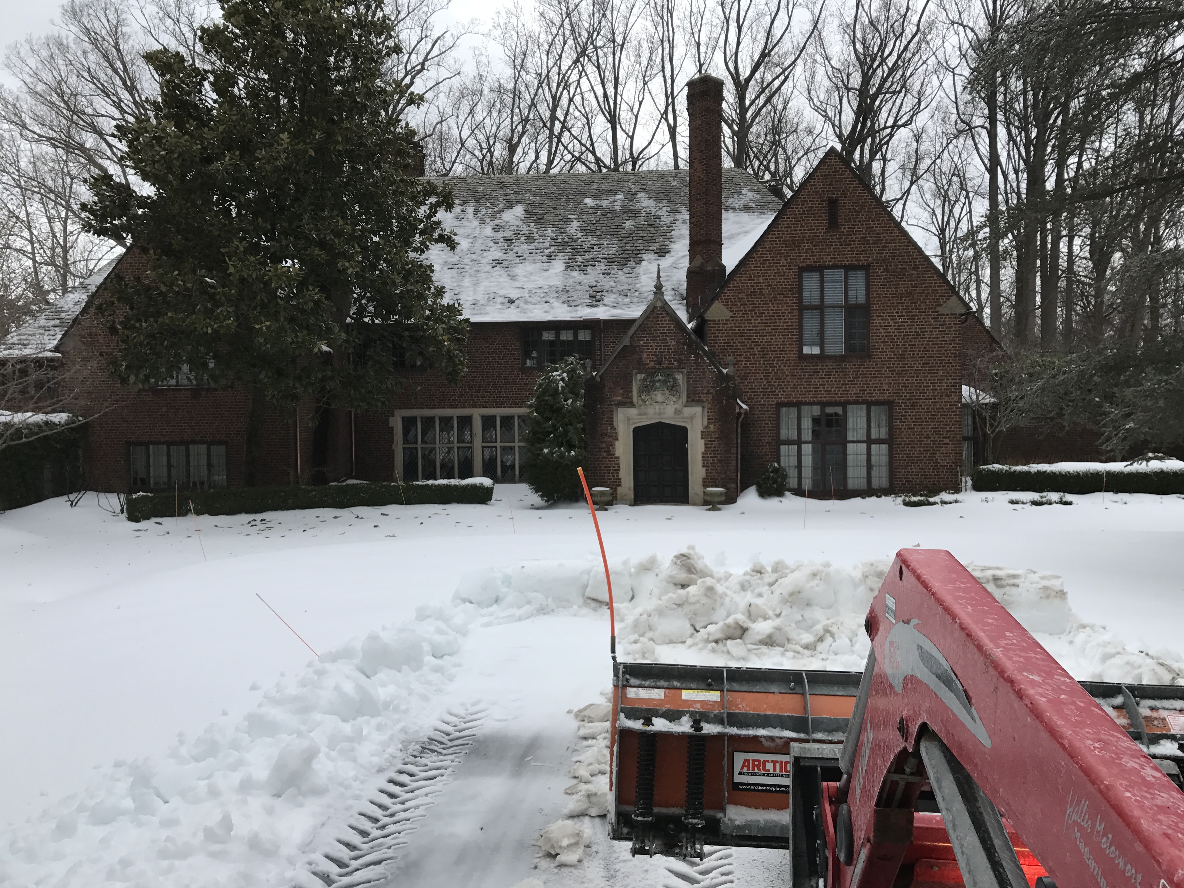

When you say “snow pusher”, do you mean a snowplow? Yes, they are easier on the machinery than a bucket as they have a moldboard spring relief trip edge or the moldboard has trip springs.
Below, You can see the trip springs on my trip-edge Arctic 8.5’ snowplow

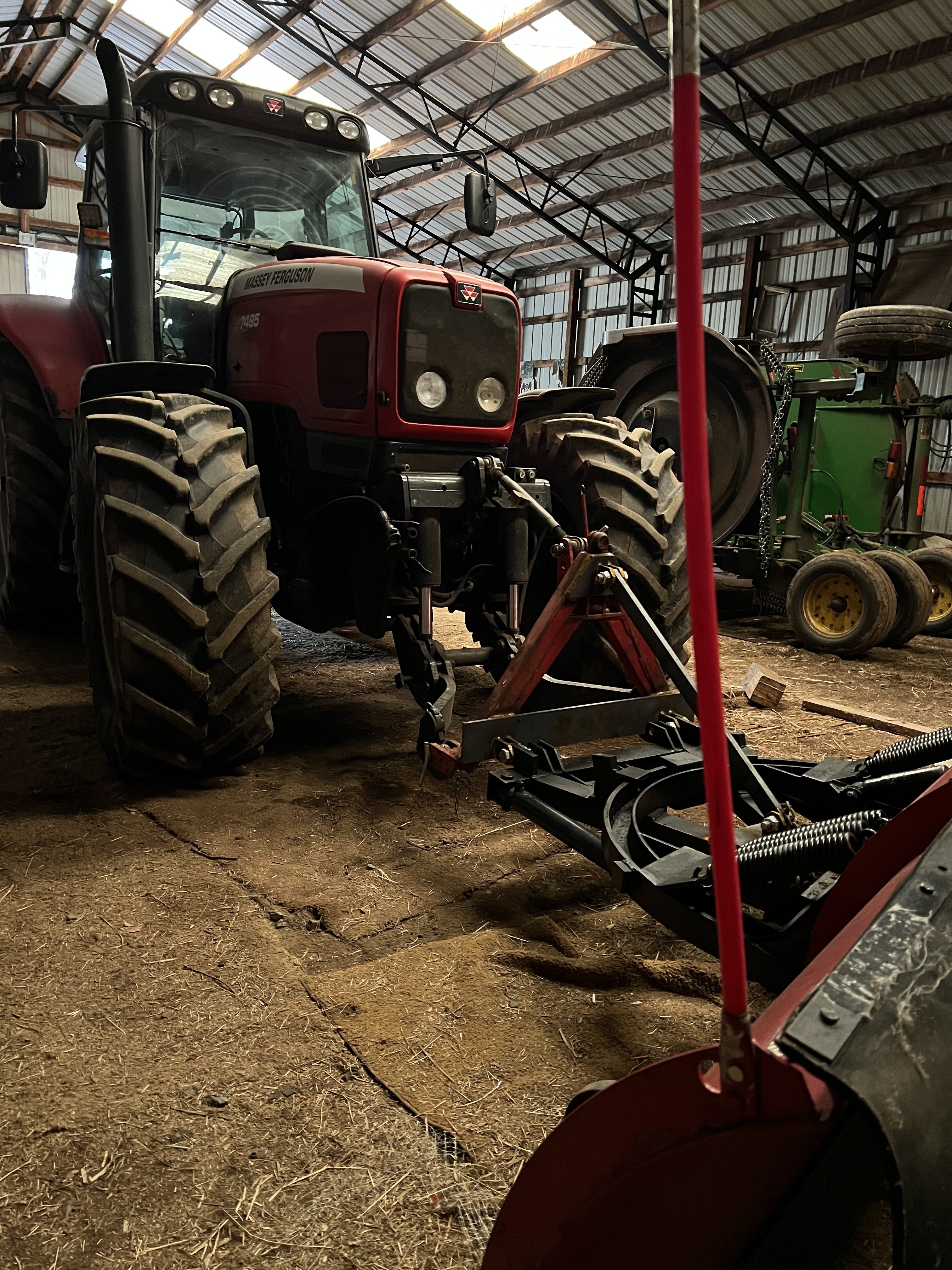

Below, you can see the moldboard trip springs on my Western 10’ Heavyweight plow

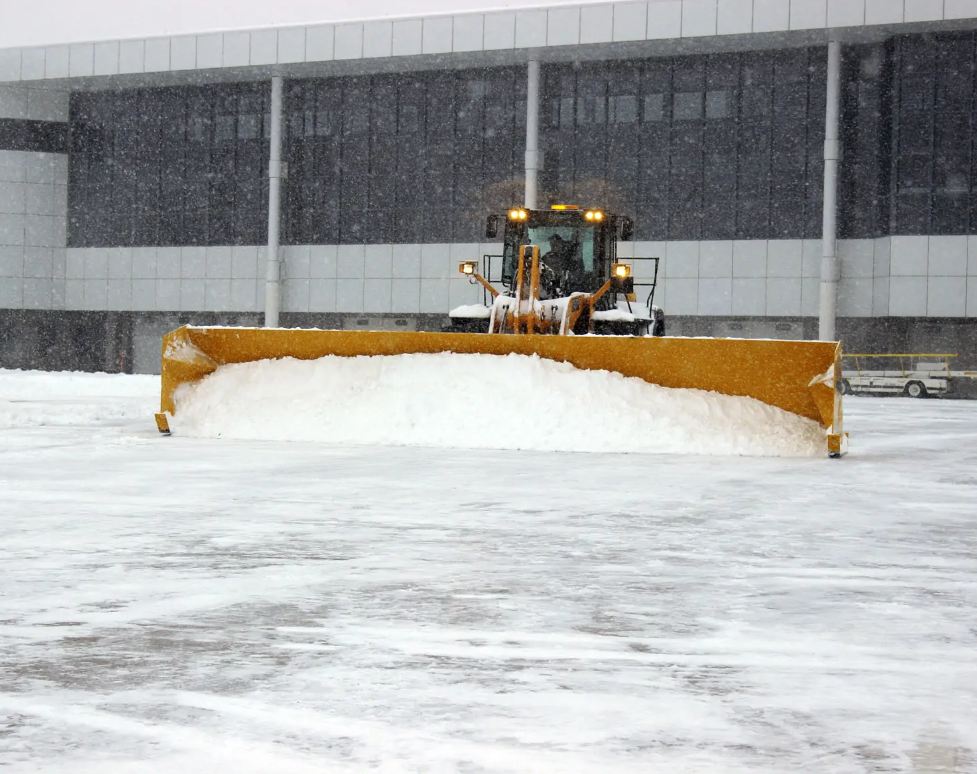

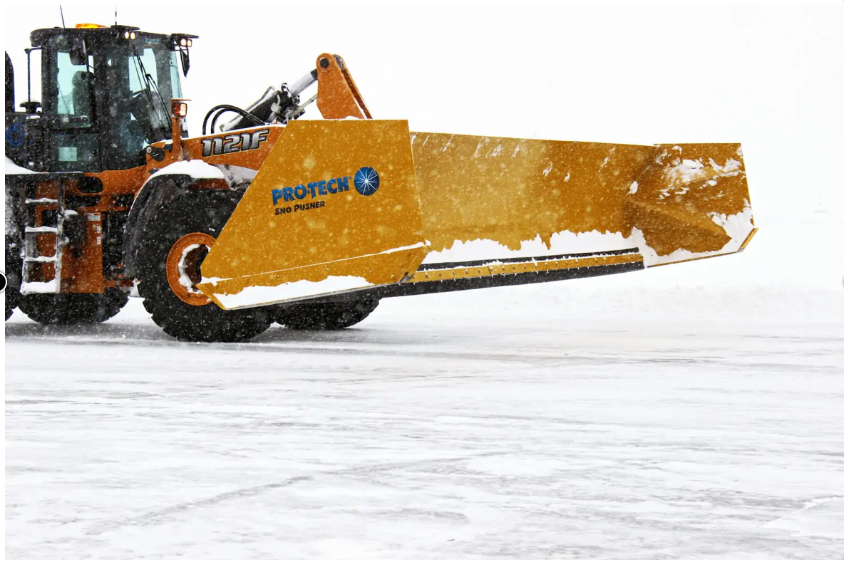

A steel edged pusher will jolt on an obstruction, but perhaps not as violently as a bucket edge that is generally parallel to the ground.

On a side note the Massey is a beast. Beauty of a machine.
