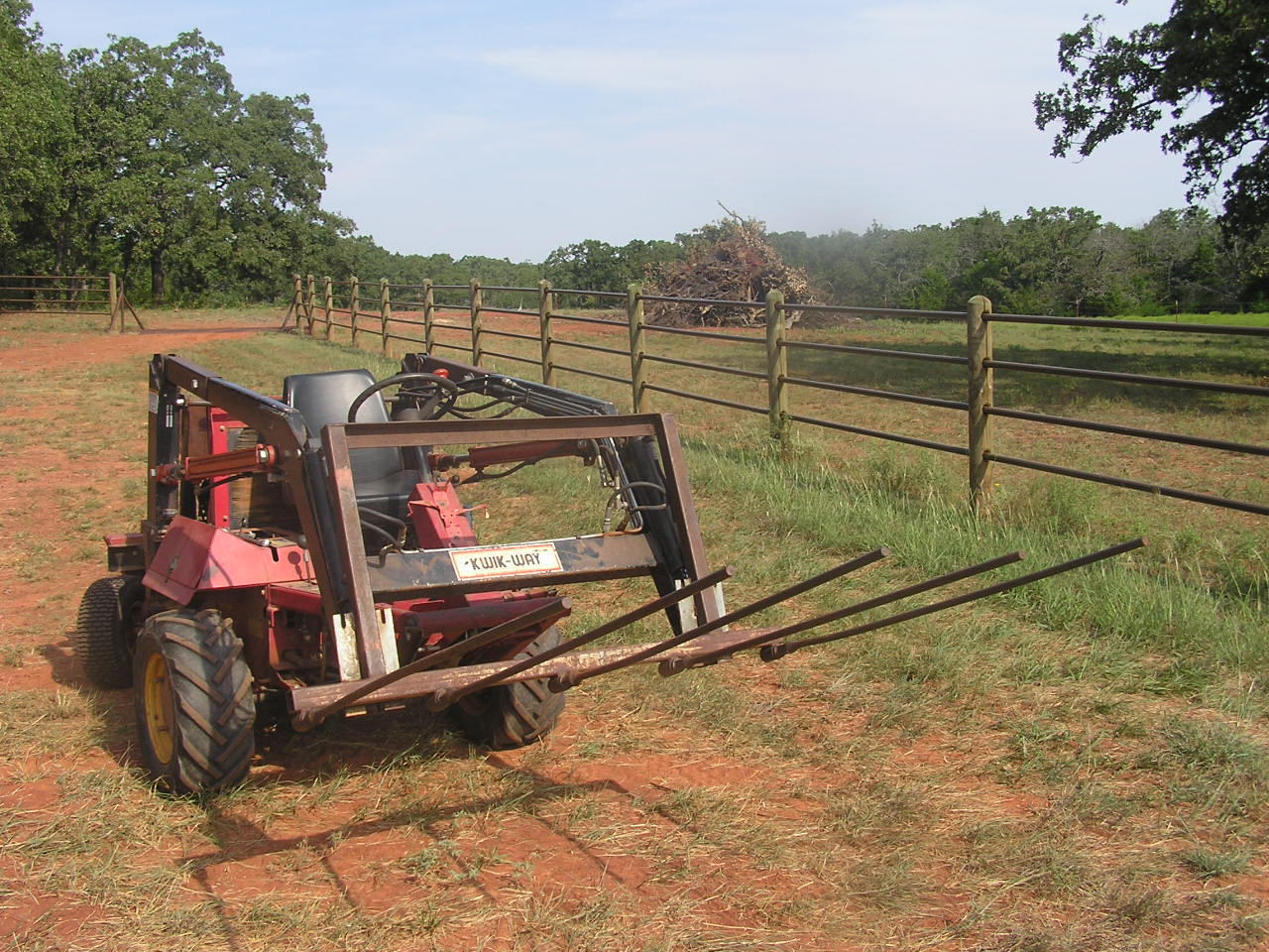

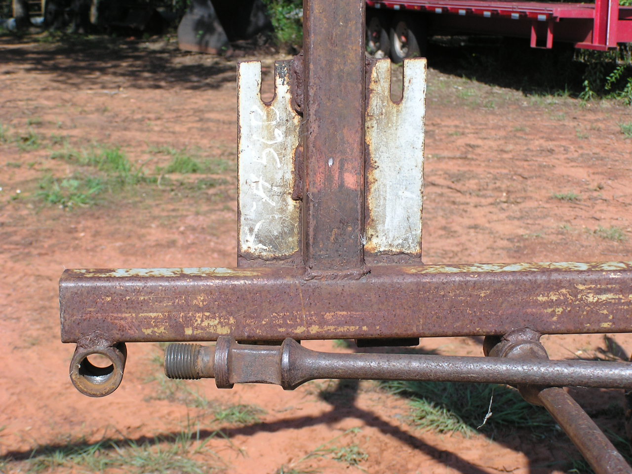

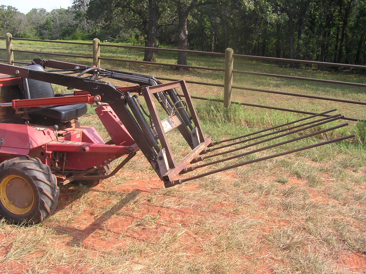

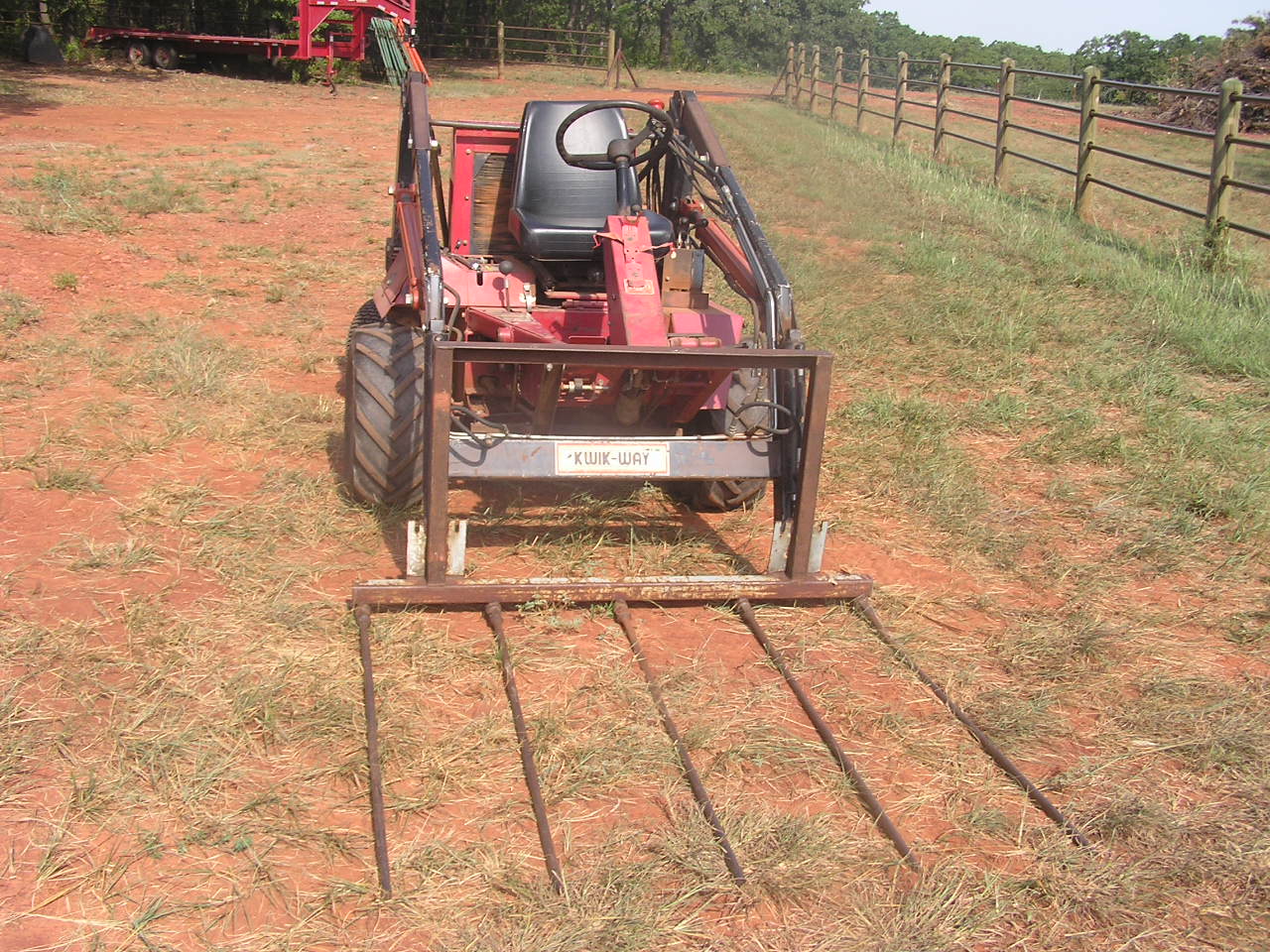

Your pictures with the chain over the front or the back shows why I prefer slots, not hooks.
Here is the way I put slots on a brush fork frame for a pin on loader.

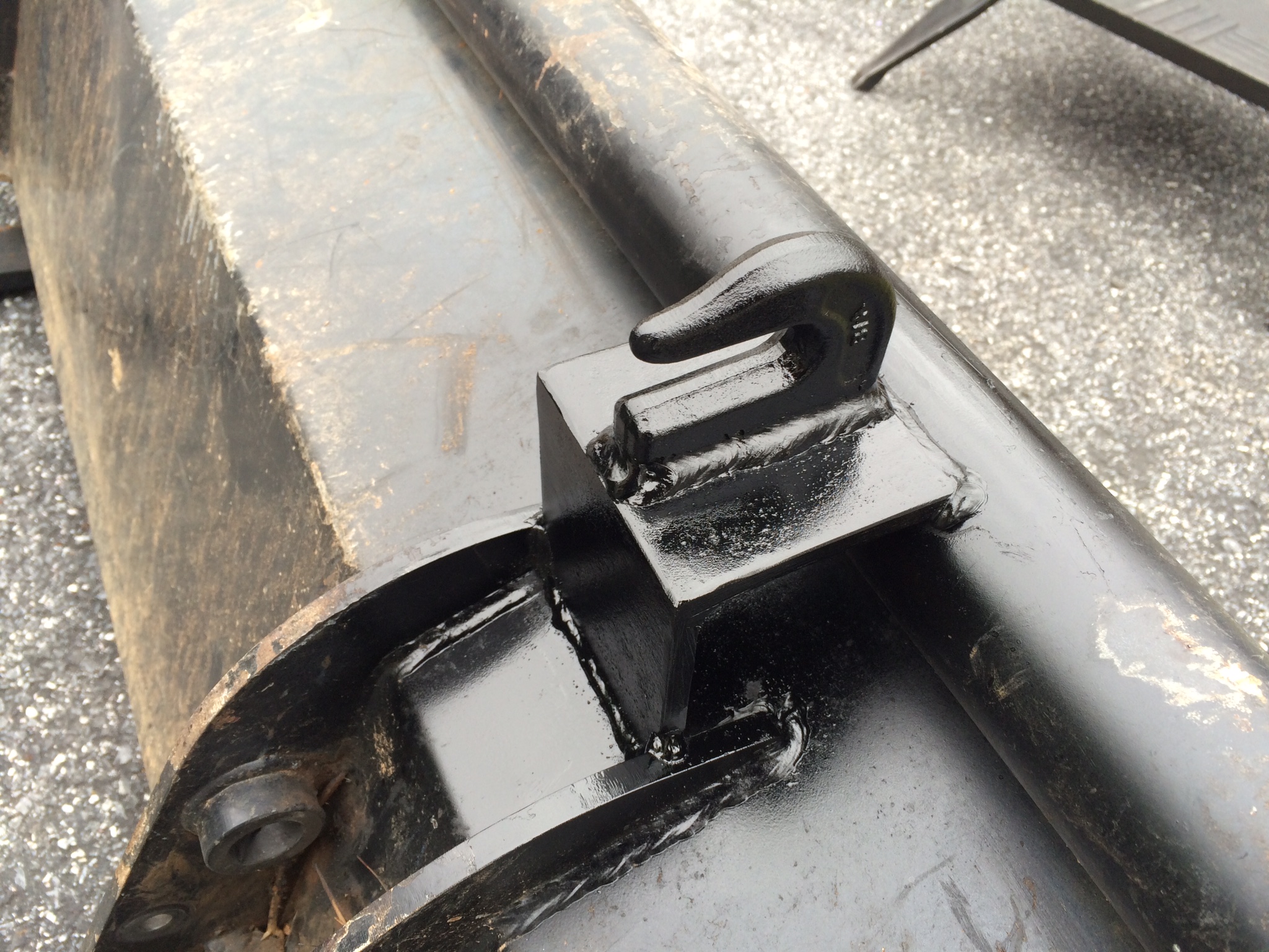

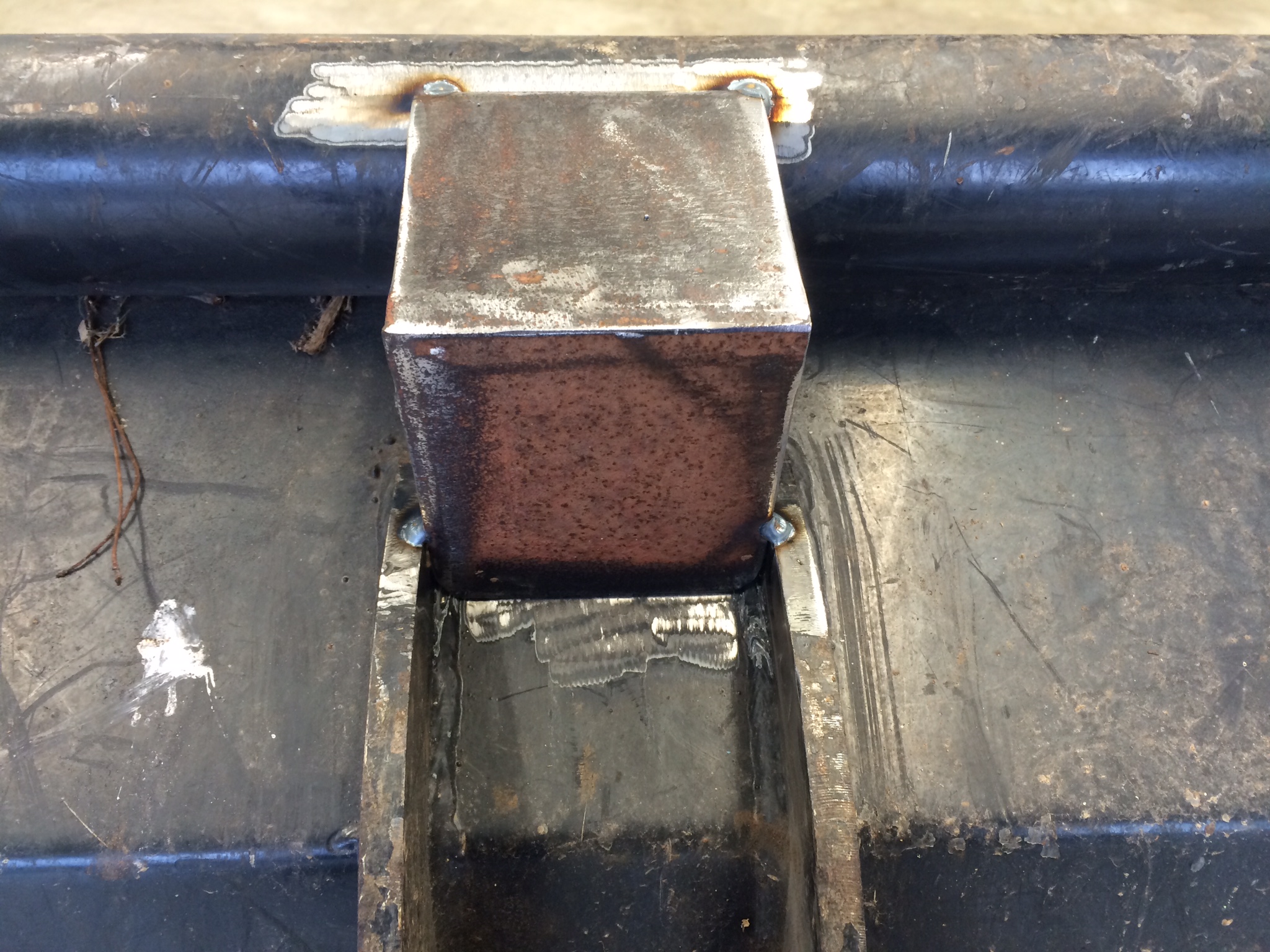

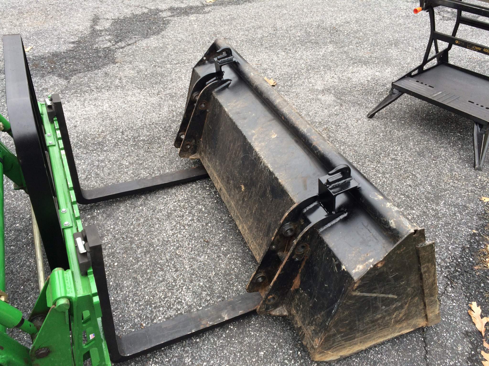

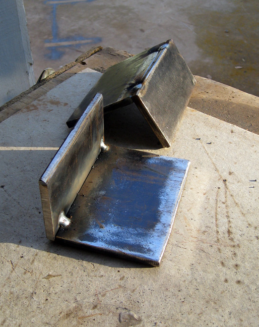

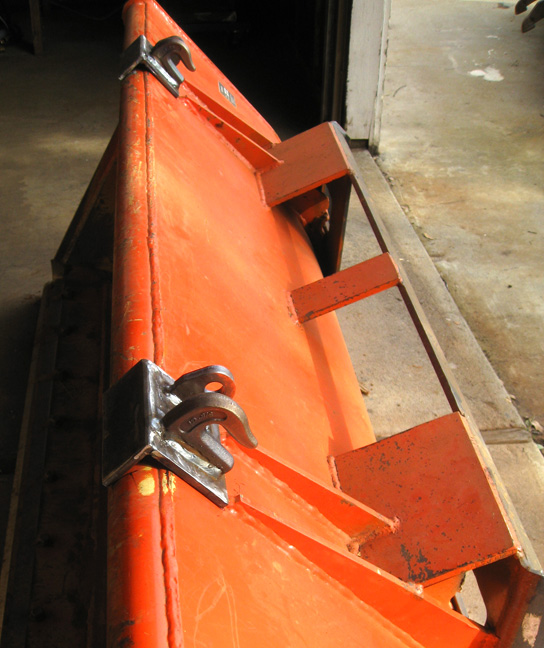

Sorry to revive an old thread, but I had a local person contact me about adding hooks to their NH30 bucket, I used the angle iron/lintel method.
3.5" x 3" x 1/4" Lintel, 3.5" wide tacked in place:
Finish welded, added 3/8" hooks and painted:

I like it. Looks good

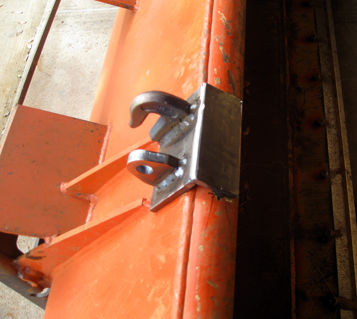

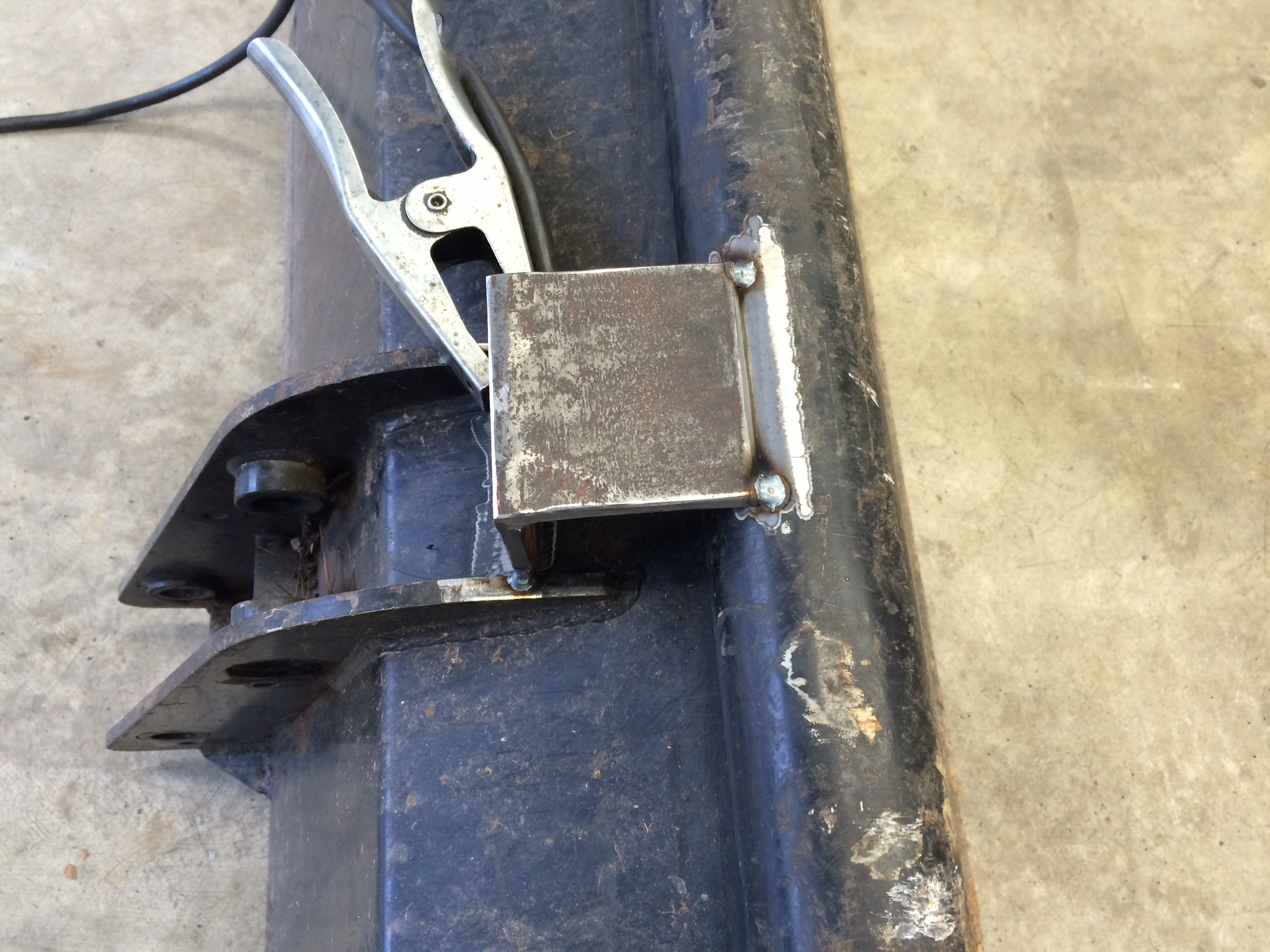

I welded 5/16 plate to make the angle. Yes, It would have been easier to buy the angle but the fun is in the process and I saved a few pennies.
Welded two of Ken's products to the plate and then to the bucket. The plate and hooks are placed so as not to rub on the round bucket edge. The plates are 4"x5" except the top which is 5"x3" because I needed the round leading edge to weld onIMG_0539.jpgIMG_0555.jpgIMG_0557.jpgIMG_0564.jpg.
Pretty much as Ken suggested in an earlier post.

Another nice job Kenny.
