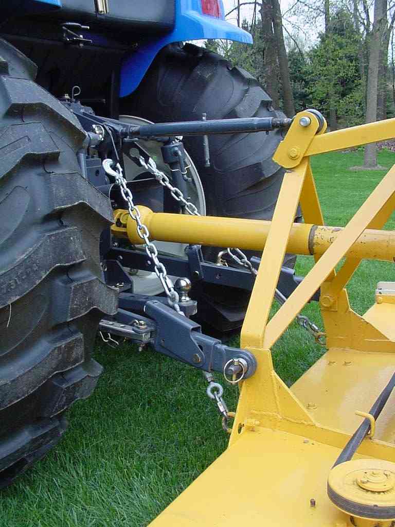

However, here's my take on that. If you have rough land and are mowing over swales like where the tractor was pointing down one side and the brush hog going up the other side, I'll bet you would still scalp the top of the swale somewhat. Maybe not so much a gentle swale, but sharper ones for sure. Not only that, but as the cutter passes over the top, the center of it gets closer to the ground. The only way to keep the cut constant height is to move the cutter up, using the front or rear or both...or get rid of the swales of course.
Yes, I would have to agree that if you have extremely rough land, where you would constantly be having to change the position, the setup might not provide the results you require. However, the pic I included was of my RFM and the area I mow with it. My brush hog otherwise sees some pretty rough terrain and I have the same setup, except without the turnbuckles and a little heavier chain. Adjustment is made simply by moving the attaching point by one or more chain links. For the most part, I drop it down and leave it alone. Ocassionally, if I see a stump, large rock, etc. I raise the 3pt, but not otherwise. I think if I had even rougher ground (and in which case I'd require an even less finished look) I'd probably take another link out of the chain and just mow a little higher so swales, etc. were not a problem. It is a pretty cheap setup, easy to install, and probably worth a try for almost everyone at least once. Note that to work, it does require some sort of moving top link, toggle or piece of chain for the top.

Gerard's technique sounds like it might work well for me. The cutter looks like it will float by attaching chains in that manner. Gerard - if I picture this accurately, you raise the lower arms only for installation of the chains. Then when you are cutting the arms are probably lowered all the way down which makes the cutter held up to the elevation set by the chains. Correct?
Correct - What it does is let the chains hold all the weight of the front of the deck and keep the front skids off the ground. I'll have to work on a picture - my bushog is out under snow but google check chains and you should be able to see a picture.

I also like the idea that you can use the check chains to quickly set the cutter back down to the elevation you intend - my 3pt height mechanism is kind of sticky for some reason that I'm not sure of yet.
djradz, your check chain assembly actually does not look bulky enough for my tractor/terrain/cutter weight. But it is a good setup that would not be difficult to fabricate. Easy to see how I would simply use a larger chain and beefier attachment hardware. I pictured this not set onto the base of the cutter though, but up on the 3ph pin attachment, on the cutter.
You're correct - mine attach to the pins on the cutter, not the cutter itself but it would work the same way and yes - use the heaviest chain you can - mine looks like the same size as the picture and I've snapped links twice and had to reweld them. Hit a bump and that's a LOT of instant tension on the links.
