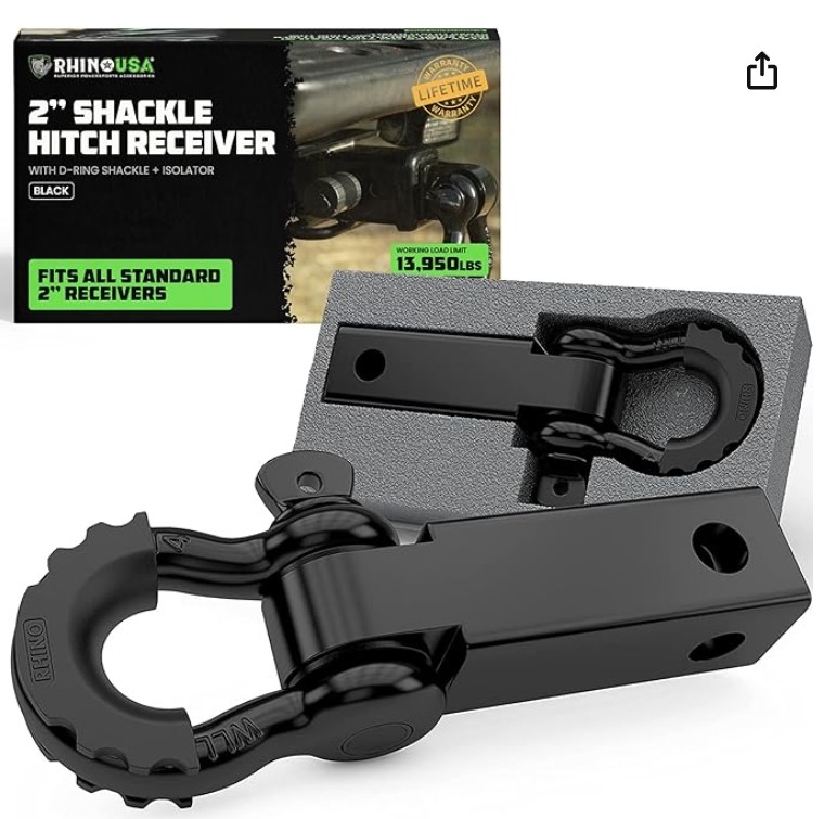

With winter coming up I'm sure someone is going to go off my road, into the ditch, and get stuck. I used to recover using a Jeep with a winch, but it I no longer own it. My tractor has a hitch, but my rear blade is most likely going to be in the way. So where's the best place to attach a shackle to the front of the tractor? Also, my tractor, with the rear blade attached is about 10,500lbs, what's the heaviest vehicle I should be trying to recover? Any other tips for using a tractor to recover stuck vehicles (this is my first tractor)?
If possible have the Driver of the Stuck vehicle hook up his end.
Tell them in advance you will not be responsible for any damage.
Hook to the drawbar and Low Gear for pulling. Spinning does not help.
Caution the driver Not to help other than steer.
First I would tend to avoid doing this in most cases. Its nice to be of service but there are so many things that can go wrong with vehicle recovery that in most cases it is better to leave it to a licensed tow truck.
In the event that you do pull someone out...
Unless you are talking about recovering heavy duty vehicle like F250 or heavier, I would worry more about damaging the vehicle than the tractor. It would be more important to use a towing point of the vehicle or a properly mounted hitch.
If this is something you do often, I would think about having the people sign a waiver absolving you of liability.
I have a neighbor that was sued for damaging a vehicle he was pulling out of the ditch (for free) and it was the owner of vehicle that had tied the strap to the car. The neighbor lost and had to pay for the damages...something like $5000 and his insurance would not pay.
As to where to tie to the tractor, the draw bar is the obvious choice. If you have a mounted winch that could be used too if you are pulling up to midsize car. However if pulling with the winch let the winch pull...don't pull with the tractor you might damage your winch.
In any situation you should very slowly tense the cable/strap/chain before slowly pulling with the car on neutral. If you are not finding traction, say "sorry" untie yourself and call a tow truck for them.
Insisting is not worth the possible aggravation.
