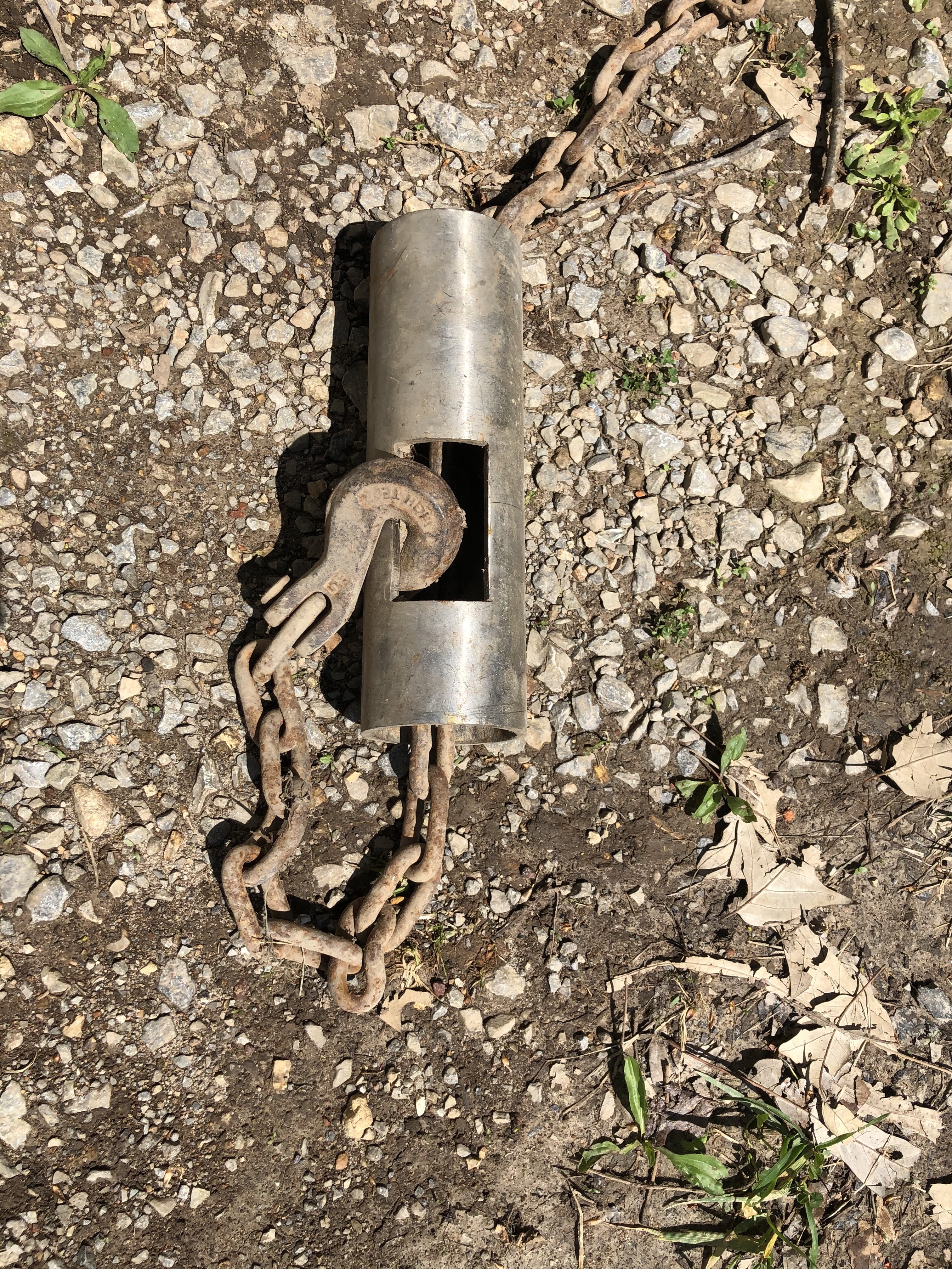

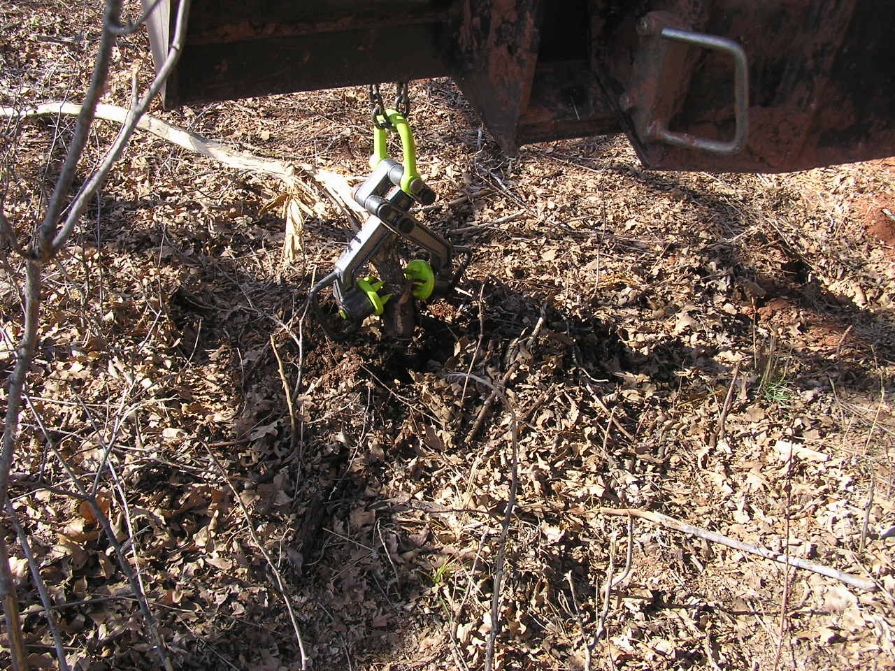

Hard to beat a chain and piece of pipe. Often use pipes on both ends of chain. Pipe bites the tree. If small trees are close, can pull several at a time. Easy to undo after pulling. Tried a grabber but didn’t work as well for me.

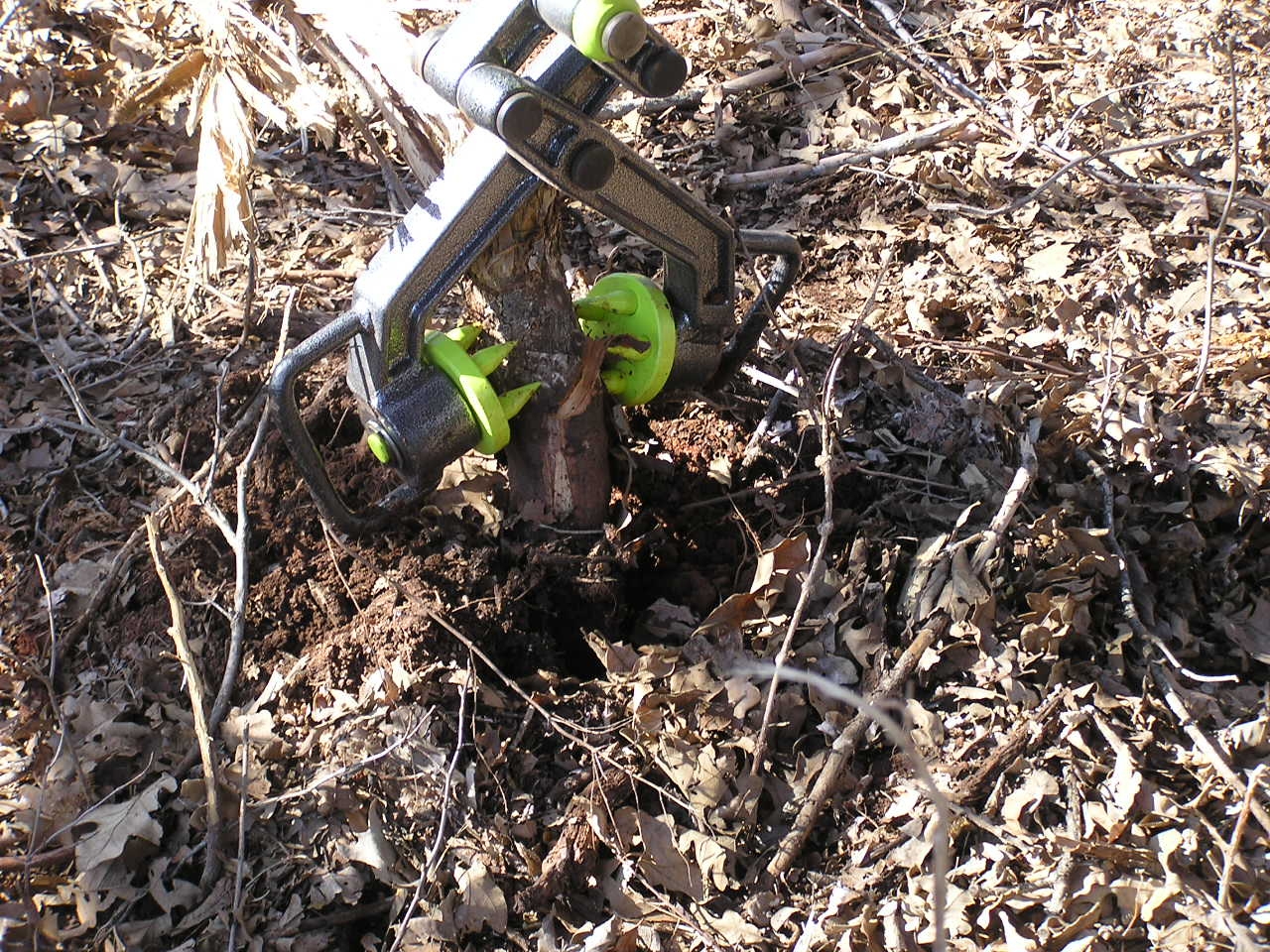

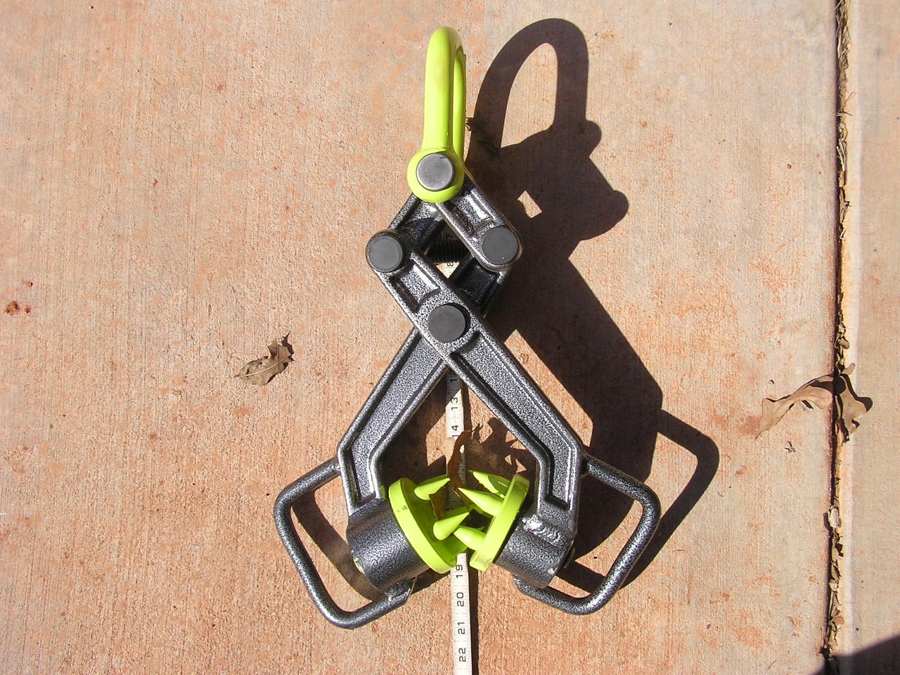

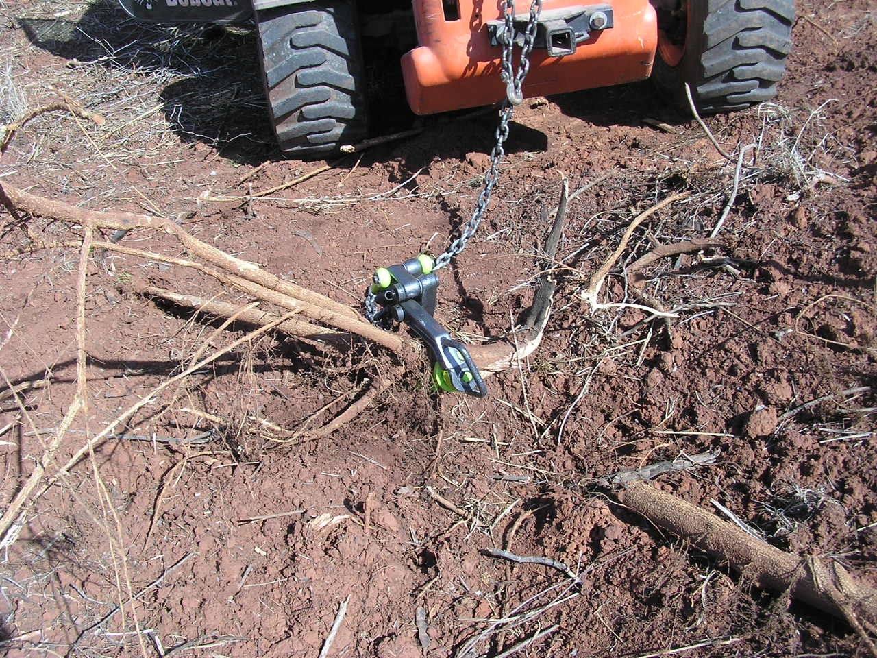

Seems as though I have a ton of weed tree saplings that are too small for the chainsaw but large enough to yank out so I ordered the 'Brush grubber.. Anyone use one? Do they hold up? Gonna use it behind one of my M9's on the drawbar to yank them out. Got the 'heavy duty' model. Is it heavy duty enough for my 8K pound, 90 horse FWA Kubota or will I destroy it?

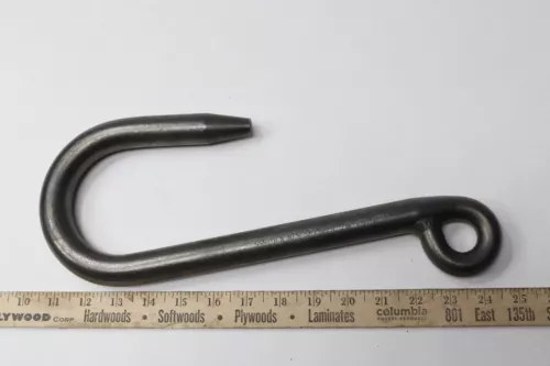

I saw a great video on YouTube of a guy pulling out stumps with a foundry hook. I bought a couple on Ebay but haven't tried it. He had a heavy chain and was pulling with a small cat (D4 or D2).
Here is what I bought on Ebay

Bought one of the HD Brush Grabbers, and I have to rate it as "meh." Found that I was on & off the tractor for positioning...and lots of re-positioning, as it tends to slip easily and often.
I have a Kubota L3200 with filled rear tires, and I'm also not-so-pleasantly surprised at just how tenacious small saplings can be. This is just physics, not the fault of the tool. Doesn't take much of a stump, and the tractor tires are spinning. When available, I'll use other trees as anchor points, and I'll use the HD come along to pull instead of the tractor. At another location where I didn't have my tractor, I was using a 5,500# truck as an anchor for pulling with the come along, and I was occasionally sliding the truck before pulling the sapling root ball.
In summary, it's been handy sometimes and frustrating at other times.

Right on the money about the pipe biting in.. If you have a bit of extra chain, you can just slip a plain piece of chain thru the pipe without the hook, weld a couple links on the side of the pipe and you're done. Make it as long as you think you need. No need to screw around cutting out a section of the pipe. There have been several mods on the original but this is the simplest, quickest and laziest way I can think of. If you have grab hooks on your loader bucket you don't even need a hook on the other end.. just a plain piece of chain welded on the side of a pipe.
/ Brush Grubber
#93
Again, not a wise idea pulling weed trees using the grab hooks on a bucket because you can make your lift arms wonky with an uneven pull. Grab hooks on a bucket are fine for vertical lifting but not fine for pulling with. What the rear mounted drawbar is for.

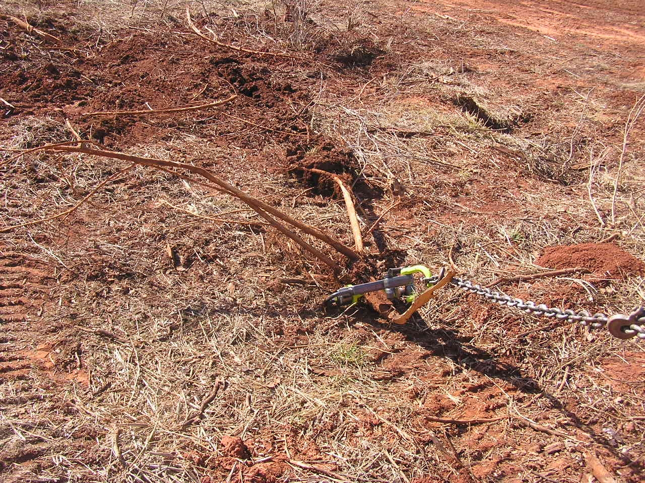

I pull little **** with the grab hooks on the bucket - stuff like scotch broom or blackberry knots, or t-posts; probably 200-300# pulling force at the most.
Medium stuff I go through the loop in the middle of the bucket; really tough stuff I bring the A-frame out and either pull that with a chain to the tractor draw bar or I use my truck winch, with the truck anchored to a tree (it really doesn't take much to skid an unanchored truck!).

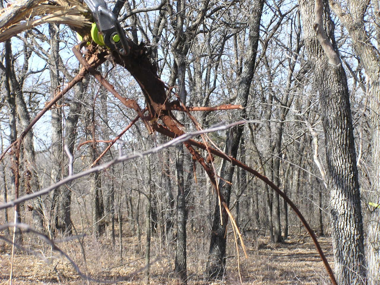

Original Brush Grubber did not work for me. It just slid up the tree while skinning the bark.
A 1/4 inch chain worked very well, basically by tying it to the tree using a clove hitch and pulling with tractor. The downside was climbing up and down to attach/detach chain from trees.
Now I use a tree/post puller (see Old Grind's photo). It is fast and easy and I can stack pulled trees for later removal; I just "curl" down until pulled tree is horizontal over the pile and drop. The limitation is the tractor weight, i.e. rear wheels lifting off ground even with ballast. This is mainly an issue with trees like sweet gums (even smaller ones) with a common root system.

I used the FEL on my JD Loader on a JD 5310 (62 hp). Now 10 hears after I bought it and 25 years after it was made I need to rebuild my cylinders on the FEL. That is probably abuse but I would think anything under 3" would be fodders for 90hp? It wouldn't bother me to back over them with a box blade. Note that I am no expert. I used a chain on the FEL to pull T-Posts. The on and off was not fun. Occasionally, the chain slipped off but practice with the wrap technique helped.
