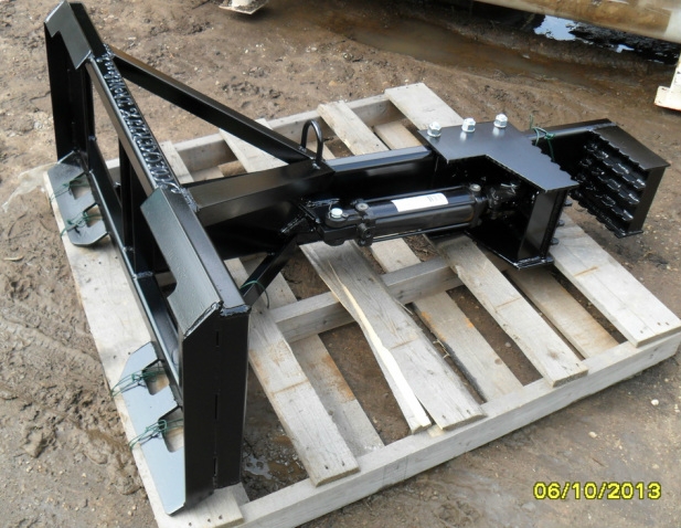

Check these: Buckthorn Puller
The long arm style is what I have:
My Thread: Tree Puller?

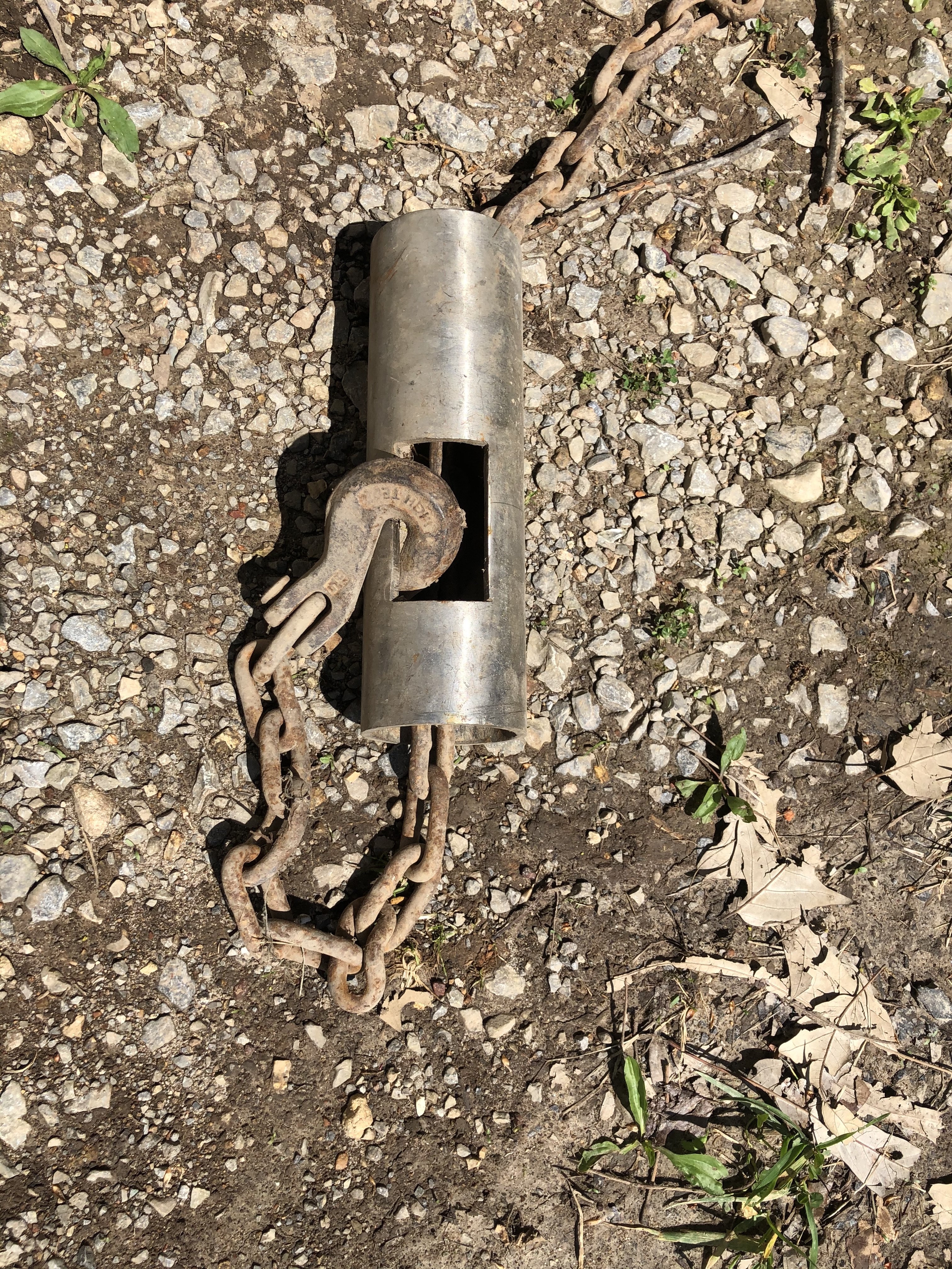

Hard to beat a chain and piece of pipe. Often use pipes on both ends of chain. Pipe bites the tree. If small trees are close, can pull several at a time. Easy to undo after pulling. Tried a grabber but didn’t work as well for me.

Been doing the pipe and chain my whole life, I even went back a few years ago and cut teeth in the pipe end to make the bite even better on the slick “gum” tree’s and shrubs

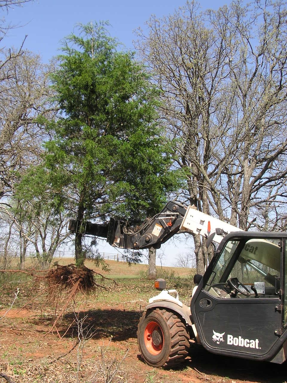

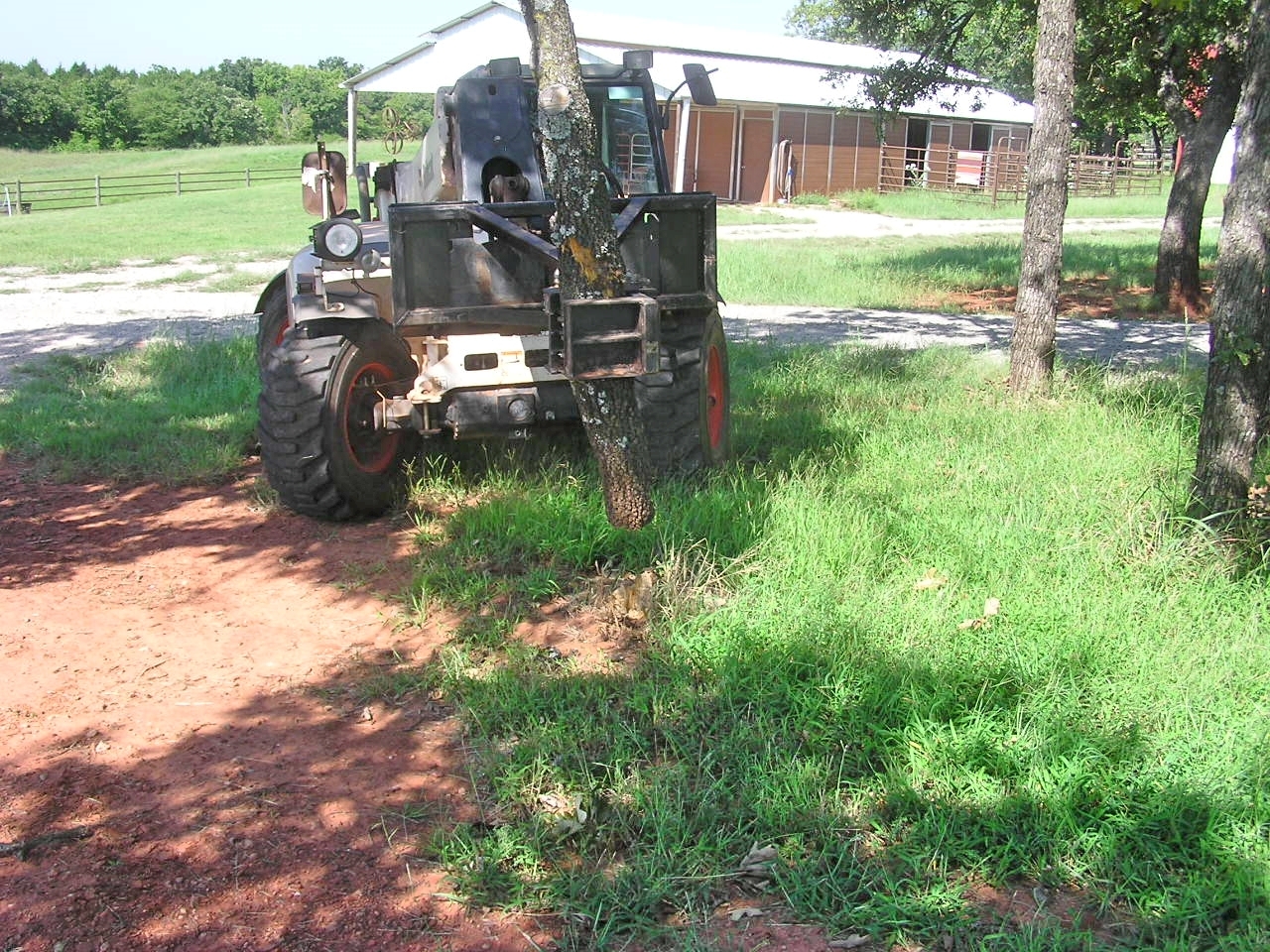

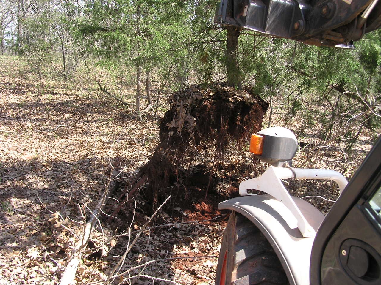

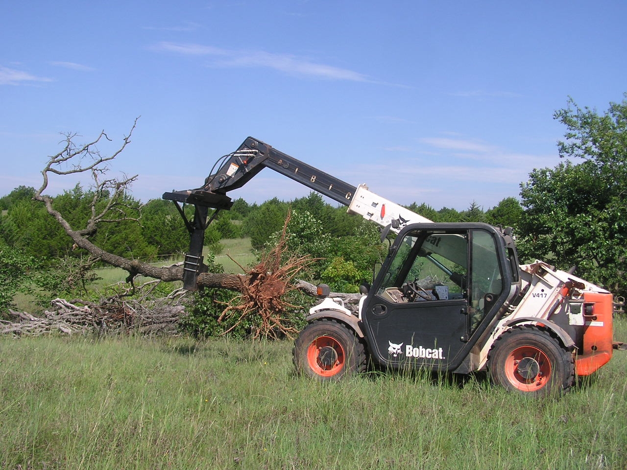

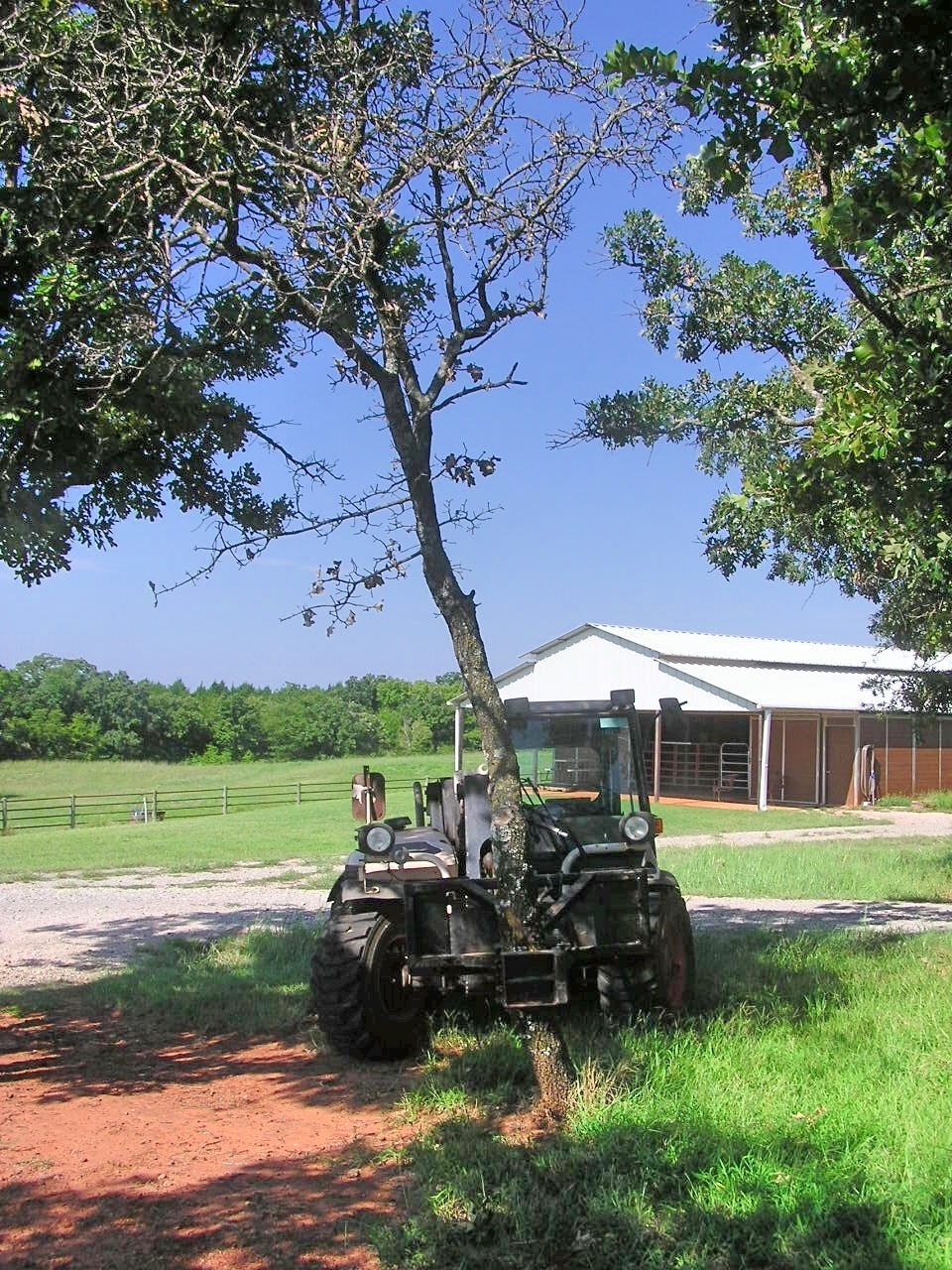

What types of trees and diameter do you normally pull with it?
Mostly cedar and oak up to 7 lnches
What size skid loader?
Not a skid loader, the Bobcat V417 is a compact telehandler.

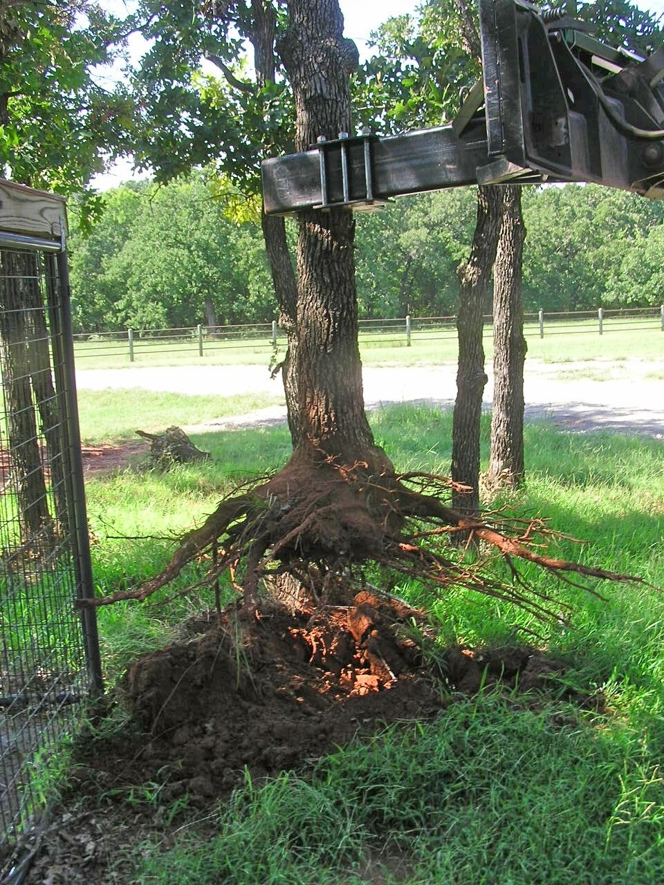

Here is a dead oak tree:
It broke:

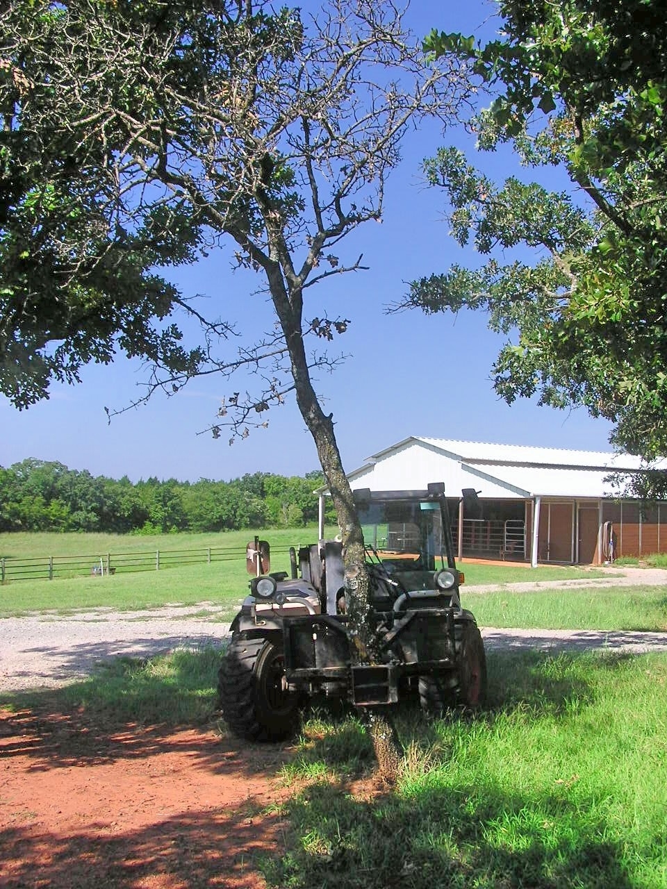

Here is another dead oak tree:
Took it to the pile in the ravine:

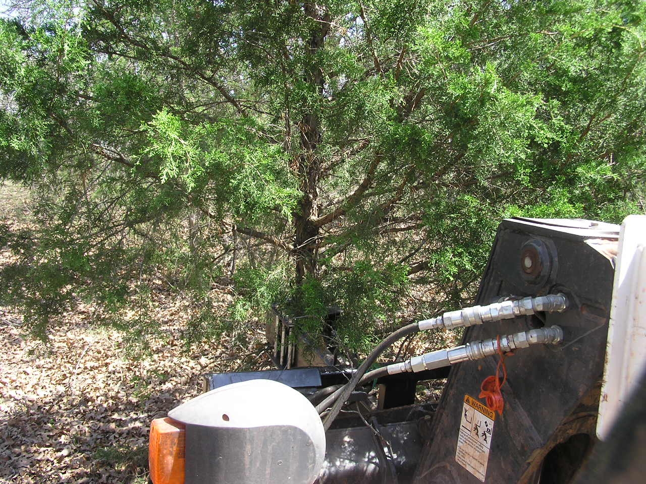

Here is a 5 inch by 15 foot cedar tree:
/ Brush Grubber #55
It broke: View attachment 3048790
Holy smokes! It must be holding up well! You buy the HD version?

I do not remember if there were two versions of the Long Arm puller back in June of 2013 when I bought it, but would have ordered the HD version.
/ Brush Grubber #60
View attachment 3051692View attachment 3051693
So the long arm one looks like you have to get close to the tree and swing into it (hard right turn) to then be able to close the jaws, as opposed to the others where you drive straight forward into the tree and close. Do I have that right?
