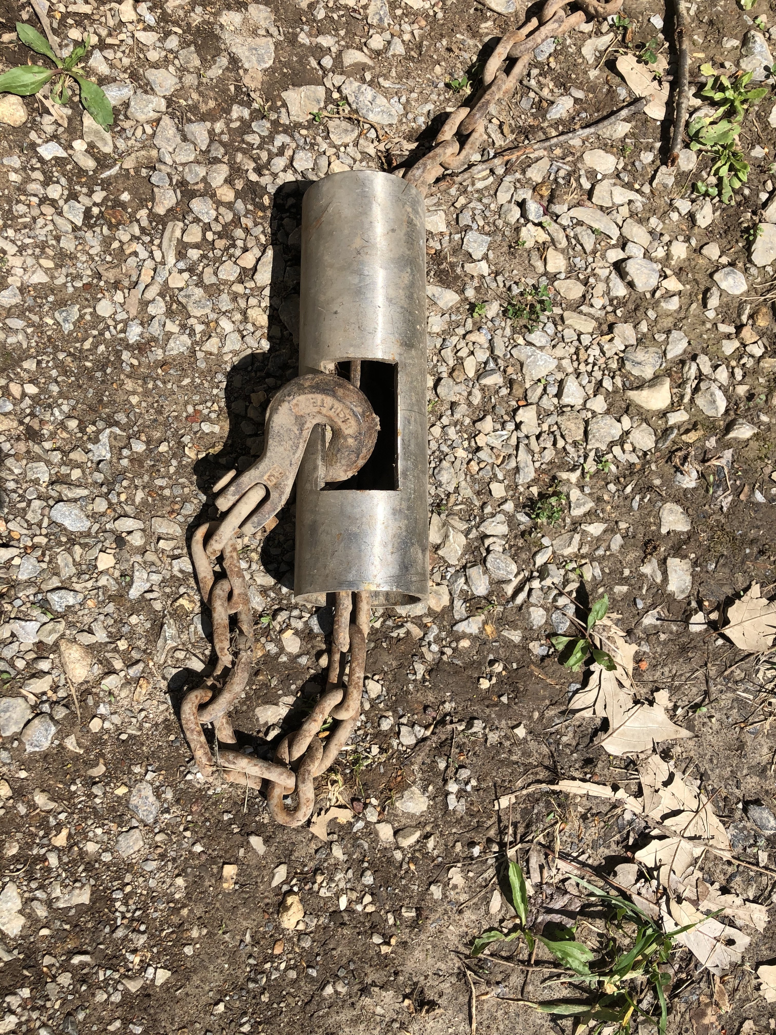

Hard to beat a chain and piece of pipe. Often use pipes on both ends of chain. Pipe bites the tree. If small trees are close, can pull several at a time. Easy to undo after pulling. Tried a grabber but didn’t work as well for me.

I made one of Smokeydog's pipe pullers. Simple & effective.

I use the pipe & chain very successfully, usually pulling with the front loader bucket hooks.
I use it on anything smaller than about a couple inches - cleared an area that was very densely packed with scotch room which tends to slip easily but the pipe grabbed it really well; I find that wrapping a chain around bigger stuff a few times with a slip hook involved works well for bigger thins that have some bumps.

If the pipe and the slot in the pipe are sized right to the chain and the hook, my experience is it will pull tight to the brush. Dont be sloppy making the cutout for the hook.

That's what I've always done, but even a 1/4" chain doesn't work well on stuff smaller than 1" or so, which is why I was looking into the grubber myself. The' ol pipe & chain trick works great down to about 1/2" at which point I find it usually breaks whatever it is in half, but most things that small can either be cut or yanked out by hand.
