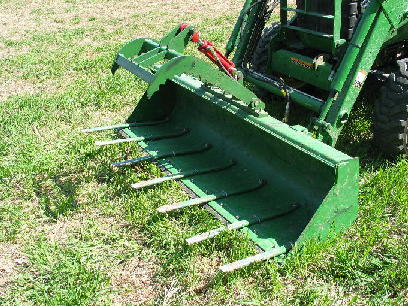

I'm cleaning up my families old christmas tree farm, and move A LOT of trees and brush around. I have a grapple I bought on ebay that is working great. I'm sure clamp on forks work well, but being able to pull up and pick up a pile of brush, or sections of a tree, it makes the work go faster and easier. I'll attach a picture to show my setup.

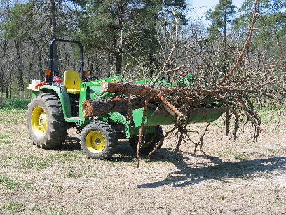

The bucket/manure tines really help make the system work. Even without the grapples, the tines help with moving larger limbs and sections of trees. But the grapple lets you really move material. What I do is cut down a pine tree, usually 30' tall tree, maybe 10-15" in diameter. I then cut it in half. I can then stack one half on the other, and then pick both up and move it to a pile. See picture.

You just want to be sure to counterbalance the load with weight in the rear. I don't know what I would do without this setup. Makes my life a lot easier. And not having to get off the tractor with every pile is great.

Check with your dealer and see if he can get you a BrushBrute. It is made by DD Scissons in Ontario. Nothing works better at clearing brush and small trees. Just ask MChalkey he bought one.
/ Brush/Brushpile moving #11
I have a toothbar, and I wouldn't use the forks for that kind of work. They would allow too much of the small material to drop or drag. The toothbar extends out enough under the brush to keep it from going beneath the bucket and I push it to the pile location. Once you get it against the pile you can raise it using the bucket, and raise the pile higher.
If you're intent on using some sort of forks you might do better with some sort of manure fork with multiple tines.
