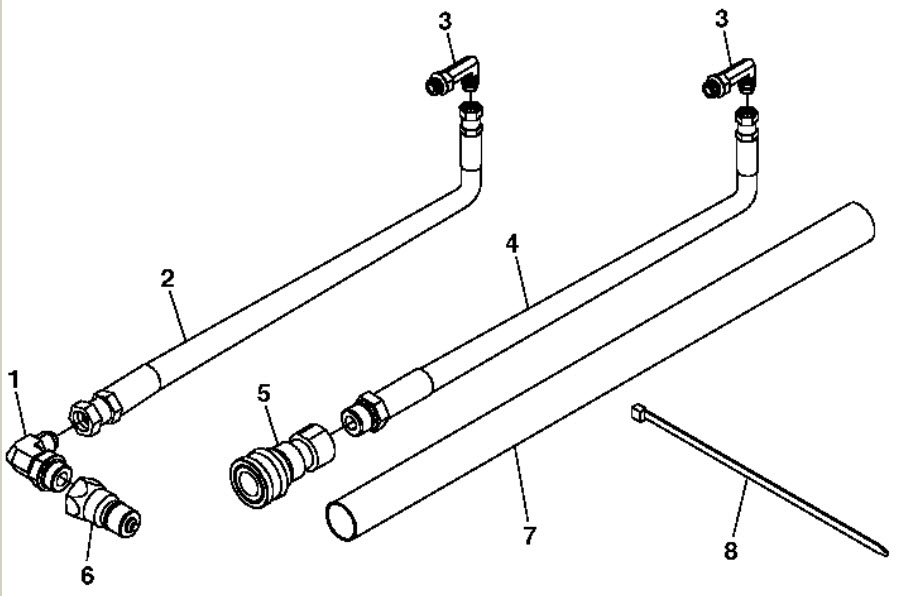

Well didn't break the tractor (1025R) but I did spring a leak from one of the hydraulic lines that connect the 260 to the 1025R. Dealer wants 55 for the hose and 200+ to come fix it. I didn't ask for the part number, but according to this picture it is AME017451.
http://www.tractorbynet.com/forums/...293359-260-backhoe-hose-problems-img_6756-jpg
Should I just take it off if it is under warranty?

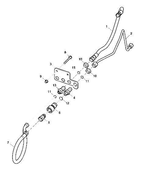

It is unclear from the photo which specific hose is leaking. Is it one of the Power Beyond hoses that is part of the tractor or is it one of the pressure hoses that is part of the 260 backhoe? The P/N AME017451 is not a valid part number.
Below are parts diagrams of the Power Beyond and 260 pressure hoses.
Power Beyond
260 Pressure Hoses
The hoses should be able to be removed by unscrewing the coupling. Also, are you certain it is the hose itself that is leaking and not one of the fittings?

I think he broke #7 in first pic.
/ Broke my tractor.. #8
If so, that hose should just unscrew. It is P/N AM105465 ($62.21)

it is the hose on the backhoe that connects to the tractor. The one with the elbow/bend in it I believe, I will have to double check tonight. Now that I looked at the picture maybe that isn't correct. There are 2 hoses from the back hoe to the tractor one has the bend in it while the other lays flat on the step. I assume they are the hydraulic feed and return lines?
The tractor is under warranty, but yes has jgayman has said I can't take it there and honestly don't want to mess with the tractor I just spent 20k on it with 40hrs. I will probably end up trying to take the line off, just wanted to check in here first with people who has experience. I just called the parts department and ordered the hose to get it coming. The service said they have to see the hose first and I figured either way I need the house. But it should be covered. There are no major rub marks
So sisupower now you know what the issue is.

Thank you for the follow-up. The hose you are referring to is a straight hose, it simply has a 90-degree elbow attached. Unless they are ordering the additional parts you will have to reuse the elbow and quick-connect coupler so hopefully those aren't where the leak is. The hose you are referring to is LVA20793 ($50.73).
