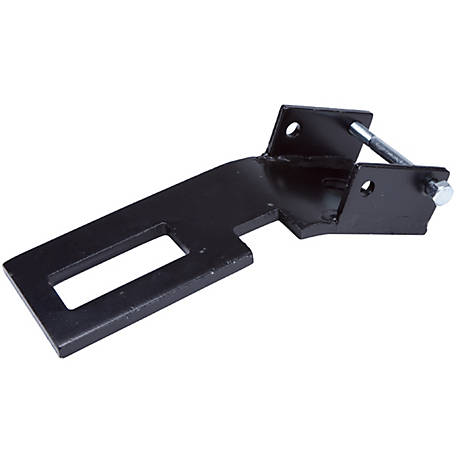

Quality Farm Supply, Agrisupply, Tractor Supply and others have these "drawbar locks" for around $21. Maybe what sixdogs is referring to.

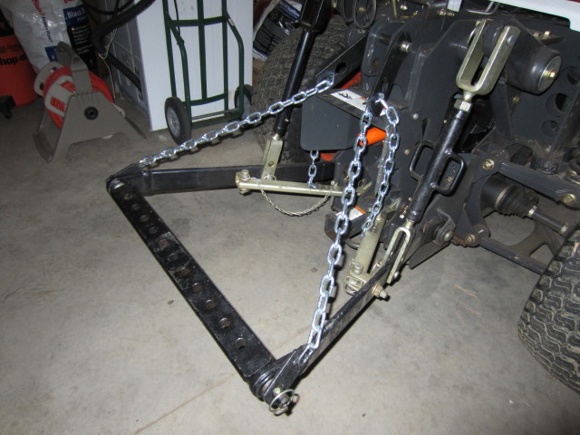

I've had one for 25 years. Haven't looked at the ones available today, but mine is quite sturdy. For more strength you can always use two, one for each link arm.
These don't work, though, if you want to use a 3pt cross drawbar in a "quick hitch". Here's one solution that I posted last year to pull a manure spreader.
https://www.tractorbynet.com/forums/customization/404937-adapting-3pt-drawbar-generic-quick.html

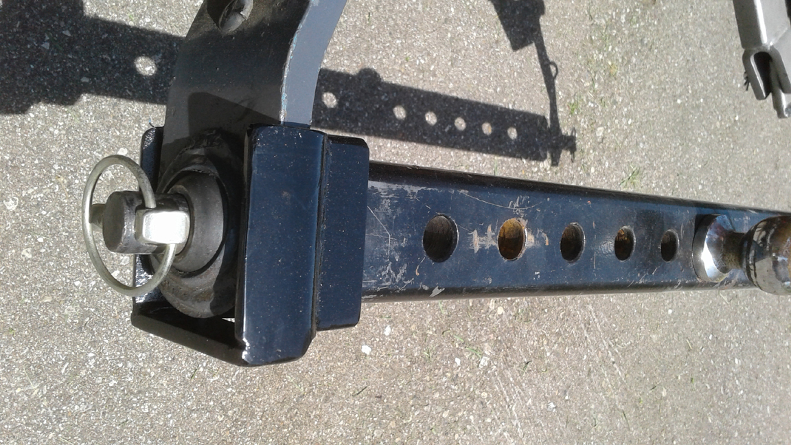

Indeed, that's the one I'm referring to. The extra wide tolerances to allow universal fit on anything and gives so much "slop" in operation that the metal easily tears. Maybe not if you're hauling around cupcakes, but if used in the woods or for really heavy or awkward items, I have not found the store-bought ones satisfactory. Maybe the older ones are OK but the newer import ones seem to me made of thinner metal. I just threw out my last torn one a few weeks ago. Quoth the raven "Nevermore".
Post #20 by RJCorazza looks like a winner to me.
Here is his pic

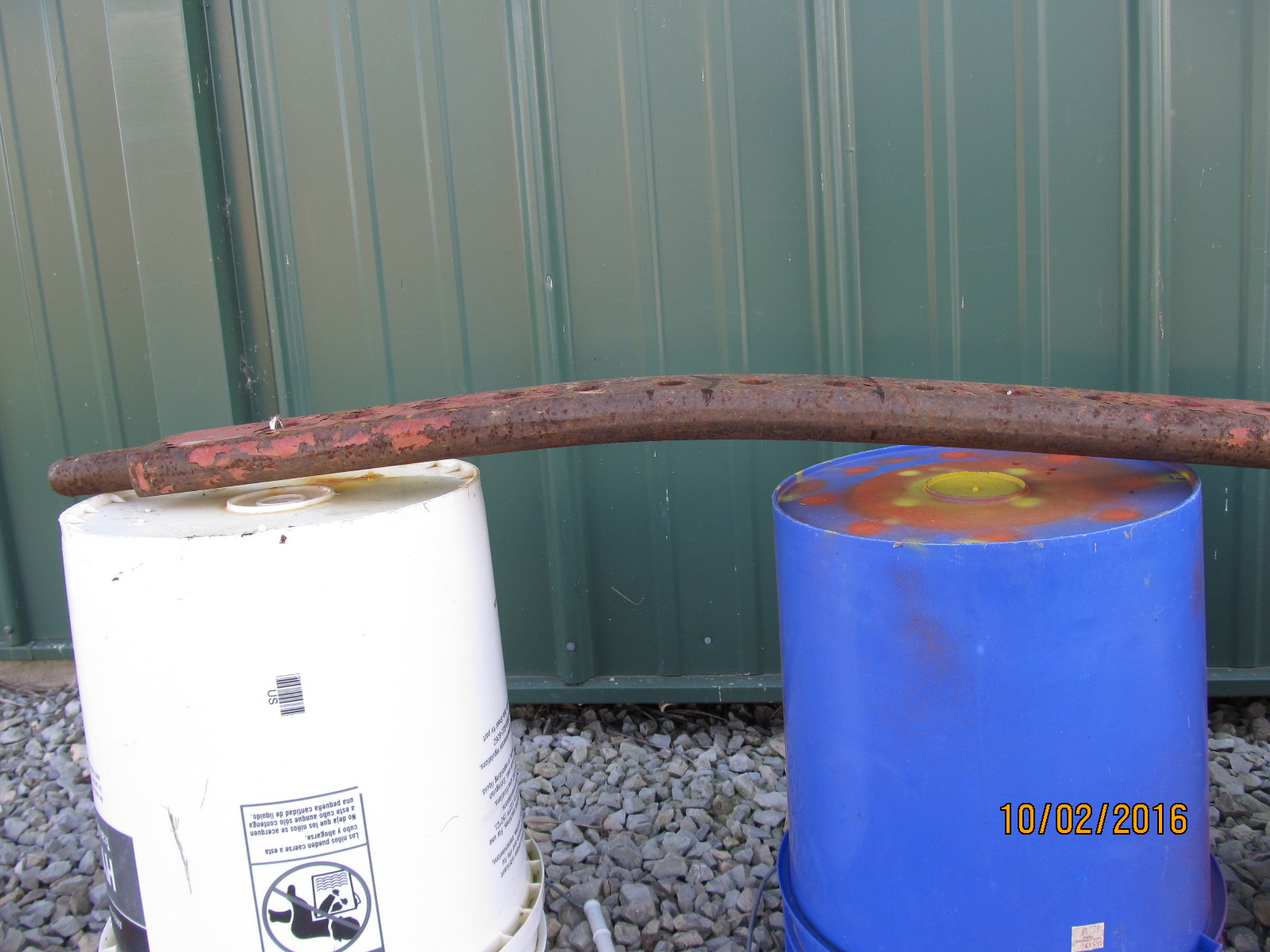

It's worth noting here that using the drawbar between the links has potential drawbacks. If you raise the 3PT hitch and that drawbar gets caught on the real tractor drawbar, it will easily be bent into a pretzel. Here's a pic of a CAT II drawbar that came with a tractor I bought. The fellow said it just got caught by " a little bit". I guess close only counts in horseshoes.
Hydraulics are pretty powerful.
Ha! Looking at that drawbar makes me want to put it on my HF 20-ton shop press and straighten it right out! :laughing:
